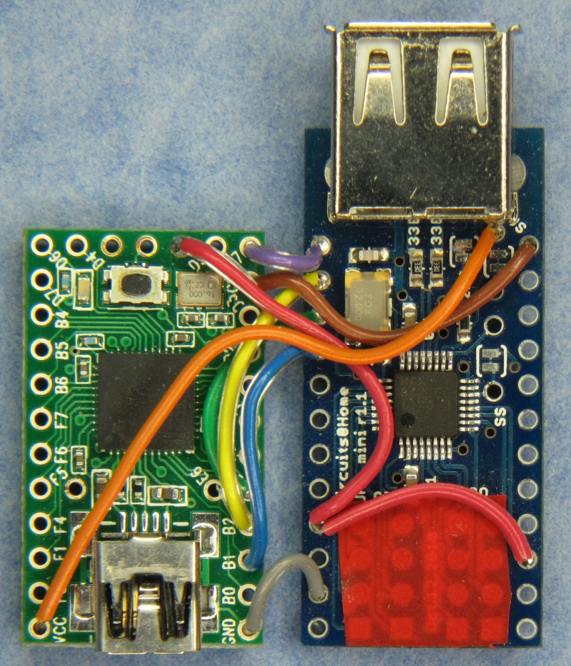

I tried hasu's code with the mini shield without success - I get "HID init: failed" with both an ML4100 and an MX3000, both when starting from the bootloader and when just plugging it in. I'm not sure at this point whether the code doesn't like those keyboards, or whether the different hardware is causing the problem, and I just haven't had time to look into it further :(
I'm assuming that some configuration issue is most likely, since it's failing at a very early stage. My hardware setup passes the board_qc test in the USBHostShield2 libary though, and that can read the device descriptor OK.
Soarer
31 Oct 2012, 03:26
Right, got it working... simply a config setting in tmk_keyboard/protocol/usb_hid/USB_Host_Shield_2.0/avrpins.h: needed to uncomment #define BOARD_TEENSY to get it working with the Teensy 2.0 + Mini shield combo.
fossala
Elite +1
31 Oct 2012, 07:45
Soarer wrote:Right, got it working... simply a config setting in tmk_keyboard/protocol/usb_hid/USB_Host_Shield_2.0/avrpins.h: needed to uncomment #define BOARD_TEENSY to get it working with the Teensy 2.0 + Mini shield combo.
Got any pictures, pictures are always good.
Soarer
31 Oct 2012, 13:45
The next step will be to fold it over and use header pins in some of the spare holes to hold it together.
