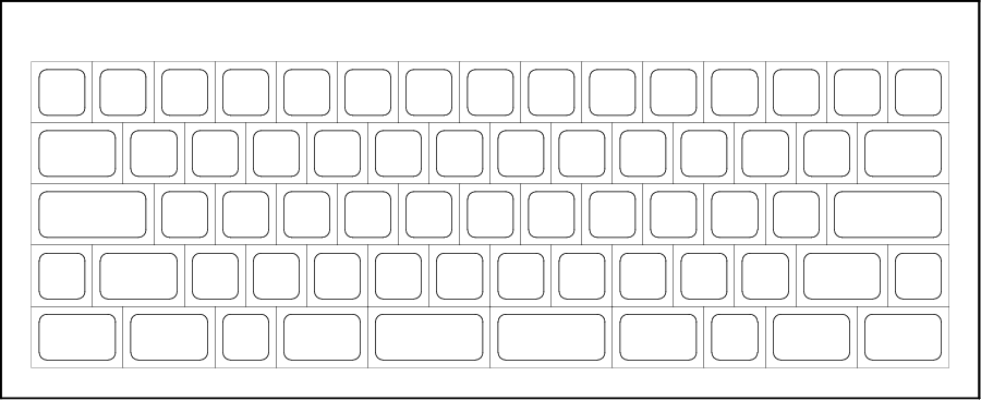

Firstly, thank you for holding a friendly discussion with me about this. I welcome input and I know we're all just searching for the holy grail in mechanical interface form.
Having the 1.5" keys available is awesome, I have incorporated that into another revision of my proposal. I'm basing my changes on ergonomic flaws that I encounter on a line-by-line basis while programming.
The reason for the gap between A and my ESC (formerly Caps Lock) is one that I believe many can appreciate: I often hit the caps lock key while trying to type N A, AND AS result my typing will look somewhat like this. It has been fixed in this version, however if you can see my point, and think it may be a feasible idea, I would gladly have that gap put back in.
The other spaces have been remedied in this version; I am assuming, however, that there is a way to flash/reprogram the controller to behave accept my layout, which even has some unused keys because I despise contorting my pinkies to hold modifiers while typing.
But with regards to my layout being "messy" - the whole keyboard is a mess anyways, and that's what we're striving to fix! :)
Another note about my layout is that a half-key of space could be cut from the right side. This would cause smaller enter and (legacy) backspace keys, decreasing the amount of torque that gets applied when a user hits the extreme side of a key, and in my case it would not sacrifice any keys that i "need". But I understand that the 5x15 is a set standard until otherwise expressed.
So to summarize this layout, it's not different aside from a little remapping (no caps lock) until the bottom two rows.
2: [1][1.25][ 10x1 ][1.25][1.5]
1: [1][1][1][1.25][1][1][ 7x1.25 ]
EDIT: layout numbers were not quite correct...
The coloring serves to separate the actions of different fingers from each other. At the bottom are the thumbs. See how much the pinkies do?
I have other ideas too, but this will do for a start. Is there any way I could obtain the current PCB designs? This is really interesting stuff.
Layout picture:

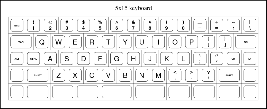

7bit wrote:This is not radical enough!
Here comes my latest 5x15 design:

13 Jul 2012, 12:52
Don't know what to put on some of the key caps, but here it is:
13 Jul 2012, 12:59
Maybe this looks a bit better:
mintberryminuscrunch
13 Jul 2012, 13:06
7bit wrote:Don't know what to put on some of the key caps, but here it is:
That's pretty much it but with a standard enter key, thanks :-)
sad_destroyer
13 Jul 2012, 20:42
I do not program COBOL(haha), but I still never feel the need to use caps lock (not even when typing "COBOL" here). I could potentially use one of the unknown keys for a shift lock modifier, however. I would be willing to program the board's controller to work with this layout too.
I would definitely go for a stepped caps lock key (to be used as Esc).
Can I have a post with the bottom two rows as follows? So that there is a model for actually using the layout.
1 ; 1.25 ; 1 ; 1 ; 1 ; 1 ; 1 ; 1 ; 1 ; 1 ; 1 ; 1 ; 1.25 ; 1.5
1 ; 1 ; 1.25 ; 1 ; 1 ; 1.25 ; 1.25 ; 1.25 ; 1.25 ; 1.25 ; 1.25 ; 1.25
Blank keycaps are fine, or you could use my layout Image
Unless you don't feel another workup of this is necessary.
