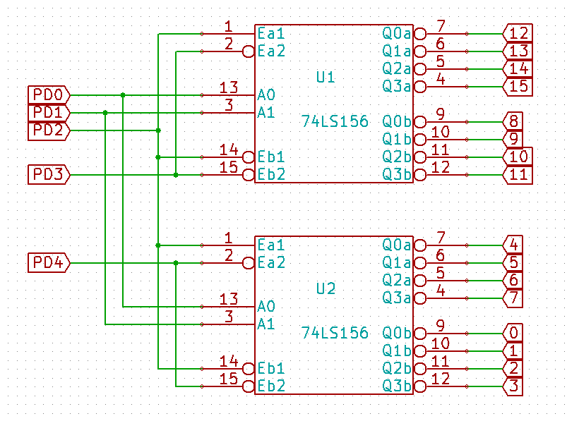

This function - a "4 to 16 line decoder" (google it) - can be built with one or two chips, but two is a lot cheaper...
from 4 pins on CPU ------ to 16 matrix column strobes
                  |      |---- 1
                  |      |---- 1
                  |      |---- 1
                  |      |---- 1
                  |      |---- 1
                  |      |---- 0     one active column strobe at a time
            0 ----|      |---- 1
binary      1 ----|      |---- 1
code        0 ----|      |---- 1
            1 ----|      |---- 1
                  |      |---- 1
                  |      |---- 1
                  |      |---- 1
                  |      |---- 1
                  |      |---- 1
                  |      |---- 1
That's all it is, a simple circuit.

Anyway, I deliberately drew it as a 'magic black box', because there's a choice of chip(s) that can be used to build it.
The 74159 has exactly the right function, but it's not common, relatively expensive (£3+), and as large as a Teensy.
Two 74138 chips would also work neatly, but they don't have open-collector outputs.
Two 74156 chips would work well, but require an extra pin on the Teensy to select between the two chips (not a problem; you'd still be saving 11). They cost 27p each (Farnell) when buying 100.
Open-collector outputs are better for keyboards since it doesn't matter if you short the outputs together (by accident, or mistake when building).
So the pair of 74156 chips would be my choice. Software still sees it as a matrix with 16 column strobes, and to activate a strobe it writes 'column number + 8' to five logically adjacent pins on a port (e.g. PD0 to PD4). The '+ 8' is there to drive the selection lines (e.g. PD3 and PD4) correctly for the two chips.

I'm sure you could find a local supplier at a similar price. edit: Just how lazy are you?! 'Change Country' on the link I gave and select Germany :roll: http://de.farnell.com/texas-instruments ... dp/1470807
DIP-16__300 or DIP-16__300_ELL (elliptical pads).
See, it's really simple! :lol:
An 'activated' output is 0V, so yours diodes' stripy ends should point this way!
Expected input binary code on PD4..0 is between 8 and 23, which will activate a single output (code - 8).
Code < 8 will activate 2 outputs (code and code + 8). Not useful, but harmless!
Code > 23 will activate no outputs.
I think that's correct... I would test on a breadboard first. Not sure if I have any '156... :roll:
Schematic...
decoder_4_to_16.rar
(2.09 KiB) Downloaded 192 times
