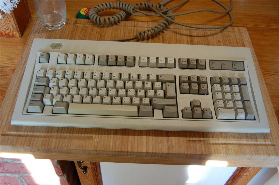

There was a Model M with Greek legends on ebay a while ago with a horribly yellowed space bar, though the other keys were all good. Wish I'd saved a picture of it, ebay's useless for preservation.
Anyway, here's another one, which is subtler but still clearly different from the other caps:
Nice worn ABS spacebar you've got on your HHKB 1 there, Cookie! Striking indeed how it hasn't yellowed anything like as much as the case. Try taking it off and shooting pictures against a white sheet of paper and you might find the telltale ABS tan even so. Apparently ABS (like all commercial plastics) is a mixture of things — the S stands for styrofoam, which sounds so cheap! — and I dare say the fire retardant part of the mix was stronger for your HHKB's case. The part which protects all the rest.
