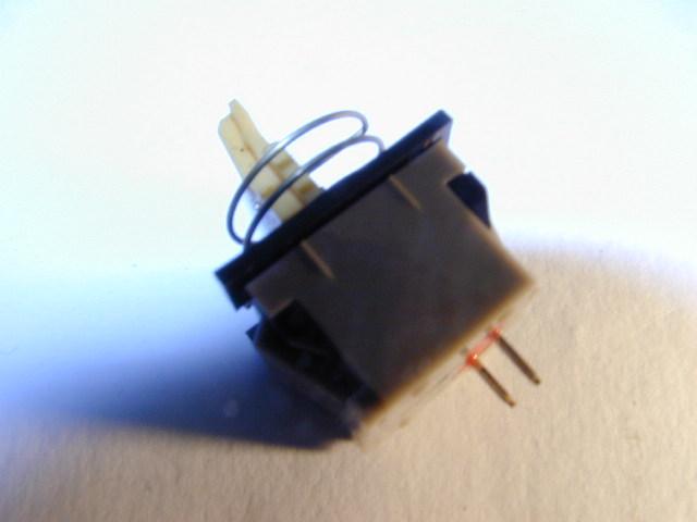

I just noticed this side shot - and the T-ALPS look white, like the TRS-80 Model III ones:
Compare with the "General Keyboard" yellow sliders:
22 Jan 2015, 18:45
I saw the photo and they do appear to be cream tee mount, but I like to be properly sure!

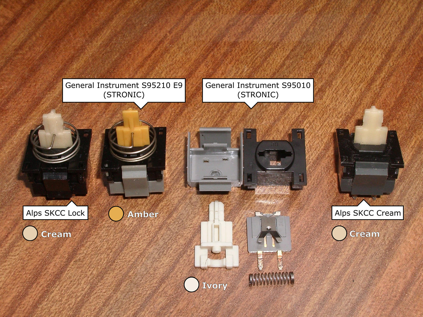

mr_a500 wrote: Either General Keyboard made keyboards with ALPS switches, or this is a T ALPS clone.
It's General Instrument Keyboard Division, and it's [wiki]General Instrument Series S950[/wiki]:
SKCC vs S950.jpg (419.29 KiB) Viewed 4297 times
You can't see from that photo, but it's "GI" branded: [wiki]Clare-Pendar[/wiki] as a brand (under its long-standing General Instrument ownership) must have been fading away around 1980.
STRONIC are adamant that they had exactly one S95210 E9 switch, and that I have it. However, this is what their website told me I'd get:
STRONIC seems to be one person whose English isn't very good and I failed to even get an acknowledgement that something is afoot, since clearly he had two different switches, one matching those from the Tatung Einstein and TRS-80 Model III (amber) and one matching his S95010 (ivory). All attempts to get any kind of documentation on these (even just packing slips from his own sources) failed, but they all basically match the S950 catalogue page I got from Electro-Mech. It seems that amber vs amber seems not to have any important meaning, but it may indicate age. Really someone who speaks French needs to interrogate them.
The keycap mount is indeed different. It fits Clare-Pendar keycaps (the switch depicted is from a Tatung Einstein):
This keycap came with an unidentified "ASM MEXICO" switch that appears to be S88010. (I also have the matching clear tops, that the Electronic Surplus site insisted did not come with them.)
The switchplate front panel is so close to real Alps that I'd not be surprised if Alps were actually making some or all of these parts — the differences even within S880 and S840 batches are so pronounced that it seems unlikely that they'd replicate Alps mould numbering so perfectly.
