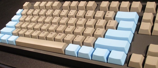

Today I installed Silencing Rings in my second Novatouch, which I purchased from Newegg. I am designating this NT-HS2. This one came in somewhat different packaging from my first Novatouch, which I shall call NT-HS1.
I also lubed the stabilizers, this time with "Finish Line" teflon grease, and I put two squares of self-adhesive foam pads under the spacebar, one pad on each side of the central switch. The foam appears to be the same material that is used as anti-skid pads on the bottom of keyboards.
Finally, I installed Ducky PBT keycaps, which are OEM profile. I used dark gray dye-sub alphas and light blue blanks for the modifiers. These keycaps seem to be made to order for the Novatouch. The OEM profile is high enough to avoid down-stroke clicks that otherwise would result from the keycaps hitting the switch housings or plate. The only key that produces some contact noise is the spacebar -- if I hit it fairly hard, particularly on the left side. I might try using thicker foam pads under the spacebar, but with normal typing, I don't notice spacebar noise.
With NT-HS1, I detected some clicking from several keys that seems to be a problem with some of the switch housings. In contrast, there are no keys with this sort of clicking in NT-HS2. Hurrah!
Overall, my second Novatouch, NT-HS2, is a joy to type on. This particular combination of a Novatouch from a later production run outfitted with Silencing Rings, lubed stabilizers, foam pads under the spacebar, and Ducky PBT keycaps in OEM profile seems ideal. With these characteristics and modifications, the Novatouch seems on par with the Realforce 87U.

Score one point for the Novatouch -- it has a normal switch in the Left Control position, so that is is possible to install a silencing ring on all of the keys.
After making all the modifications to the Novatouch (installing silencing rings, lubing the stabilizers, putting foam pads under the spacebar, and installing Ducky dye-sub PBT OEM profile keycaps), I am amazed by how good this keyboard sounds and feels. The transformation from the original is stunning, and if I didn't know I was typing on a CM Novatouch, just judging by the sound and feel, I could swear I was typing on a silenced Realforce 87U all-45g.
Novatouch with Ducky PBT Keycaps in OEM Profile:
This is my second Novatouch makeover, and I found the results on the second one even better than the first. For example, the second NT has no clicking keys. The model numbers of the two boards are the same, but the S/N of the first one is SGK5000GKCT1US1142000109, whereas the S/N of the second one is SGK5000GKCT1US1150101259. I assume that the higher number corresponds to a later production, and perhaps some improvements were incorporated.

@hypersphere thanks for posting your thoughts on the NT. the keyset looks great !!

@roboticus: Thanks. I really like the Ducky caps. Wish they had some readily available additional color options, such as black blanks.
