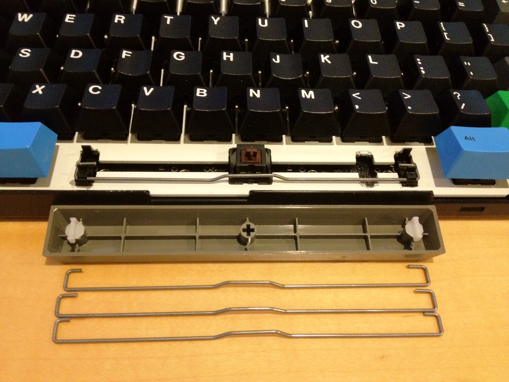

Mad props to alaricljs for all his help. Armed with his tips and hints, I bought a wire bender, found the right size of wires, and I can now make 7x Costar stabilizer bars. The first one took me an hour to make it right. Now I can make one in 5 minutes. I think Costar stabilizers for 7x spacebars is a go.
Costar 7x Stabilizer metal bar.JPG (726.08 KiB) Viewed 7084 times

Very nice. Did you made that wire based on the wire WASD sells? I have heard WASD uses a thicker wire than Rosewill/Filco.
litster
17 Jan 2012, 17:41
I measured both WASD's and the ones from one of my Filcos. They are all 3/64" wires. In any case, the wires fit perfectly into the clips and no rubbing. I haven't added any grease yet, but they feel fine.

The clips to the plate might be the same, but the wire is certainly not. For Cherry, the wire/bar needs to have a hump in the middle to go over the switch. That's is why it is a lot harder to bend than Cherry's stabilizer bars.

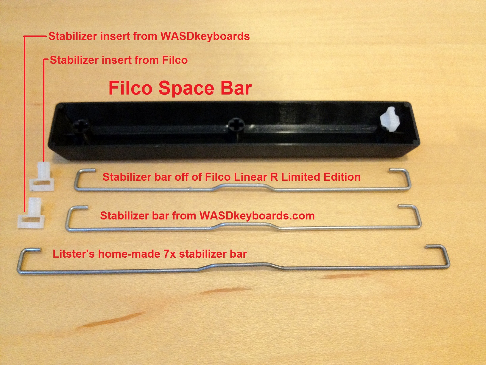

Thanks, then here is my next question accordingly: does the filco wire feel weaker than the WASD wire?
Also what about the white plastic stabilizer inserts? Does the Filco one look shorter and chubbier?

Filco's stabilizer bar and WASD's feel about as flexible as each other, and same as mine. The inserts are the same too. Well, Filco's is about 0.1mm taller, but i think that is due to me pulling the spacebar out and stretched it a bit. WASD's insert is brand new, never been used, so there has been no stretching.
Costar Stabilizers With Text.jpg (650.06 KiB) Viewed 6960 times

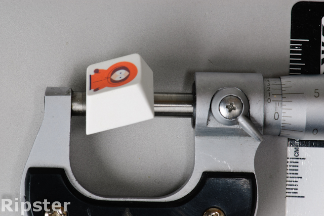

ripster
19 Jan 2012, 21:31
Damn imperialists.
The right tools give the right results.
Kenny died after I did this.

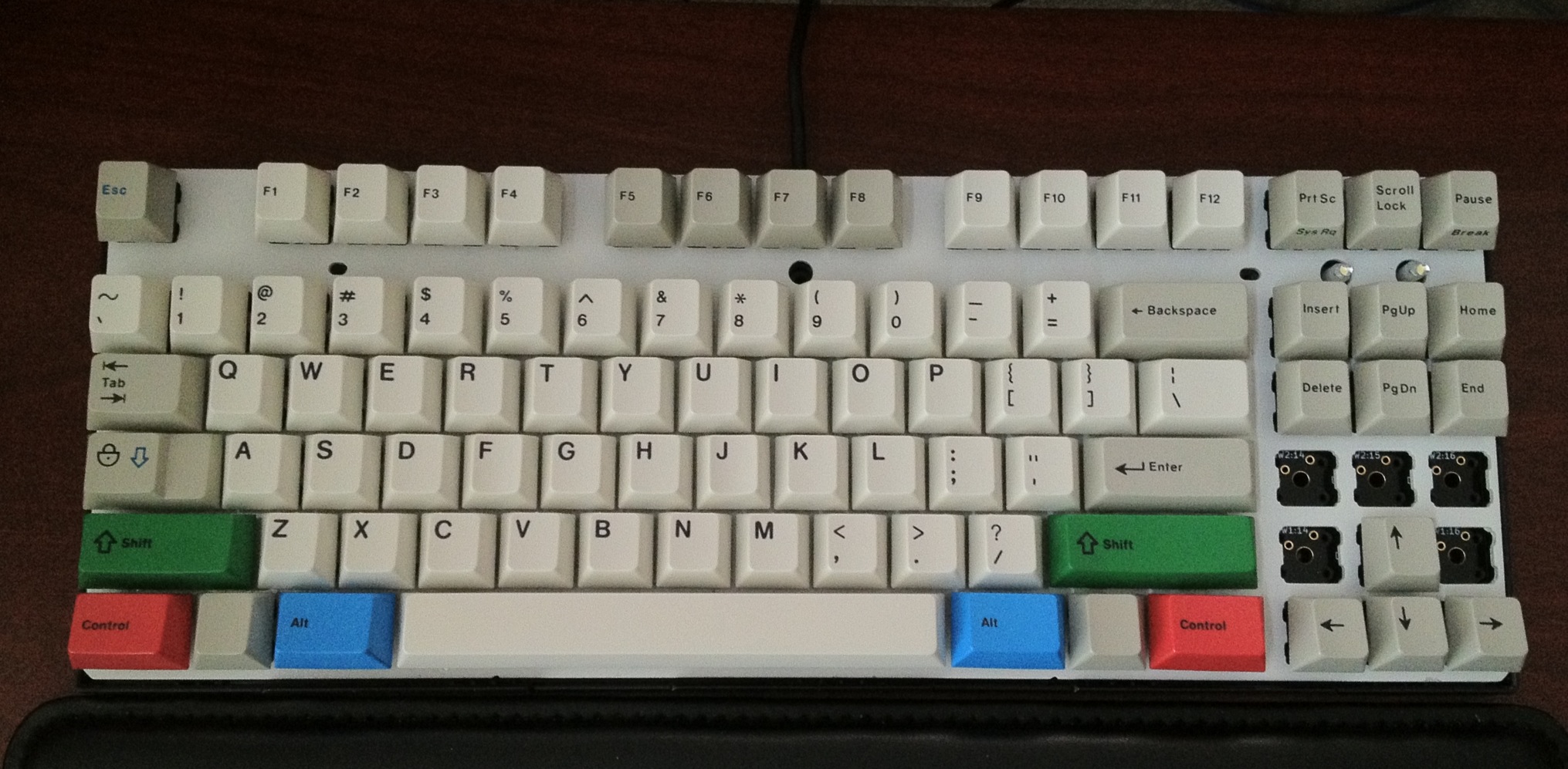

Totally unrelated, but here is a picture of the Phantom prototype dressed in Cherry dye sub keycaps, plus Cherry RGB dye sub modifiers, plus Tarkoon's Blue Esc keycap and handbag capslock.
I have been just having the prototype sitting on the bottom half of a Filco case. The exposed white-colored plate makes it pleasant to look at. It is nice and free. Like surfing the web in your underwear! :-)
Phantom with Full Dye Sub plus blue Esc and Handbag.JPG (501.92 KiB) Viewed 6820 times

20 Jan 2012, 00:31
I'm jelly, that looks amazing.
