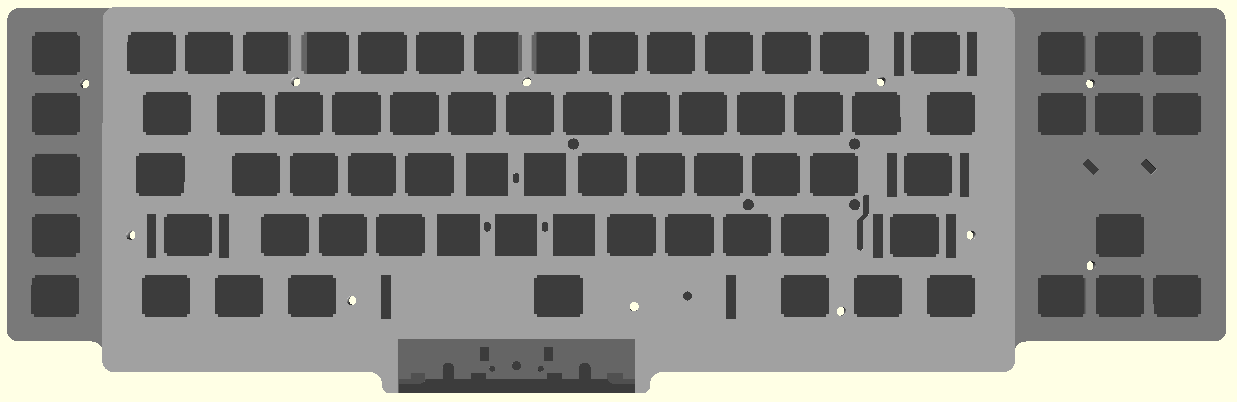

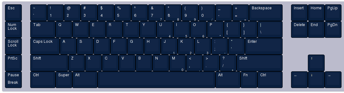

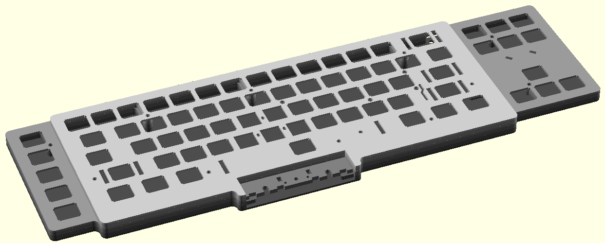

I'm really excited to see this group-build. :D A lot of great ideas are coming out of it and the PCBs will take a lot of the pain out of making a custom keyboard. Though I don't think I'm ready to commit to another custom keyboard project, I've been working on some layout ideas and thought this would be the right place to share.
This post by Muirium where he mentioned his pyramid concept got me to thinking, I only really want the main keyboard area for typing. The other key clusters are just in case they are needed. Also, looking again at matt3o's keyboards and some of the others from the last group-build, I really like how much thinner they are than the one I built. So I threw together a design that made the secondary clusters less prominent, while still allowing enough internal space for TrackPoint hardware (I think).
Thanks to suka for the suggestion to use OpenSCAD. :) The above pictures were made by importing the DXF file and extruding the 2D layers. I'm dreaming of a relatively simple Python interface that could take most of the grunt work out of designing layered keyboards, perhaps similar to suka's OpenSCAD script, but perhaps that could take keyboard-layout-editor raw data as input and automatically generate a top plate. That would also help reduce the possibility for errors when drawing the plates manually.
For the case in those pictures, I tried reducing the design complexity to make it easier to build and more serviceable than my last keyboard. So it doesn't have an OLED display and has only 2 LEDs instead of 7. The TrackPoint controller would mount to the top plate making the keyboard easier to close. And this is the layout I had in mind:
Anyway, I'm still tinkering with this design, and can't wait to see some of the great concepts and excellent work in this GB come to fruition.

mtl wrote:Thanks to suka for the suggestion to use OpenSCAD. :) The above pictures were made by importing the DXF file and extruding the 2D layers. I'm dreaming of a relatively simple Python interface that could take most of the grunt work out of designing layered keyboards, perhaps similar to suka's OpenSCAD script, but perhaps that could take keyboard-layout-editor raw data as input and automatically generate a top plate. That would also help reduce the possibility for errors when drawing the plates manually.
Can you share how you extruded those layers, as I am mighty interested, since I am always designing layout plates and layered acrylic cases.

Good idea. If I understand your idea correctly, it may require some additional screw holes that may be redundant for edges of the keyboard where you opt not to have a module. I think there would probably be visible seams where modules are attached. I'll try to take a crack at it in the near future and report back.
mohitgarg wrote:Can you share how you extruded those layers, as I am mighty interested, since I am always designing layout plates and layered acrylic cases.
First, save the case design as a R12 DXF file. Then search the dxf for LAYER to find the names of your layers. Then import them like so (this is the .scad script I used):

mohitgarg wrote:Regarding the code to generate layers, this is a very interesting idea, which I had shared again on my Blox project thread, it would be a one time investment, but one should be able to write a script to generate SVG files, for layers based on a webform, or a formatted output like from the layout editor and this would help the community immensely. I did intend to get onto that when it came to it (Right now I am working on designing the PCBs).
Some of the issues are regarding output formats. OpenSCAD is scriptable, but doesn't seem to support output of smooth arcs (laser cutters prefer arcs over sharp corners because it keeps the laser moving). DWG is a proprietary format, but if anyone could recommend a library that supports DWG output I would be interested. SVG is good but I'm not sure if matt3o's laser cutter accepts it and what line thickness should be used. Plus there are unit conversion issues from what I've read. DXF may be the way to go, but I got corruption errors opening up a file created using the Python dxfwrite module in DraftSight. When a good output format and supporting library are found then perhaps more progress could be made.
