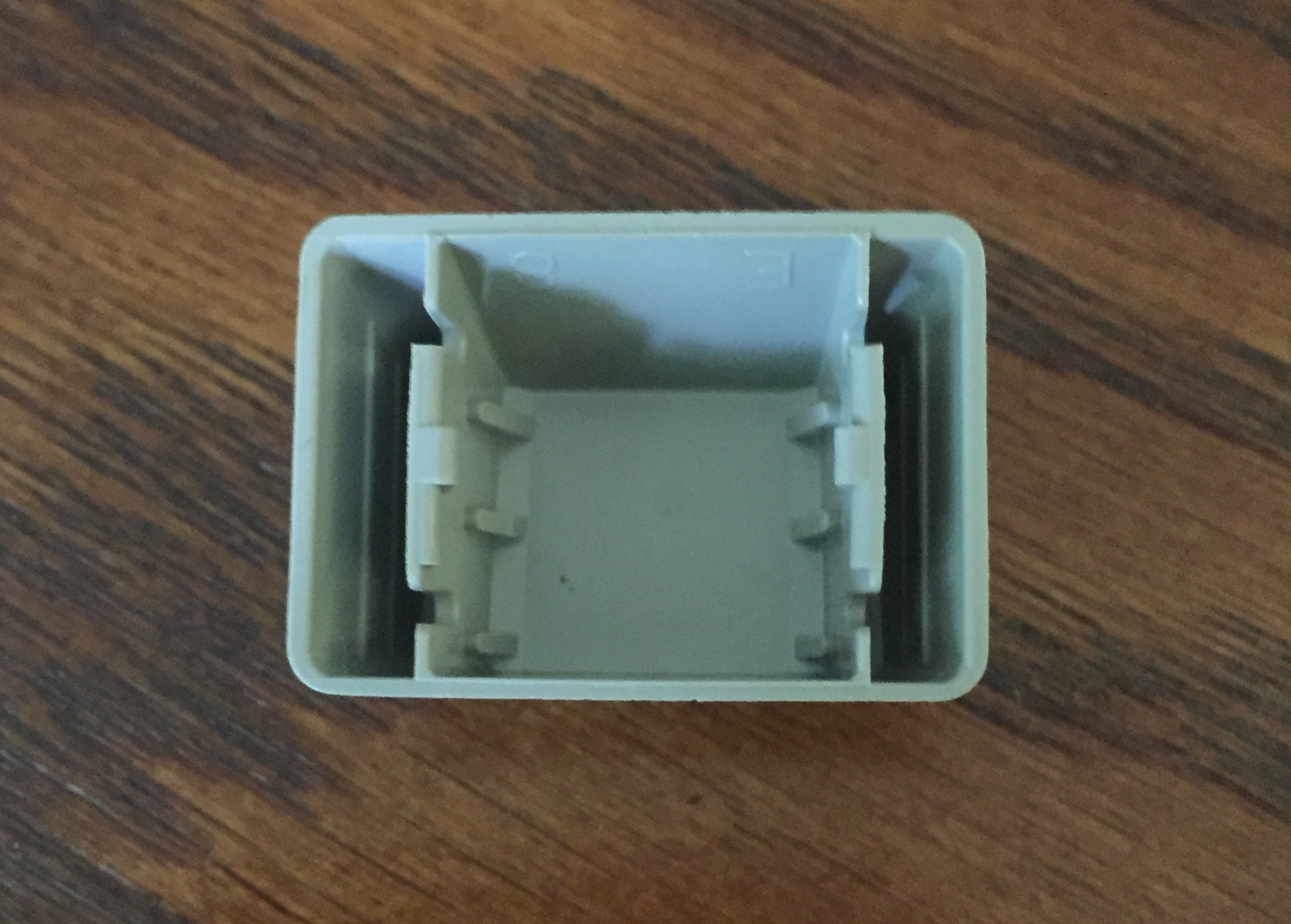

Agree with 7bit, with a twist. You just leverage the same keystem as the stabilizer on oversized keys. So the keystem is always the generic 2-piece keystem base (regardless if it is an active switch). Then the caps just snap on. A picture below of a 1.5u to add context. For the anything >1.5u, you just have multiple of these oversized clips (2 for anything ANSI with ISO enter needing three. Definitely doable. I would be up for helping to fund mold costs (assuming I get a cut until reimbursed).
Any extra stems we need, we source (plenty floating around without tops), or crawl to Unicomp when that supply dwindles. Moral, avoid designing stems.
Sorry for hijacking the thread with this, but we (BS fans) need help. I'll let it rest, but demand will be there... You build it, they will come.
