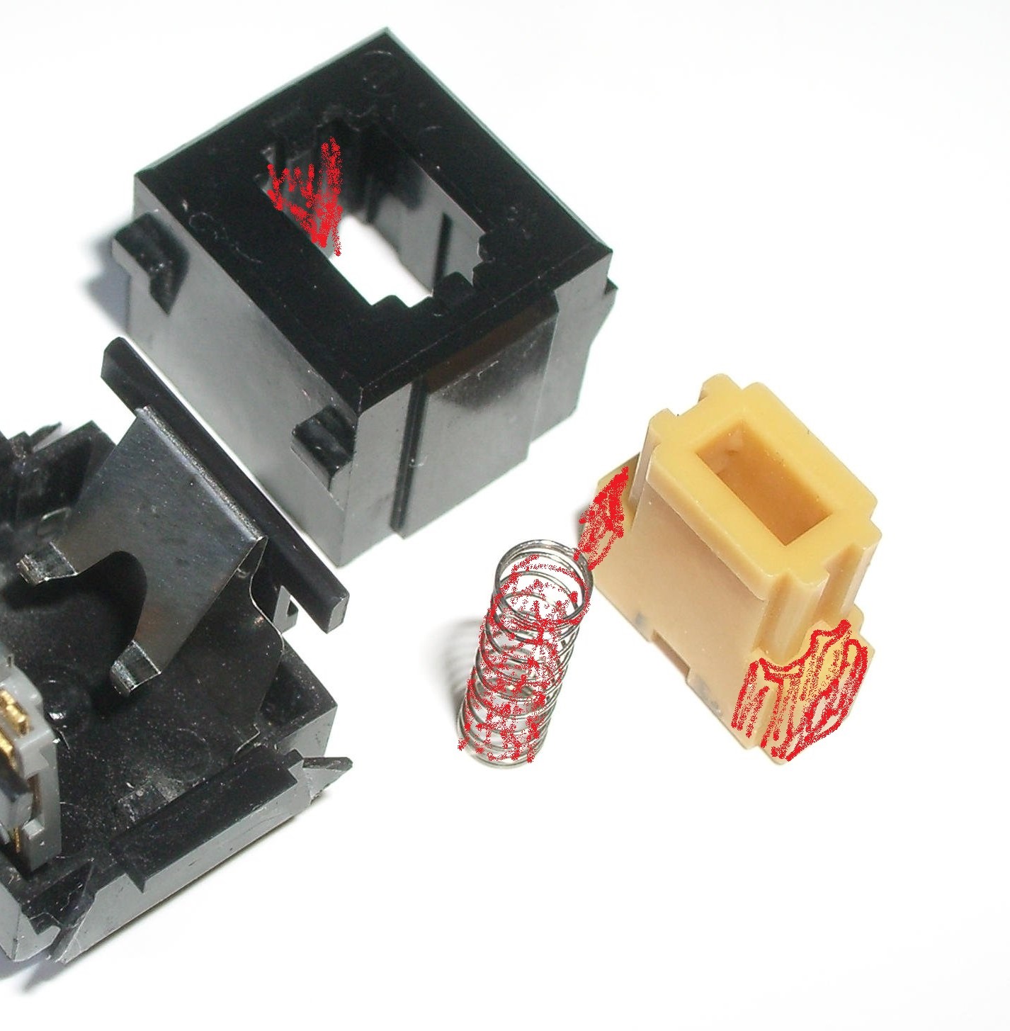

On another note, what parts of SKCM switches do you generally lube ?
I would have lubed the sides of the stem that come into contact with the upper housing, the uper housing slider recesses and the spring maybe to get rid of a bit of spring ping.
Also what parts do you throw into the ultra sonic cleaner ? I would have put in Slider, Upper & Lower Housing. Nothing else.
And does someone has a good ali express supplier for (two stage) springs for alps switches ?
I have some SKCM dampened Creams I want to experiment with. I´am talking Wax Boil, Spring Swap, Wet Lube & maybe a Paper Mod, just to see what you can get out of one of the cheapest alps out there :D

guidemetothelight wrote: 24 Jul 2023, 08:54 what parts of SKCM switches do you generally lube ?
The couple times I've lubed alps I've just gone for the sides of the slider that makes contact with the rails after ultrasonically cleaning the stem and upper housings, and it seeeeeems to work alright, though I've never tried your type of method to compare. I hate the sluggishness that lube sometimes brings, so i tend to be a bit lighter on the lube side of things. Regarding springs though, call me insane but i kinda like ping in vintage switches???? Alps boards seem to suit it, and it adds a bit of interest to the overall sound. I wouldn't say the same about MX switches though, as i think custom MX boards are generally pretty clean sounding and ping can mar that.

podgen wrote: 24 Jul 2023, 13:54 The couple times I've lubed alps I've just gone for the sides of the slider that makes contact with the rails after ultrasonically cleaning the stem and upper housings, and it seeeeeems to work alright, though I've never tried your type of method to compare. I hate the sluggishness that lube sometimes brings, so i tend to be a bit lighter on the lube side of things
After yesterday´s testing, veery light lubing of the indicated spots makes the switches a fair bit smoother, but now I want to try waxboiling and wet lubing to see how much further that would get me.
I removed the dampeners of all the skcm creams to give them some of their sound back.
podgen wrote: 24 Jul 2023, 13:54 Regarding springs though, call me insane but i kinda like ping in vintage switches???? Alps boards seem to suit it, and it adds a bit of interest to the overall sound.
Thats a fair point. I tried it without the spring lube, which didnt really help anyway & I must say, I like it more that way as well.
Only problem is that the dampened cream springs are pretty inconsistent, so I want to swap the springs to some (lighter) two stage srpings. Around 55 grams would be great I think, the 70 of the dampened creams are a tad bit too much for me.

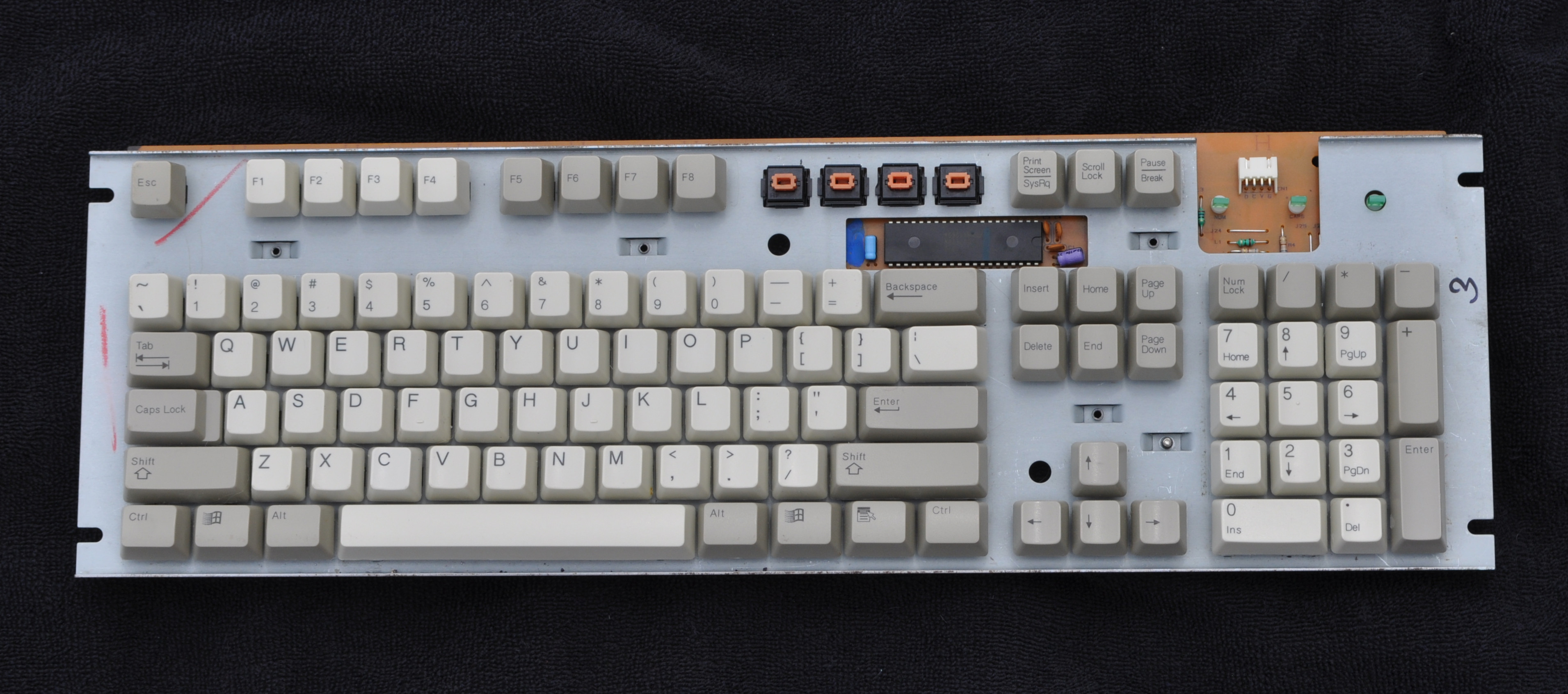

Since I couldn't get the PCB on my Ultra-TP to work properly, I ended up transplanting the good parts from it - a very clean plate, case top, and double-shot keycaps - into an Avant Stellar, along with some NOS blue Alps. Best of all - the programmability features in the Avant still work, and the EEPROM chip now sits inside a DIP socket so it's easy to replace if needed. I think this board will be my daily driver from now on, unless I manage to find a black Avant Stellar by some freaking miracle (then I'll just swap the case and the keycaps). Thanks to Polecat, Karolus and Alectardy98 for their help with this project.
The only things (beside black color, lol) that could make this board better would be a badge from an old Northgate Ultra (the one with a thick transparent overlay) and a case bottom from a Gen 3 Northgate with detachable cable socket.
Another interesting project would be to find a 102P (I know they exist, but I have yet to see one for sale) and outfit it with blue or Amber Alps, a gold badge from an early 102, and a detachable cable. Granted, it would have no dedicated macro buttons, but what a beauty it would be!

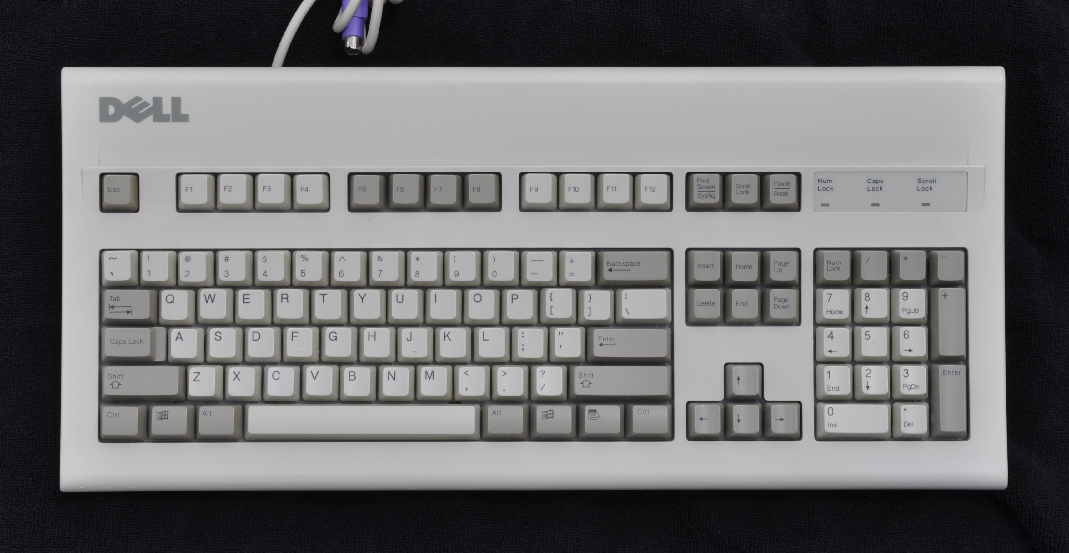

Latest finished project:
Full - Copy.jpg (758.82 KiB) Viewed 35300 times
toprustfree - Copy.jpg (1021.56 KiB) Viewed 35300 times
No retr0bright. No painting. Orange Alps are obviously not original, but they're quite nice in this keyboard's case.

I am going to fit a Dell case with white Alps, just because I think that'd be interesting. I may do something crazier and fit an Apple Extended Keyboard II with whites. PBT keycaps ...

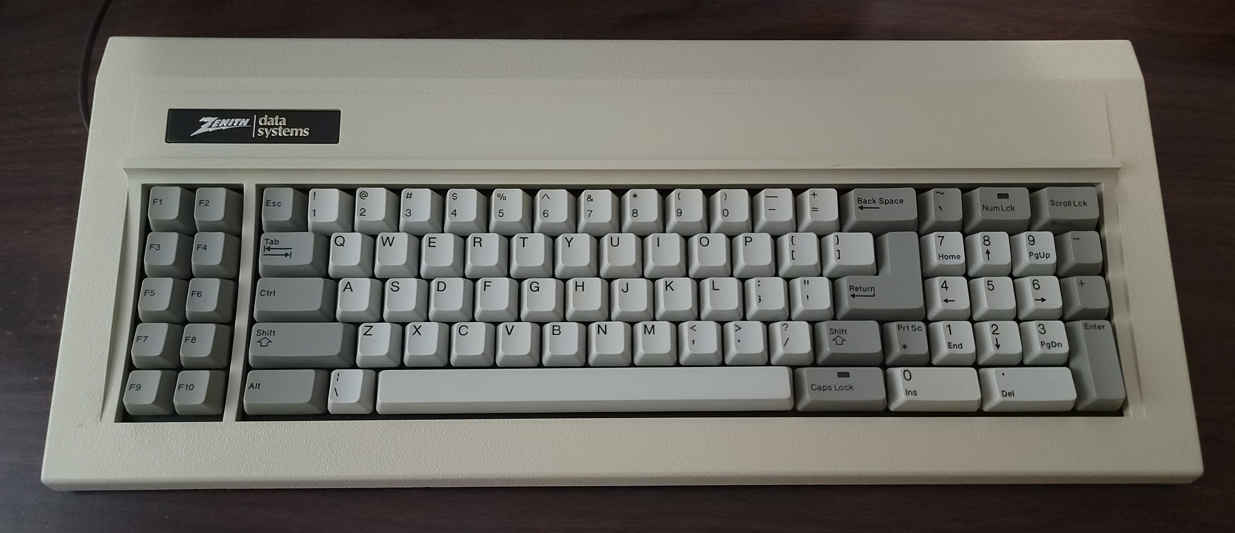

Just got done restoring my z150, and its awesome. :lol: :lol:
I finally got an alps keyboard that I can actually consider using over my model f xt.
Keycaps are all of the double shot abs variety. With green alps.
Lubed the springs, fully cleaned the top housings + sliders, as well as waxing the sliders. I found a very big impovement after the wax was applied, now these feel like brand new, they were in pretty nice condition before hand.
Only thing wrong with it is I notice when I type sometimes keys dont get sent, so I am asuming the switch plates are dying on me.. any suggestions to help revive these? Or should I just replace them?
