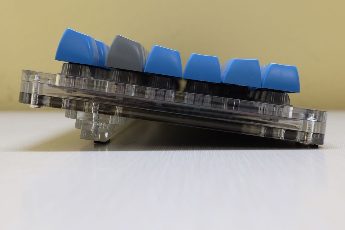

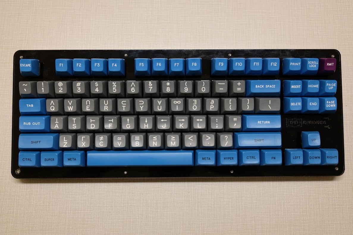

In case you're curious, here is what a clear/acrylic 87-key board looks like with Round 6. Works great!
XMIT169 top view.
XMIT169 top view.
XMIT169 side view.
XMIT169 side view.
