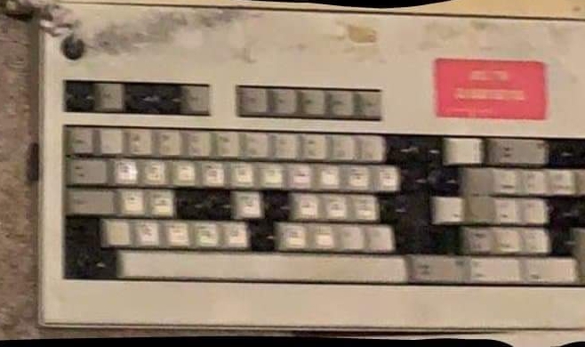

Anyone knows what this one might be?
kelvinhall05
06 Aug 2020, 05:41
Super hard to tell from that pic. Complete guess would be some kind of buckling springs, I dunno.
juspek
06 Aug 2020, 06:30
Picture is so blurry but it looks like it is a keyboard :lol:
Seriously though, this Televideo PC keyboard looks same http://www.retrotechnology.com/aux/televid_dos.html

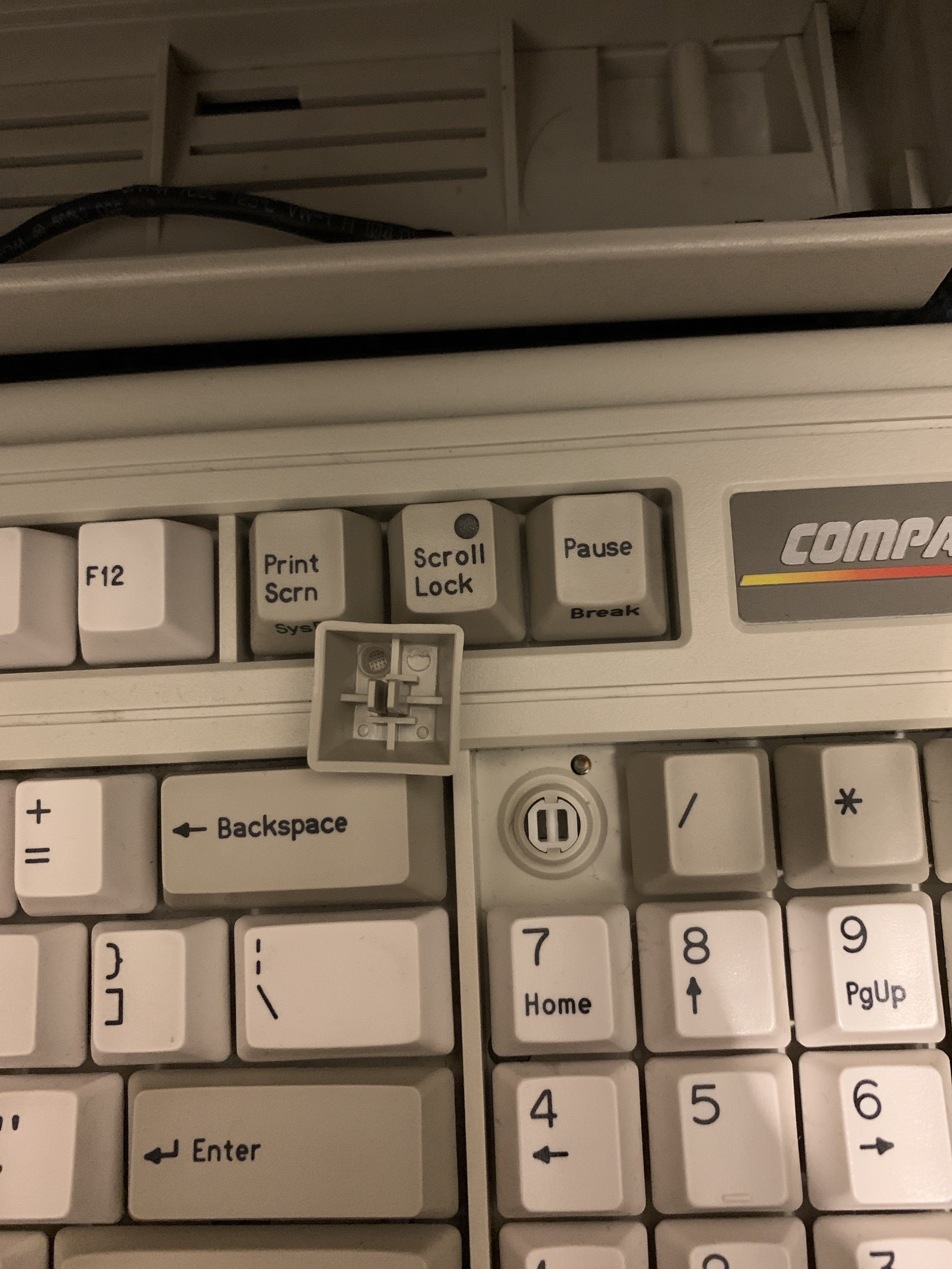

CapnCrunch53
15 Aug 2020, 20:33
Anybody know what type of switch this is, from a Compaq Portable III? Some type of dome with slider I assume?
hellothere
15 Aug 2020, 23:35
While I'm also going to vote slider with dome, I just took a quick Internet Expedition and found out that these also came with foam & foil or Alps.

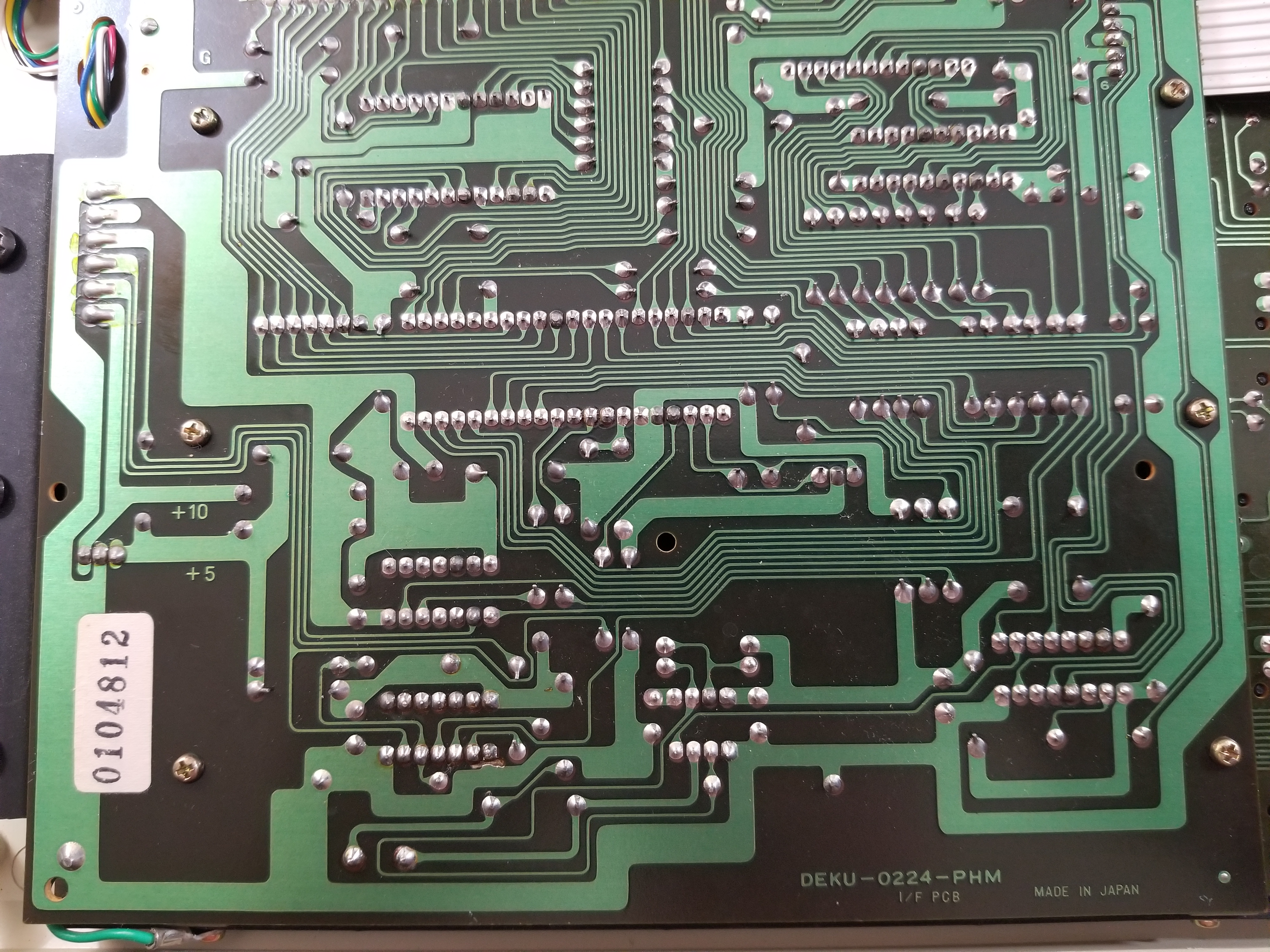

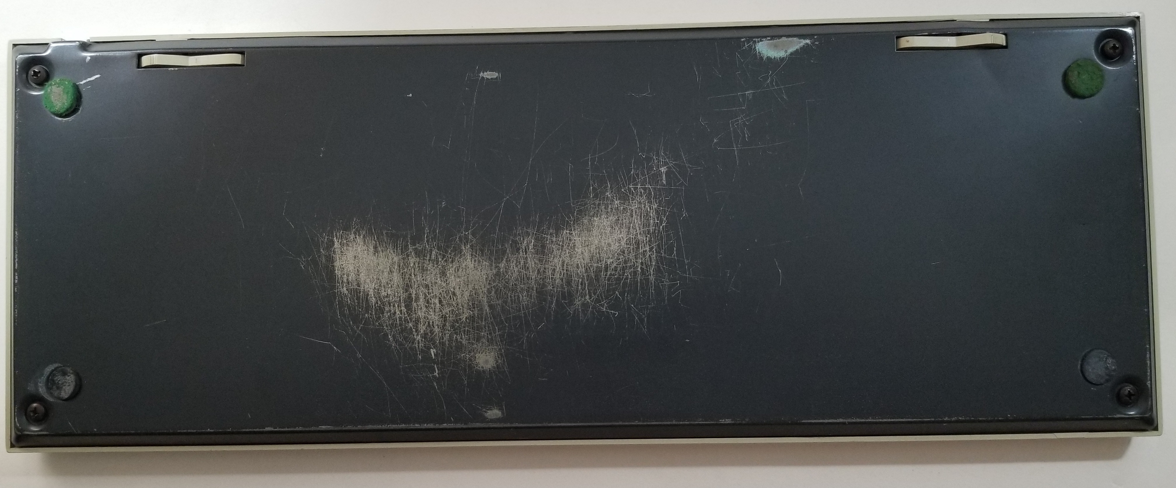

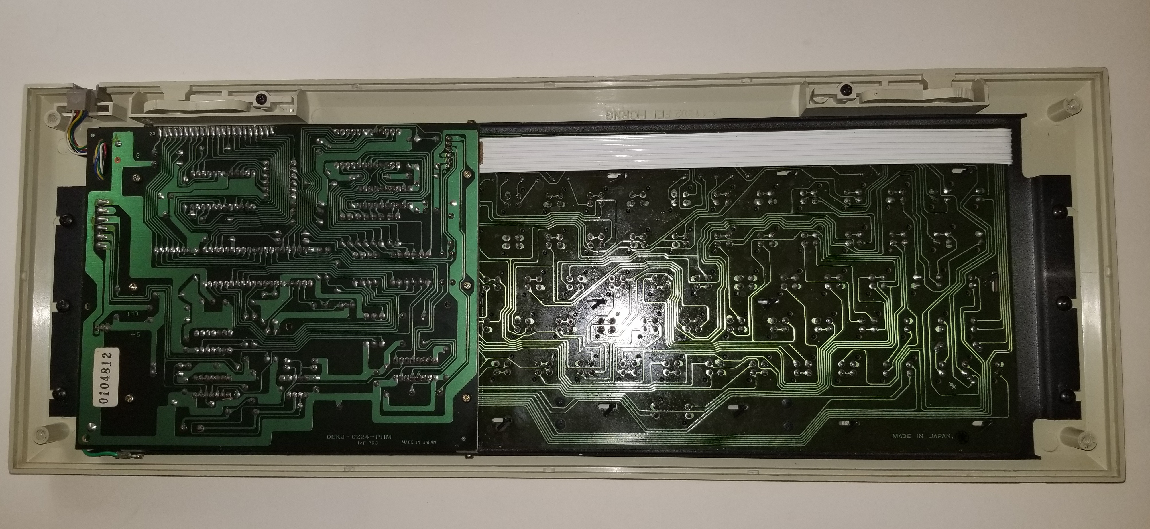

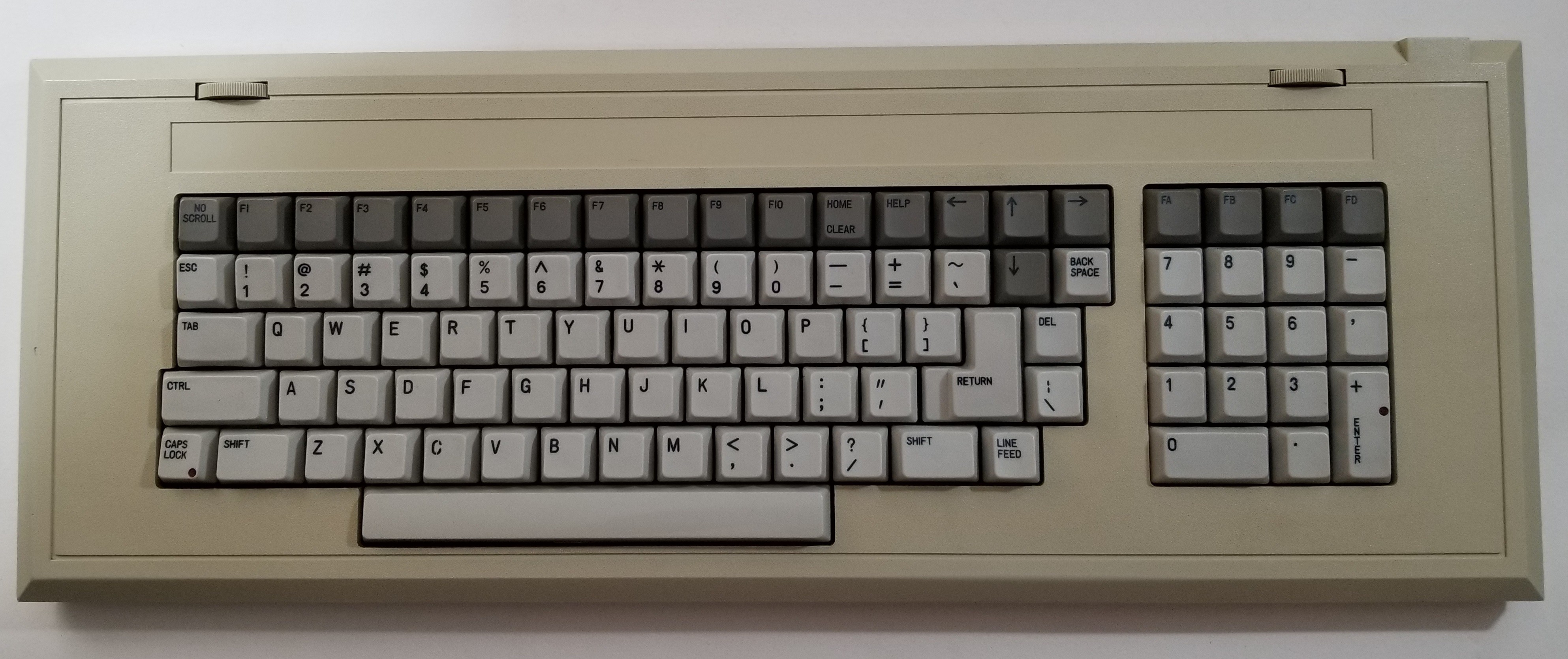

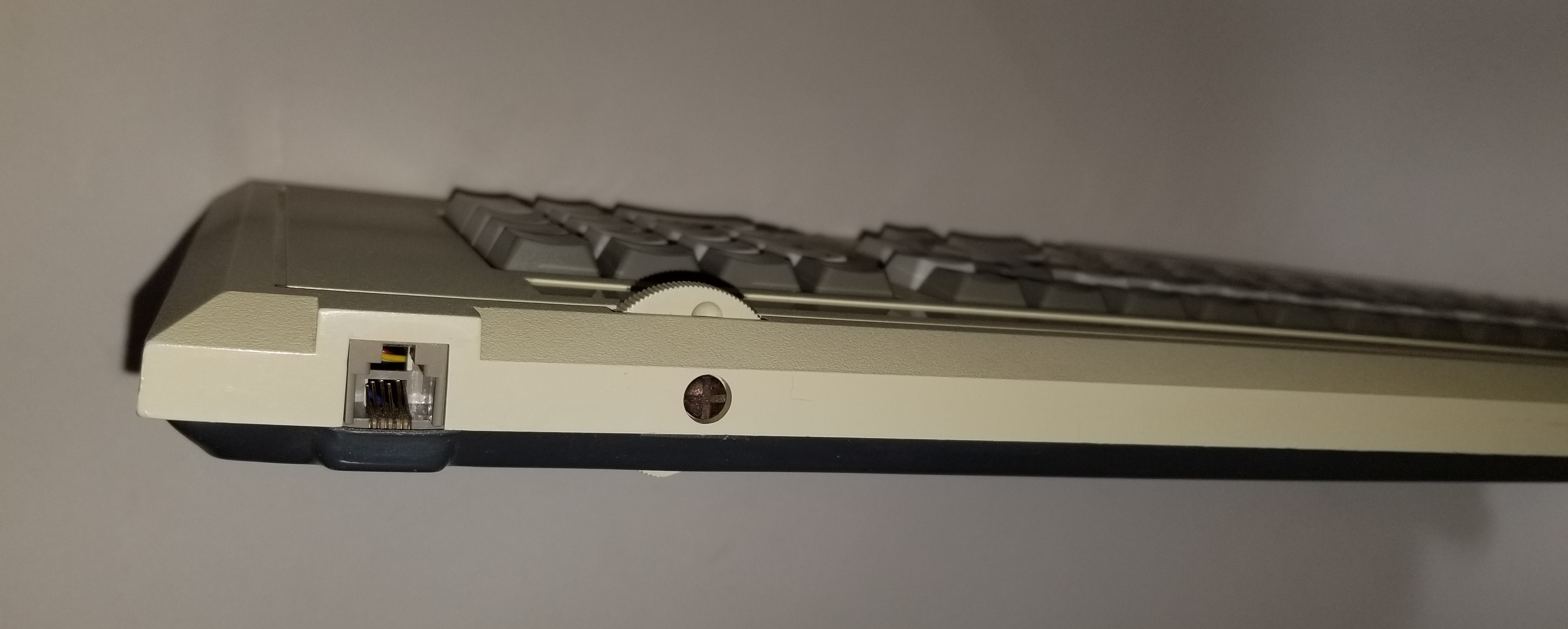

Can someone identify this keyboard?
1 (2).jpg (1.59 MiB) Viewed 12279 times
0 (1).jpg (1.35 MiB) Viewed 12279 times
hellothere
20 Aug 2020, 21:00
@josh68 http://vintagecomputer.ca/morrow-md-3p- ... e-computer. Still looking for switch type. I like the dials.
Nope. Nothing easily findable. A couple examples here had tall cream Alps.

20 Aug 2020, 22:14
The layout looks a lot like some zenith/heath terminal keyboards that AFAIK only cane in skcc and skcl. I don't think it would be skff as the caps look newer than that switch range was ever paired with. The LED positions and lack of alps branding on the PCB is also an indicator that it is something else.
juspek
21 Aug 2020, 22:21
Here is a picture of Morrow Systems computer with similar keyboard: https://deramp.com/downloads/mfe_archiv ... _color.jpg
josh68
22 Aug 2020, 01:22
Fantastic. Great info from everyone. I very much appreciate it all.
