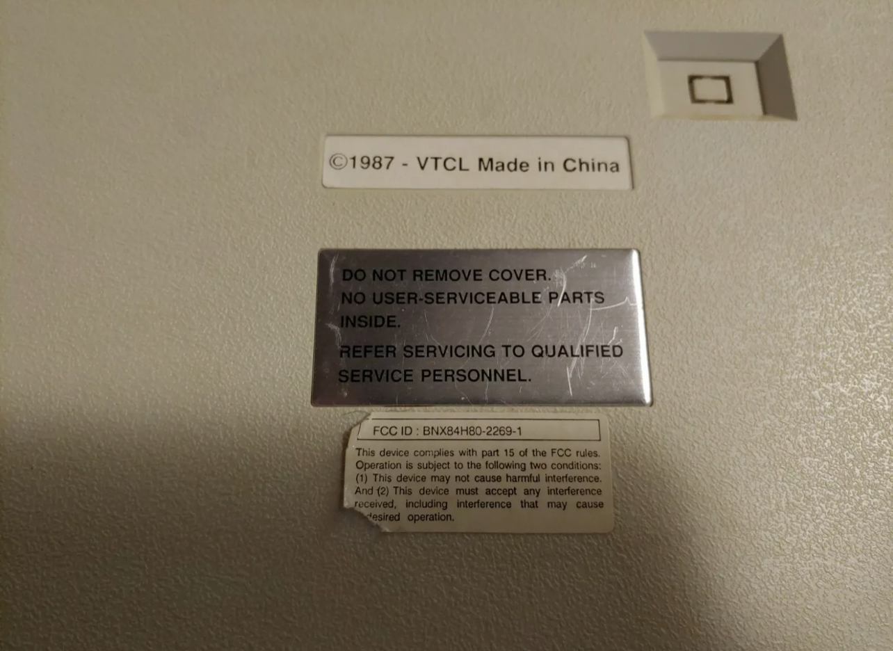

MMcM wrote: 05 Sep 2021, 16:48
ExZKV wrote: 05 Sep 2021, 16:34 Please help me to identify my keyboard.
VG-920.
Explains the pinout. 4800 baud TTL serial.
Now that's a really complete answer to a question. Very cool.
Mmmmm. Old Topre goodness.
ExZKV
05 Sep 2021, 18:05
VG-920.
WOW!
It`s a miracle! Thank you very much!
ExZKV
05 Sep 2021, 20:08
it`s real to connect this keyboard to a modern pc? may be use some converter?
MMcM
06 Sep 2021, 00:08
ExZKV wrote: 05 Sep 2021, 20:08 it`s real to connect this keyboard to a modern pc? may be use some converter?
How easy this will be depends on what the serial signals are. There are a number of possibilities:
  • ASCII characters -- this makes it very hard to turn into a modern keyboard
  • ASCII characters plus separate indication of shift state -- this is marginally better, but still not great
  • key codes for key press and key release -- this is ideal and allows working as a modern keyboard with arbitrary mapping
  • key codes for key press only with shifts included or key release for shifts only -- this works for regular typing, but makes some games harder and doesn't really allow for changing which keys are shift (including adding more shifts if Ctrl, Shift, and Compose isn't enough)
Based on page 5-44's mention of key code, init code, and status code, I would be hopeful that it is not just ASCII, which means something is possible. But the only way to tell is to hook up an oscilloscope, logic analyzer, or microcontroller to the serial line and see what shows up.
And, yes, a converter is needed, to read from the serial input (and write to serial output to set LEDs and beep). An ATMega32U4, like a Pro Micro or a Teensy, is well-suited to this task, as it has built-in USB support. A framework like TMK or QMK is best for controlling the mapping, once the raw decoding has been done. Arduino also works, and is sometimes useful while working through the decoding. There are a number of examples and people here in the Workshop board are probably willing to help.

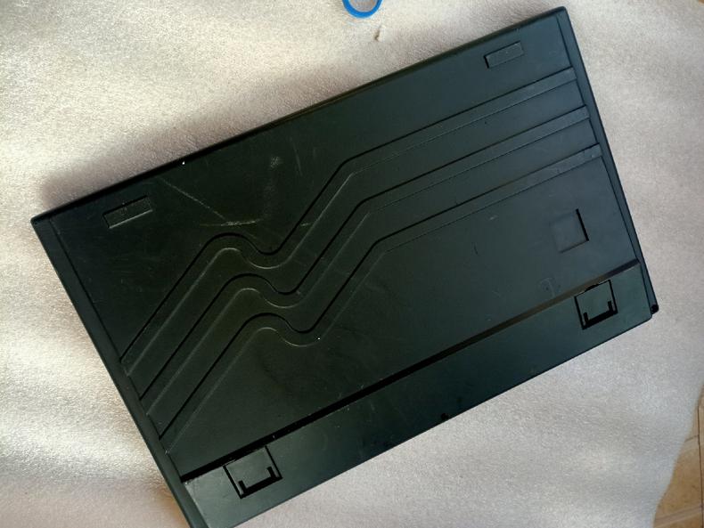

what keyboars is it according to you? also what type of keys ?
06 Sep 2021, 13:35
It looks like a variant of the BTC 51 series with the 1.25u Escape key and the grey "ISO key" next to the left Shift key — I have only seen BTC keyboards have that.
Edit: Some BTC-made Packard Bell keyboards have a similar case.

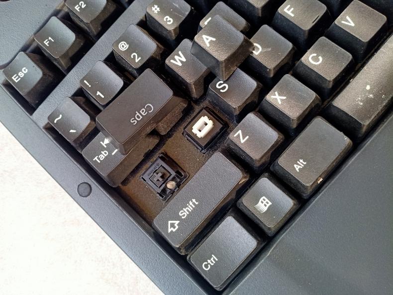

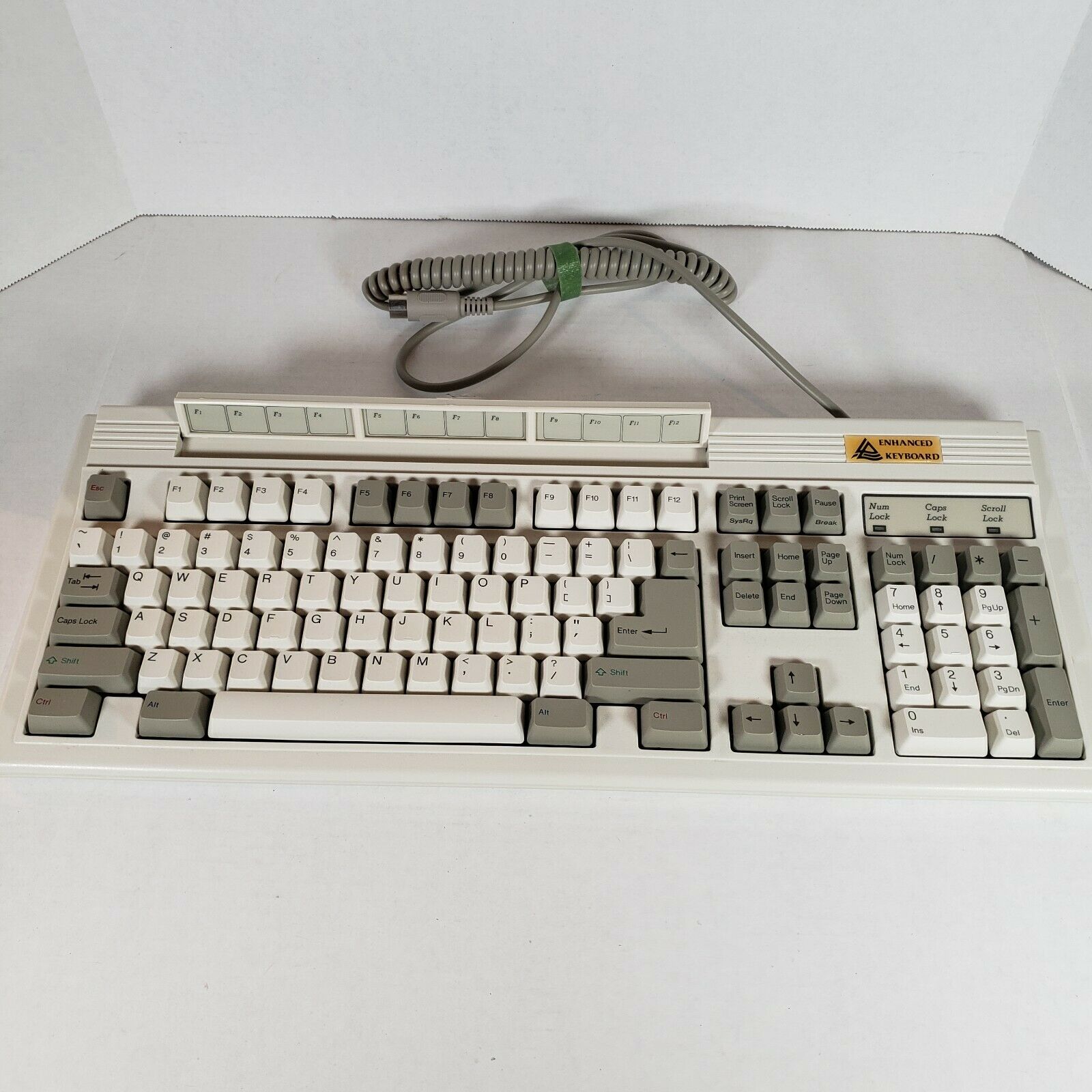

From a recent eBay listing. Manufacturer is “Video Technologies”.
The nav cluster and blank keys in the bottom row make it slightly more interesting than run-of-the mill boards.
Does anyone know what this is, what switches it uses? (I assume it’s very cheaply made.)

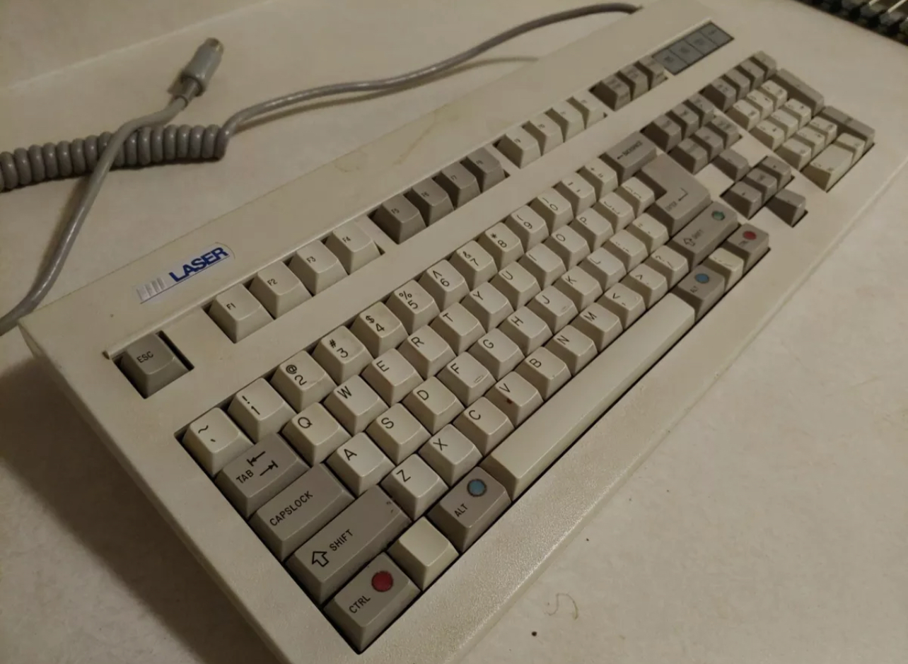

zrrion
06 Sep 2021, 19:02
that's a laser board with SMK 2nd gen MX mount clickies. They're nice enough switches and caps but the build of the rest of the board leaves a lot to be desired

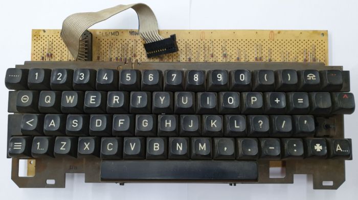

Lalaland124 wrote: 14 Aug 2021, 13:20 Supposed to be an old Siemens keyboard. Any guess on use-case and switches?
Did you get any more info on this keyboard?
I found a similar looking one, but with some extra keys top right.

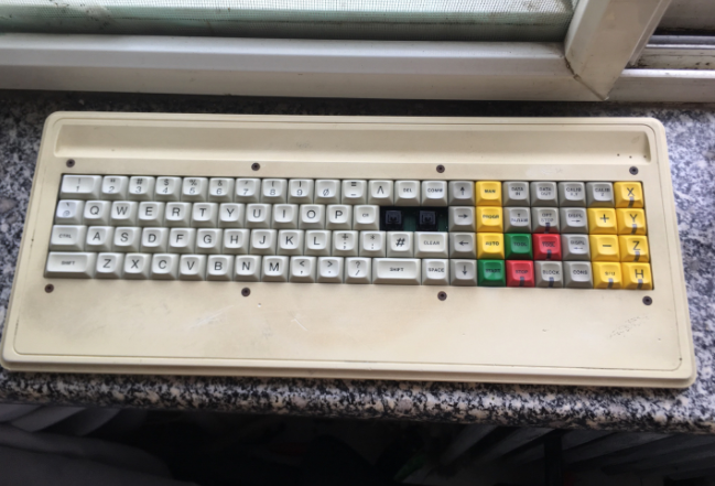

One more keyboard, strange layout with a 1u space and a lot of windowed keycaps in a interesting profile - appreciate any info about this one, and thanks in advance!
Lalaland124
15 Sep 2021, 10:28
jejex wrote: 14 Sep 2021, 01:56 One more keyboard, strange layout with a 1u space and a lot of windowed keycaps in a interesting profile - appreciate any info about this one, and thanks in advance! unknown.png
Those keycaps are gorgeous! What kind of connector does it have? Reminds me of old video editing terminals

JannievanZyl wrote: 13 Sep 2021, 15:53
Unfortunately not :?

Lalaland124 wrote: 15 Sep 2021, 10:29
That's a Siemens T1000 teletypewriter keyboard. We had a similar one rather early in this thread, which I replied to.
Another one had its own thread, and another thread describes another family of keyboards with that switch and the switch itself, for which there is a wiki entry, too.
jejex
15 Sep 2021, 20:03
No clue on the connector, bought this on a Chinese second-hand website, paid approx $5, and has MX blacks or some clones. The keycaps are doubleshot, and absolutely great, unfortunately there's 2 missing, but I'm going to use them in my ortho build.
EDIT: I think I've found it: Sieb & Meyer 45.01.04.3 and it looks it's a keyboard from a German CNC machine control panel, with a presumably homemade case. Sadly, this didn't get me much info, as it is pretty much undocumented. As always, thanks for your help and have a great day!

OleVoip wrote: 15 Sep 2021, 14:08
Thanks, I've looked at a lot of site and photos of various T1000's but I've not yet seen one with the two extra red keys you see top right on the one I found.

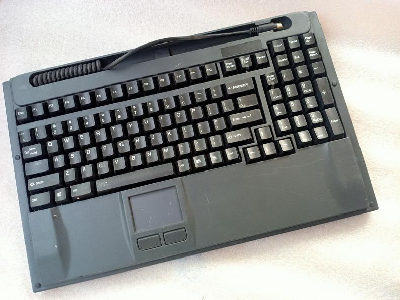

june bug
22 Sep 2021, 05:56
hey y'all, does anyone recognize this keyboard? there was no information on the pcb that i could see
Polecat
22 Sep 2021, 06:14
Terminal board of some sort, sorry I can't tell you which model. Keytronics foam and foil, good looking keyboard, but not a very desirable feel for most of us.

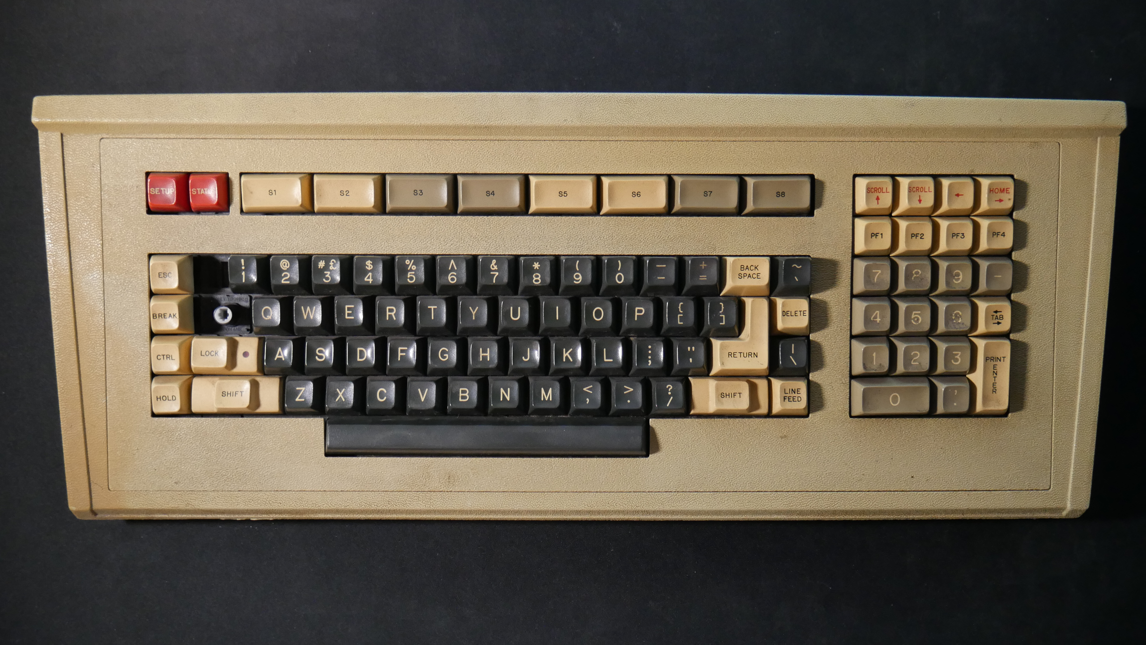

Has anyone seen an Ericsson keyboard like this before?
https://www.ebay.com/itm/Ericsson-Keybo ... 637-2357-0
Those orange key caps and the bezels are so beautiful

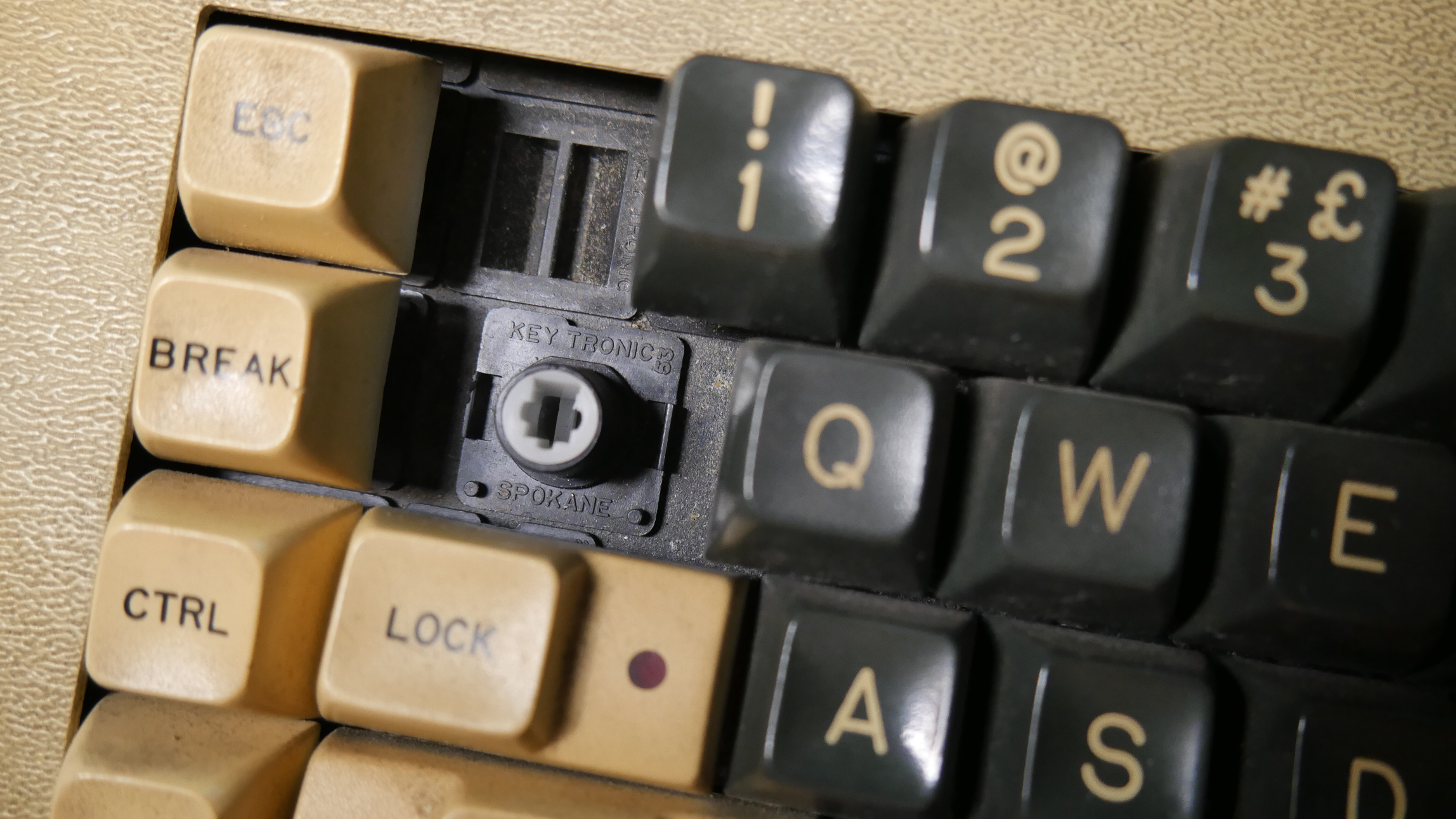

Polecat
24 Sep 2021, 06:17

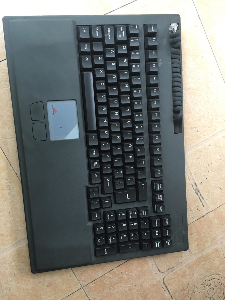

Weird Focus-ish keyboard. No photos or info on the switches, anyone know this one?
https://www.ebay.com/itm/384410414027
june bug
24 Sep 2021, 06:43
i think it's a Rin-Teck RT-1000 board minus the Chinese legends

Polecat wrote: 24 Sep 2021, 06:17 Weird Focus-ish keyboard. No photos or info on the switches, anyone know this one?
I had that on my watch list for a few days. Seems way too expensive for a standard Focus board with SMK switches.
Polecat
24 Sep 2021, 17:26
june bug wrote: 24 Sep 2021, 06:43 i think it's a Rin-Teck RT-1000 board minus the Chinese legends
link
That's definitely it, thanks! I tried searching the forums and looked in the wiki, but it's not listed in the index of keyboards by brand for some reason. Not the first time that has happened either.

Lucid wrote: 23 Sep 2021, 01:48 Has anyone seen an Ericsson keyboard like this before?
Very nice looking KB!
