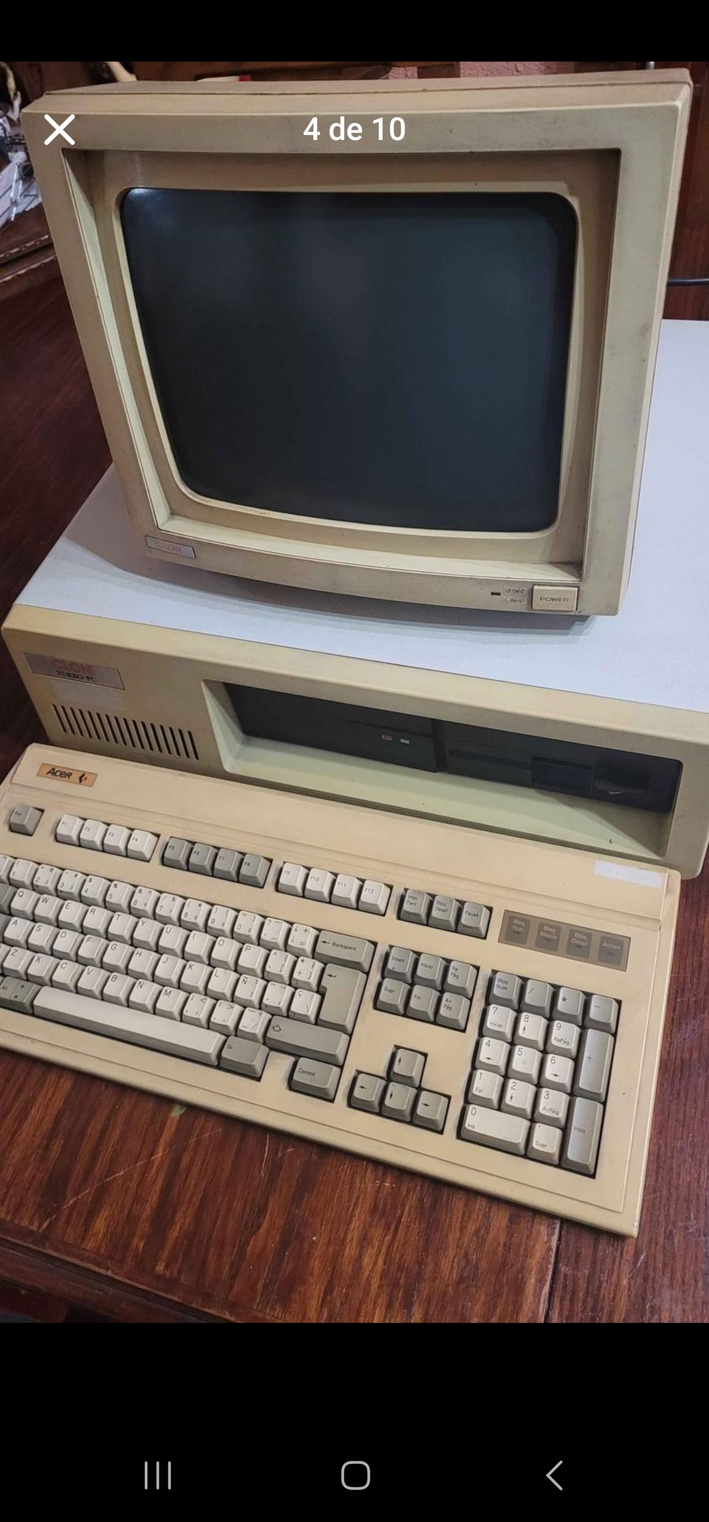

Just spotted this fella on Facebook marketplace, does anyone recognize the computer or if there is any way to confirm the model? I've read that kb-101s and 6010s are pretty much identical

I think the label says "CLONE" in red letters with the N and E being a ligature.Leshe wrote: 27 Oct 2024, 22:52 does anyone recognize the computer or if there is any way to confirm the model?
The text below that is harder to see, but I read it as "TUENG PC".
The thing to look for is an IBM PC clone case that has the label in the exact same position and size. Apparently, that variety is not too common.
- Polecat
"Turbo PC". Generic term, probably just meant the motherboard had a 6 MHz or 8MHz mode, instead of the base 4,77. Might not be branded at all. Many XT clones were built from generic parts, either by the dealer or owner.
Keyboard could be a KB-102A or KB-102AS, or 6012 (all Alps), or a 6312 or 6512 (Acer slider-over-something). Upper cases were interchangeable. Need to see the label.
edited to correct 101A/101AS to 102A/102AS
Findecanor wrote: 27 Oct 2024, 23:04I think the label says "CLONE" in red letters with the N and E being a ligature.Leshe wrote: 27 Oct 2024, 22:52 does anyone recognize the computer or if there is any way to confirm the model?

Label says Clone Turbo PC. At least they're pretty straight forward with admitting they're a clone! But yes, one of many PC XT clones of the time. Acer has nothing to do with it, just happened to find its way to being paired with this system. As always, if it can come with blue alps, don't be surprised if it actually has white alps.

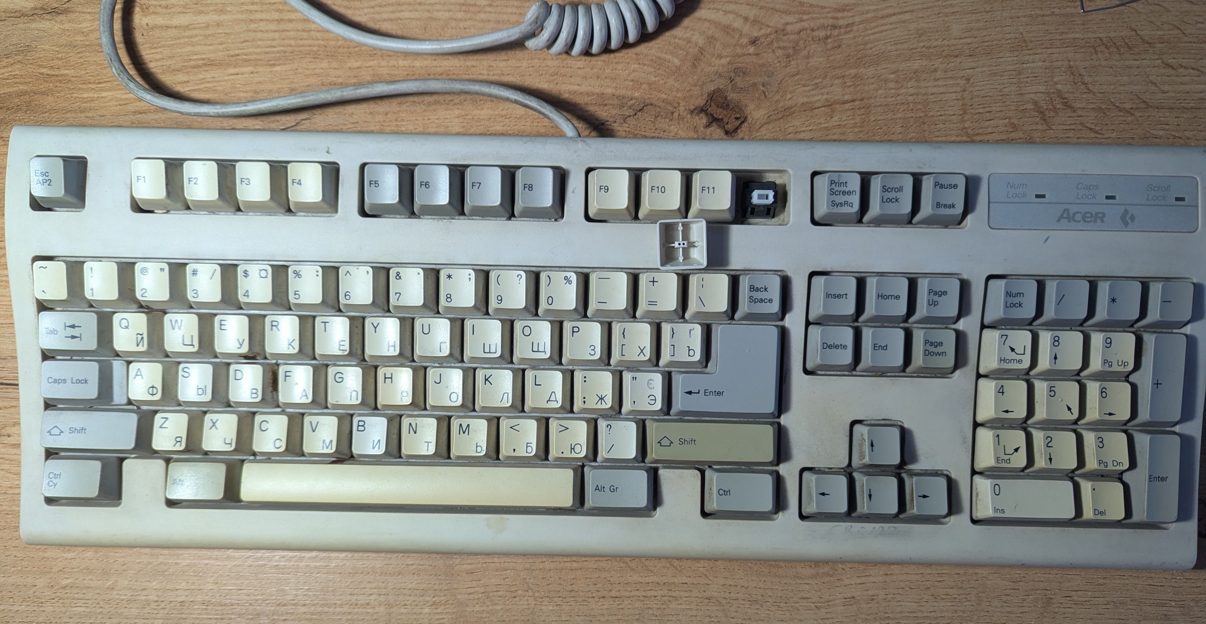

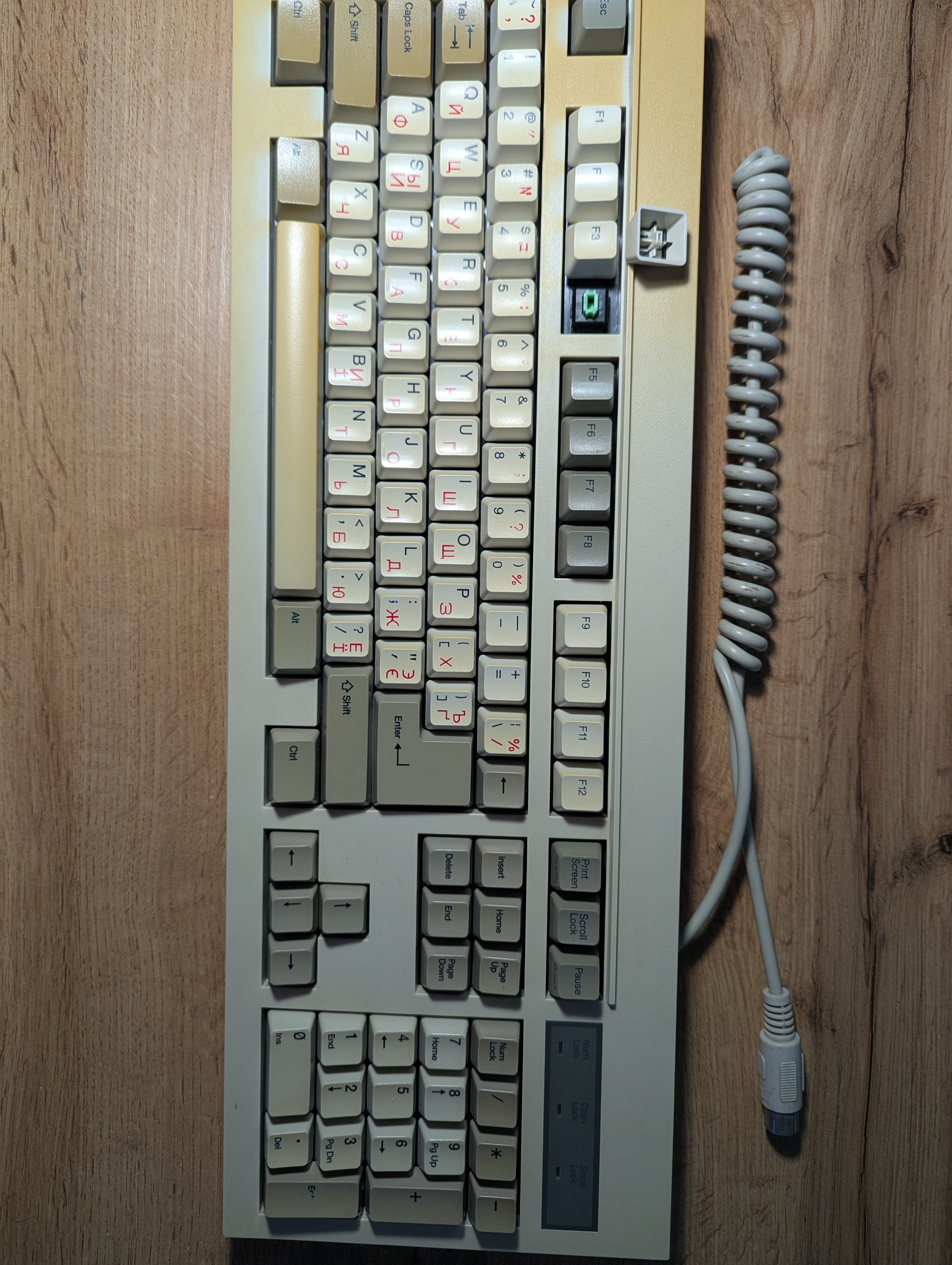

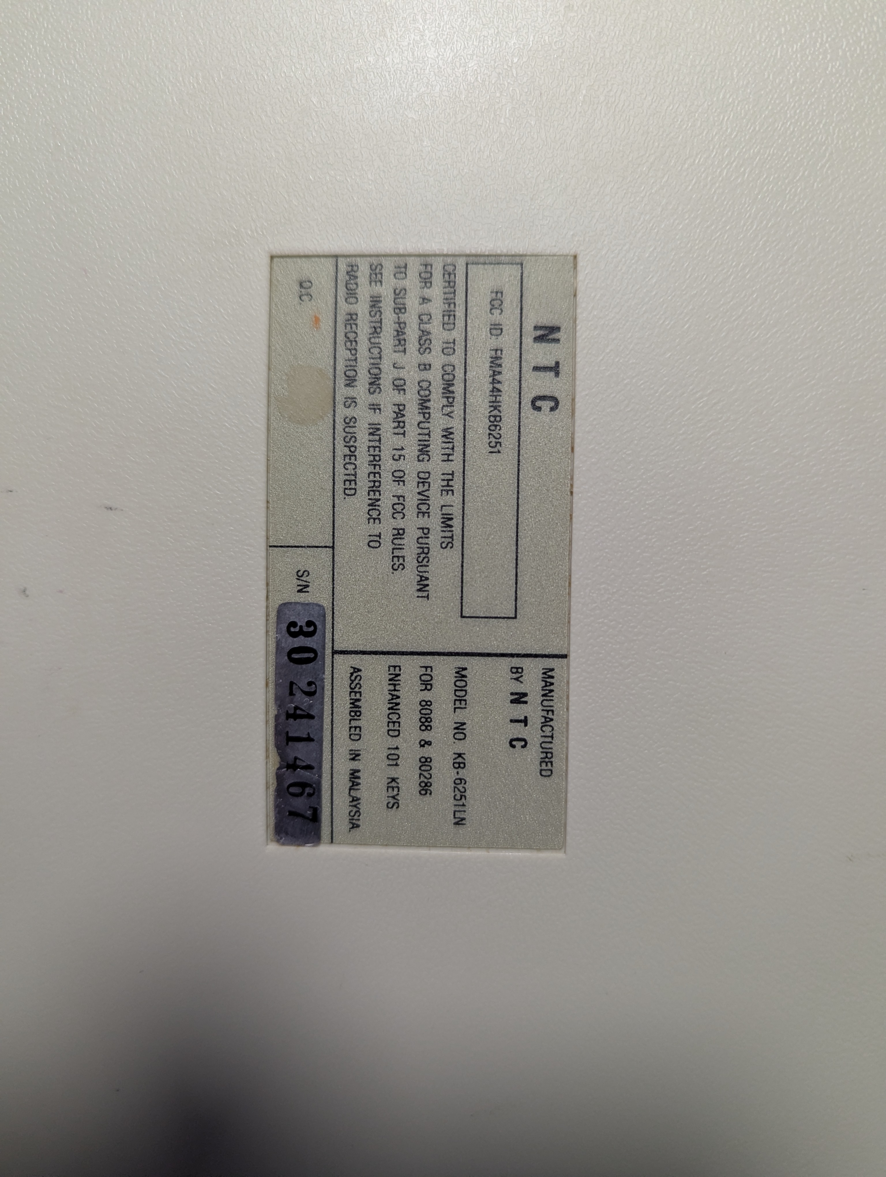

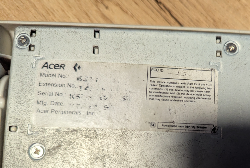

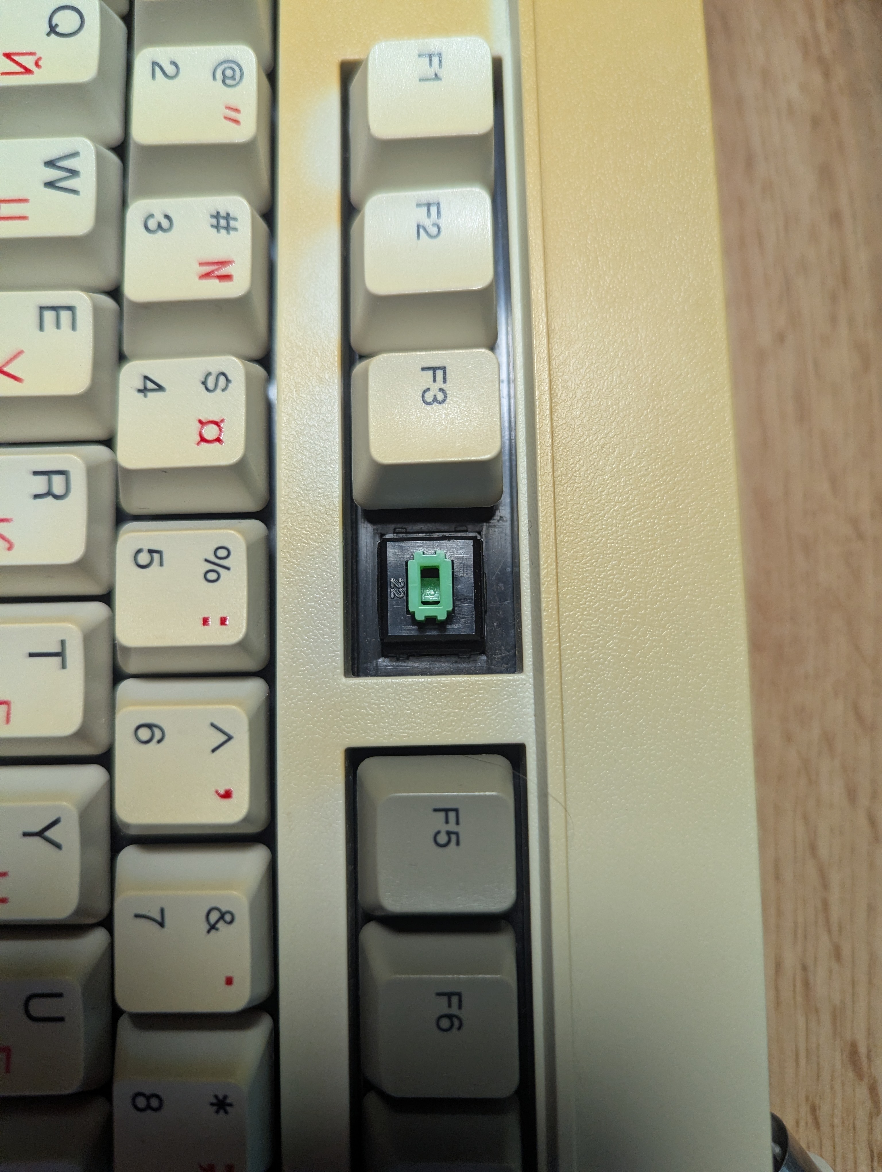

I was having my laptop repasted at this place, and when they returned the computer, funnily enough, the keyboard was not working. So I brought it back, and while they were at it, reconnecting it, they let me dig in the discard pile. I pulled 2 boards out of there.
What is this Acer? The name on the back is not readable, but I think it starts with 53. I might be wrong, though. It has a metal bottom and 2 sets of feet. It says 1991 on the sticker. The top of the switch housing has Acer written on it, and 3X at the bottom. The connector is PS2. There was also this NTC KB-6251LN
FCC ID FMA44HKB6251
Could this actually be Alps? I don't believe it. It's too good to be true. Some clones, maybe?
FCC ID FMA44HKB6251
