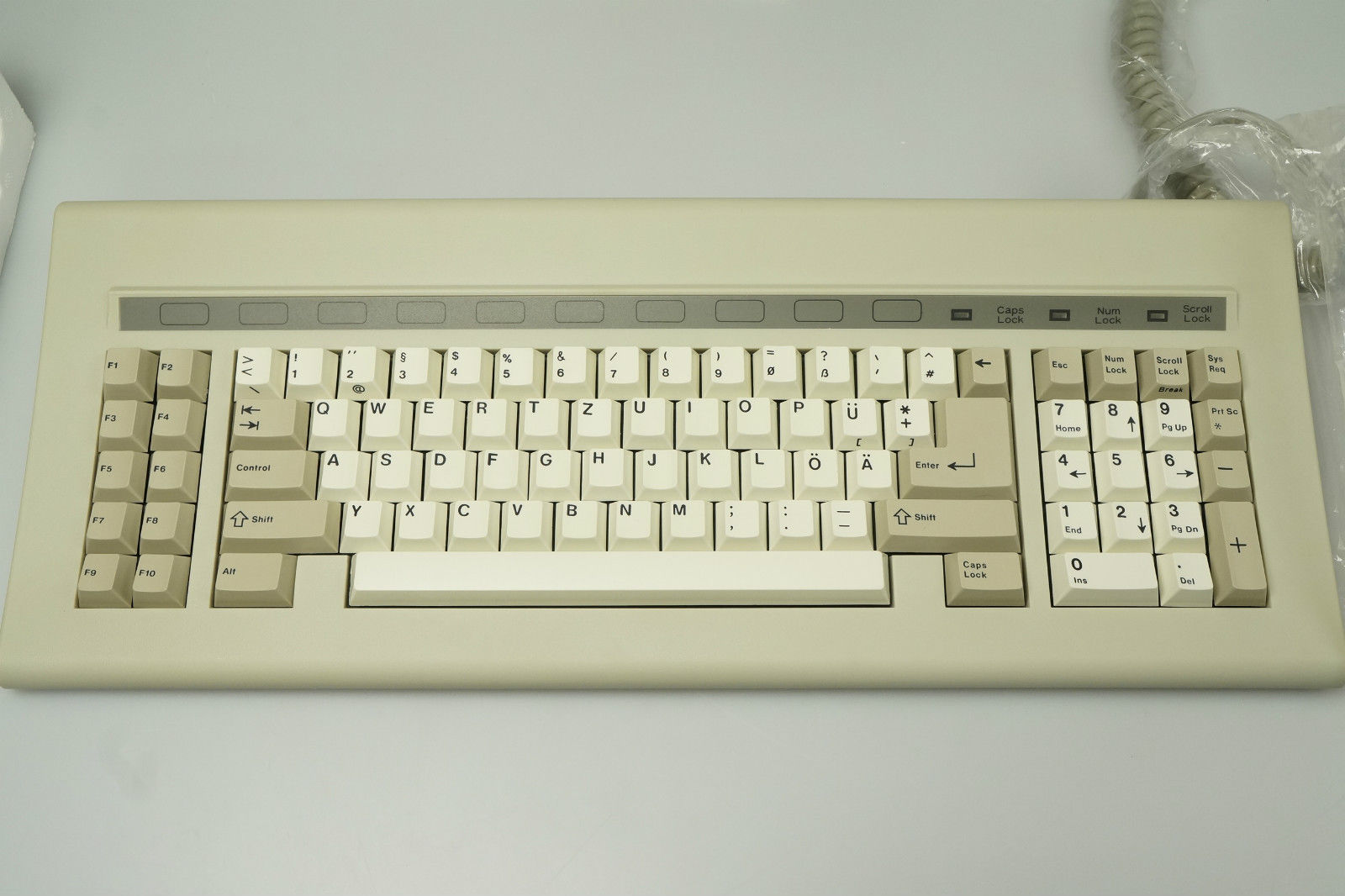

Does anyone know something about this board? HAL KB2100, used with a HAL CT2100 Communication Terminal, can't find any info about the board itself tho

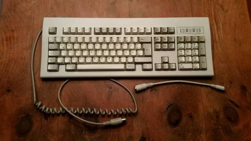

acinho
05 May 2016, 21:31
Anybody ever heard of a Lion keyboards?
Case looks like a Cherry.
guk
1896 Vintage Reds
05 May 2016, 21:44
Pic not working for me, but all of the Lion branded Cherrys I've seen were G83 (3000/6000).
Terry, I think Ohaimark is correct. That looks like a Chicony RD. Unless there is a second keyboard, can only see one pic.
05 May 2016, 21:46
acinho, you need to provide an actual image URL in the img tags, not a URL to a webpage with an image on it.
Scooped F and J, so either doubleshot or dyesub. The difference in yellowing on the spacebar and positioning on some of the letters makes me think more likely to be dyesub.

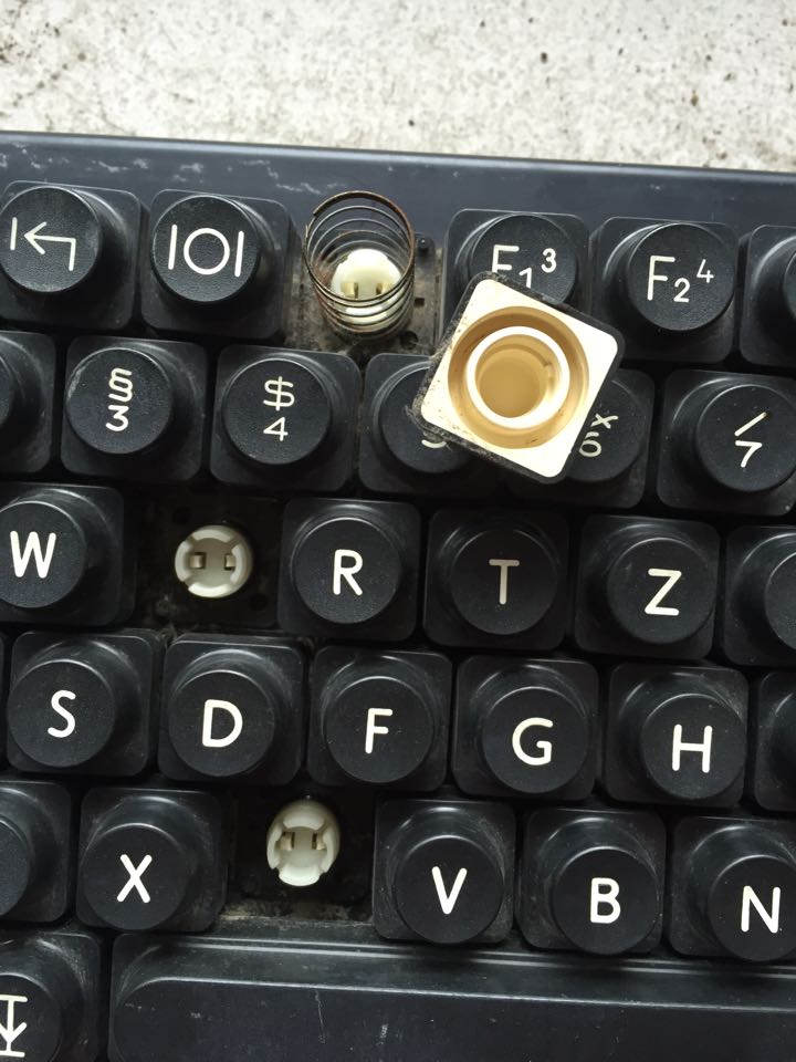

So I found this thing. I have absolutely no idea what it is. Hopefully someone does.
Switches are linear and pretty scratchy. I didn't see any identifying marks on them. The key caps are somewhat spherical and engraved. Recently thick. Tried fitting them on cherry switches, but no dice. The thing does power on, but I didn't really want to leave it on for long.
07 May 2016, 05:08
Maxi Switch vintage linear. Most vintage cross mount caps are not MX-compatible, so that makes sense.

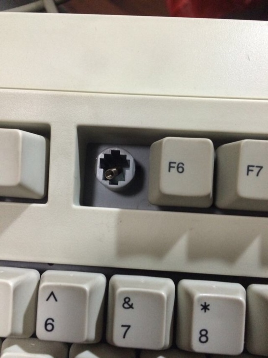

I found some new switch on these month. That's the one I can't identify. I think I saw it before I took it.

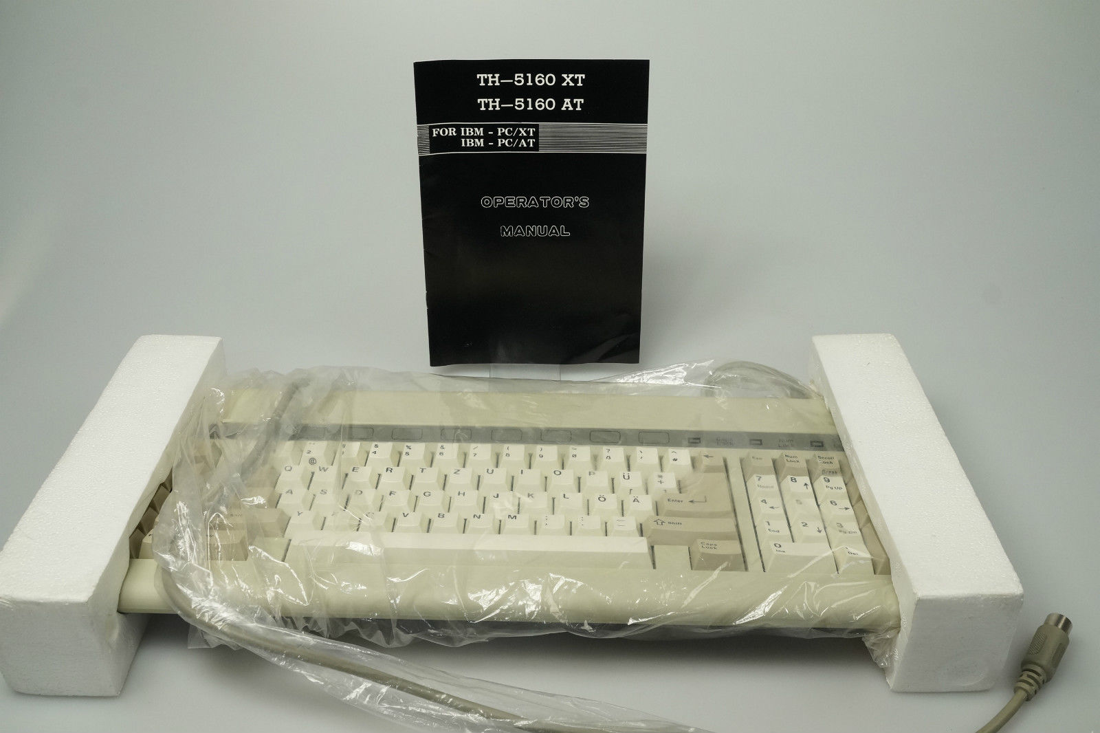

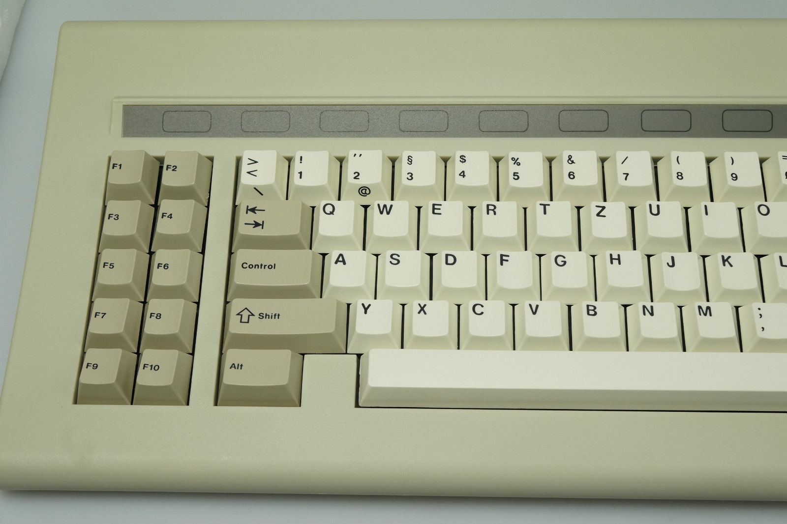

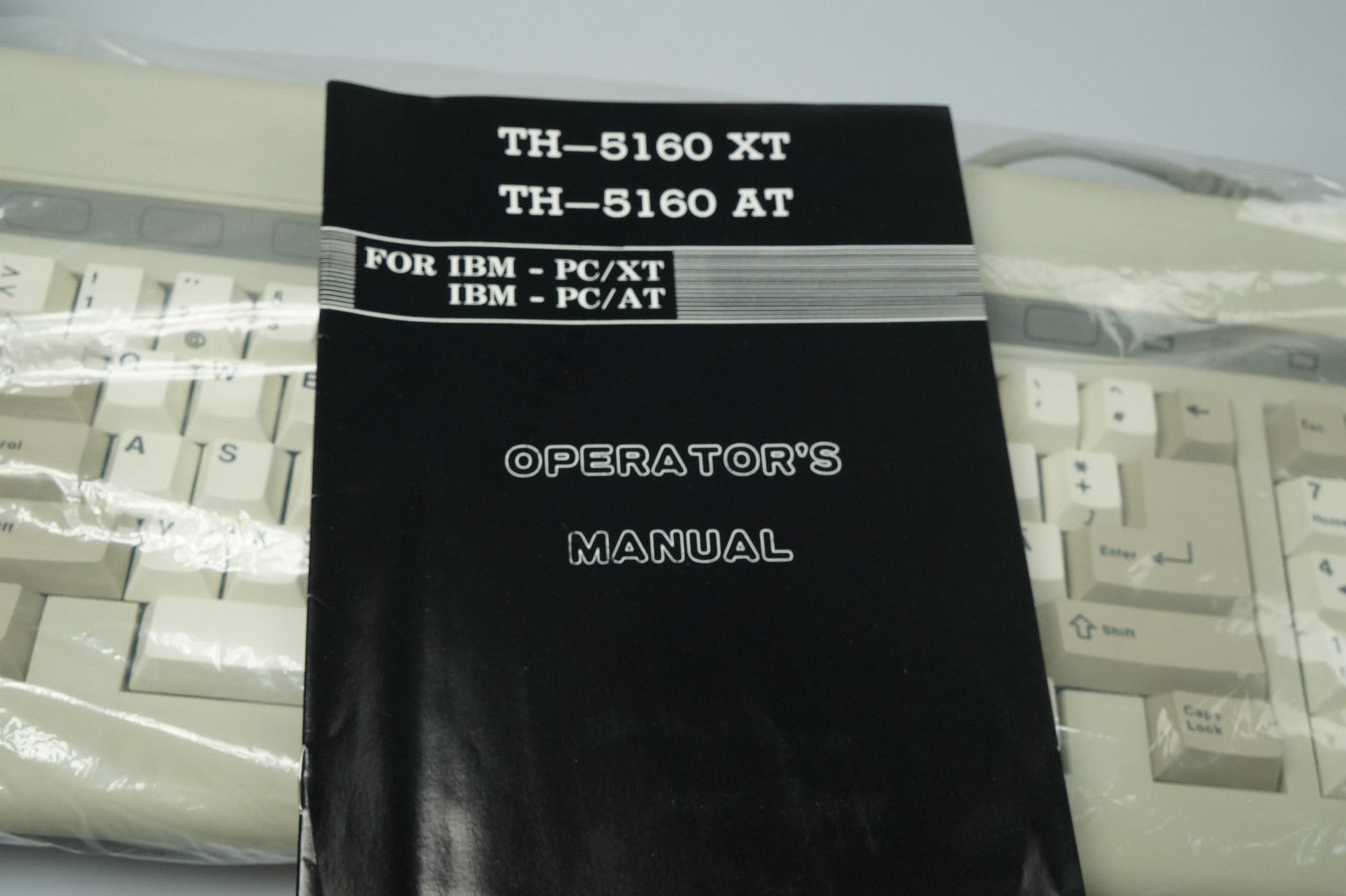

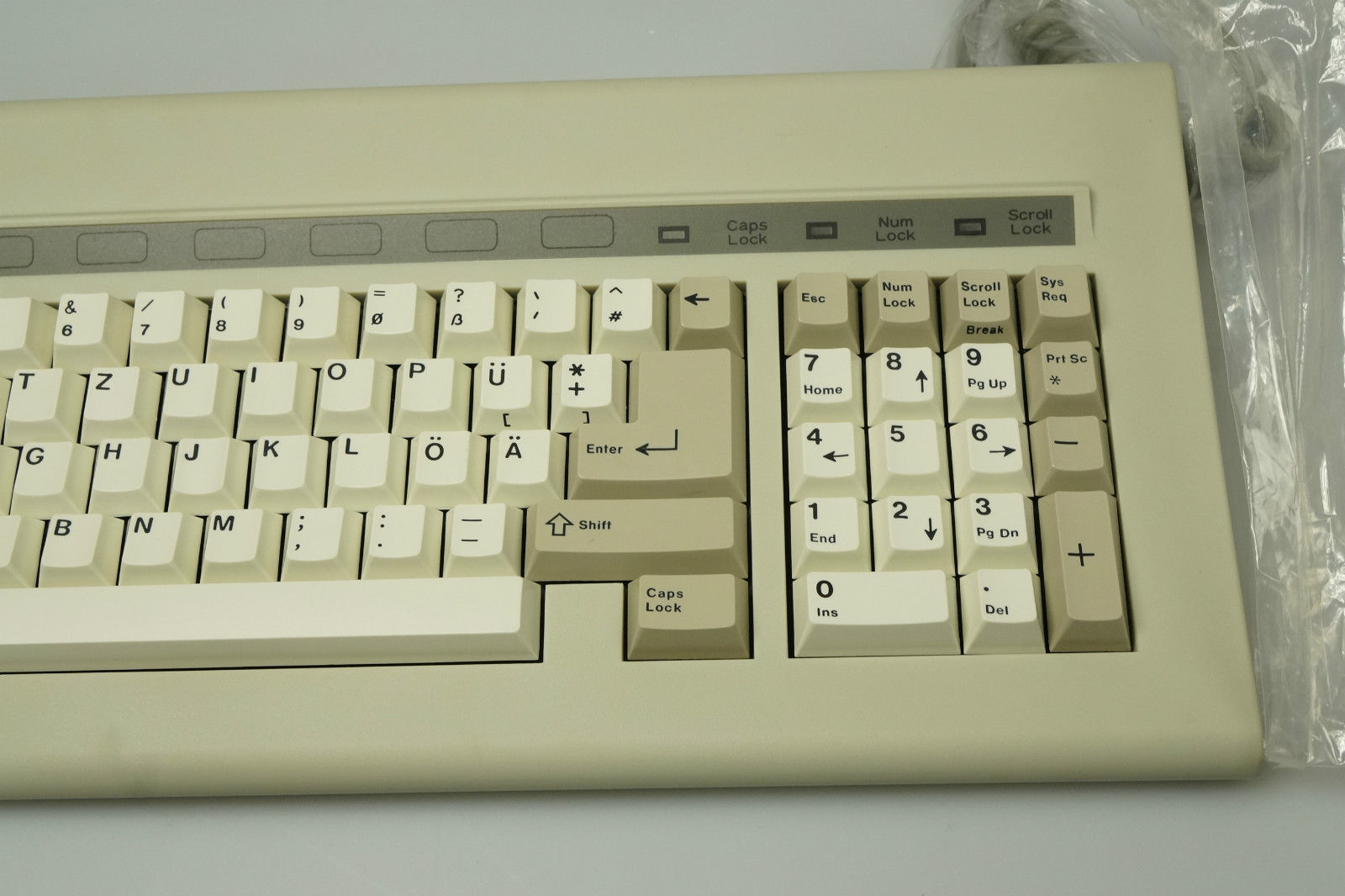

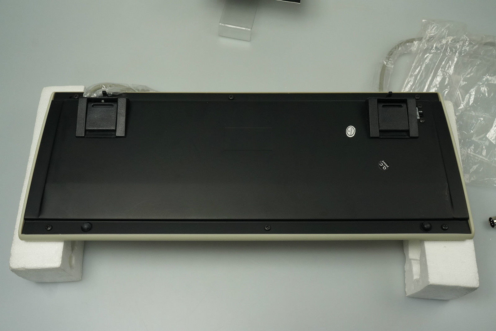

Hi guys. This is my first post on the forum and in it I'd like to go back to the discussion you had on the previous page about Focus keyboards. I managed to acquire an old keyboard with Alps SKCM Blue switches. On the back of the PCB it says Focus FK-727/747, so I guess it's one of these or some Focus made OEM. Here is some more info with pictures:
Polish layout. That "17" in the top left corner is a sticker. Must have been there since new, because the plastic underneath is perfectly white :)
Complicated blue Alps and double-shot caps.
Metal, black painted bottom. Unfortunately, someone removed the main sticker. There is a XT/AT switch in the top right corner.
TEI Remex (top sticker) is most probably the original owner of the keyboard.
Top housing and some caps removed. Filthy.
Controller chip.
Bottom of the PCB — the main source of information.
Focus FK-727/747.
Any ideas? Is this an FK-727, 747, some type of Chicony KB-5160 or sth else?
24 May 2016, 17:04
Ooooh, so nice. I love Polish typist layout, but this is even cooler: Polish programmer with typist second legends! Where did you get it, Allegro?
Edit: and welcome to DT! :D
24 May 2016, 17:26
I'm still not sure what the difference between the 747 and 727 is, but it's definitely one of those, yeah xD . They're beautiful boards, Focus really had a way of making great lookers. And of course with blue Alps, what's not to love? :D Very nice find indeed!

Chyros wrote: I'm still not sure what the difference between the 747 and 727 is, but it's definitely one of those, yeah xD . They're beautiful boards, Focus really had a way of making great lookers. And of course with blue Alps, what's not to love? :D Very nice find indeed!
Could the stepped Alt, Caps Lock and Ctrl be any clue? Pictures of the Focus FK-747 boards I found didn't seem to have them.
Yeah you might be right, good spot :) .

norolim wrote: Hi guys. This is my first post on the forum and in it I'd like to go back to the discussion you had on the previous page about Focus keyboards. I managed to acquire an old keyboard with Alps SKCM Blue switches. On the back of the PCB it says Focus FK-727/747, so I guess it's one of these or some Focus made OEM. Here is some more info with pictures:
Just what I said it's Alps SKCM Blue.
The [AT][US]Chicony KB-5160 series(FCCID E8H5IKKB-5160AT) keyboard with Alps SKCM Blue at least have three different keyboard.(small difference on the front and back case)
Your's keyboard is TH-5160(Type1).
