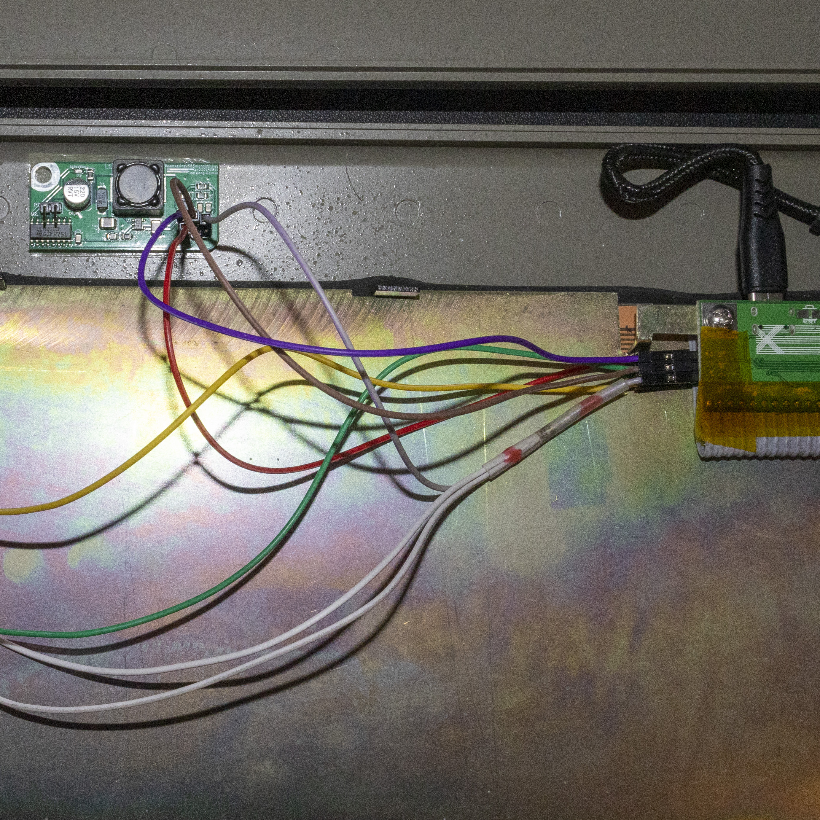

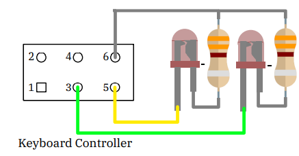

Ellipse wrote: 18 Jan 2021, 18:06 darkcruix would you mind sharing a Bill of Materials for your LED mod? I think it may interest some new Model F owners.
It really depends on the configuration. In my case I have a solenoid and two LEDs connected. How to connect the cables is described in my technical reference manual here: https://www.bucklingspring.com/technica ... downloads/ on page 4-97 (191) and the following.

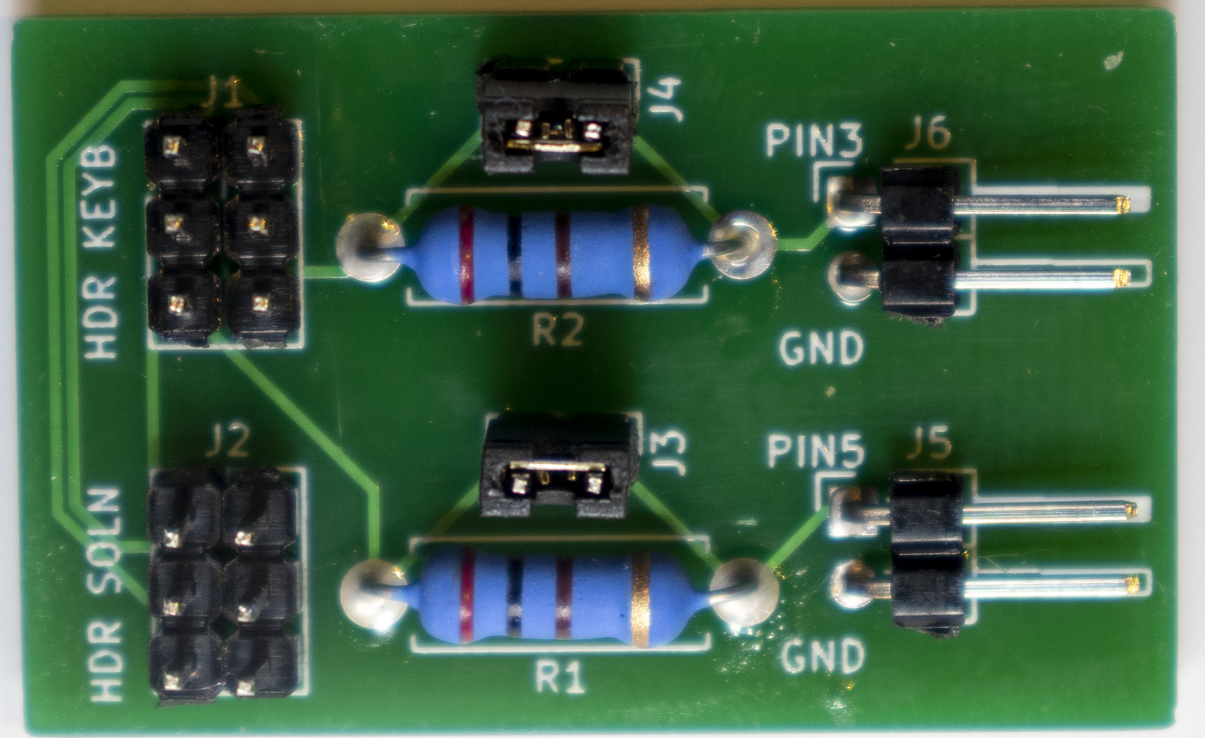

Required parts:
* 4 wires, 10cm to connect the keyboard header with the solenoid header
* 4 wires, 20 cm to connect the keyboard controller with the LEDs
* 2 resistors (200 to 500 Ohm) between LEDs and keyboard controller
* 2 LEDs (3 mm) 20mA
* 2 Metal sockets for 3mm LEDs https://www.amazon.de/-/en/gp/product/B ... UTF8&psc=1
The drill holes need to have a diameter of 5.8mm but I used 6mm and it worked perfectly. I used adhesive tape to cover the drill area, marked it precisely and used a center punch for each hole.
To reduce the cable mess with individual wires, I have created a little break-out board as shown below. It allows me to connect the solenoid controller with the keyboard controller using two standard 6-pin ribbon cables and gives me additionally the option for two LED connections. Best part is that I have the resistors already on the board (including bypass jumper).
Normally you would want num-lock / caps-lock to be shown in the lock lights and that works out of the box - just hook up the above LEDs accordingly. In my case I use it to display Layers (Momentarily or Switched). What it means is that no LED lights, if I am in the base layer, when I hit the Layer1 key, a white LED lights up, when I toggle to layer 2, the red LED lights up and stays lit and finally, if I use Layer1 + Layer2 key, I have a third layer and that gives me both LEDs.
Using QMK as firmware makes all this easily available / programmable, as the individual pin headers are selectable and when to light up.

@darkcruix Thank you for this instruction, this is very exciting. I think I may have just been convinced to get a solenoid as well. This is such a rewarding keyboard!

darkcruix thanks for your great setup instructions for the LEDs.

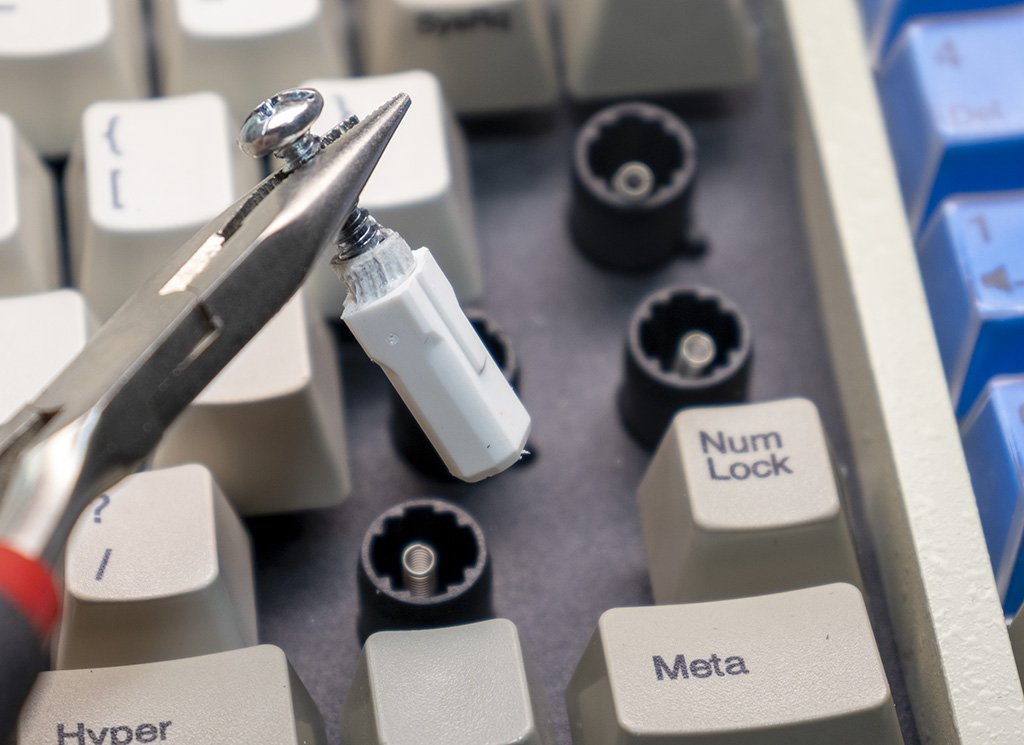

DrivenKeys wrote: 19 Jan 2021, 02:00 Here's a quick collage I put together on my phone of how to make the (hopefully) damage-free insert remover I just mentioned.
I just wanted to confirm that this is working spot on in my tests ... I will add this as the standard method to remove the inserts in the Model F manual ... HUGE thanks for this idea. Below a few of the photos I took and some measurements:

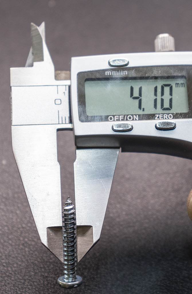

I used a screw with a thread diameter of around 4mm:

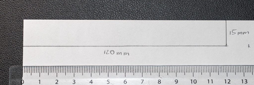

The paper was cut into the size of 5 inches by ½ inch (between 120 mm and 140 mm length and a height of 15mm). I rolled it up so it barely fit into the plastic insert (you need to feel some resistance when inserting the paper):
Finally, I screwed in the screw carefully by holding the paper with pliers. Once the screw is inserted, you can easily pull on it and get it out together with the insert:

darkcruix wrote: 20 Jan 2021, 23:46 It really depends on the configuration. In my case I have a solenoid and two LEDs connected.
@darkcruix, I'm not interested in the solenoid for now. Would it be enough adding the LEDs directly in series with the resistors like in the following diagram?

The screw + paper method seems like the best method so far to remove stabilizer inserts!

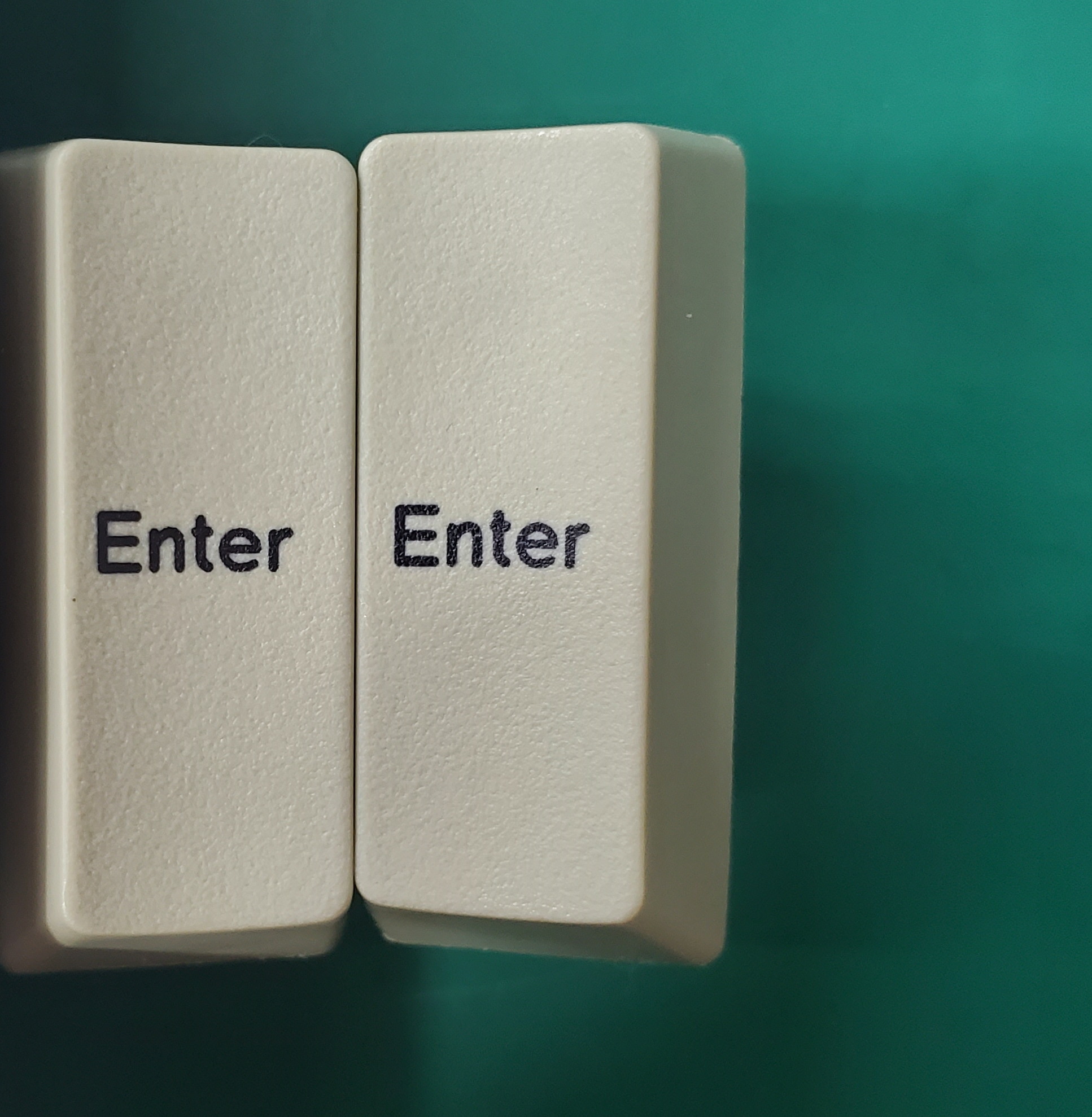

Dye sublimation update:
We finally have some approvable key sets! See the below example - please note some keys have been slightly cut off in the photo. And the photo was taken with a camera, not a scanner, so there may be some distortion.
I hope the below key set will be representative of the new Model F sets going out to everyone. The alignment is within the original IBM Model F tolerances I have personally seen from dozens of originals I have collected / restored over the years. The most salient note to the factory is the Print Screen type keys which are a little too close for comfort to the edge but I would not be exchanging someone's keys or key sets if in general they match what IBM deemed acceptable on a sold product; see my 11/10/20 post for more details - one paragraph copied below:
"Some keys will always be slightly out of alignment tolerance - even so with IBM - so the goal is not perfection. According to my digital caliper measurements of an excellent, probably 90th+ percentile IBM XT keyboard example with outstanding sublimation quality, 24% of its keys aligned out of the bounds of the standard deviation (an amazingly tiny 0.15mm!). IBM's out of bounds on this set ranged up from 0.18mm to 0.46mm variance from the average alignment of the key set (still excellent results). As I've seen having owned and refurbed dozens of F's over the years, the standard deviation was far larger / looser on many of the other, later production units."
2021-02-25 test.jpg (781.65 KiB) Viewed 20023 times
If all goes well the factory is going to try to make a small number of sets of US ANSI, Apple/Mac, and HHKB 6 key and send them to me before Chinese New Year break. That way I can start getting orders out.
To keep things simple I am not going to accept shipping requests for the keys and cannot answer questions of "is my keyboard in this key set batch" (please don't ask!), though everyone can still continue to request separate shipping without keys. Everything will go out in priority order, putting at top of the list the single digit serials, early bird tooling volunteers, and custom/low serial orders in order of the date of your first keyboard ordered. With current production estimates there will be no remaining sets in the first batch for other keyboards. In keeping with policies over the past year, your order cannot go out if even one item cannot ship.
Also now that the second container shipment is on its way, beginning in March (not before March) you can start to request separate shipment for a wider variety of keyboards. Below is a list of the keyboards expected to be received as part of the second container shipment, arriving around the end of February:

elcano wrote: 26 Jan 2021, 01:19
I put the resistor between the PIN 3 and PIN 5. So, I would get the ground direct (and in series), but the resistors before the PIN connections. In theory your method should work, but I would just give it a try ... worst case, the LEDs will burn out :)

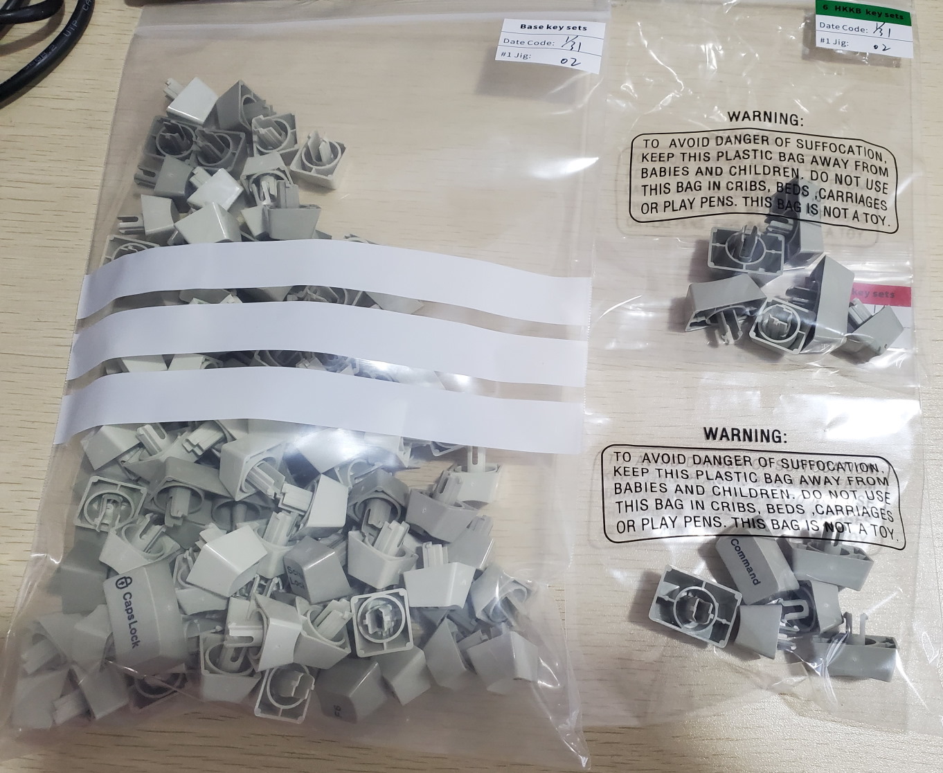

31 Jan 2021, 08:29
The latest monthly update is now on the project web site blog:
https://www.modelfkeyboards.com/blog/
As noted before, a big thanks to Deskthority forum member Zed for creating and updating the sublimation artwork. The factory received the approved artwork for production and started production this week. We only have a few days left before Chinese New Year but if all goes well the factory is going to try to make a small number of sets of US ANSI, Apple/Mac, and HHKB 6 key and send them to me before Chinese New Year break. That way I can start getting orders with printed key sets out.
Below are examples of some of the production Brand New Model F key sets bagged up and ready to be express mailed to me:
20210131 Key sets - Copy.jpg (365.33 KiB) Viewed 18711 times
And here are two Enter keys hanging out together (this is from finalized dye sublimation artwork). The texture is so fresh on the new key molds that the legends seem to glisten if the key is positioned just at the right angle to a light source. Of course there’s no glistening, just deep black when viewing the keys as you are typing on the keyboard as opposed to viewing straight down with a strong light source.
The angle of lighting and the angle of your camera definitely affect the perception of the keys as shown by these two identical keys at slightly different angles.
20210131_141514 Enter keys.jpg (604.43 KiB) Viewed 18711 times
darkcruix
31 Jan 2021, 16:12
Stunning...
shampoo
31 Jan 2021, 16:40
Ya, ditto. Those look fantastic!
