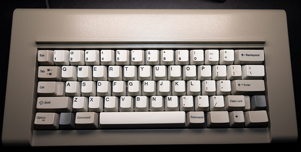

Having used the keyboard for a couple of days, I have to say that it is pretty magnificent. Definitely the best clicky keyboard I have used. All of your hard work is definitely appreciated, Ellipse - and pandrew, darkcruix and whoever else contributed to make it this good.

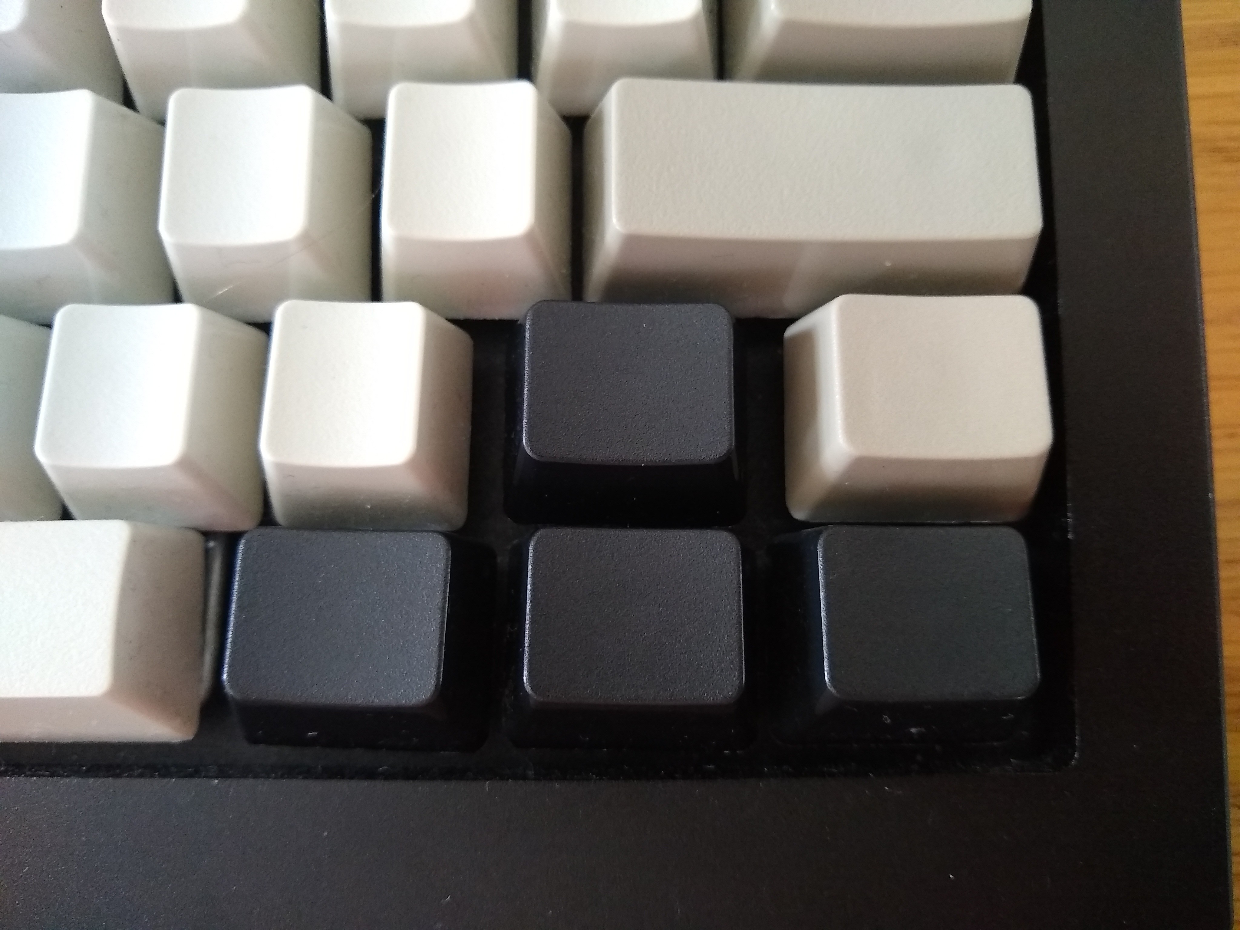

Finally got out the superglue and made my 1.25 U right shift key.

10 Feb 2021, 21:30

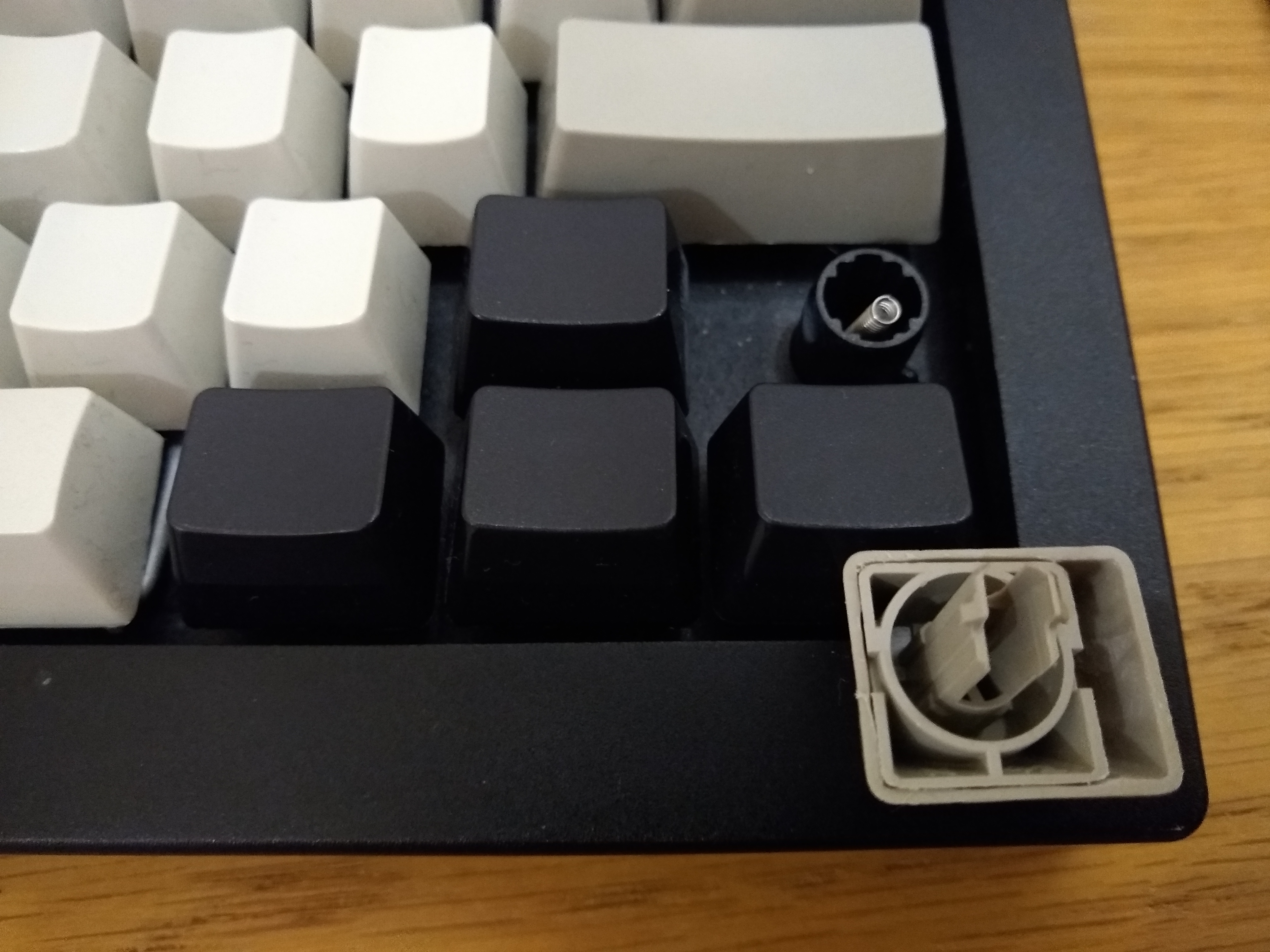

The inv. T made of 1.25 U keys lines up perfectly with a similar gap on the left and right of the 'up' key and to the left of the 'left' key.
I didn't like the way the non-stepped part of the Caps Lock wasn't centred above the 'down' key.
I superglued a Model M stem into a 1.25 U key to make the pebble-coloured key to the right of 'up'. I'm using it as shift rathar than function as, as a long time user of HHKBs, I didn't use that key for anything other than function shifting for arrow keys before.
The difference in shade between the unicomp 1.25 U pebble and the ellipse enter is less noticable in the flesh.

clickclack
10 Feb 2021, 21:37
darkcruix
10 Feb 2021, 22:00
clickclack wrote: 10 Feb 2021, 21:37 bottom.jpg
I love that - you can bet I will try the exact same thing ;)

The really cute thing is that the 1.25 U key is an ISO left shift key. So there'll be a printed version of it as a "normal" key from both Unicomp and ellipse.

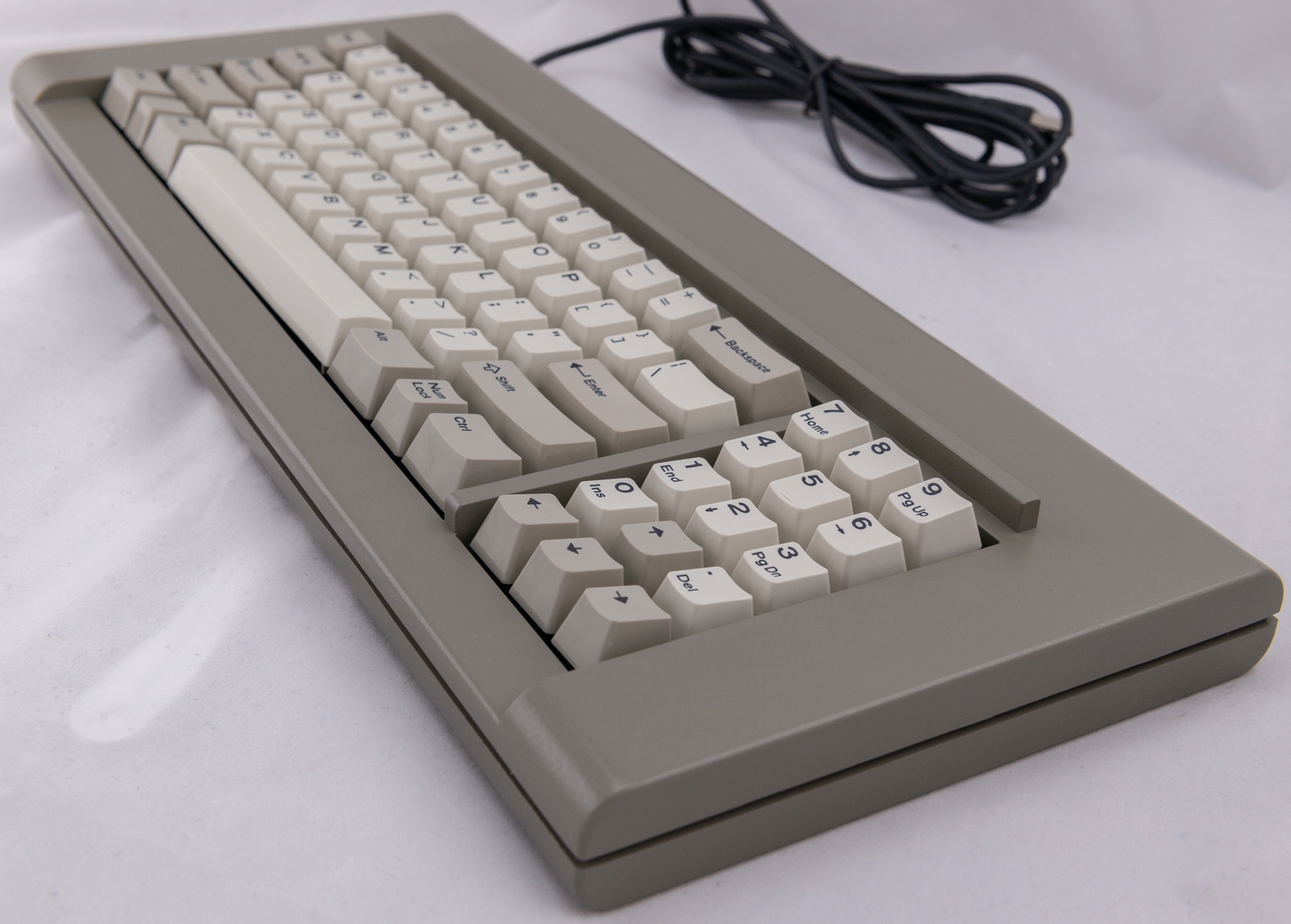

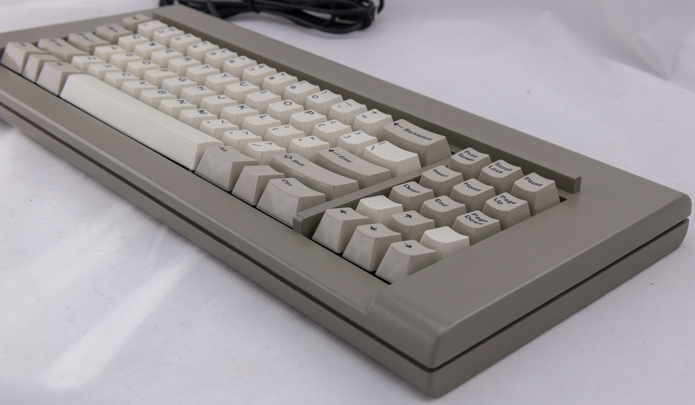

Ellipse
11 Feb 2021, 23:51

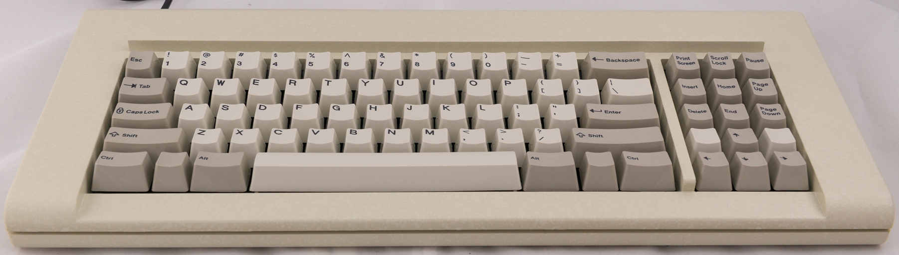

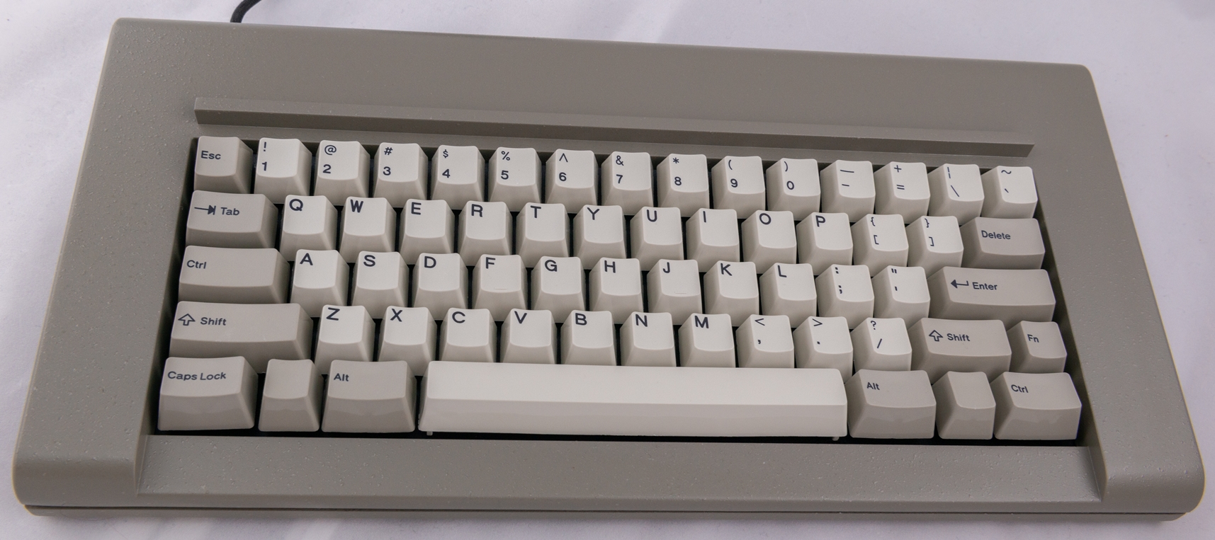

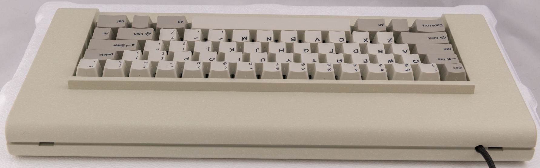

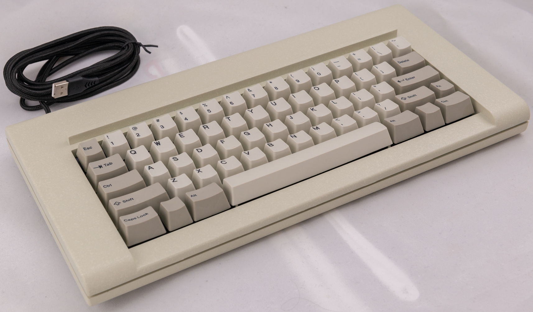

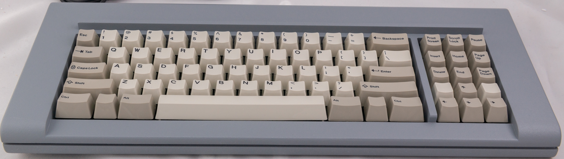

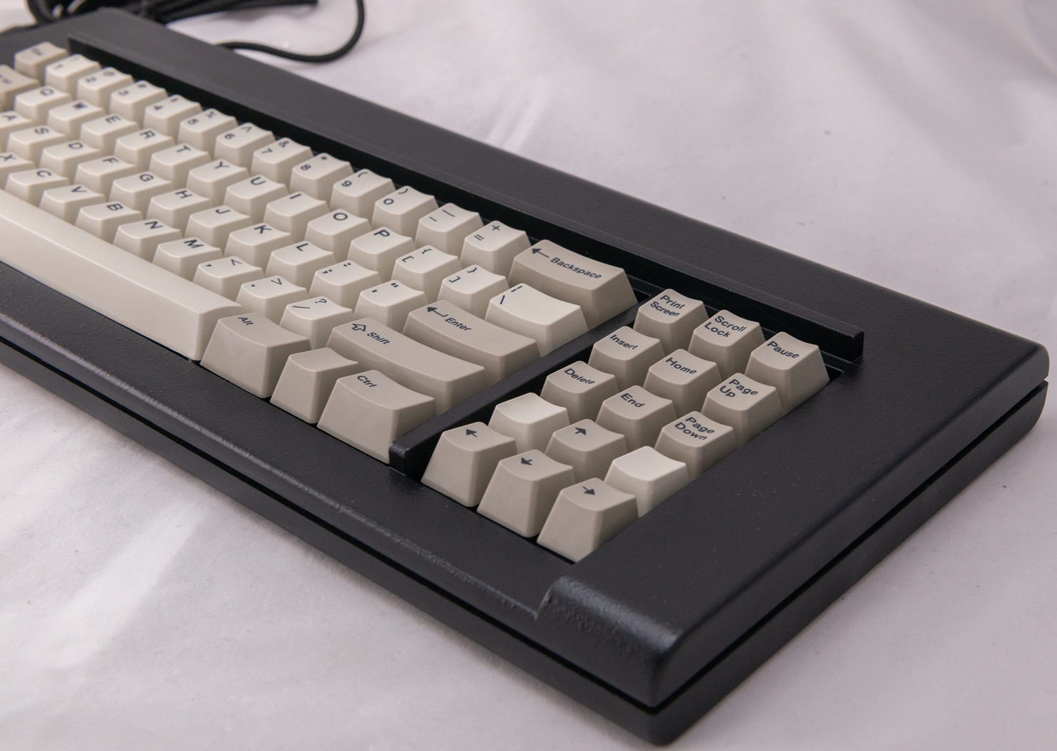

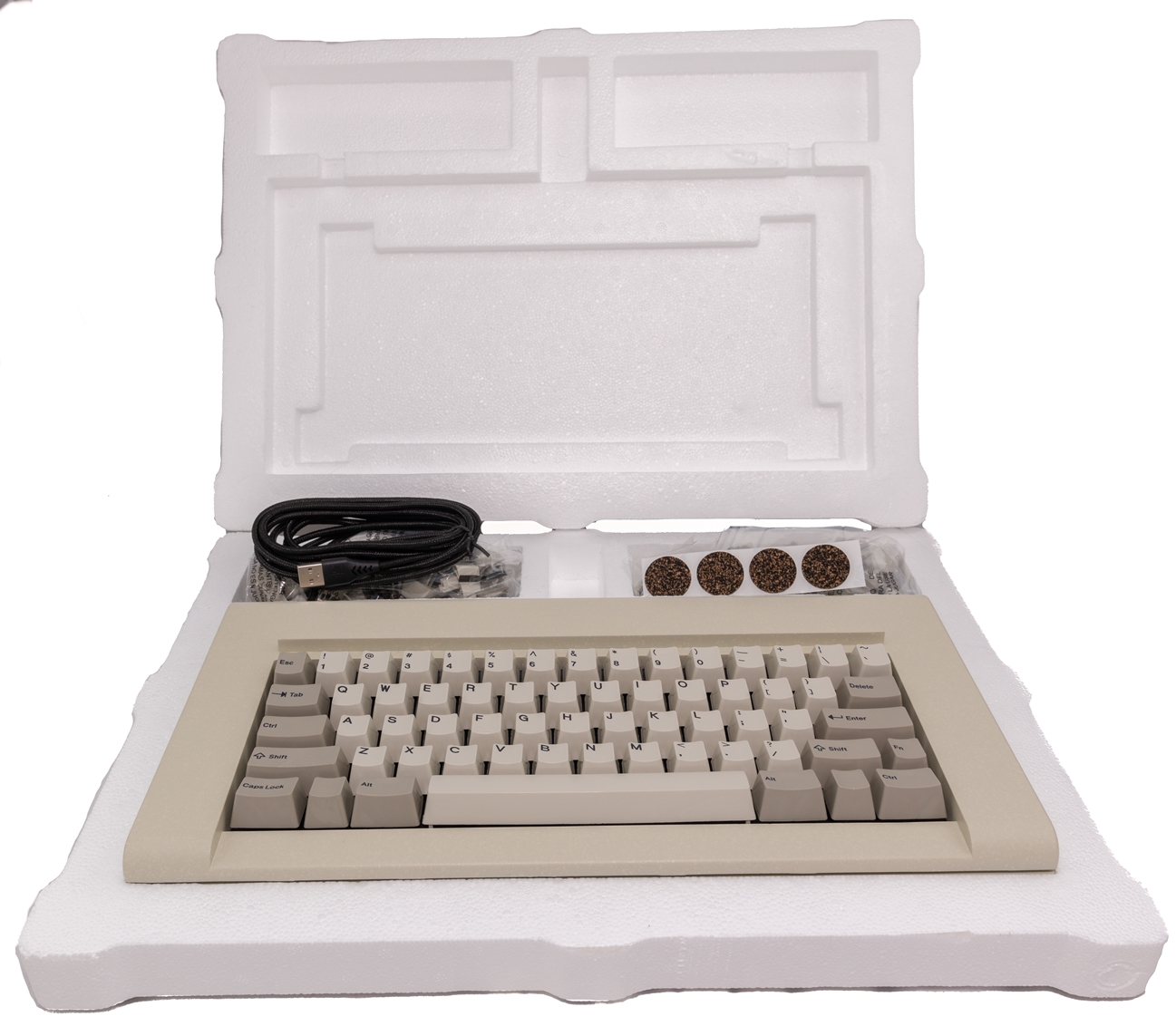

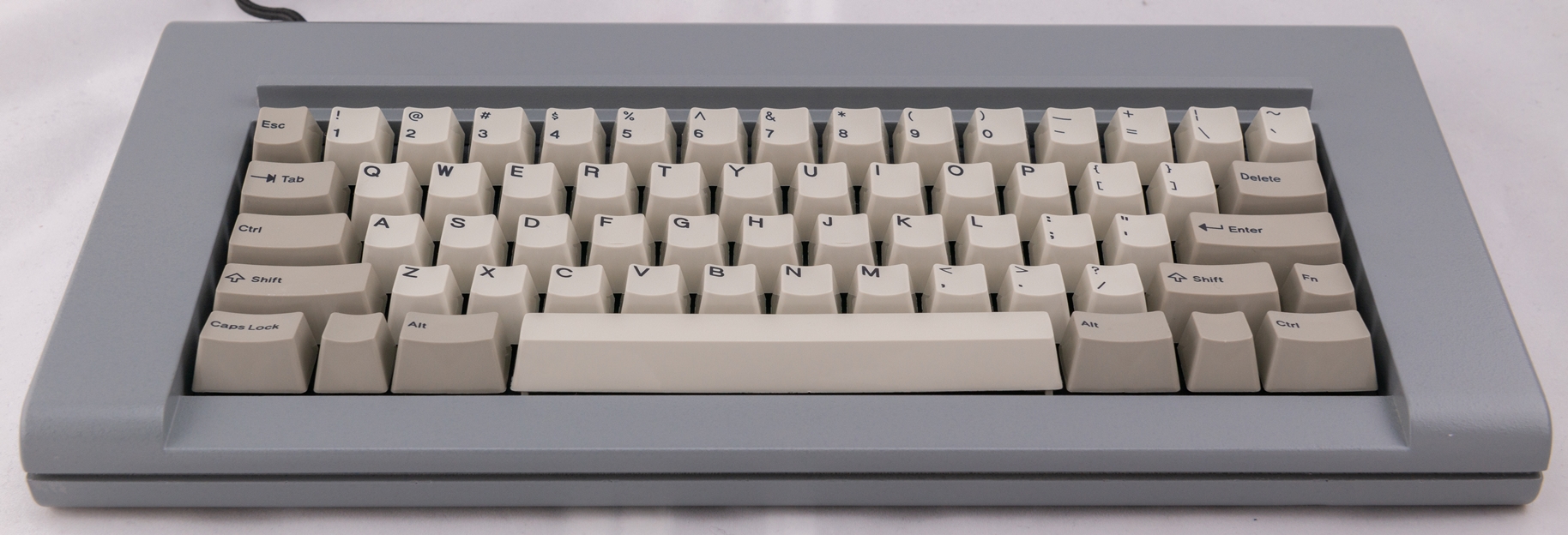

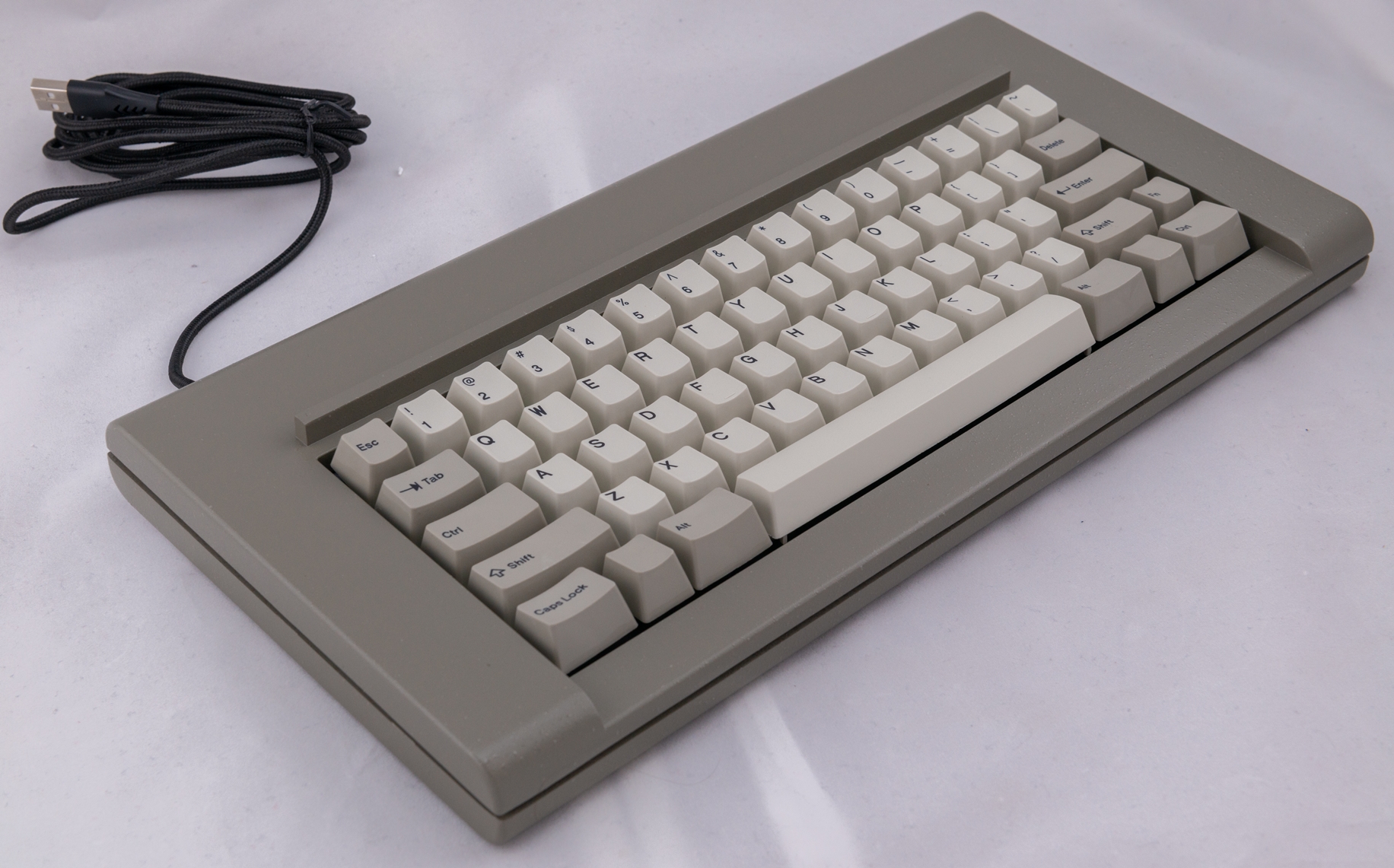

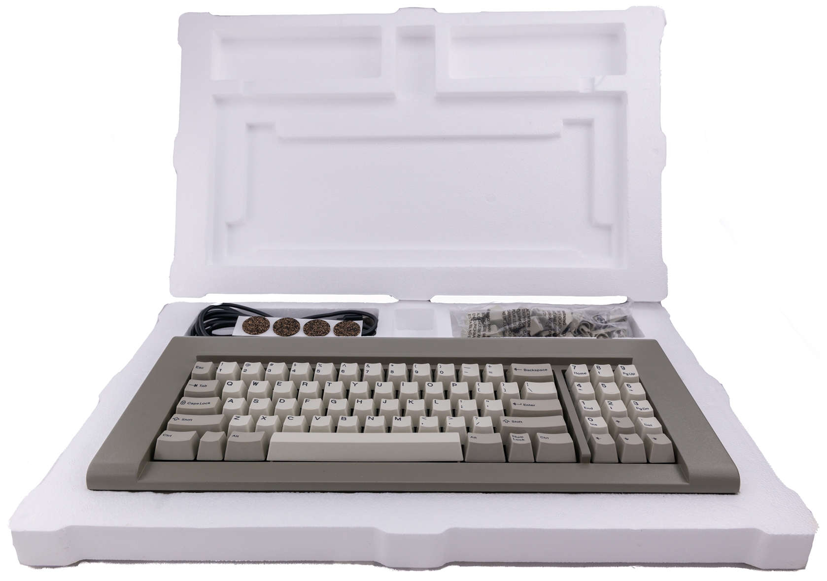

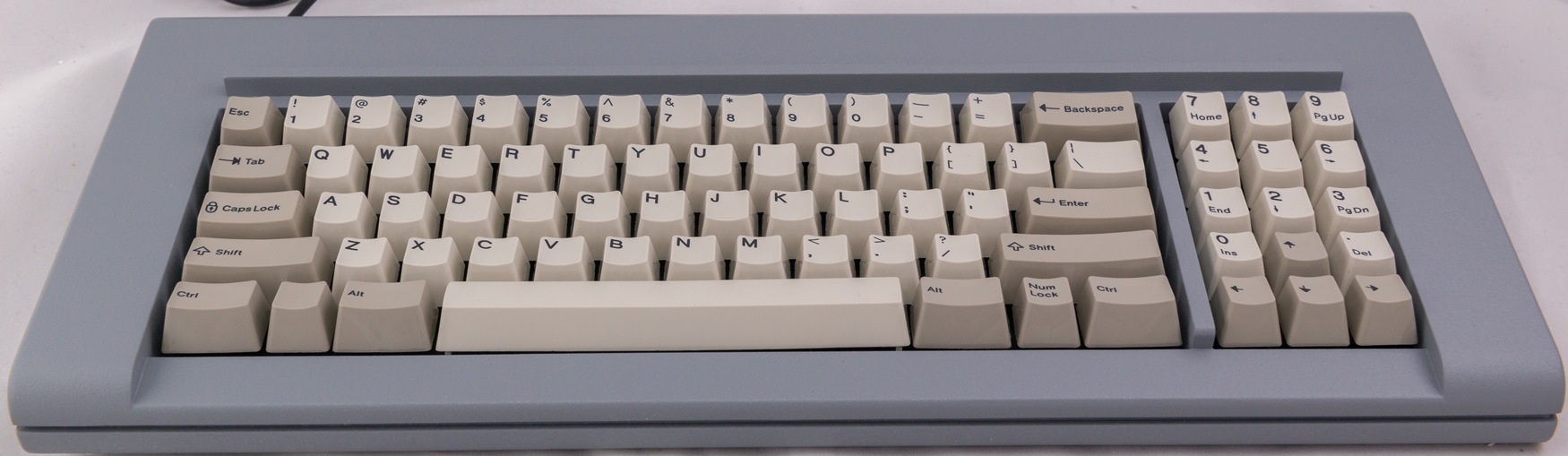

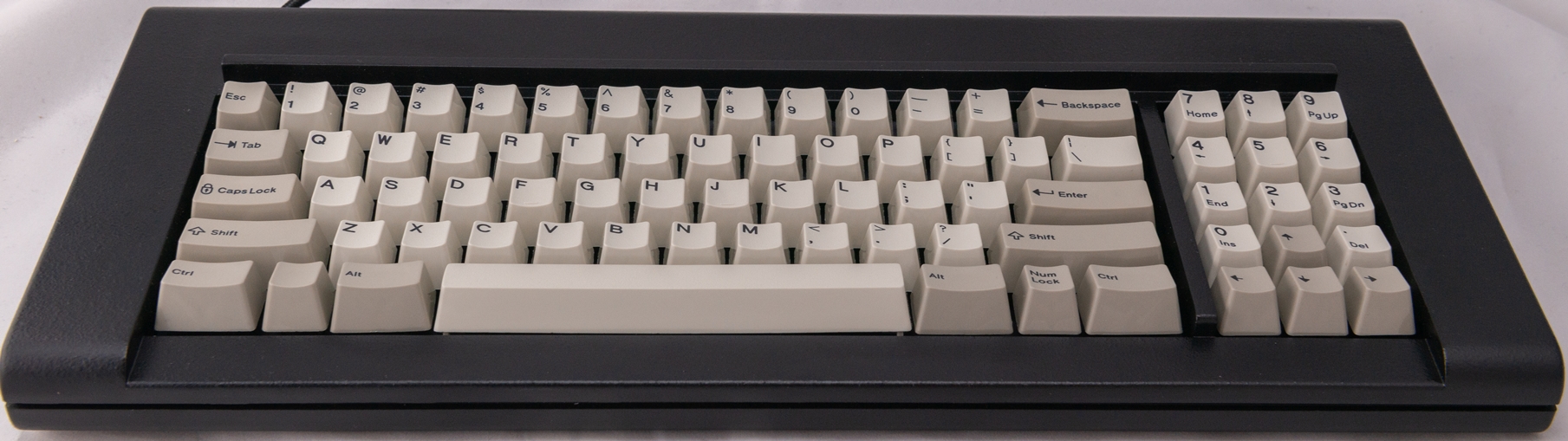

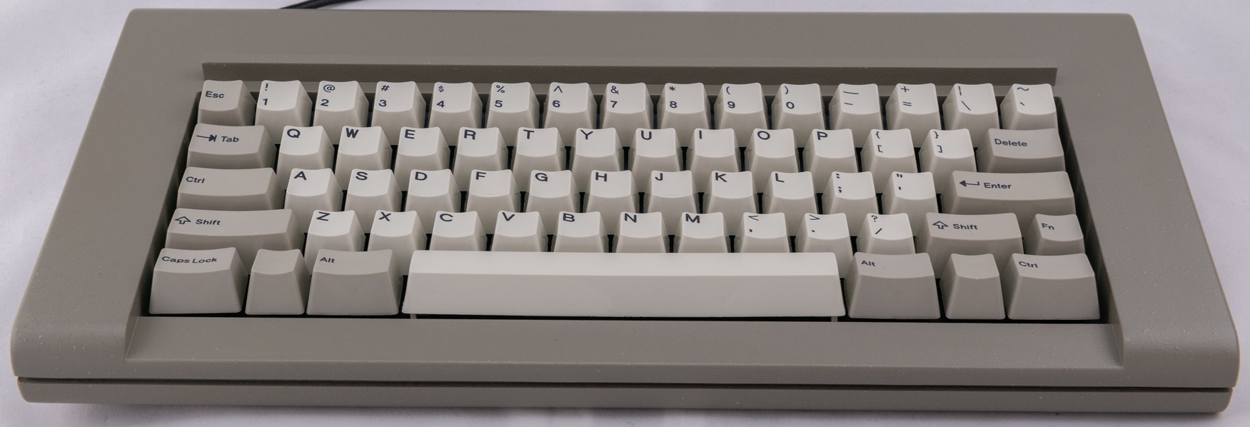

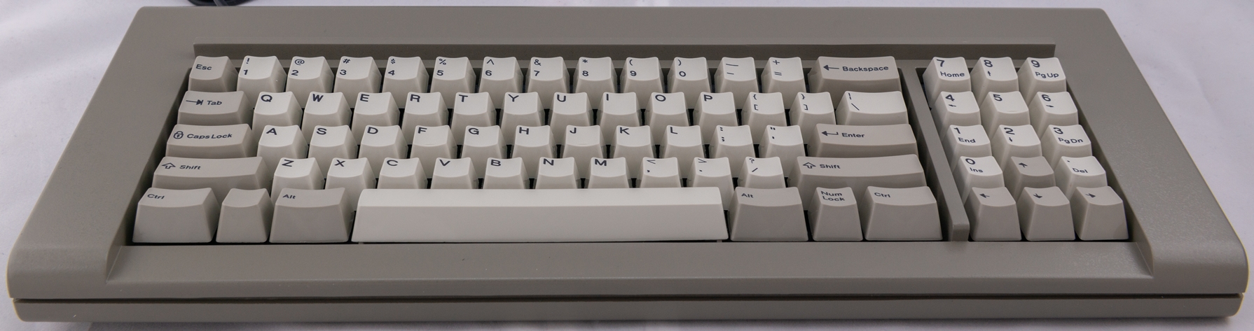

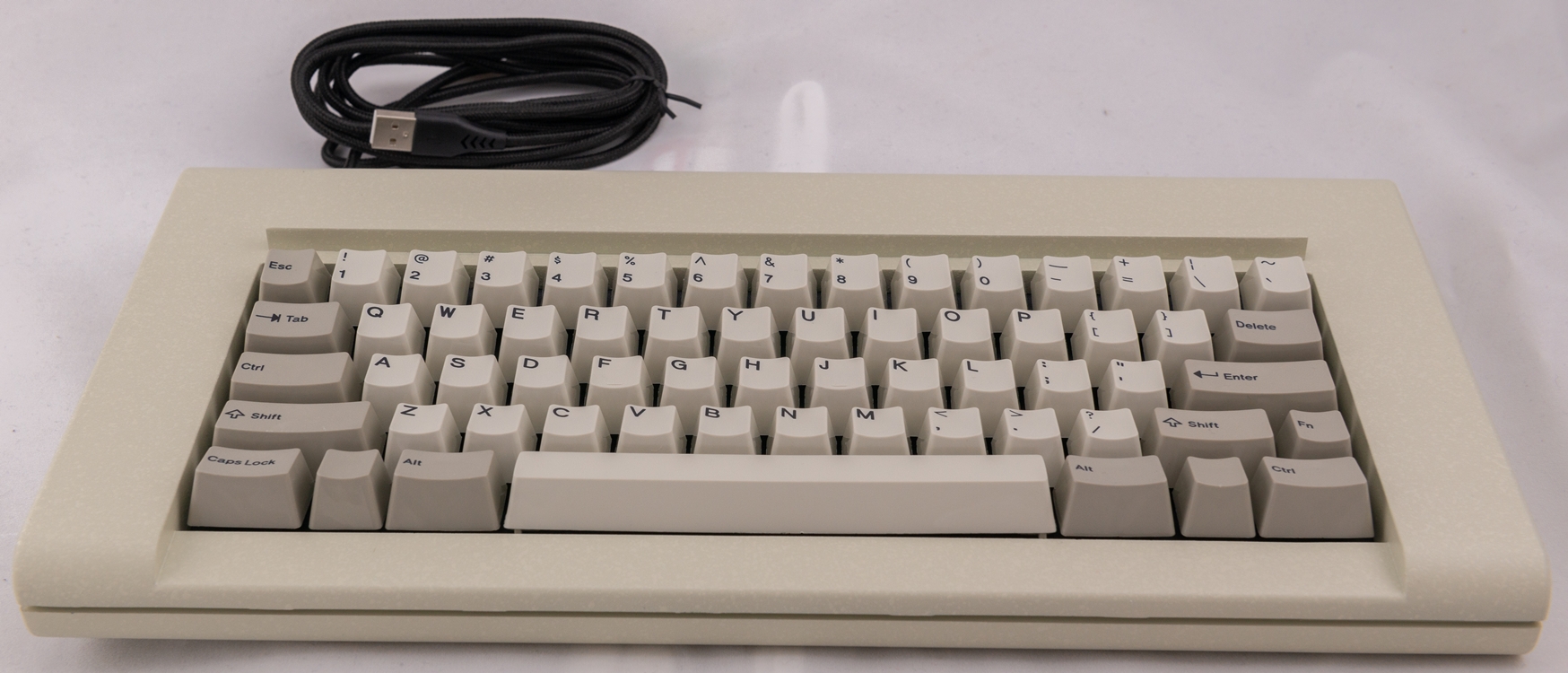

All but two of the "all in stock" single digit and early bird tooling supporter orders for keyboards and new Model F key sets have shipped out!
Next up are the earliest low/custom serials with all orders' contents in stock.
Below are photos of the very first keyboards with the sublimated new Model F key sets to go out, along with the inner assemblies moved to other case colors for the purposes of photographing additional keyboard variations.
The key sets came out even better than expected! So good that I have decided to sell off two spare original IBM F107 key sets on eBay in the coming weeks because I believe the new sets are of better quality.
All this week's photos are available in the continually updated imgur album of keyboard variations - a selection of these photos is below. The imgur album has the full res photos: https://imgur.com/a/gw8FOl0
The layouts in the photos include F62 Split Right Shift and Split Backspace, F77 ANSI with 0-9 and Cursor keys, and F77 ANSI with Ins/Del/etc. keys and cursor keys. Case colors shown include Off-White/Beige, Industrial Gray, Black, and Silver/Blue Gray.

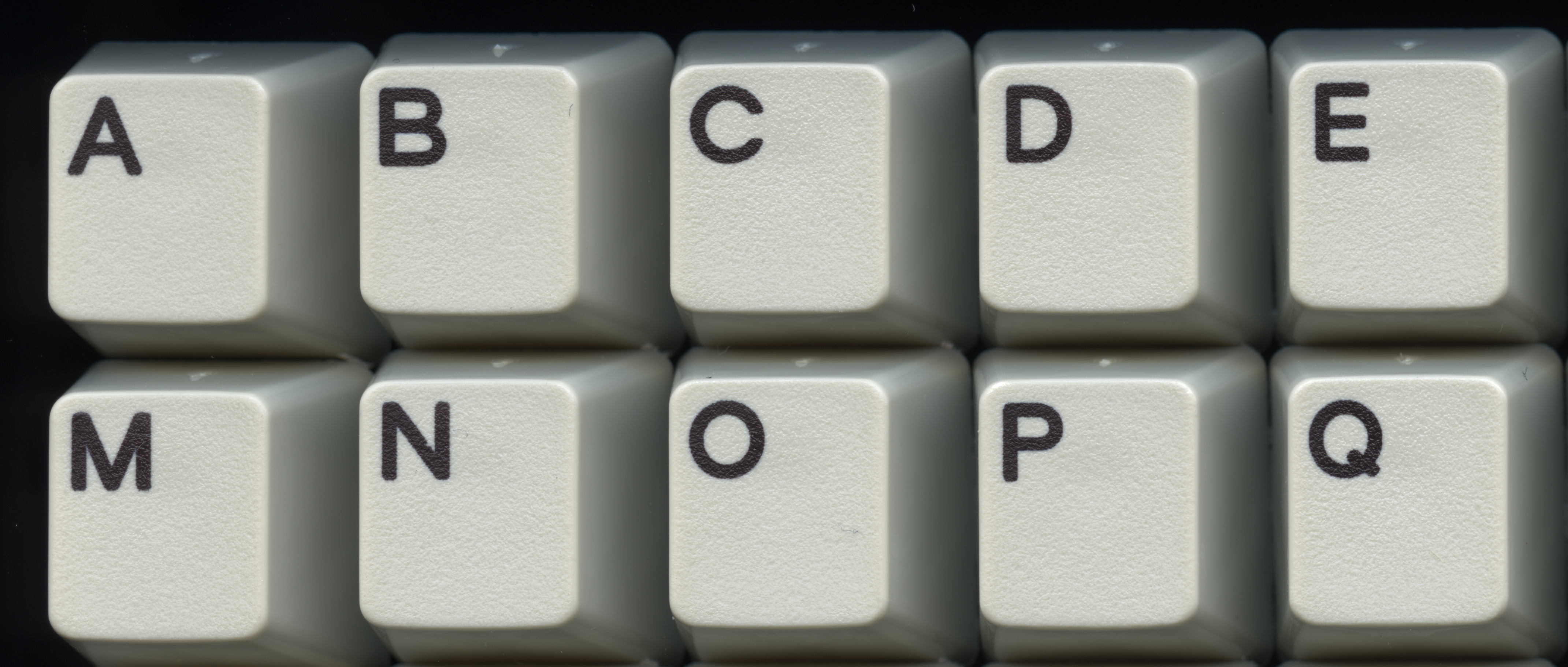

Ellipse
12 Feb 2021, 02:08

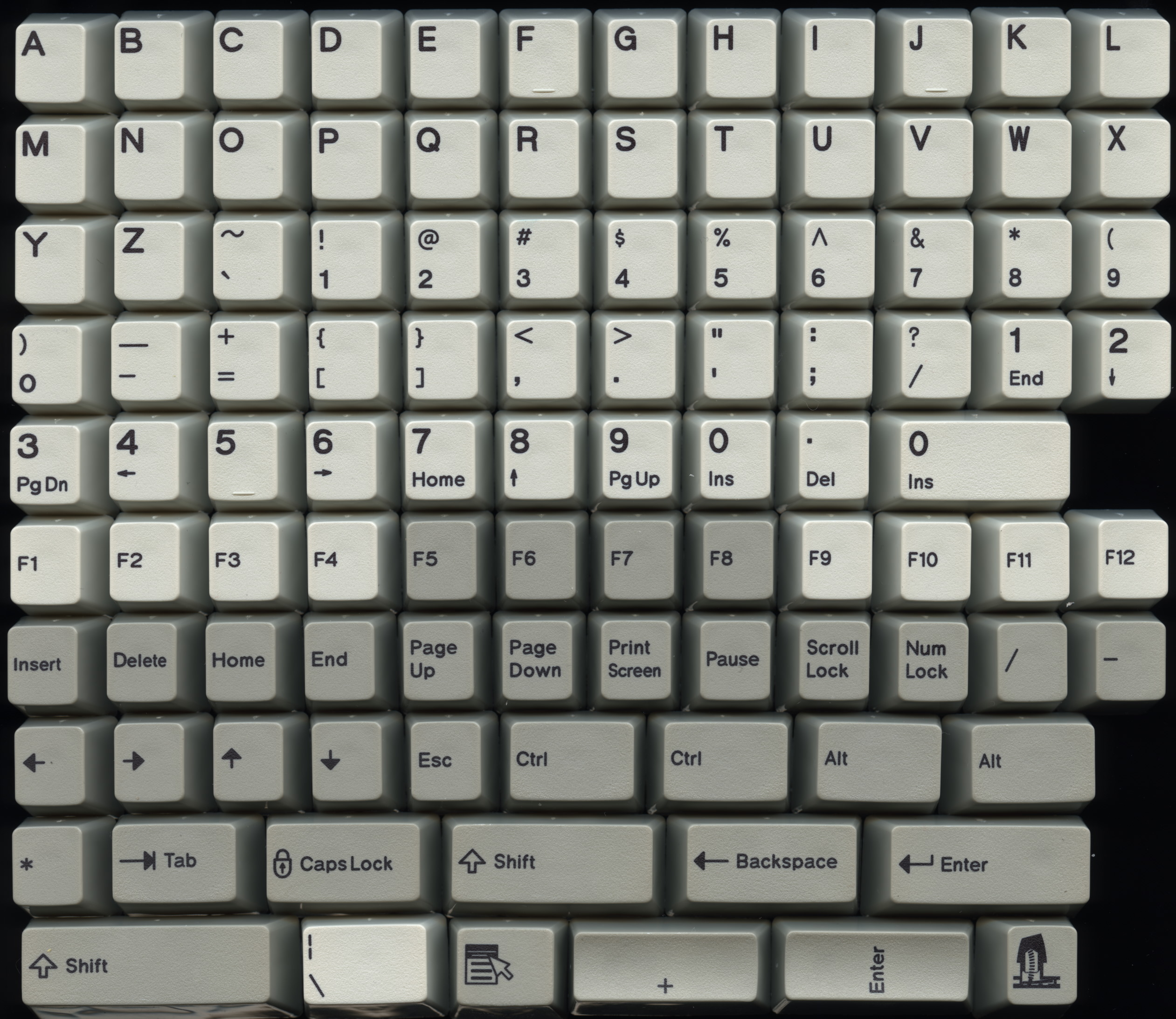

And below is a high resolution scan of the new Model F sublimated keys on my Epson V700, along with a detailed crop of the same image to show the quality.
2021 02 11 new Model F scanned keys 2.jpg (1.1 MiB) Viewed 17371 times
2021 02 11 new Model F scanned keys detail comparison.jpg (1.03 MiB) Viewed 17371 times

Those are clean! Also! Where can we order a key with the buckling sprint diagram on it like that bottom right one?! :O
