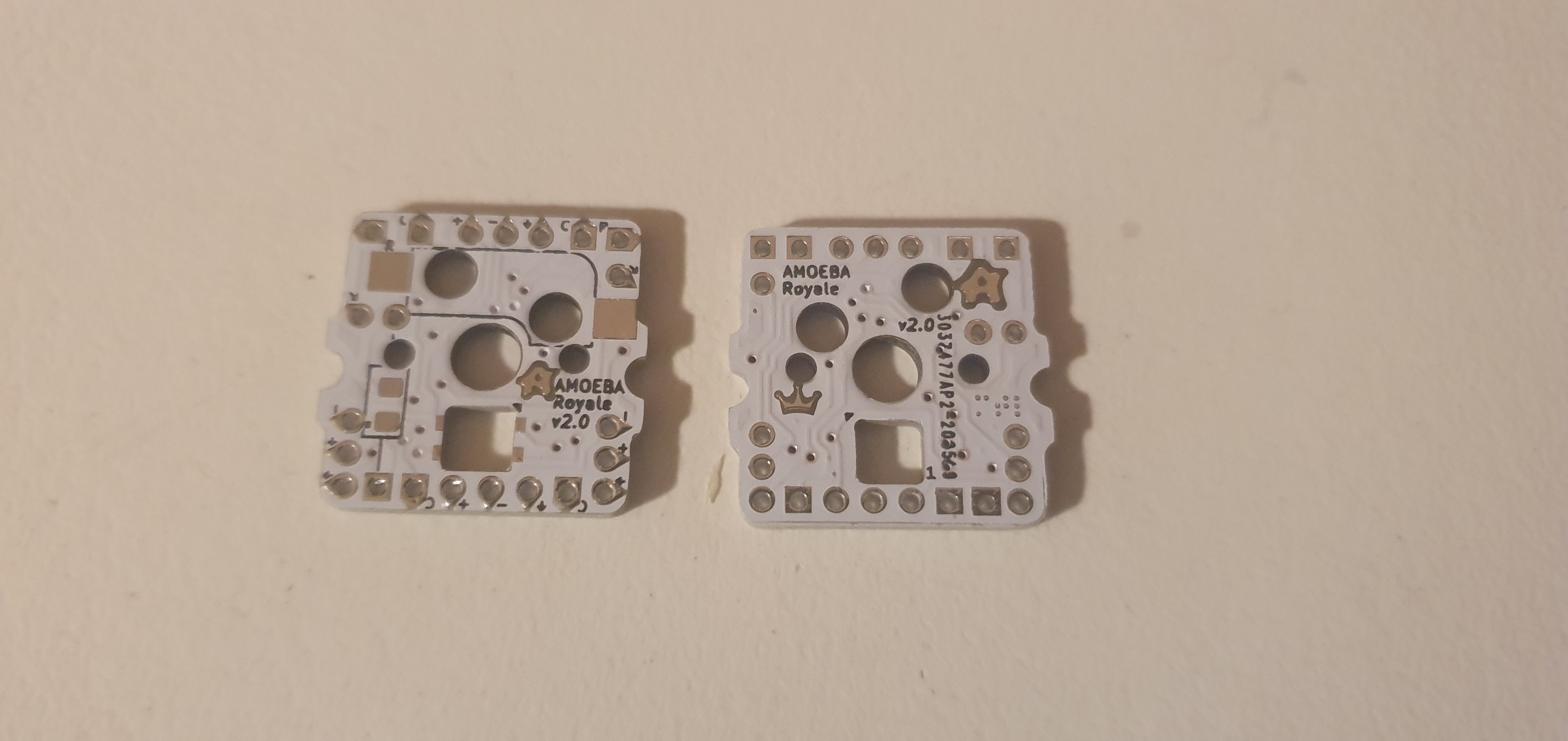

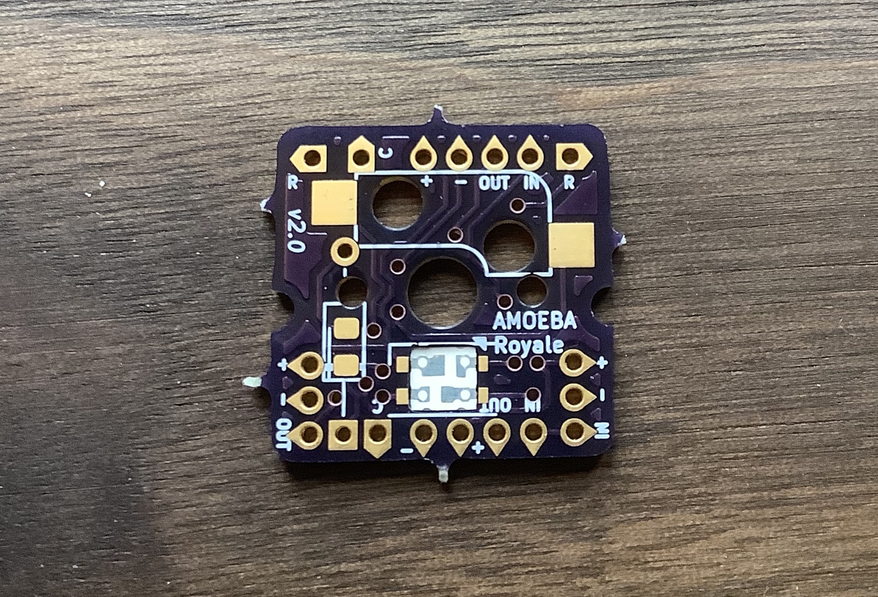

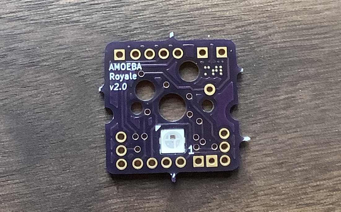

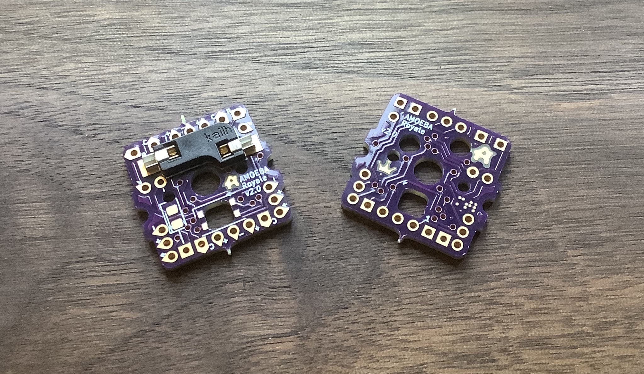

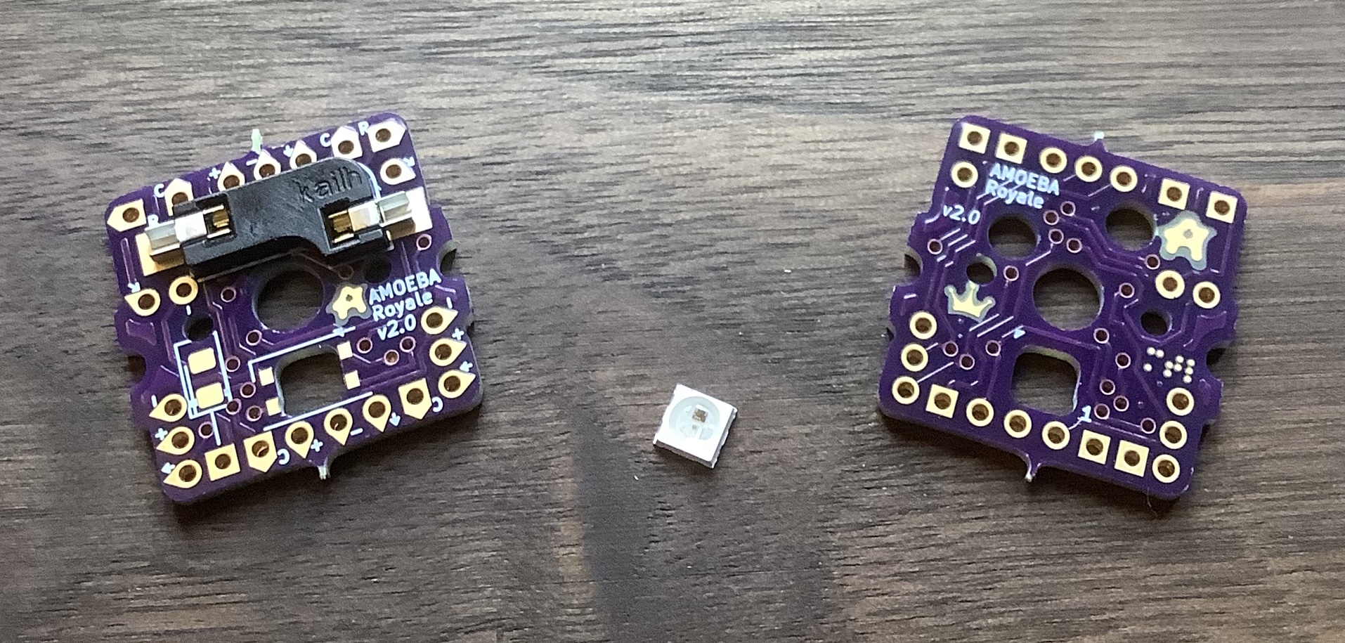

Ah, that makes sense. Thank you for that context. I'll put together the files for release, try to call attention to the milling issue, and create the 2u version at a later date (as time permits).
For now, here are a few pictures of prototypes that have been made. The first pictures show the current design, which suffer from the milling error and can't fit the LED without filing away at the PCB:
Here are a couple of shots of an earlier prototype with the LED:

The milling issue for the LED is unfortunate. If I understand correctly, they use a too big of a mill head, which results in the corners being too rounded for the LED to fit in? Is it possible to make the cutout longer, such that it's not completely square, but instead extends a bit to the top and bottom, allowing for rounder corners? I don't know if that would make it impossible to fit the circuit in though.
Also, do we know if any other manufacturers supports finer mills, such as JLCPC?
Also, you don't have to be in a hurry for my sake, I won't have time to play around with them for the next couple of months anyway. I would much rather wait a few month if that was what it took to figure out how to fix the LED issue.
mtl
10 Apr 2020, 15:20
It may be possible to dogbone the corners. Will give it an attempt. (PCB space is at a premium.)
I don't have experience with other manufacturers, but hopefully someone can offer insights. I can also produce panelized gerbers if someone can offer guidelines (optimal panel size, ability to do V scoring/grooves, etc.). These parameters would possibly vary by manufacturer.

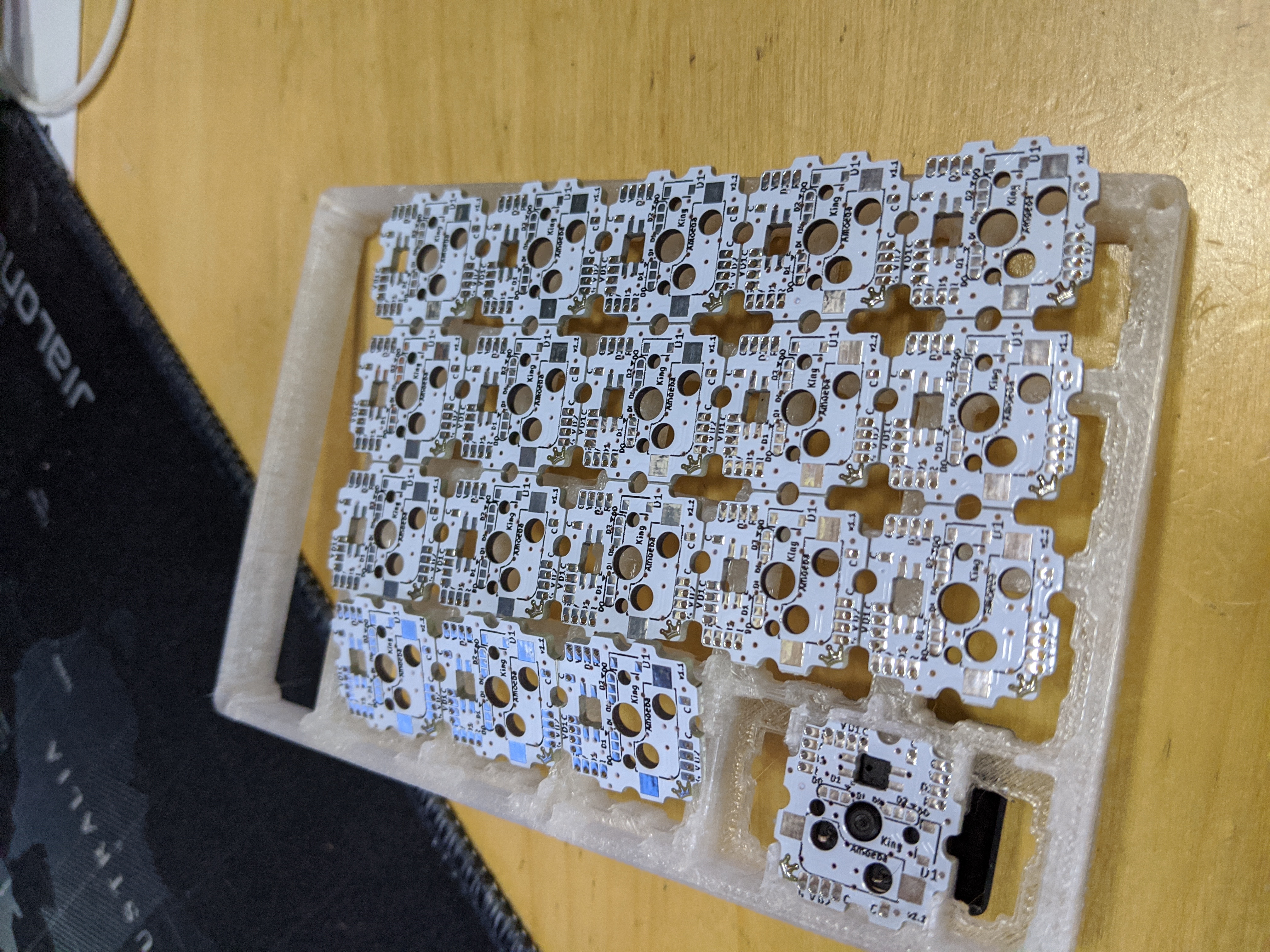

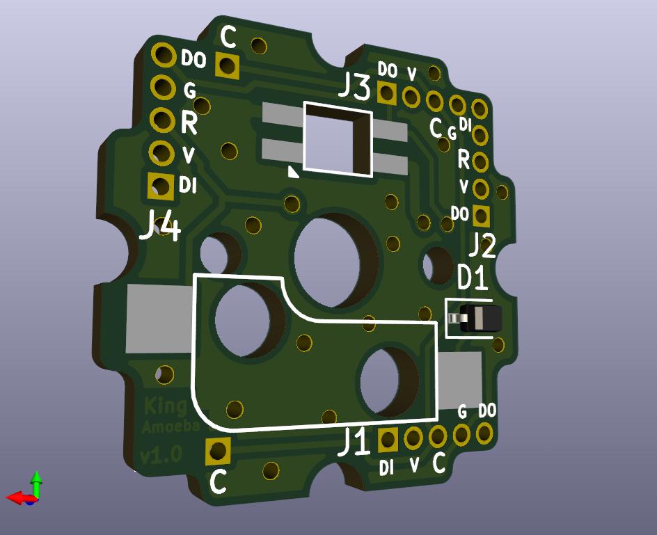

So after taking a good look at the Amoeba Royale and doing some 3D prints to see how it would fit in my planned dactyl keyboard, I decided I could use some changes. It started, because I needed a little bit of space around the corners to allow it to fit into a 3D print. Then I went down the rabbit hole. I'm calling it the King Amoeba, since that's my last name and still a fitting homage to the inspiration. The changes are pretty substantial though, with only the hotswap socket kept from the original.
  • Cut back corners to allow at least 1mm edge, ie width and height at the corners is 17mm instead of ~19mm.
  • The design was optimized for ortholinear, but should work with a standard layout.
  • I went to a 1.27mm / 0.1" pitch on the board interconnects. The plan is to just use standard ribbon cable to wire up the rows.
  • The top has a left and right 5 pin connector, of which either the top 4 or bottom 4 pins are used depending on the direction of the serial bus for the LED's.
  • This same pattern has been repeated on the columns as well as an extra column pad in the opposite corners.
  • I had to drop the through hole diode for space, and I swapped the SMD diode to a SOD-323, because JLPCB has these in stock, so I might be able to avoid soldering those at all.
  • I used the SK6812MINI-E and redrew a footprint based on the datasheet I found.
All in all I think it came out pretty well. I plan on doing a double wide layout next and then hopefully ordering some boards.
I will try to get files into a Git Hub fork when I have time. I will also add my OpenSCAD files that I will be using as a base for the 3D print. I hope to also have a modular variant of that to enable quick prototyping there as well.

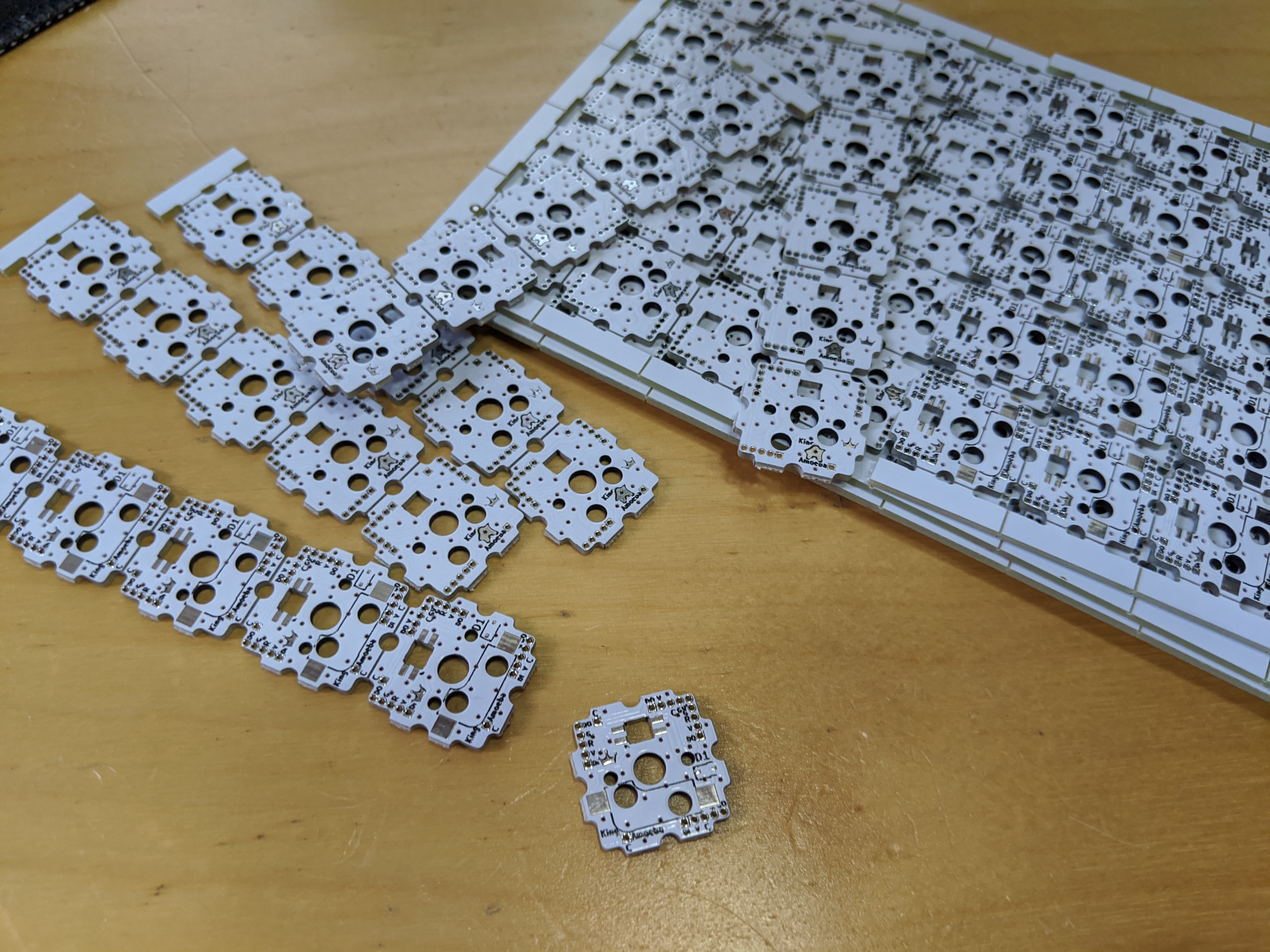

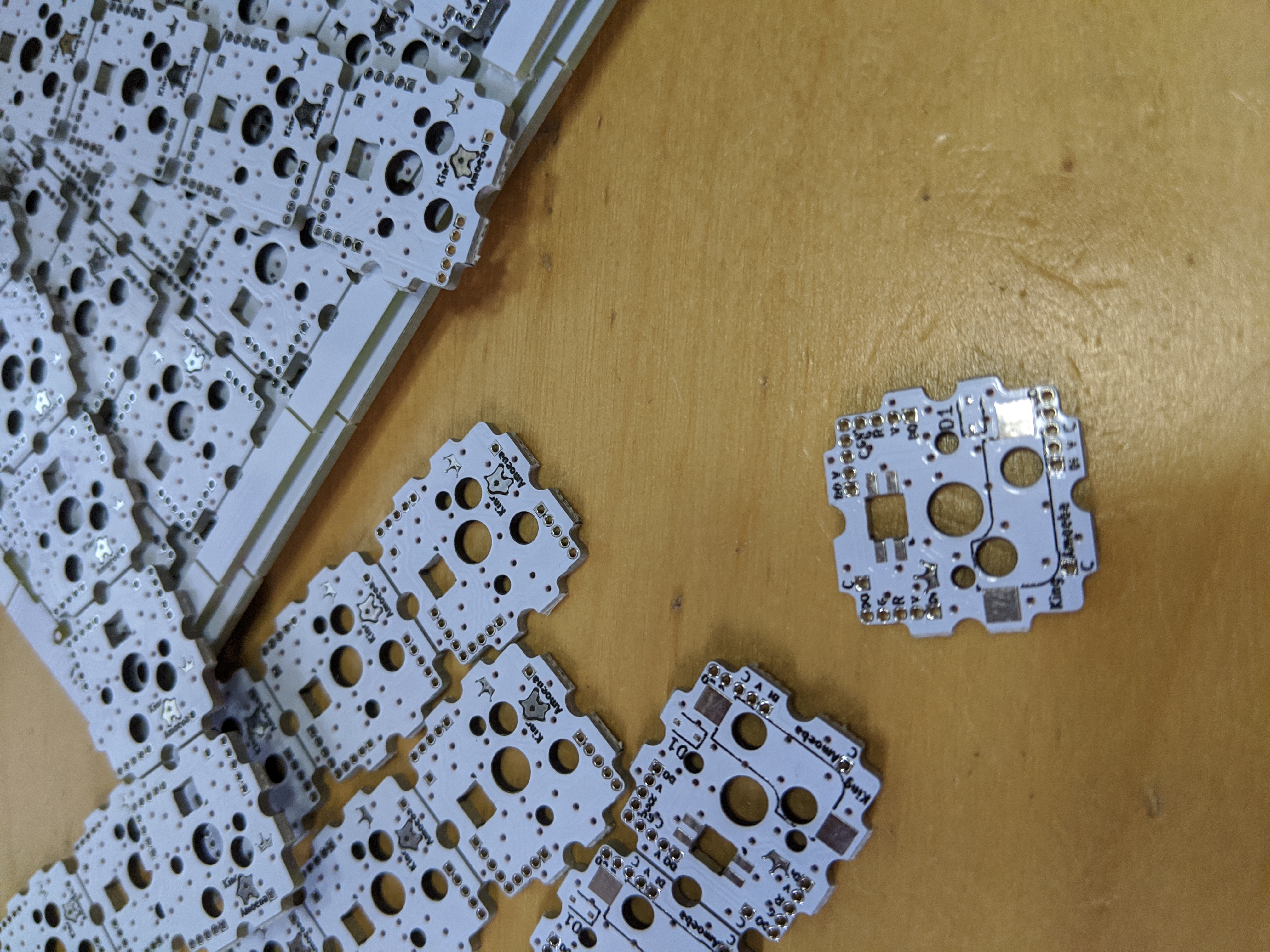

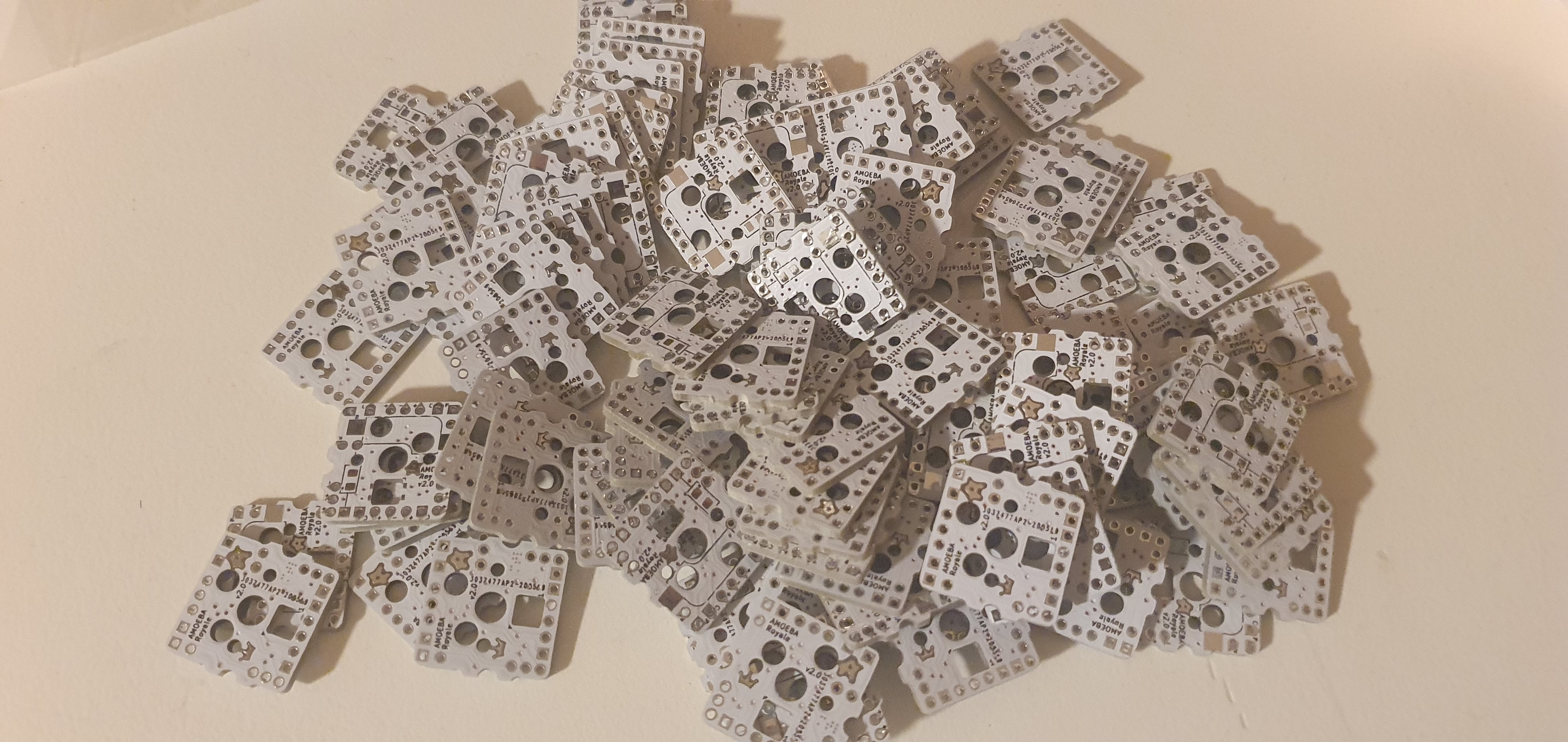

So the boards came today,
but upon it looks like I made several mistakes. :? I don't have the rest of the parts yet, so I'm not too sure how well they will work, but the continuity testing looks good.
Here are the issues I found.
I used the SO-323 instead of the bigger SO-123 or SO-123F diode normally used.
JLCPCB also put them into a 5x18 panel instead of 18x5 panel, so the panel is not as useful as I'd like.
The biggest issue seems to be that I believe I put the pads for the LED's upside down. They are still functional, but wiring up the LED's will be a big pain in the behind.
I'm also going to make the cutout for the LED a little bigger, its a bit tight right now.
I'm going to put in an order for a corrected variant 1.1, but if anyone would like some of these, I have five 5x18 panels. They will work well without the LED's and the SMD's can work, but wiring them will be tougher. If anyone is interested in some and willing to pay shipping and maybe some beer money, please let me know.The panels are perfectly spaced for ortholinear layouts.

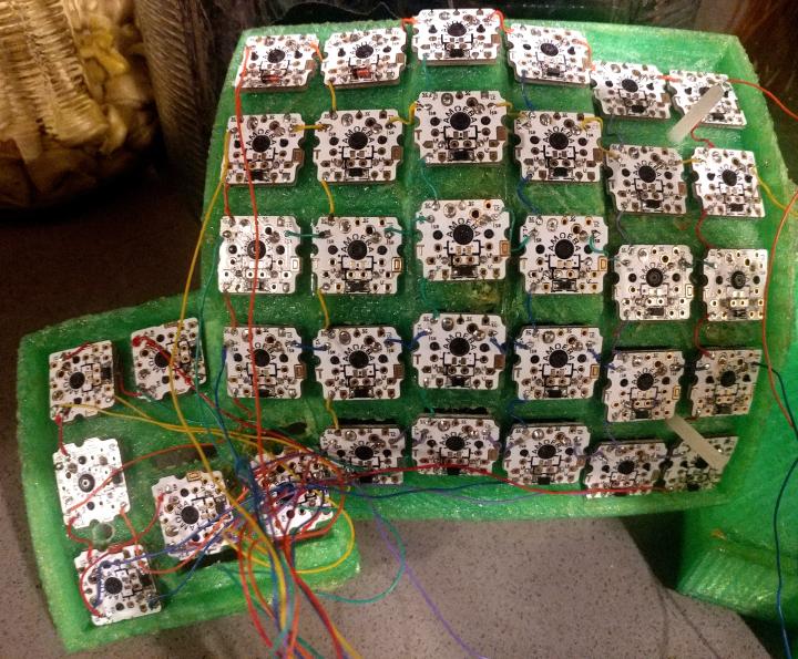

Nice work mtl. I'd like to try Royale for a hand wire I'm doing with a "flat board" LK201. I ordered from OSH Park to check it out.
I was thinking that I would go for long rows from a sheet, i.e. break the sheet at the row boundaries. And then screw the row to the top plate every 3rd or 4th switch via riser. I like the idea of less wires for my hand wire. I like hot swap. I don't care about LEDs. The LK201 had these strange plastic blocks for their giant membrane plungers. I'm printing my own with modifications to have cherry mx holes and greater width in the vertical direction to accomodate the Royale but yet allow the plastic blocks to have their feet go into the bottom plate holes. Kind of fun, I hope it works.
plastic block upside down, feet that go into the metal base plate pointing up:
here is orig plastic block side by side with a previous rev of my printed mod:
and here's a rough cut-away of what I'm trying to do:

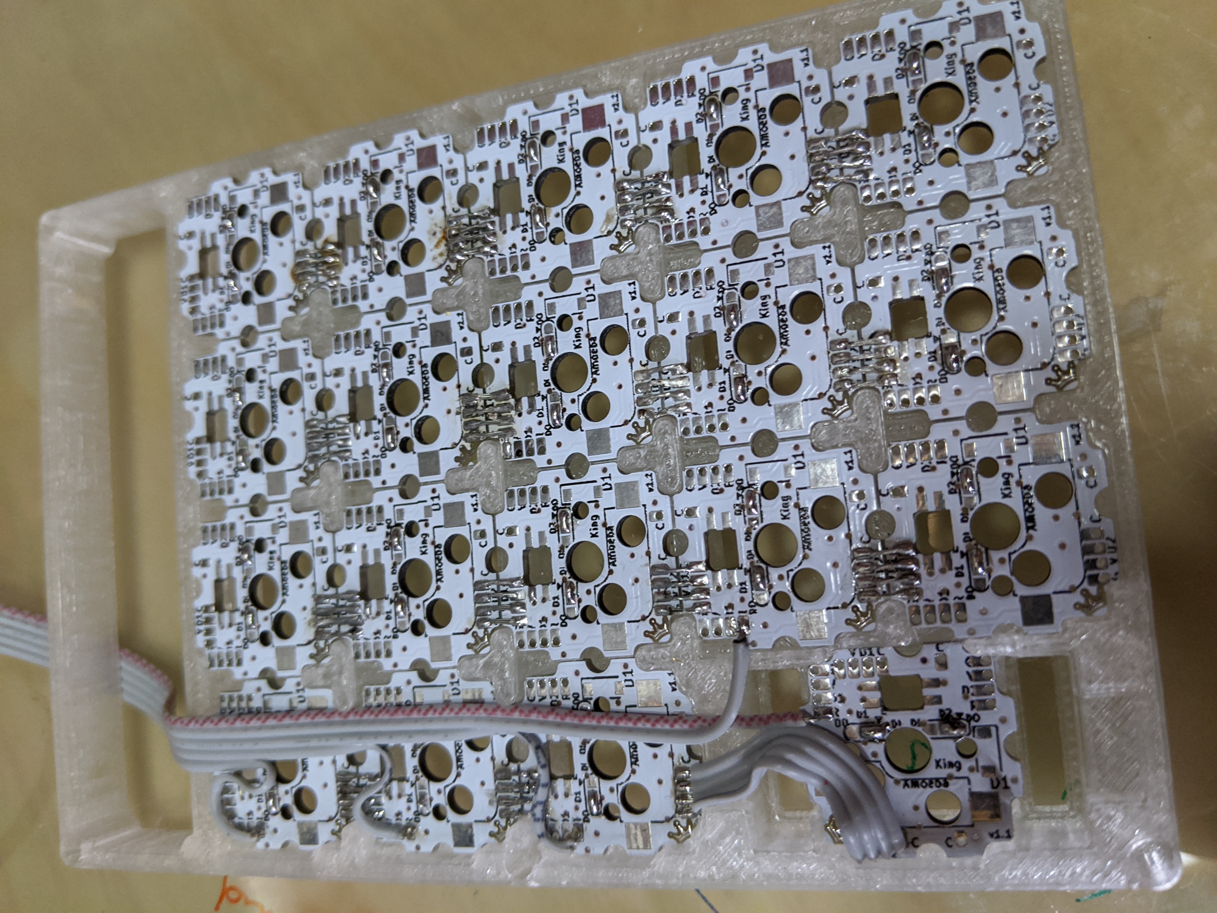

SuperAmi
09 Jun 2020, 10:17
SlientClick wrote: 05 Jun 2020, 16:46
Razerban wrote: 05 Jun 2020, 13:40 @SuperAmi: Did you order the corrected version from JLCPCB ? Have you received them yet ?
Also, did you have time to post the gerbers on Github ?
Thanks for your efforts!
This, in the middle of build a tiny tight dactyl prototype right now and this board would be perfect for the next iteration!
I got the boards back on Thursday. That makes two revisions, and I'm still waiting on the sockets, LEDs, diodes and other parts from AliExpress. I guess they are more Ali than Express... :?
I was waiting to post until I had a chance to actually verify the design and clean up the files. Its my first KiCAD project and I don't think I have the libraries and other aspects setup cleanly, but if it will help, you are free to try it out. I have 5 16x5 panels and don't need them all. I can send you a panel, but unless you are in Europe the shipping is currently prohibitive due to COVID-19.
The Fork is here: https://github.com/JKing-B16/keyboard-p ... moeba-king
I basically added my work under the amoeba-king folder. I've also added some initial work on an OpenSCAD library for a 3D design to hold the boards. I'm currently working on an ErgoDox-Dactyl layout. I've also started in on a Numpad keyboard as an initial prototype of the 3D design and to practice soldering techniques, but you can find a rough layout for my Dactyl design in the columns.scad file as well. The SCAD is based around a single key module that holds the PCB fairly well. There is a grip version for single boards that grips the bottom of the board as well.
My plan is to use standard ribbon cable to connect up the LED's/rows/columns. This hasn't been as easy as I'd hoped. A lot has to do with the short connections. They transfer heat to easily. Combine that with the stranded cable in ribbon cables, and you get bus wire that sometimes becomes a bus bush. If anyone knows a decent source for solid-core ribbon cable, that would be great.
Switching to a leaded solder allowed me to lower the heat and improved my success rate. The best technique so far was to take 4 wires of ribbon cable, strip them together and insert them carefully into the board, solder them to one board, trim the cable to length, and then pull off the insulation and solder the other side. I think for longer runs, like a dactyl layout, you could get back in with the strippers and actually leave the sheathing on, but for short runs there is not enough meat to grab.
Here is a short preview of soldering. https://youtu.be/Nhtp69AZE4M
Here is an image of the bus wire soldered. I'm still waiting on the solid core wire delivery to finish up the row and LED soldering.
As you can see in the video, when it works, its really nice, but I had to resolder every third try.
I am glad I increased the pad size on the connectors. It makes for easy surface soldering as well.
I'll try to post more, once the rest of the parts arrive in the next 2-3 weeks.

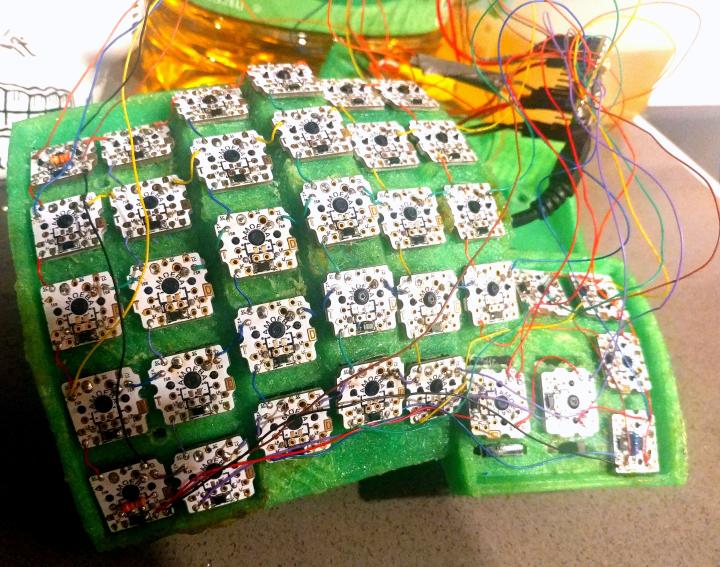

Finished my hand-wired version just yesterday. Will be watching your results. Thanks for you work on this btw!!!

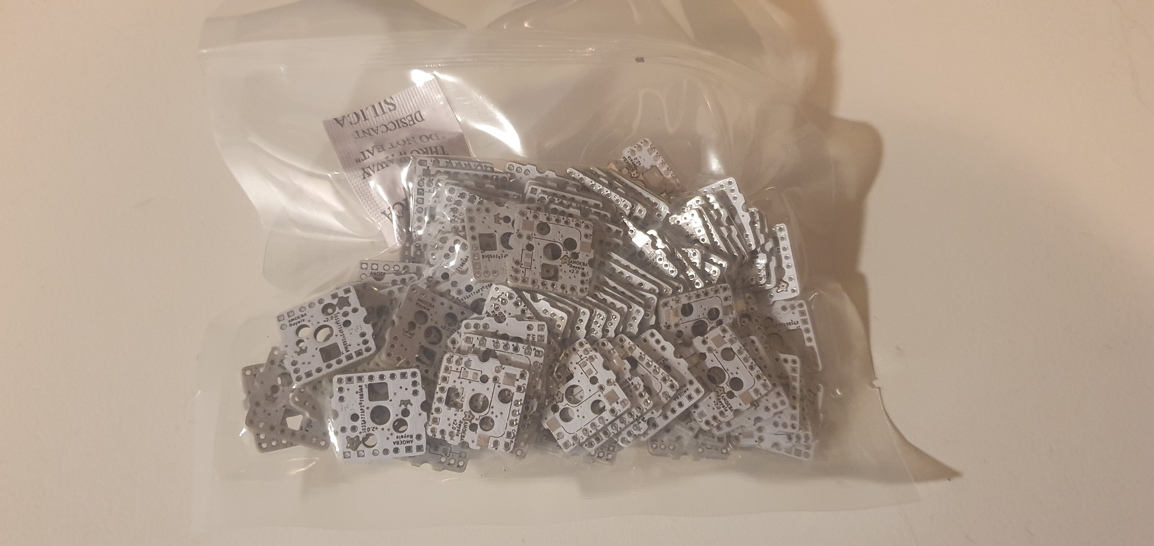

Disclaimer: I sell those, this is my main source of income. If this is a problem I can delete/modify the post.
So here's the different PCBs I'm making:
- a single-switch PCB (already being sold), with hotswap for MX and Choc low-profile (no RGB). I use this one in my Dactyl Manuforms
- a 2u PCB with stabs and sk6812 mini-e RGB. This has been asked to me by multiple people, I've taken the edge cuts of the amoeba 2u as basis when I found out about it.
- a 6x6 plate with 19.05mm spaced single-switch pcbs, with MX hotswap and sk6812 mini-e RGB
Now the last one is the most interesting, as everything is already connected on the 6x6 board - rows, cols, Vcc, Gnd and Din/Dout for the rgbs per-line.
So in practice it's a 6x6 orthogonal board, which can be "cut" in smaller pieces to make an otho board of any size... all the while having vcc, gnd, the rows and cols, Din/Dout already wired. This is the one I'm most excited for.
Let me know what you think, I can also post some screenshots.

Hey yoshi and Takeko,
Here are my 2 cents on a per-key rgb dactyl:
The ISF might work, but you might not need it if you have around 60 keys or less. The wiring will be a hassle. Also consider that to use an ISF you need RGB leds with one pin per R, G, B + common anode or cathode.
This means that for each single-key pcb, you will need 4 wires that go to the ISF.
If you chose to go without ISF, then you need to use SK or WS rgb leds. In this case, you will also need to connect GND, VCC and Din/Dout inbetween each PCB.
Both solutions require a lot of soldering, and imo is not for the faint of heart.
I have wired dozens of Dactyl Manuforms at this point, and even now I'm not considering per-key RGB.
The PCB mentioned on the reddit thread is something akin to what I'm working on, albeit mine will be made for orthogonal boards - but I don't see a reason why you wouldn't be able to break it apart to 1us.
Please, don't hesitate to let me know if you have any questions about the Dactyls, I have some experience building them...
Cheers
Pluna
15 Aug 2020, 11:33
I have used the Amoeba King PCB to create a dactyl manuform with SK6812MINI-E on every switch.
It worked great.
Thank you for sharing your PCB design.

bstiq
23 Oct 2020, 15:04
Hey guys,
This hasn't been updated in a long time.
I got my 3 PCBs working:
- 1u Hotswap MX
- 2u RGB MX
- 6x6 breakaway ortholinear per-key RGB hotswap prototyping board
Since we are not gonna carry them on the shop, we decided to open-source them.
You can find them on the Github: https://github.com/HID-Technologies/
There's the kicad files, the gerbers (in the release section), and some information there.
Cheers

Just logged in to post a thank you for this design. Here's 1 half of my current use case complete.
Edited to post the other half
