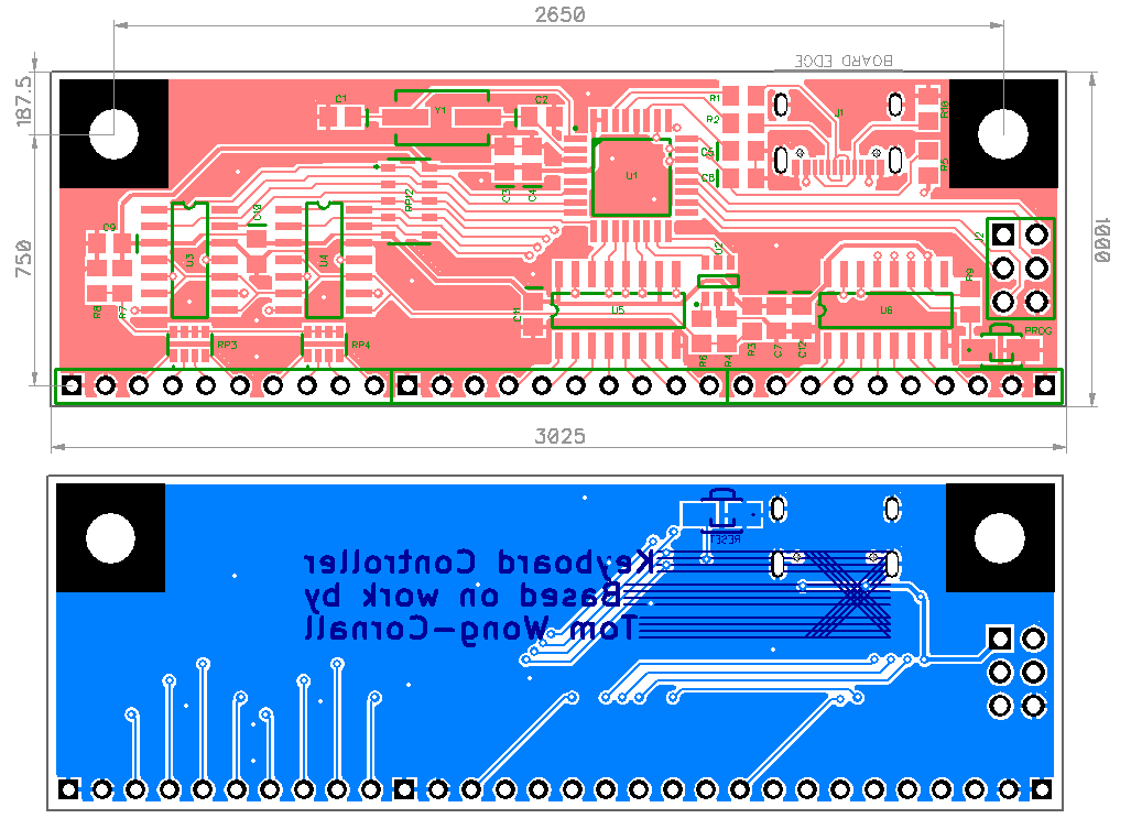

An update - I tested a third USB cable that is 2 feet (the first two tested were 10 foot cables like the ones that will be used with the F62/F77 project. So far the smaller cable works 100% with no disconnections or crashing.
So I think it may be an issue with the value of the resistors for the USB connector - maybe they need to be adjusted to allow for longer USB cable lengths? Any ideas?
After that the major problem is the one key !1 / 192 issue, and also the high voltage when strobing the columns (not sure if the latter makes a difference in the controller operation.

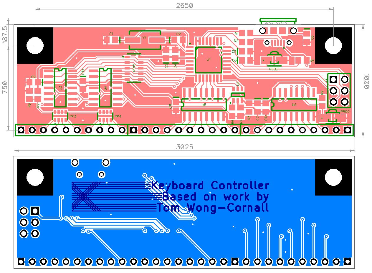

wcass
20 May 2016, 04:22
That is some good clues.
Longer USB cable would have greater resistance than shorter USB cable - so maybe i need to lower the resistance at R1 and R2 on the D+ and D- lines. That would be easy to check.
Another thing might be that the D+ and D- lines pass right next to the crystal. Maybe i need to route the USB lines away from the crystal.
I'll draw that up this weekend.
wcass
21 May 2016, 06:16
Same size. I just moved the USB connector to leave the crystal more isolated. I also changed row order so that trace length from MCU to rows is more uniform.
Ellipse
29 May 2016, 20:53
wcass your new design may do the trick, hopefully minimizing noise on the data lines for the USB - not sure if we should try further resistor/capacitor adjustments on the current compact xwhatsit controllers to be sure.

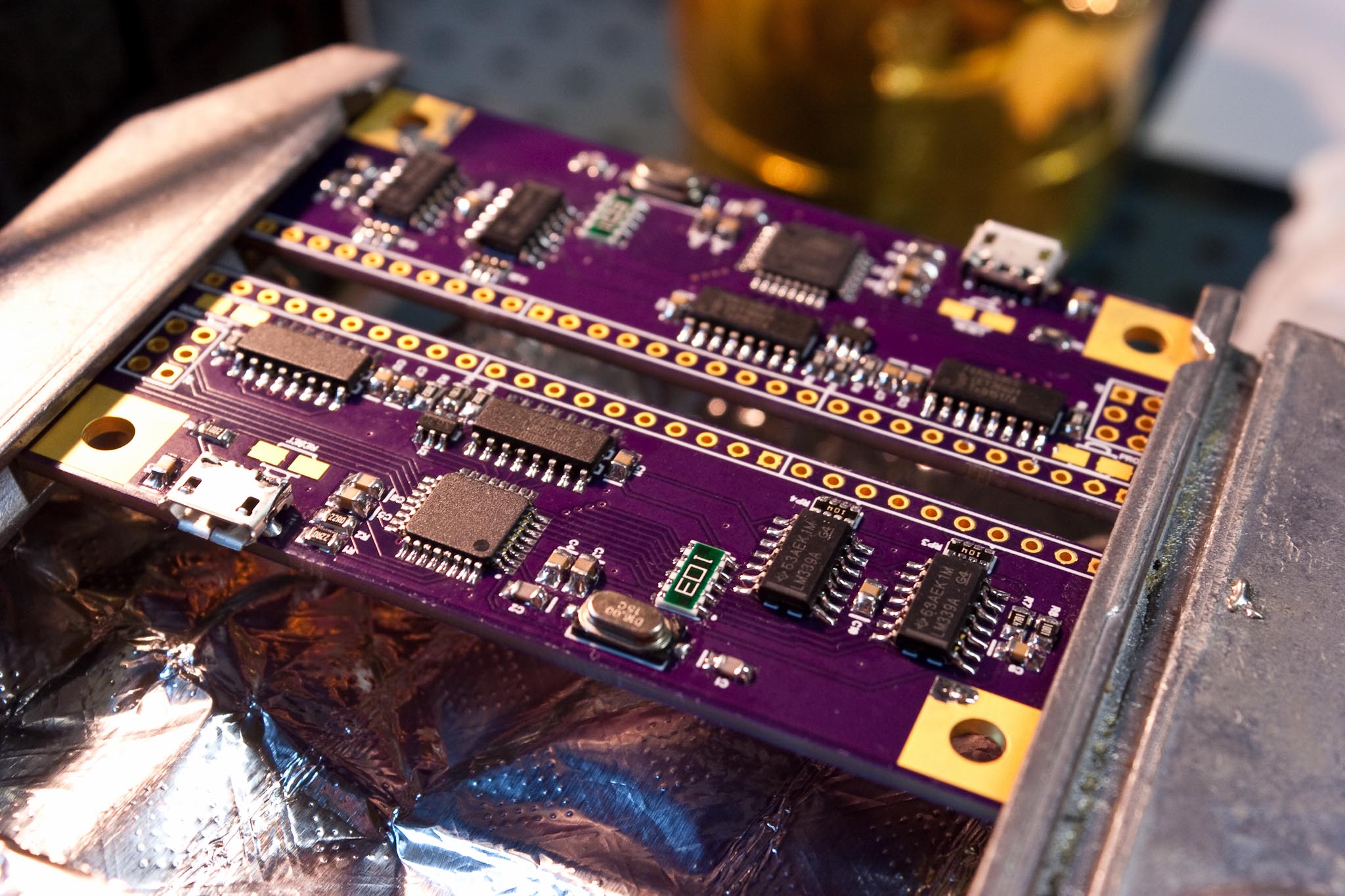

phosphorglow
02 Jul 2016, 19:37
Super exciting stuff! My apologies for not being more useful and taking forever to actually get the soldering done... ;P
Just as Ellipse said - big thanks to red, wcass, joc, Ellipse, and xwhatsit for creating the whole thing in the first place.
Here's a bunch of hand soldered silliness:

hbar
15 Jul 2016, 09:37
phosphorglow wrote: Here's a bunch of hand soldered silliness:
If that doesn't prove that soldering SMD is no harder than THT, nothing does. Good work!

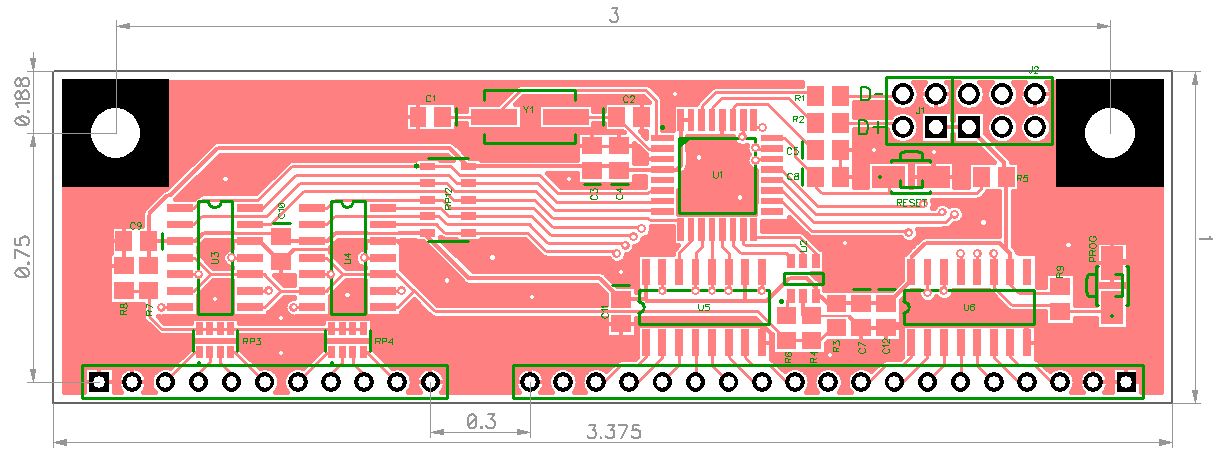

wcass
30 Jan 2020, 02:02
I actually did design a version with USB-C connector and one with USB breakout pads.
The USB-C connector is larger (in one demension) than micro USB and requires an additional resistor, so i had to move some stuff around and i think that C6 was eliminated because of that. I think i determined that it was not necessary. The crystal footprint is 7x4.1mm. Example: ABLS7M2-16.000MHZ-D-2Y-T
I have not built either of these variants, but they are based on this version. Let me see if i can find those ...
wcass8b.zip
(45.29 KiB) Downloaded 300 times
wcass
30 Jan 2020, 02:23
i just realized that the width changed. i am sure there was some reason for it, but ... i have no idea why that happened.

wcass
31 Jan 2020, 06:45
The files for USB-C.
As stated, the connector is larger so some things needed to move around. I had to move the Reset switch to the back.
xwhatsit USB-C.png (54.89 KiB) Viewed 11840 times
