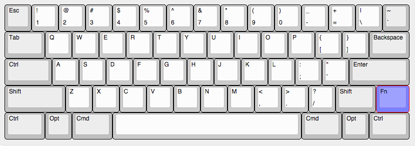

I'd go for a 1.75u stepped right Shift any day. No problem to me if I get HHKB layout from it! In fact, you could consider the step a useful prompt that this is no ordinary wasteful 2.75u Shift key!
Hypersphere
08 Dec 2014, 00:25
Muirium wrote: I'd go for a 1.75u stepped right Shift any day. No problem to me if I get HHKB layout from it! In fact, you could consider the step a useful prompt that this is no ordinary wasteful 2.75u Shift key!
Yes, there is something to be said for taking a stand against that monstrosity, the 2.75x Right Shift!
Provided the stem is centered under the 1.75x stepped key, I might end up swapping it out for a centered 1.50x key, and if Unicomp cannot be persuaded to print an "Enter" and/or an Enter arrow on the key, I know that they will supply unprinted 1.50x keys. I am actually fine with a 1.25x Right Shift, although this is my limit. I've tried keyboards with 1.00x Right Shift keys, and I tend to miss the key and hit the edges of others.
This opens up other possibilities for the Right Shift and Fn key to its right:
Right Shift: 1.25x, 1.50x, 1.75x
Fn (to right of Right Shift: 1.50x, 1.25x, 1.00x
It might look weird to have Fn larger than Right Shift, so the second option of 1.50x Right Shift and 1.25x Fn looks good.
08 Dec 2014, 00:45
Yup, just like Scott said:
scottc wrote: It might make more sense to have 1.5 + 1.25 instead of 1.75 + 1.0. It's not a perfect HHKB, but it works.
I'x prefer a perfect 1.75u right Shift, and failing that a stepped one, but this is a great compromise if we need it.
As for the bottom row, 7u spacebar symmetry like the Kishsaver is my favourite. The HHKB was always short a couple of outboard mods.

Isn't this sacrilege, at least on the HHKB side? Will you provoke the wrath of Wada? But perhaps this is counterbalanced by upholding the rite of Kish. The result maintains the symmetry of the HHKB but adds two modifiers, so that we end up with:
1.50, 1.00, 1.50, 7,00, 1.50, 1.00, 1.50.
Thus, Revision 3 would look like this:
And here is the link to the layout:
http://www.keyboard-layout-editor.com/# ... c83707baf7
This is not bad at all. It requires only the CapsLock position to have a stepped 1.75x key, and Unicomp has blanks and Ctrl keys available.
One additional revision that could be considered is to shorten the Left Shift to 1.25x and to put an additional Fn key to its right (this one would be 1.00x). I have this arrangement on my XT just for symmetry of sorts, but in practice I never use the left Fn key.

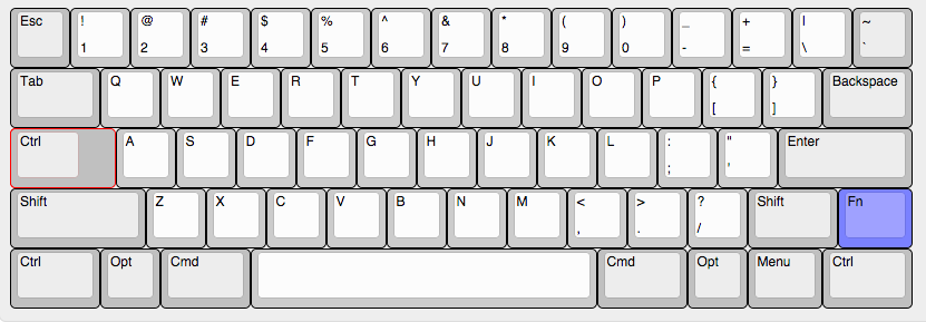

Thanks for these insights. I am fine with the 7.00x spacebar, which enables preservation of symmetry on the bottom row. At the same time, I am in favor of having a smaller spacebar. However, I think that the 7.00x spacebars might be more plentiful and also available in black. Regarding Unicomp colors, I prefer Pebble or Black rather than Gray for mods.
Here is HHKB-Rev4 with a 5.75x spacebar:
This revision explicitly shows that the 1.75x key in the customary CapsLock position is stepped. I don't mind having a stepped key in this spot. However, the bottom row is starting to look cluttered. While I like having a shorter spacebar, aesthetically, I prefer HHKB-Rev3 which has a nice symmetry.
0100010
08 Dec 2014, 15:31
I prefer the 7x spacebar or the 2.75 - 1.5 - 2.75 split space bar.
Hypersphere
08 Dec 2014, 16:00
0100010 wrote: I prefer the 7x spacebar or the 2.75 - 1.5 - 2.75 split space bar.
As do I. Symmetry! I should add that I favor the 7x spacebar version: symmetry plus simplicity.

08 Dec 2014, 16:51
I like the one I suggested, too!
Webwit may well be right it's insufficiently Wada, but I very much like the specific ways it deviates from the HHKB. Note the inner symmetry in the inverted T block of right Shift and its underlying mods? Handy for long cursor sessions in a layer lock! I use mods with my thumbs (cue Jacobius calling me a hypocrite*) so the overall bottom row symmetry is an advantage over the HHKB's vertical alignment at the cost of horizontal balance.
*Never one to fear being hypocritical, I have a bit of a defence on this one. I loathe tilted "thumb keys" but I don't mind normal mods on my thumbs at all. The spacebar is the one I actually rest on, and desire convex curved. I like the distinction between spacebar and the other keys. While I also like the homogeny of mods with the upper rows.
Hypersphere
08 Dec 2014, 17:56
@Muirium: Yes, I think this is my favorite as well. It is "HHKB-Rev3" above.
The only tiny downside is that I like light blue Fn keys, and Unicomp does not (yet) produce custom keys in color except for 1.00x. However, I have been gravitating to blank mods anyway, and Unicomp does provide all sizes of blank keys.
08 Dec 2014, 19:01
HHKB Rev. 3 / HHμB is exactly what I'd go for.

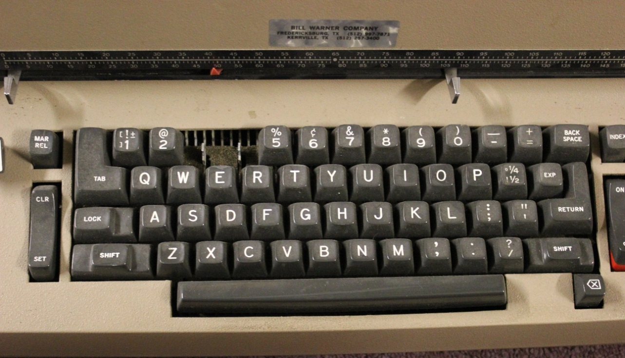

That being said, I am stripping 3 Selectrics, and have 3 full sets of caps for sale. Somebody make me an offer and take them home. Pics tomorrow.

Which model and year of Selectric? And are the caps spherical double-shots?
elecplus
09 Dec 2014, 02:21
Yes, spherical double shots, pics tomorrow. THe Selectrics are brown, if that helps. Selectric IIs, I think.
Like these, I think http://s694.photobucket.com/user/mycadd ... 2.jpg.html
elecplus
09 Dec 2014, 23:33

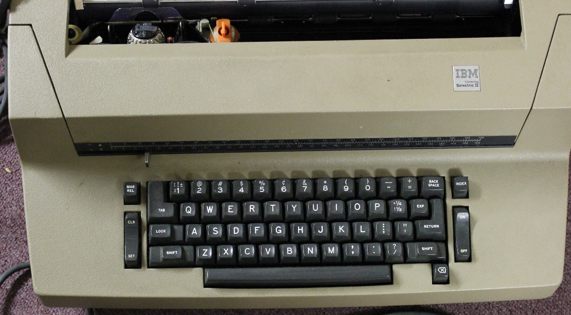

IBM Selectric II, there are 3 of these to be scrapped. All the keys are there, I just pulled 2 to show the wire they sit on.
One does not power on, 2 do, but neither one works. So off to the grinder they go.
Shiny scooped caps! Kind of a dark charcoal grey color, white on the bottom side of the caps.
