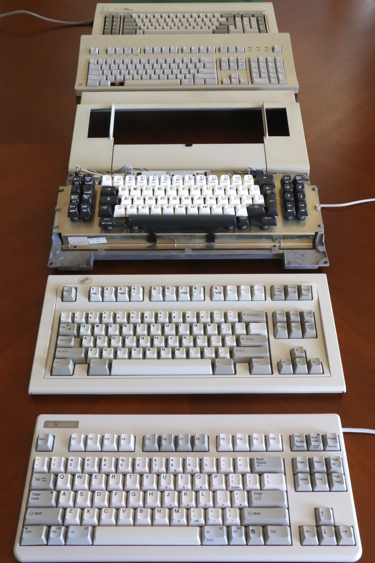

These are all new to me. And the bottom one came brand new! It's the only one I've used, as I've conversion work to do. Including, thankfully, Xwhatsit's Controller:
When you can't Model F, go straight to beam.

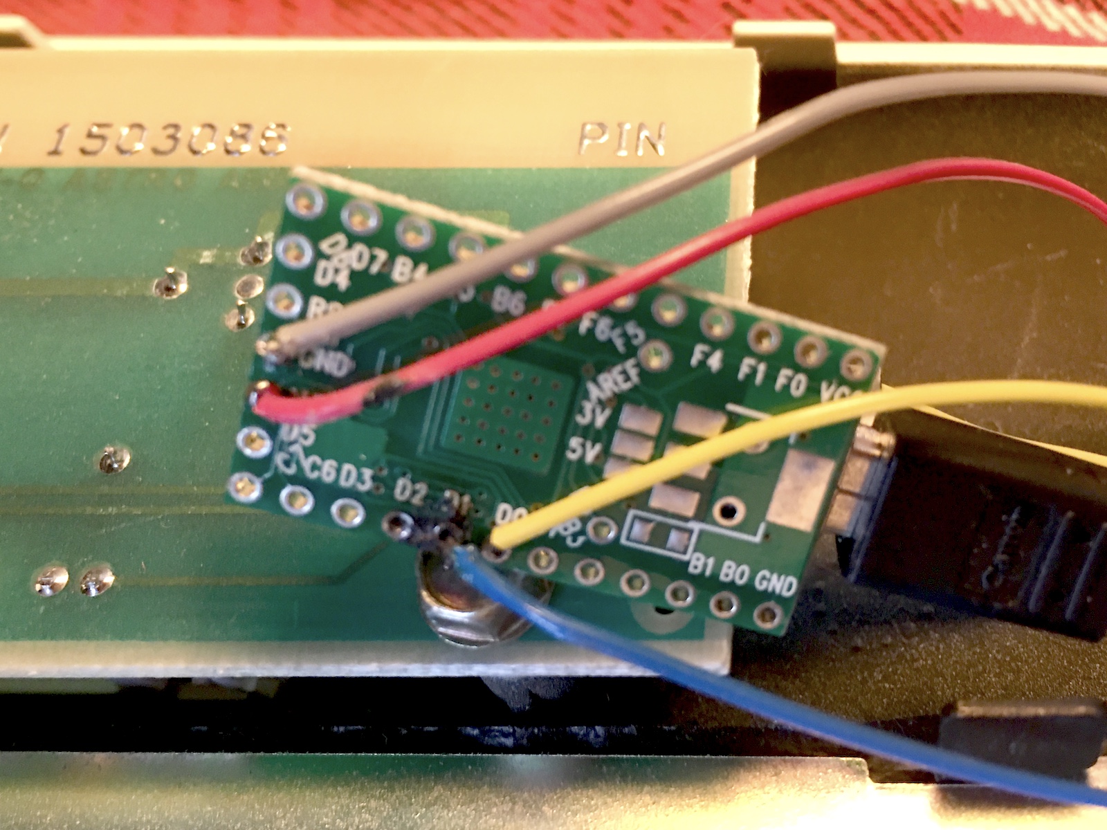

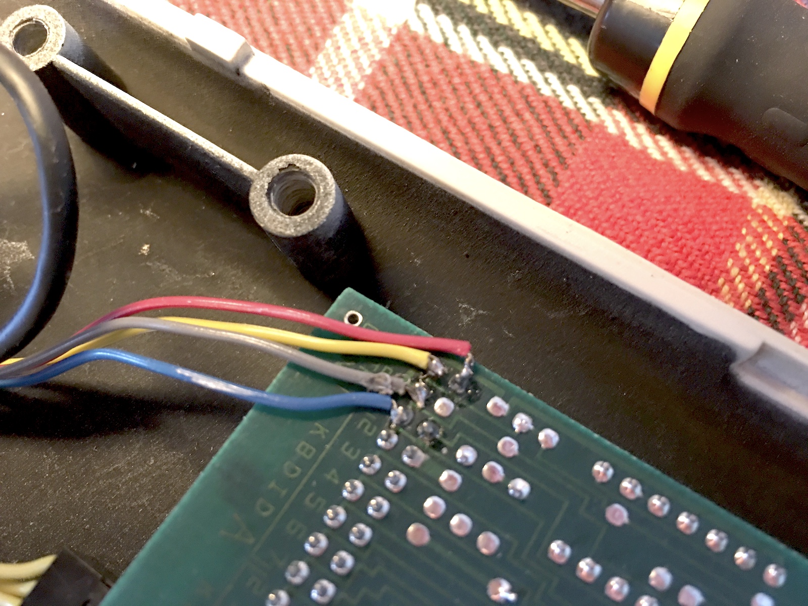

Kmnov messaged me to ask about (their missing) AT cable's pinout. I don't know where I put mine (it was in a sticky state) so I cracked open my AT to take a couple of pics of my hacky Teensy job, done a few years ago. Yes, prepare yourselves for some charred solder work! Not my finest job, but it's held up.
First, here's the underside of the controller. I simply hooked into the cable's pins individually, from below:

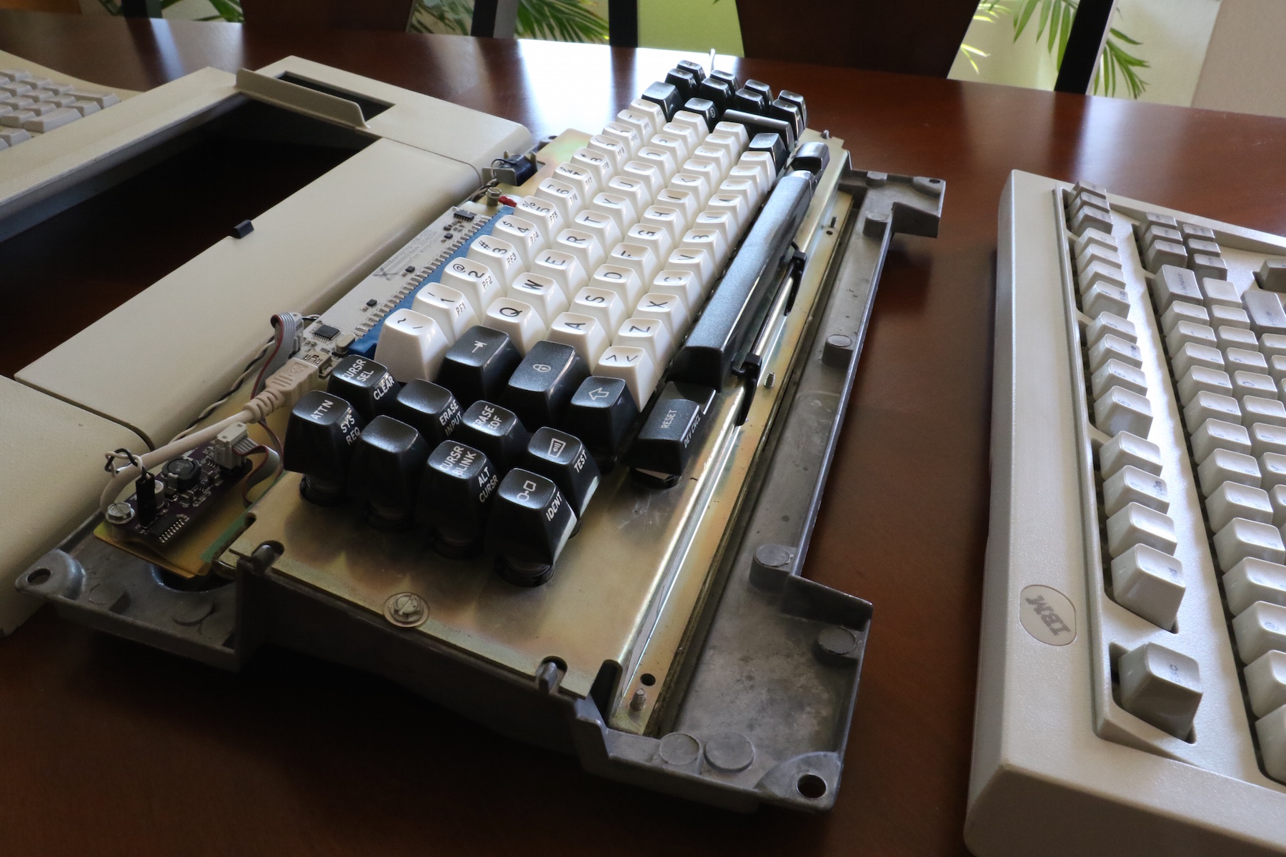

And here's where my four connections meet my Teensy, usually tucked into the space above the LED PCB, but pulled out here to take a look:
As we all know, PD0 is data and PD1 is clock. So the colours are:
  • GND = grey
  • V++ = red
  • DAT = yellow
  • CLK = blue
Because Soarer's converter's tools (scas, scwr, etc.) are 32 bit, they're incompatible with Mac OS Catalina. That's not a huge problem, but I do like to play around with layers from time to time, so I'm tempted to do a better job installing an Xwhatsit Controller PCB I have spare anyway. But this setup, and these wires, works for sure.
Oh, one more thing: originally, I installed a Pro Micro. Didn't work. The AT seems to be too much power draw for the wee Arduino. But a Teensy handles it.

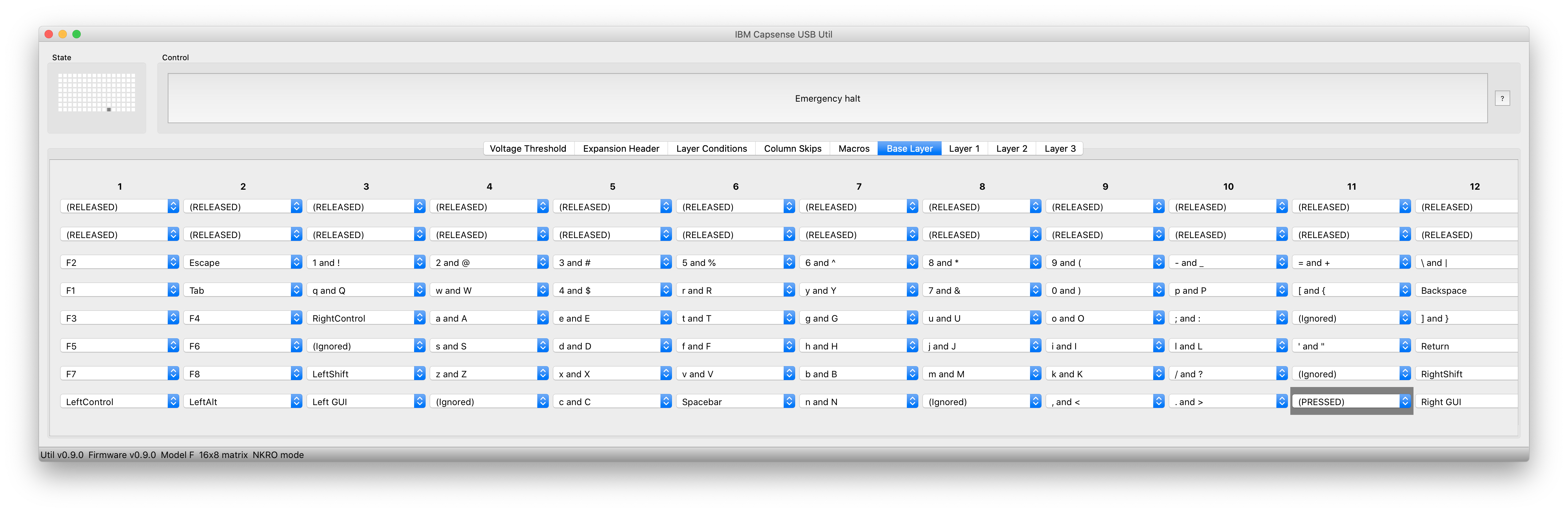

As threatened, I whipped out the original controller, and my Teensy, and have my AT running on Xwhatsit now. Must say I do love his controller software! It's a joy to use a GUI for this kind of matrix work. Here's what that looks like, now I'm all set up:
Screenshot 2019-09-26 at 11.41.47 pm.png (317.71 KiB) Viewed 10824 times
An extra bonus is I can use this keyboard with the iPad now it's lost its power draining IBM controller. Nice to have the AT up at Kishsaver level functionality after all these years!
Actually, one thing I forgot was the LEDs. As Xwhatsit says in his manual, IBM's cable needs some rearranging to work. That'll be my next project inside this auld beastie.

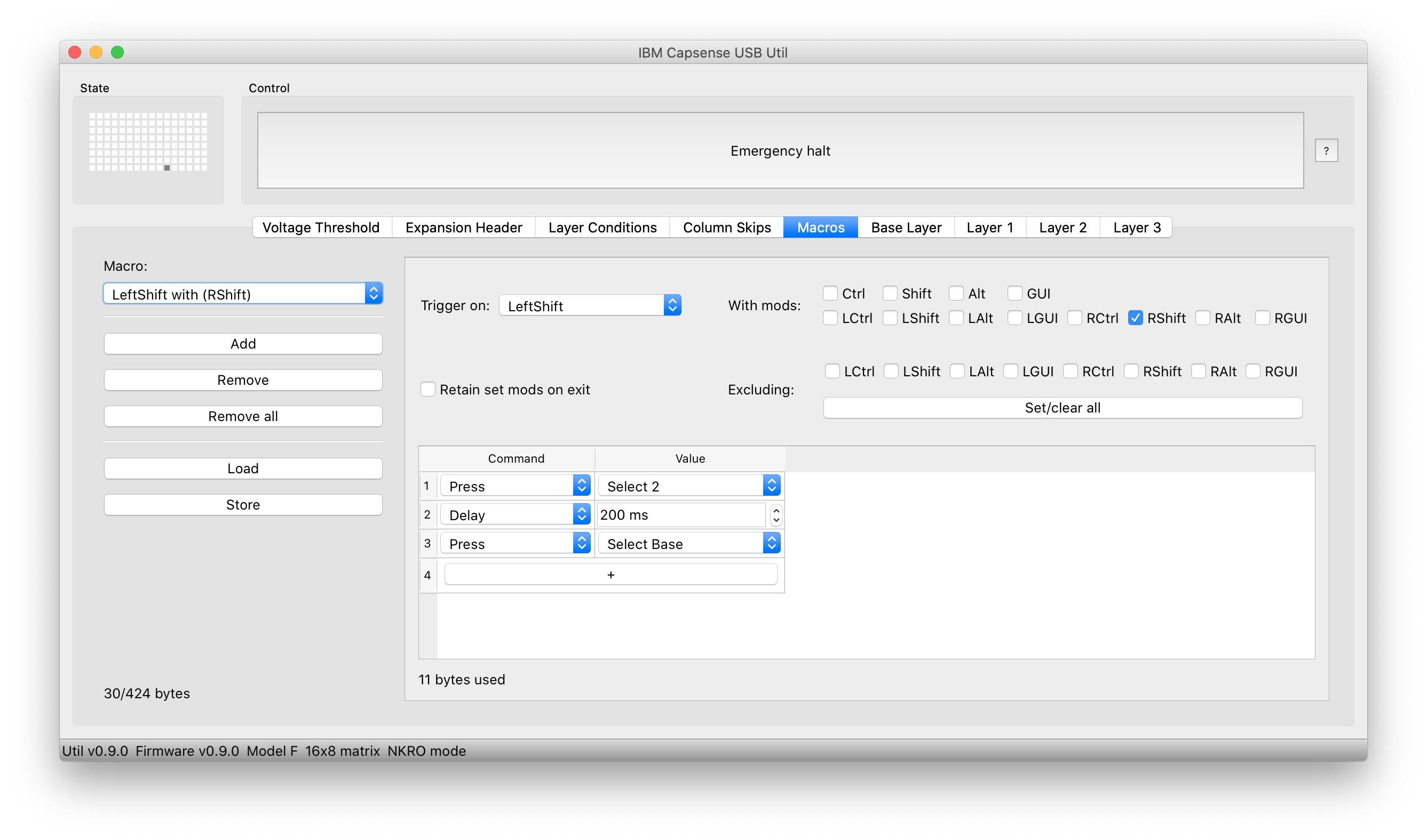

Actually, here's some cunningness I'd like to share, entirely in the GUI.
I like to have Control on the key left of A. Caps Lock is one of those keys I seldom use, but when I do want it, I have it tucked away in a super obvious macro: Shift + Shift = Caps Lock. Done that for years. I'm not kidding when I say I rarely use it: I only just noticed it wasn't working any more when I fixed up this AT! Plugging in my Kishsaver, I found it wasn't working any more there, either!
Caps Lock worked fine when I use it HHKB style: Fn + Tab = Caps Lock. And any other key was working fine as a macro on Shift + Shift. Only the combination was upfucked! It wasn't even a matter of needing to clear Shift inside the macro, as when I did that, it still didn't work; while Shift + Fn + Tab was still working fine. Gah!
After much experimentation, tea, swearing and head scratching, I figured out what was up. It's a timing issue. The Mac treats Caps Lock differently to other keys. Likely a safety measure against WHAT MY KEYBOARD BORKEN11 mishaps from people who, understandably, hit the damn thing inadvertently. Caps Lock needs to be pressed some arbitrary length of time. Fast enough that I don't notice it in practice, but slow enough that Xwhatsit's macros broke. They press and release keys too quickly. And there's no obvious way to slow them down; with no MAKE or BREAK options, only combined PRESS.
So what did I do? This:
Screenshot 2019-09-27 at 2.44.55 pm.png (274.94 KiB) Viewed 10775 times
Wot? No Caps Lock?
Yeah, I was crafty. What the macro does now is kick the keyboard into another layer for 0.2 seconds. While you're there, I remapped both Shift keys to Caps Lock. So what the keyboard sees is Shift + Shift turns into Caps Lock for 200 milliseconds, then back again. I made the original input into Caps Lock instead, so I could take my time and clear the OS's filter.
There are (and always were) two macros, actually. Left and Right Shift each have their own, to handle both available sequences of Shifts. The keyboard certainly knows which one you pressed first, even if it doesn't matter for our purposes. I learned that trick, along with the Shift + Shift macro itself, straight from Soarer.
So there you have it. BREATHE EASY NOW, YOU CAN SHOUT AGAIN! And toggle it off all elegant, like. Where there's programmability, there's a way.
