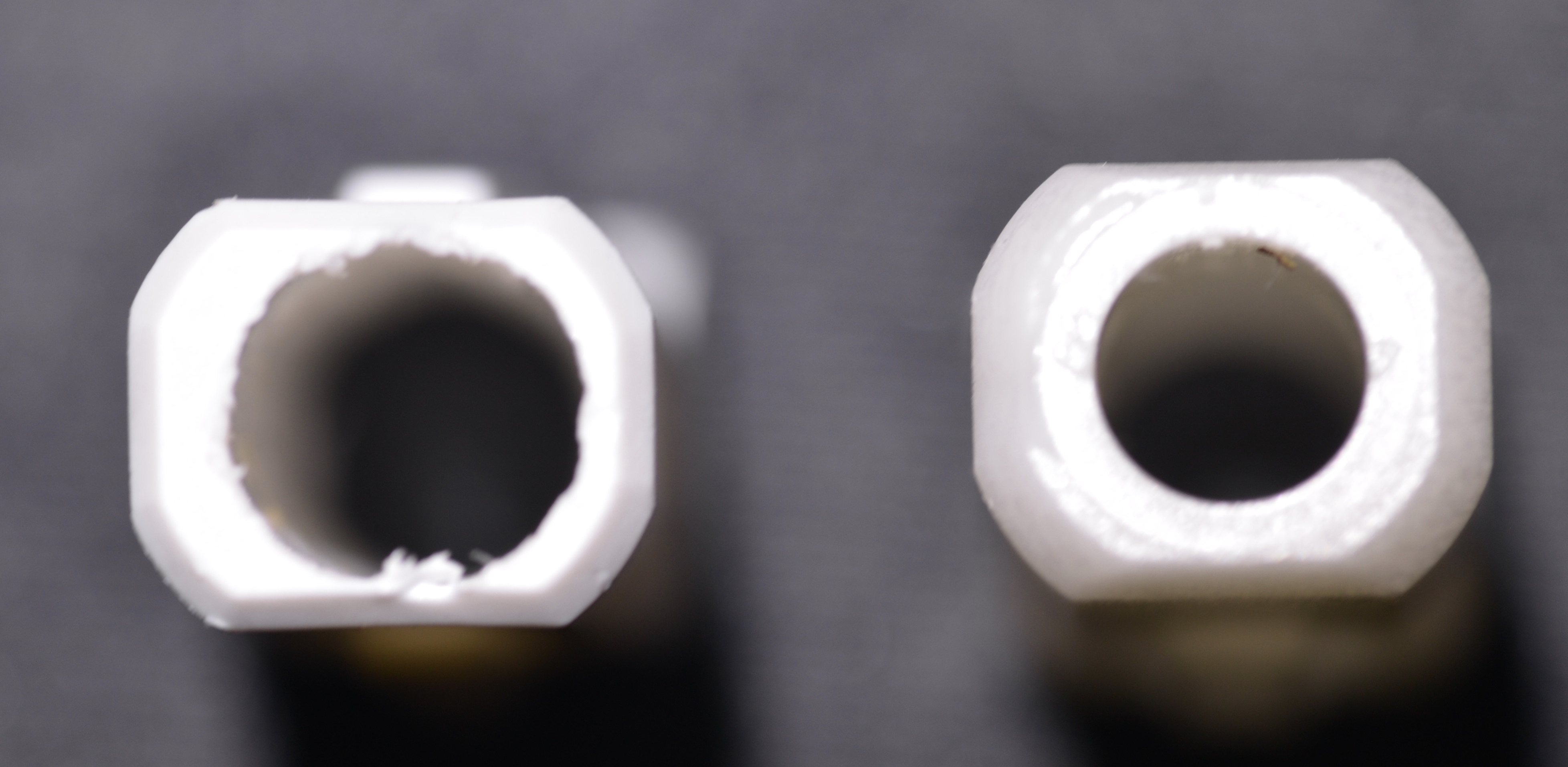

I am using an F77 for a spell. Serial number 835.
On the unit I have, which has a standard ANSI layout, the right Shift key was absolutely unusable in terms of stabilization. It came from the factory this way. Ellipse needs to get with the factory and tweak those molds, don't know how this got past quality control.
When I pulled the barrel stabilizer for the right Shift key it looked like it had been drilled out. This is a view of the stabilizers looking "up", from the PCB toward the ceiling. The left is the one I pulled from this F77 (with great effort using needle nose pliers, the fit is very tight compared to my Model Ms). The right is one I just pulled from a 1994 Lexmark M.
From years of experience with Model M keyboards: Never ever do this!!!
The "right" way to deal with stabilizer binding issues is to use a dry grease, such as Finish Line Extreme Fluoro, on the stabilizing pin of the right Shift key. But that internal taper on the stabilizer insert absolutely positively needs to be present in order to prevent the key from rotating too much about the Y (fore-aft) axis on its way down.
I may modify this board to use a wire stabilized right Shift key, those tend to behave better.
Ellipse
16 Mar 2021, 19:09
XMIT is correct - should not be drilling out inserts. XMIT please do show photos of the wire stabilizer mod if you don't mind - I do like those keys better!
While QCing hundreds of these keyboards, I have found a completely harmless way to eliminate stabilizer binding 100% of the time, without using grease or anything else. The issue is not with the insert.
As noted earlier, I have instructed the factory to test the 2U and wider keys for binding and to fix any that bind. You have to do some of the below steps several times in some instances of binding.
The full section from the project manual is copied below:
Key binding – 2.25U and larger keys getting stuck. Possible fixes:
Gently wiggle the key post (the part that goes into the stabilizer insert) a few times in the direction of the left and right sides of the key if you were to look at the key as oriented on a keyboard – seems to eliminate binding when the extreme edges of a key are pressed. Be very gentle as this is the easiest part to break on a key!
Gently squeeze key stem of the key a few times seems to make the key work 100% well and slide freely (try squeezing a few times, squeeze and hold for 10-30 seconds, and then squeeze and gently move the squeezed stem left and right while holding the key with your other hand). Your fingers should be positioned so as to squeeze deeply into the key, as deep as possible, not just at the very end of the key stem. A video on this fix: https://www.youtube.com/watch?v=VBgQ9AO1Z_c
Burnish back side of barrel with spring – use model m nut driver.
Keep stabilizer insert 1mm above top of barrel and there is no binding. Alternatively maybe add a 1mm piece of foam under side of key where stabilizer insert goes. Example story: “It seems like the left barrel (the empty one) on the space bar was binding a bit. I solved it by cutting a thin foam disk (about 2mm thick) and sticking that into the outer barrel on the bottom of the space bar. This limited the travel just enough to avoid binding. Once that was done, the keyboard was perfect.”
And one last method that worked: “I did add a little bit of Syncro Superlube and that did it. Thanks!”
[ XMIT ]
17 Mar 2021, 01:32
The person who previously had the board reports that they did not modify the stabilizer inserts, which means it was delivered to them with this drilled out looking stabilizer insert. Curious.
Ellipse
17 Mar 2021, 03:04
Today's dye sublimation update:
The factory has received the additional sublimation equipment and is custom manufacturing more jigs in order to sublimate with three machines at one time. Their goal is to have daily production capacity of about 180 jigs' worth of keys in total, as noted before.
They expect to set up the additional equipment and continue sublimating keys in the coming weeks and ramp up to full production in April. They expect to finish all the sublimation in May and continue express mailing me batches of keys periodically.
XMIT would you like me to mail you a replacement for the bad insert? Feel free to PM me your address and I'll throw one in the mail for you.

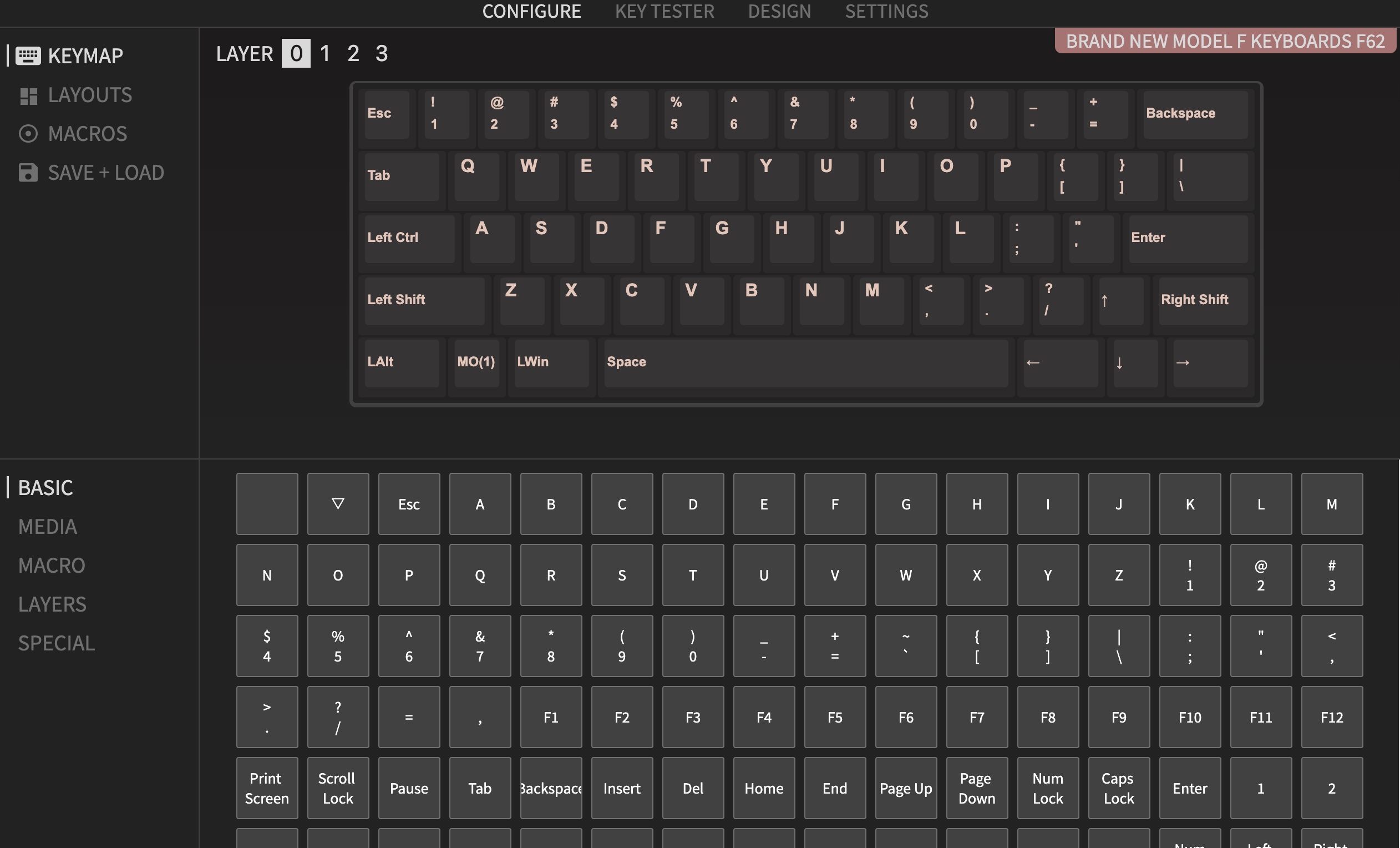

darkcruix
17 Mar 2021, 10:11
I have added the tested VIA files (Firmware, Layout, and small PDF that explains things).
They are built for the Brand New Model F (F62 and F77 - all layouts). Everyone who wants to test the easy to use VIA App to assign the key layout - you can download the latest versions from here:
https://www.bucklingspring.com/via-firmware-and-layout/
Screen Shot 2021-03-17 at 10.07.43.jpg (390.79 KiB) Viewed 10785 times

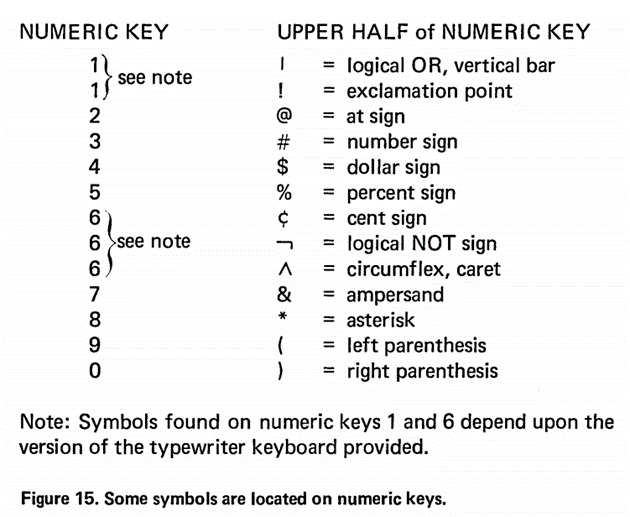

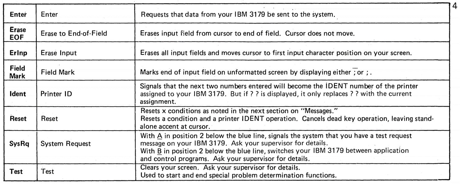

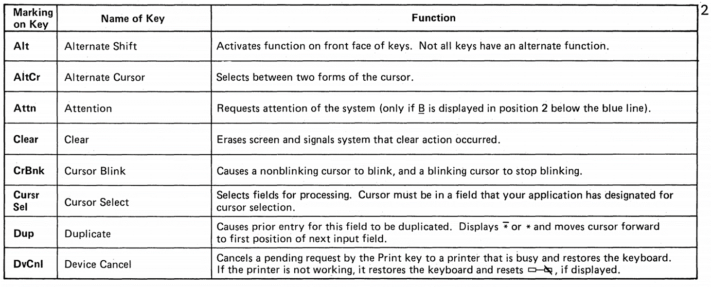

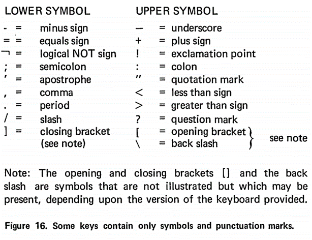

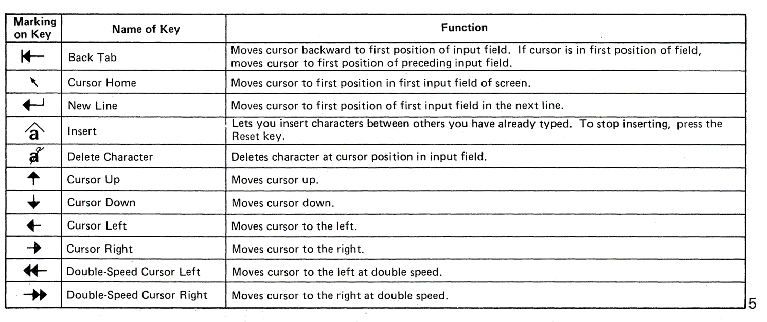

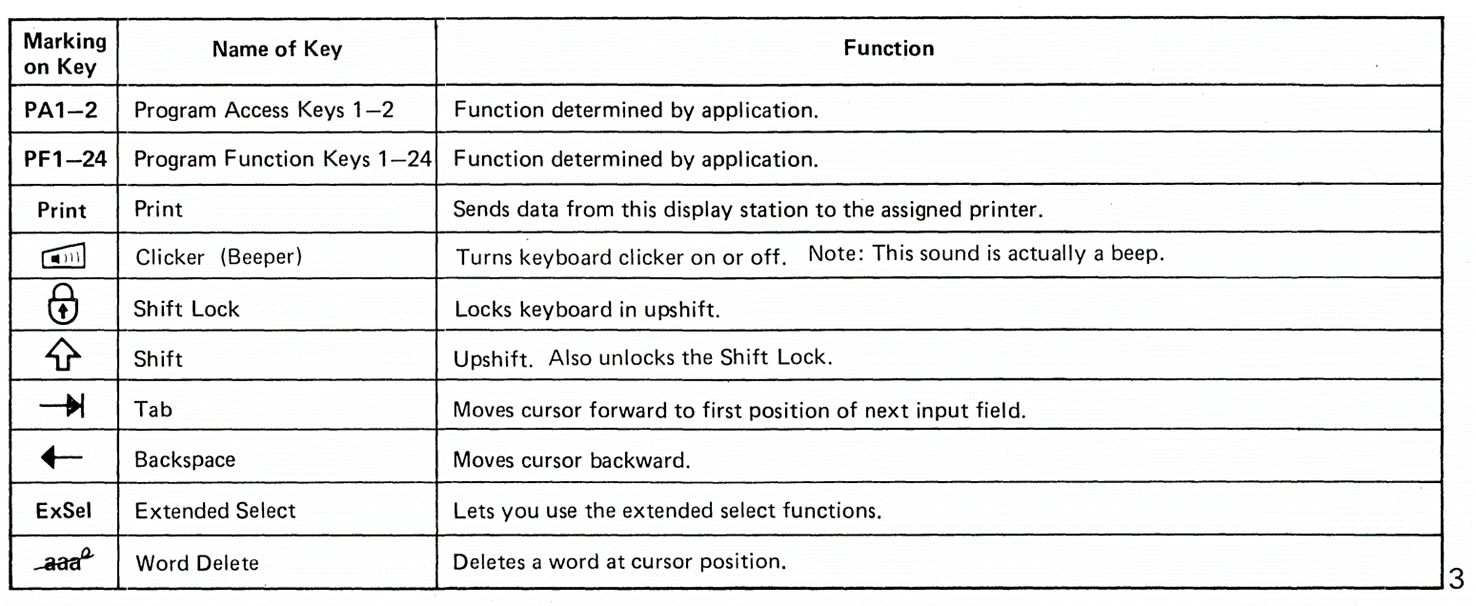

IBM Key legends and key descriptions
I have tallied the extra keys and submitted these keys to the factory, along with the finalized legend designs from forum member Zed. During this process I came across some old files describing some of the IBM Key legends and key descriptions for the key functions on their keyboards - hope it might be of interest. I had no idea what many of these keys actually did on the old terminals!
Copied below are pages from the IBM 3179 (F122 keyboard)
IBM key legends (3).png (136.93 KiB) Viewed 10517 times
IBM key legends (4).png (126.14 KiB) Viewed 10517 times
IBM key legends (5).png (122.57 KiB) Viewed 10517 times
IBM key legends (6).png (101.06 KiB) Viewed 10517 times
IBM key legends (1).png (40.44 KiB) Viewed 10517 times
IBM key legends (2).png (50.36 KiB) Viewed 10517 times
IBM 3270 Operations Guide 1972, pages 31-47 - see this link for details of the following keys and more
http://bitsavers.trailing-edge.com/pdf/ ... _Jul72.pdf

On GH darkcruix noted a great way to turn on and off the solenoid with keyboard key presses:
Will it be possible to turn a solenoid off and on through VIA, or is that functionality not possible through the software?
I have it set-up and it is working. You just need to choose "Any" and then type e.g. HPT_TOG or any of the other QMK options:
| Name | Description |
|`HPT_ON` | Turn haptic feedback on |
|`HPT_OFF` | Turn haptic feedback on |
|`HPT_TOG` | Toggle haptic feedback on/off |
|`HPT_RST` | Reset haptic feedback config to default |
|`HPT_FBK` | Toggle feedback to occur on keypress, release or both |
|`HPT_BUZ` | Toggle solenoid buzz on/off |
|`HPT_MODI` | Go to next DRV2605L waveform |
|`HPT_MODD` | Go to previous DRV2605L waveform |
|`HPT_CONT` | Toggle continuous haptic mode on/off |
|`HPT_CONI` | Increase DRV2605L continous haptic strength |
|`HPT_COND` | Decrease DRV2605L continous haptic strength |
|`HPT_DWLI` | Increase Solenoid dwell time |
|`HPT_DWLD` | Decrease Solenoid dwell time |
My note:
I tried this on the pandrew QMK configurator but with the HPT_BUZ and the solenoid toggle worked. The solenoid was by default set on.
Also the solenoid was activated even with pressing the Fn keys - I thought pressing the modifier keys and Fn keys are not supposed to activate the solenoid?

Ellipse wrote: 18 Mar 2021, 22:30 On GH darkcruix noted a great way to turn on and off the solenoid with keyboard key presses:
My note:
This is correct and I experienced the same issue. I have created a patch to exclude these keys in the source code of QMK, but need @pandrew to review it.
