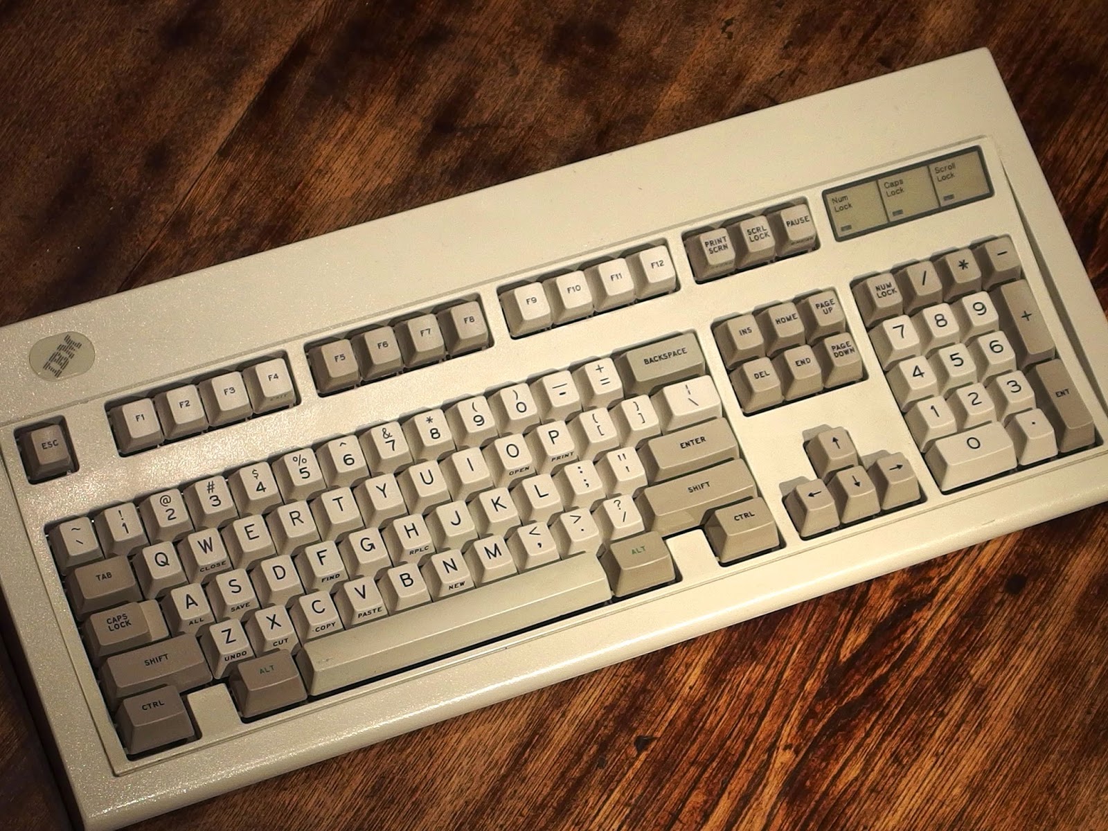

Jan Pospisil wrote: 20 Apr 2021, 20:28 I couldn't find any photos of model Fs with Czech caps, and the Ms I found were not very clear, sorry about that.
I haven't found pictures of F/M/M2 IBM keyboards with a Czech layout, BUT the layout the IBM PDF shows is consistent with the layouts _and_ pictures I've found of (IBM and non-IBM) Polish, Hungarian and (former-)Yugoslavian keyboards.
Those two pictures, indeed, show a Czech layout in agreement with the PDF, even though the front-printing can barely be identified.
Jan Pospisil wrote: 20 Apr 2021, 20:28 I don't honestly care about those, but if we're going for accuracy, I guess we should stick to the IBM pdf?
That would be my vote. If only to appease that "pretty judgy" guy. :mrgreen: :mrgreen:

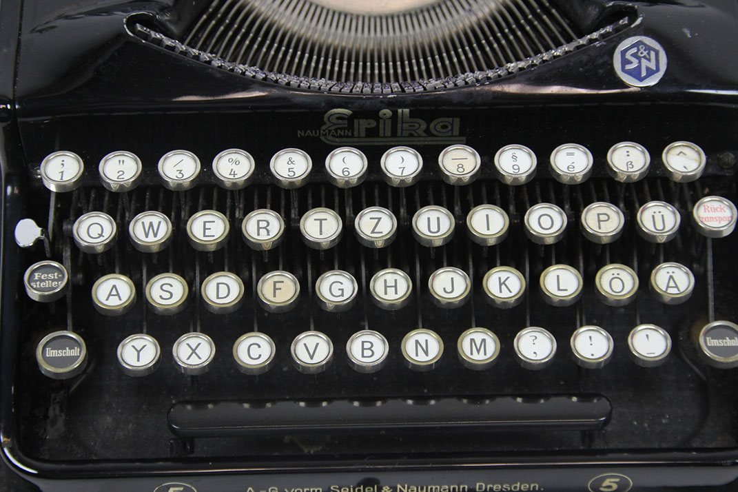

Jan Pospisil wrote: 20 Apr 2021, 20:28 Oh wow, that goes in depth. I don't really use layers beyond shift, so I don't have an opinion on that.
(and tbh, whoever wrote that is pretty judgy, I would NOT want to use their "fixed Czech" layout)
We definitely prefer QWERTZ.
I originally ordered (UK) ISO with a split right Shift, so that'd be my adjustments beyond just the Czech layout as shown in the IBM pdf.
So modern Czech kbs usually have (Z Y) on the Z and Y caps, with the default symbol in the top left corner. But neither of the Ms seem to have that. (so I wouldn't do that)
The older grey badge one seems to have secondary characters on some of the alphas, but not all that are shown in the IBM pdf. The newer blue badge doesn't have any that I can see.
edit: OK hold up, I might be wrong.
It really comes down to which operating system you are going to be using if you want to have the sub-legends match what the computer is doing. Or, if you just want a bunch of extra legends (I think Czech sets the record so far at least for the Latin languages) that look cool the IBM layout might be the way to go.

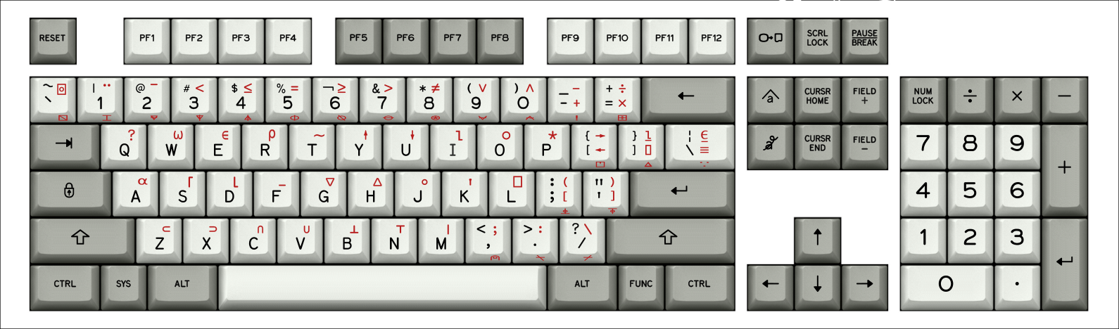

Although IBM used front printing for a lot of the national layouts, we are going with putting the AltGr legends on the top of the keys in the bottom right corner. This leaves room for front printed F Row legends on the number row as bonus feature.
I was just about to ask about that, that is a great solution!

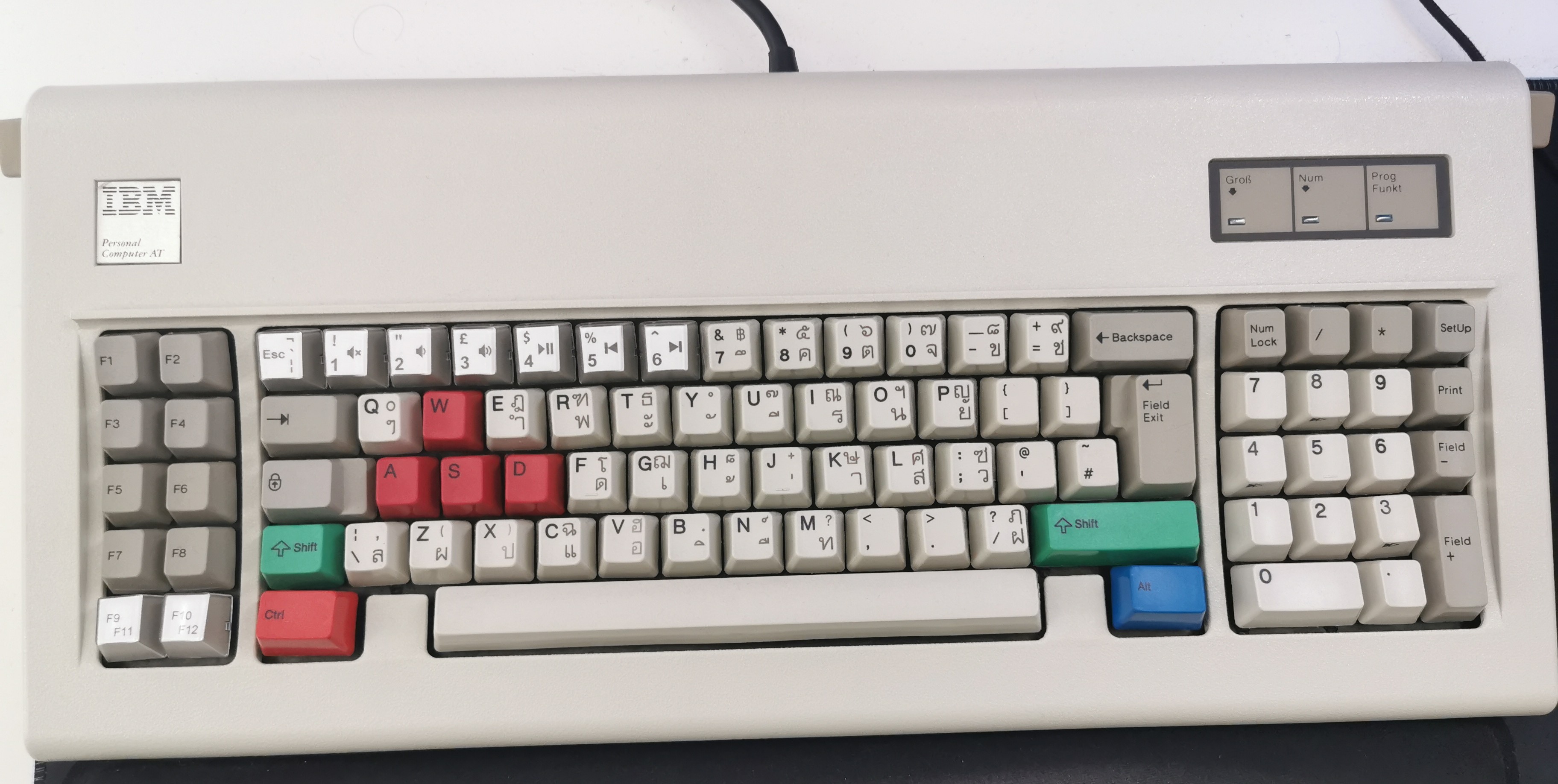

High quality Thai sublegends are kinda rare in mechanical keyboards, so I'd certainly purchase a set if one was made!
A bit of information if production is indeed considered. Thai keyboards are in ANSI layout. I have never seen one in ISO layout. I ordered my Model F in the split backspace HHKB layout, so the | \ ฅ ฃ key should come in 1u and 1.5u size. Special modifiers do not need to be made because they typically are in English.
The original specifications for the Thai layout has a slightly different number row.
The most common layout as used today.
As seen on an Apple keyboard. Note the 1u | \ ฅ ฅ key which is a by-product of the right side being chopped off slightly. Also the Caps Lock is label is replaced with ก/A , which performs the same function as Caps Lock, toggling lower and upper legends.
Many of the top right characters on the IBM Model F are in the wrong places. The number row is also much different from modern layouts. Typography is similar to Thai typewriter fonts, such as "DB Bradley Curved X". https://thaifaces.com/thaitype/bradley/#0
There are some slight differences between IBM's font and this one, such as ง having a downward curve and the ไ ๆ having more sharper, angular curves.
Another font IBM's is similar to is "DB TongSiam X". The ผ ฝ keys are a bit different.
https://thaifaces.com/thaitype/tongsiam/
The Model M also had Thai versions, but with a more modern font which has less character than the old typerwriter style font IMO. I think this user put Model M keycaps on his Model F AT.

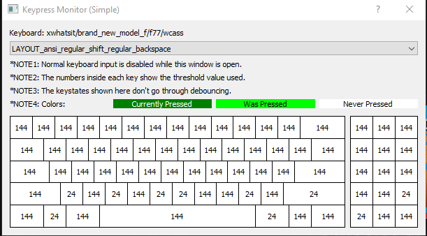

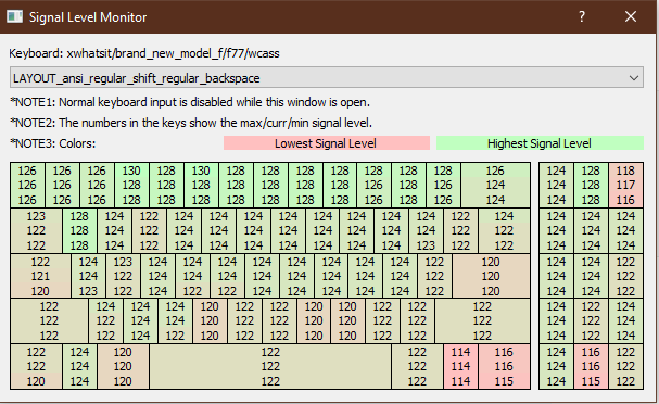

Hi, thanks for your response, I am having more issues with my model f
I tried swappig out the spring for another key on my 9 key, and i think that the spring is not the issue
When I touhed the keyoard, it got shoked and many keys stopped working, so my sentenes are laking some letters, as you an see
all the keys with a 24 on them do not work
I have tried reseatig the keys to no avail
please advise
viewtopic.php?f=62&t=7834&p=465787&hili ... ai#p465787

GetInTheRolls it looks like a matrix row is not working - please see the manual's description on how to fix a row. It involves touching up the solder and maybe adding a layer of electrical tape if your keyboard is an ultra compact case version. Also please use the signal level monitor as your screenshot is not as detailed.

Zed wrote: 21 Apr 2021, 01:29 Great info and references Jesse9766. For the non-Latin sets like Japanese, Korean and now Thai, I am not going to draw the characters myself and will be using suitable typefaces instead. I have found fonts that closely match the ones IBM used for Japanese and Korean and hopefully we can come up with something appropriate for Thai.
Are the links from the thaifaces site meant to be reference pictures or actual fonts to download? Would any of the fonts that Google offers work? Thasadith looks like a candidate.
https://fonts.google.com/?subset=thai
That is a very nice modern font using a "humanist" font style. Though modern fonts are typically more rounded than old fonts, like the original font on the Model F. I think it would look nice if printed, though it might be difficult due to the thin lines.
DB Bradley Angular X seems to be the closest to IBM's. This font is also known as Bradley Square and reminds me of the text in textbooks, probably because it is. IBM uses a handwriting font style, same as Bradley Square. If it helps you out I can trace over the characters on the IBM keyboard, but honestly all fonts are good as is. I don't know where to find a download for this font, but it'd be the best to start as.
https://github.com/jeffmcneill/thai-fon ... thai-fonts
This is a large collection of Thai fonts, but they seem optimized for screen reading rather than print.

Ellipse wrote: 21 Apr 2021, 02:26 GetInTheRolls it looks like a matrix row is not working - please see the manual's description on how to fix a row. It involves touching up the solder and maybe adding a layer of electrical tape if your keyboard is an ultra compact case version. Also please use the signal level monitor as your screenshot is not as detailed.
Hi, thanks for your response.
I have been having very strange behaviour with my board. If you think that the solution is to indeed open it up and look at the soldering, I will do that. Please let me know if you still think the issue is with the soldering after this new informaiton.
After shocking the keyboard with my hand (is there a way to prevent this in the future?), the aforementioned keys in the bottom two rows stopped working. I plugged it in with another USB C Cable and the board started registering a lot of phantom presses, the keys which didn't work started to work, and even the 9 on the numpad (which still doesn't work and I don't know why - I tried reseating and multiple springs) started registering continuously. When I swtiched back to the original USB C cable, the aforementioned keys continued to not work.

GetInTheRolls did you do the test where you open the signal monitor utility first, then remove the 9 num pad key, and then observe if the top number in the group of 3 numbers moves to green? As a note I test every key before mailing but sometimes problems show up after these keyboards are bounced around in shipping and/or used on different equipment. I would first touch up all the solder joints (don't take apart the keyboard for this as it's not needed; you just have to open up the case as noted in the manual). Have you tried another computer and another USB port?
The last resort (if the above does not work) is to remove all the keys and open the inner assembly as shown in one of the videos in the manual, and rest a flipper on top of selected keys that do not respond to the flipper. If a key registers then it is an issue with the flipper and spring which should be replaced or cleaned off with a lint free cloth (also clean the PCB with a cloth too).
Did you add polyimide or electrical tape to the bottom of the controller? It may be making contact with the bottom of the case which may cause intermittent issues.

Ellipse wrote: 21 Apr 2021, 04:33 This is a great discussion on all the additional language options. I have just submitted four additional language layouts to the factory thanks to Zed! Brazil, German, Swedish Finnish, and Swiss German.
Thanks for your response. I have added some electrical tape over the polyamide tape and I hope that will fix some of the issues I was having. As for the 9 on the numpad, I took a solder wire in my hand and touched it to each of the joints to figure out which one was the issue. I am not sure if there is a specific joint I need to solder (could you let me know which one to solder if there is a specific one linked to the 9 numpad?) but I found one which seems to constantly press a group of keys - that appears to be an issue, right? Because if I add solder to that joint it would be permanently pressing that group of keys? There are a few other joints which constantly press a column of keys when I touch it with the solder wire. Please advise. Thank you!

I have no idea if this is practical and I haven't even brought this up with Ellipse so don't get too excited for this one. Still very much a WIP as well.
F Beam APL.png (616.56 KiB) Viewed 10527 times

Kugelkopf wrote: 21 Apr 2021, 22:54 ...
Upon contemplating the photo, I'm wondering, if it might be the "Feststelltaste", that had to be pressed in the first place and the silver button, to unlock the thing. My relevant typing experience is a few decades away...
AFAIK, "Umschalttaste" moves the typing levers up, "Feststelltaste" just pushes "Umschalttaste" AND activates a lock with a spring, leaving "Umschalttaste" in a down position. You had to push a bit "Umschalttaste" to release the lock and let the typing levers go back down.
The metal key is probably a "tab-stop" lever : push it down to set a tab-stop, pull it up to unset the tab-stop at the current position. Those tab stops are little metal tabs at each character position along the roller that stop the roller when you push it to the left. The "go-to-next-tab" key may be the red one on the right. That's the case on my 1967 typewriter.
