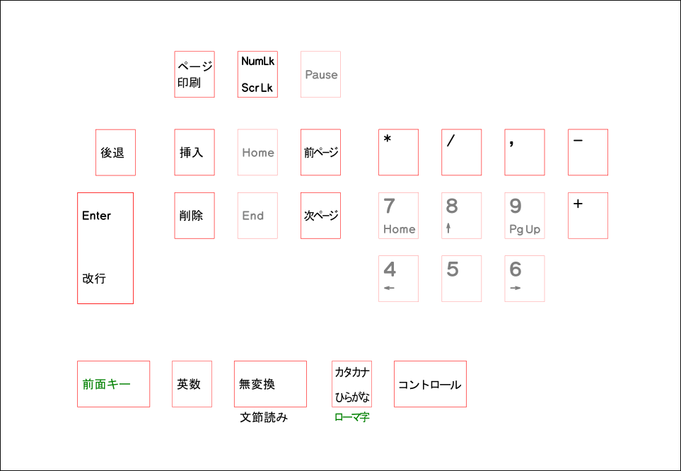

Nice to meet you. This is my first time to use deskthority. I'm using a translation app to communicate with you, so my English may be a little off.
I'm Japanese, and I'm familiar with Japanese keyboards and fonts; the Model M that IBM manufactured for Japan is called 5576-c01, and the font used is Ishii Gothic. This font has not been digitized and is impossible to use. The closest font to Ishii Gothic that exists today is Yu-Gothic. Japanese Kanji is completely different from Chinese Kanji, so please use a Japanese font when using Japanese characters. If you would like, I can help you create a Japanese layout. Sorry for the long post. Thank you for your time. :)

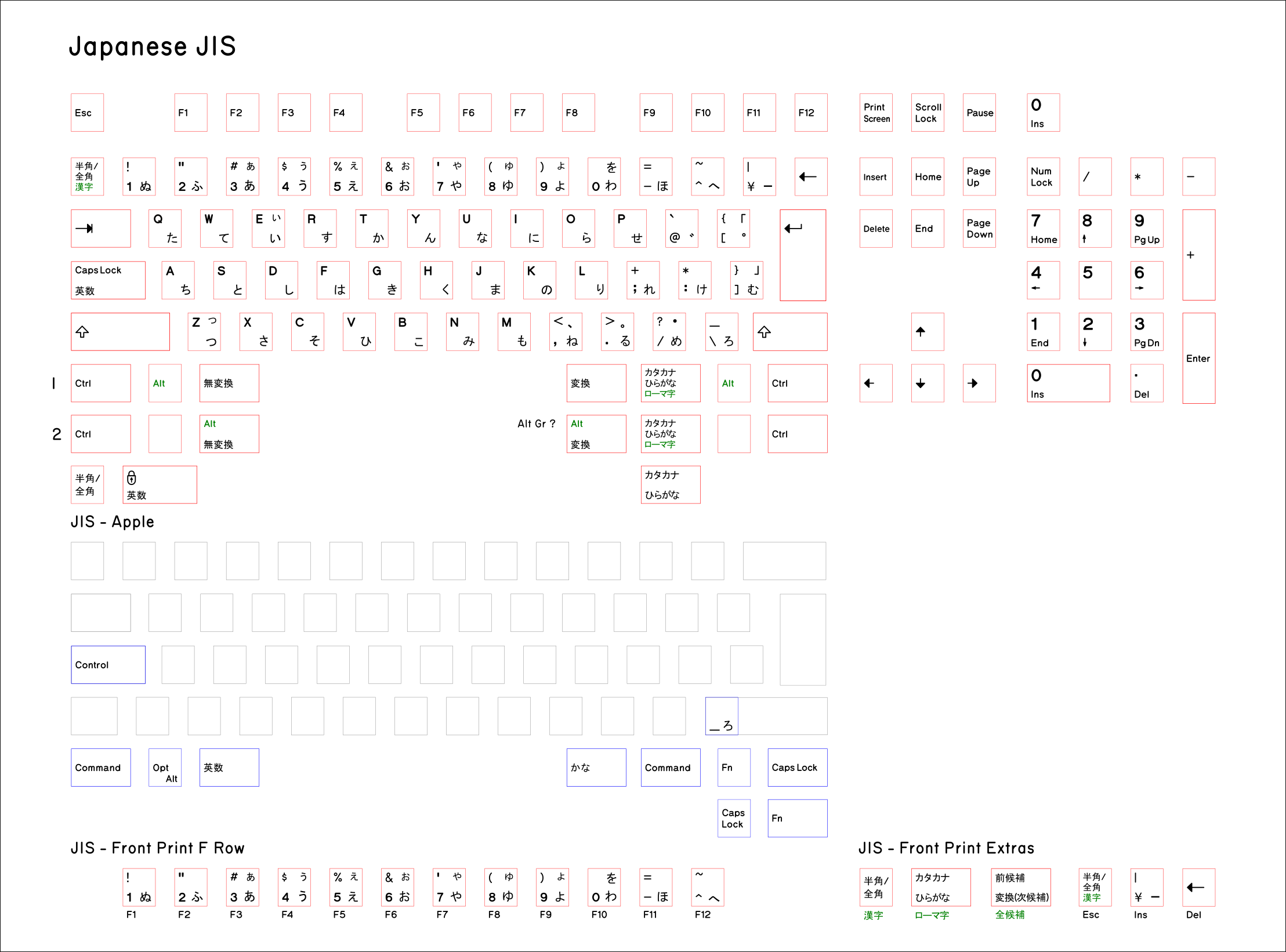

Welcome Dön and thank you for the feedback! I have several questions that I hope you may be able to help me with. Here is what my current JIS layout looks like. I have used the MS Gothic font but I can change it to Yu-Gothic if you think that would be better. Please let me know if you find any errors or anything that should be changed.
JIS v16.1.png (243.54 KiB) Viewed 11054 times
My first question is about the bottom row. The F62/F77 keyboards don't have enough keys to do a proper JIS layout so I am trying to figure out a good compromise. Which bottom row (#1 or #2) do you like?

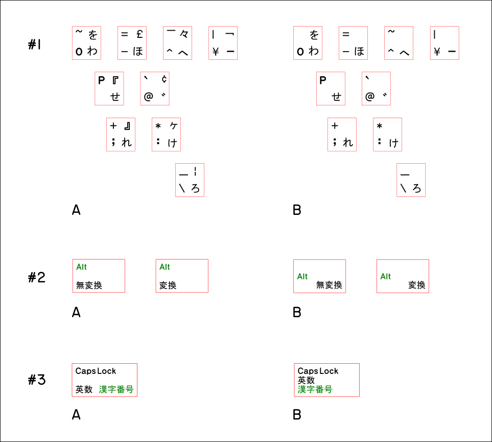

Could I also ask which versions of these you prefer?

#1 A - seems to be old type layout, #1 B - modern layout?
#2 A & B - If 'Alt' is on same key as 無変換 Muhenkan and 変換 Henkan, do you have to press 'Shift' to access 'Alt' function?
#3 A & B - Is 漢字番号 Kanjibangou used on modern computers?
Thank you! Please let me know if you have any trouble translating my writing.
For those reading along and wanting to know more about the JIS input method, here are some of the references I have been using:
Here is a pdf markup of the previous picture with translations done by my nice neighbor. Note there is an error on the 'Alt' Kanji.

And some links about the layout and the functionality of the extra keys:
https://en.wikipedia.org/wiki/Language_input_keys
http://xahlee.info/kbd/Japan_input_method.html

As someone who also uses a heavily personalized JIS layout and is very much looking forward to the JIS keys, here's my opinion. I'm not Japanese, but have lived here for quite a few years and need to make use of Japanese input every day for work and whatnot.
I'd prefer row 1 to keep the alt symbols separate. That being said, I personally use the 無変換 key as enter so plan to leave this blank However I do frequently use 変換 and the hiragana/katakana key
I'd prefer layout A to match the originals. My 5576 and pingmaster both match that (although the pingmaster has a vastly different font, most of the labels match up)
I've never used a keyboard that combines alt with 無変換 and 変換 so not sure about the answer to that, the C01 and A01 have separate alt keys.
I've never seen 漢字番号 on a modern keyboard, but it was on the original.
While I've not done a close comparison myself, this is supposed to be the original font from the keyboards. Not sure if just an image like this will help you.
https://l-l-l.jp/wp/?p=1328
Also, in case this information is useful, Yu Gothic is often the standard font used in Japan, while MS Gothic is the font used by Windows UI. Either is something people would be familiar with, but I also believe Yu Gothic is closer to Ishii Gothic.

Thanks for the feedback! One of the customers didn't recognize some of the hiragana punctuation symbols on the old 'A' layout "『』" so I worked up the more modern layout based on the Wiki link I posted above. Looks like we now have a vote for each.
The 'Alt' + 無変換 and 変換 came from modern aftermarket sets I was looking at (KBDFans) and seemed like a good way to deal with the lack of bottom row keys. I was wondering about the functionality of such a layout (especially since a lot of their Japanese sets are ANSI layout and I'm not sure they are really intended to be used as an actual Japanese keyboard) and how you access the Alt function. KBDFans goes with the centered 'Alt' and if shift is needed, the top justified version would be more IBM like.
Re. the 漢字番号 legend, any preference if I should put it on there? I don't think the front printing will be on anything larger than 1.5U keys (Ellipse?) so it would have to be one of the top printed versions and neither are historically accurate.

It's my understanding that those extra symbols are no longer functional on modern computers (they certainly don't work on mine), so they'd only be there for display purposes to match the originals. This would be my preference because a big part of the focus of this project has been to recreate the original keyboards as accurately as possible.
The C01 layout for the bottom row matches your row 1, which is why it's my preference to have separate alt keys. The 003 was the SSK model, whereas the C01 was the only model to actually use IBM buckling springs, so I think matching either one of those should be the priority. However, since you don't have the extra 003 keys and instead have alt keys, I'd lean to copying the C01 in this case. Given that you've left the legends for backspace/delete/page up/down in English, I'd lean towards the C01 overall.
The A01 and C01 have 漢字番号 front printed on the caps lock key, whereas the 001-003 had it front printed on a different key, so either way I think front printing would be most accurate. That being said, caps lock is another key I plan to leave blank (I have it mapped to backspace), so prioritize anyone else's feedback over mine.

'Alt Gr' isn't used correct? I do have more Japanese legends done but I wanted to make the set match the other ISO sets hence the English Backspace, Delete, etc. We could go back to these though:
JIS Mods options2.png (40.95 KiB) Viewed 10986 times
Would any of those bottom row keys be useful or preferred?

When referring to the Japanese layout, Topre's Real Force is the most common modern layout. c01 and others are different from the current keyboard layout. It is classic, but not practical.
ms gothic is a very lame font for people who know a lot about fonts. It is popular because it is a standard font in Windows, but it is not a good font.
Ishii Gothic is a font that was used a lot in the past, but it has not been digitized yet. It was recently announced that it will be digitized in a few years. The font similar to Ishii Gothic is Yu-Gothic. It is recommended that you use this one.
#1 I choose B for this question, A is different from the current one.
#2 This question is a very difficult one; I think it's too subtle to use the same key as Alt. I don't think Japanese people would actually be able to use it.
#3 "Kanji number" is not on the current keyboard. It's not necessary, but if you like the classic look, I think A is easier to read; B is hard to read because the characters are squeezed together.
Japanese IBM keyboards do not have a Model F. And the exact Model M is c01. And the only exact Model M is c01. a01, 001, etc. are all proprietary to IBM Japan and manufactured by Alps or Brother. If you want to make a replica of the JIS version of Model F, you may want to refer to various perspectives. If you are ok with that, just provide me with the material and I can create a layout.
Keep in mind that if you refer to the classic IBM JIS, it is difficult to use it as a current keyboard. The Toupre layout is correct.
It does not use Japanese for Delete, Insert, etc. It is only in demand if you want a classic look and feel.

The extra symbols in 1A and kanji legends for backspace/etc should only be used if you want historical accuracy to the original IBM keyboards, if you want something that matches modern keyboards then it's 1B and English labels. Note that the modern Japanese backspace and enter keys match what you'll find on the C01 rather than the plain arrow keys in your original image. My preference is for historical accuracy rather than matching modern keyboards, but it sounds like I'm probably going to get overruled on that.
You're correct that Alt Gr isn't used. While there is the lacking windows key issue in the C01 bottom row layout, I think it's best to still copy it exactly and let the user work out how they want to handle that problem. If you do think the keyboard needs a windows key, my preference would be to replace one of the alt keys but to give the user both legends. Either that or mention ctrl + escape in the product description with large bold font so users know what to press.
On a side note, your first three front print extras are also all keys I would plan to pick up. I'm not sure if you can't have front print in the default set, but if you can then my preference would be for the first two to be in there, and the third is to again match historical accuracy over modern keyboards.
Editing to add random thought I just had, while the 003 and C01 are the two buckling spring keyboards most similar to this, the pingmaster was the keyboard that was used with 4704 terminals, so maybe there's an argument to be made that pingmaster legends would be best for historical accuracy.
