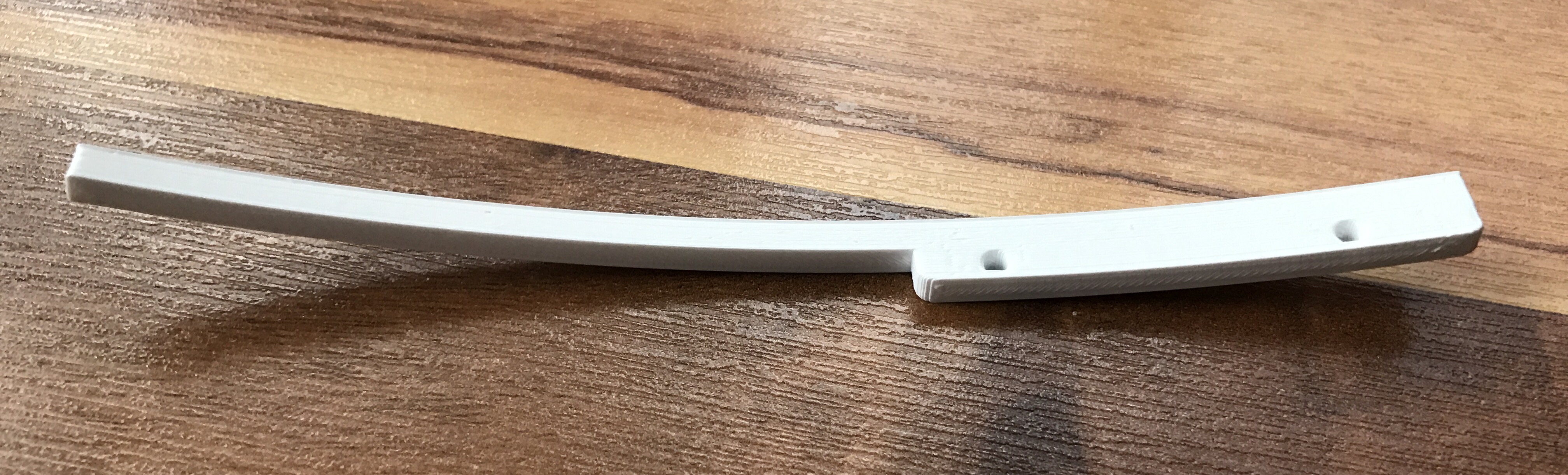

They look good. I might kick the fan back up a bit so the screw holes turn out just a touch more rounded (look close to perfect), but I think we are very close to dialed in. Unfortunately these things are so long and small (height and width) that the infill patterns don't have much impact on the overall timing with a 1.2mm shell. What it did noticeably do though is reduce the amount of time the infill takes. The issue all along really has been that the infill (even at 100%) would occasionally leave a slight ridge when retracting (this Cura software elects to use some very random patterns, and I haven't seen a way to alter the algorithm). The ridge would harden enough that it would impact the shell pass, causing a "speed bump" as it passed by. Enough slight bumps in the process, and the silly thing would come off the plate.
The combination of the .2mm and reduced fill time have eliminated the hardening of any "glob", and now we cruise right along with smooth beads throughout. The other MASSIVE upside of the .2mm is we have cut the print time by half. The definition of the print is obviously less, but really only noticeable on the portion that would be covered up anyway. I'll try to get some pics later.
Appreciate your thoughts andrewjoy and matt3o. Also, if anyone decides to take the STLs and apply your own patterns with success, upload that for everyone if you would.

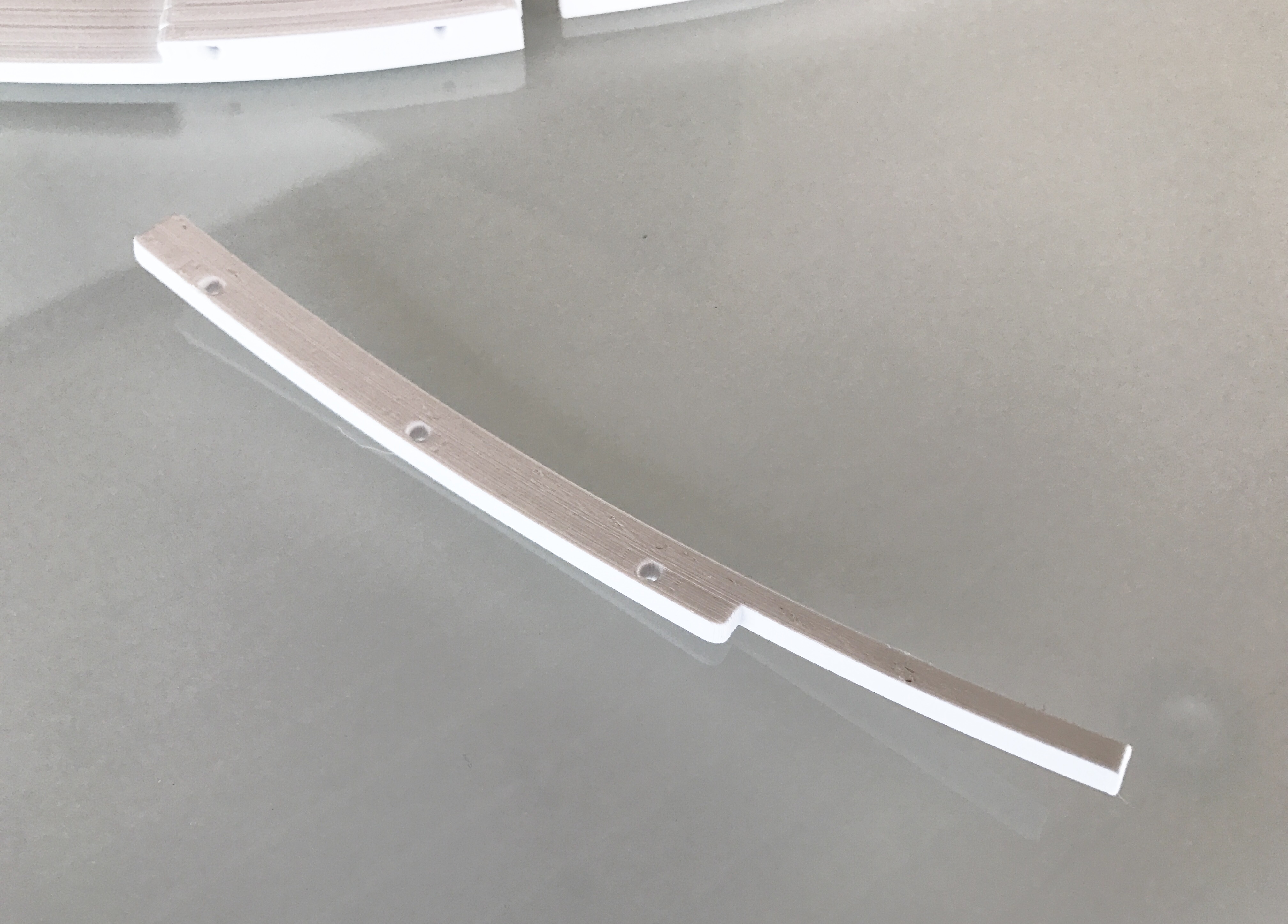

EDIT: photos from the above mentioned prints

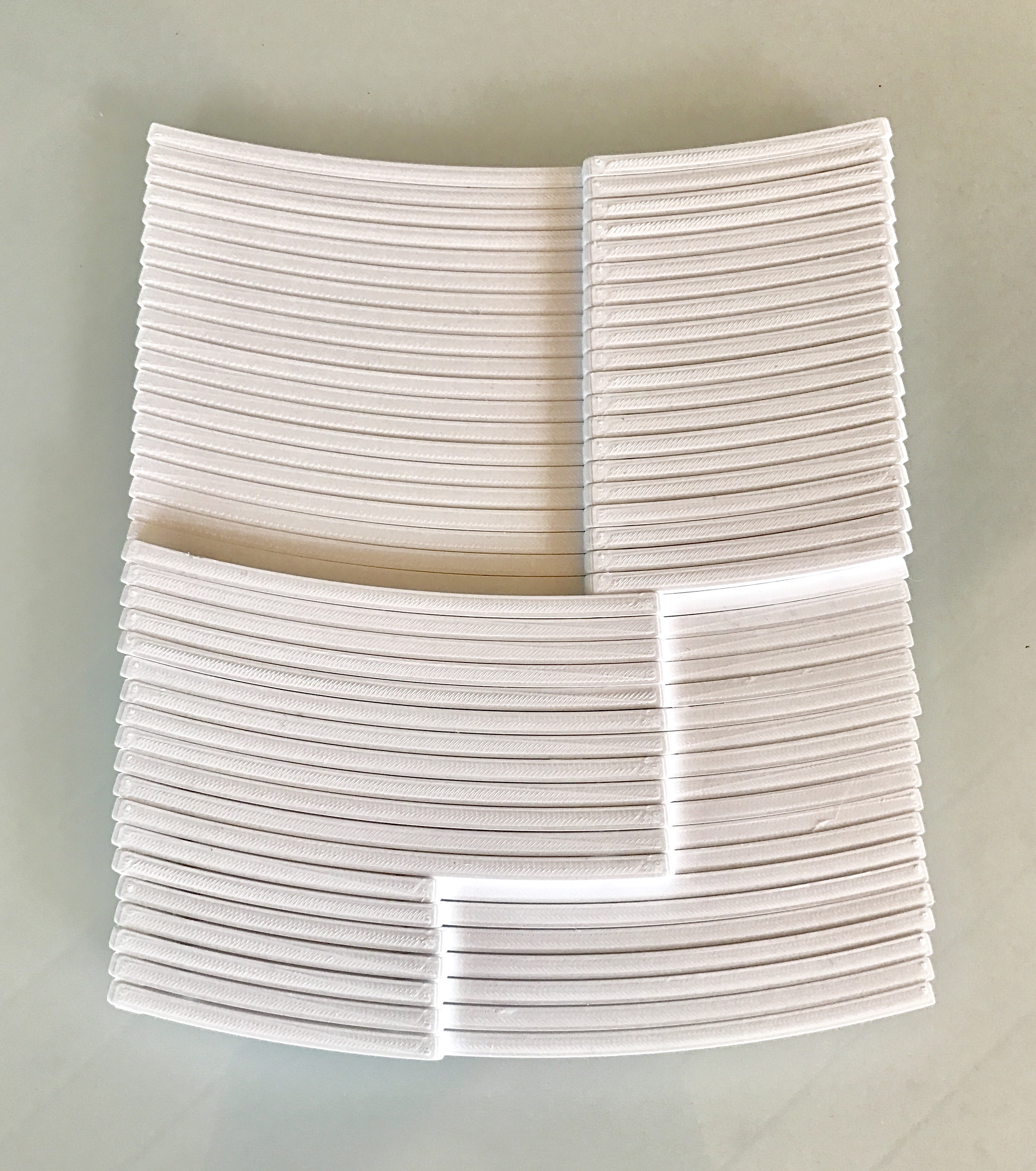

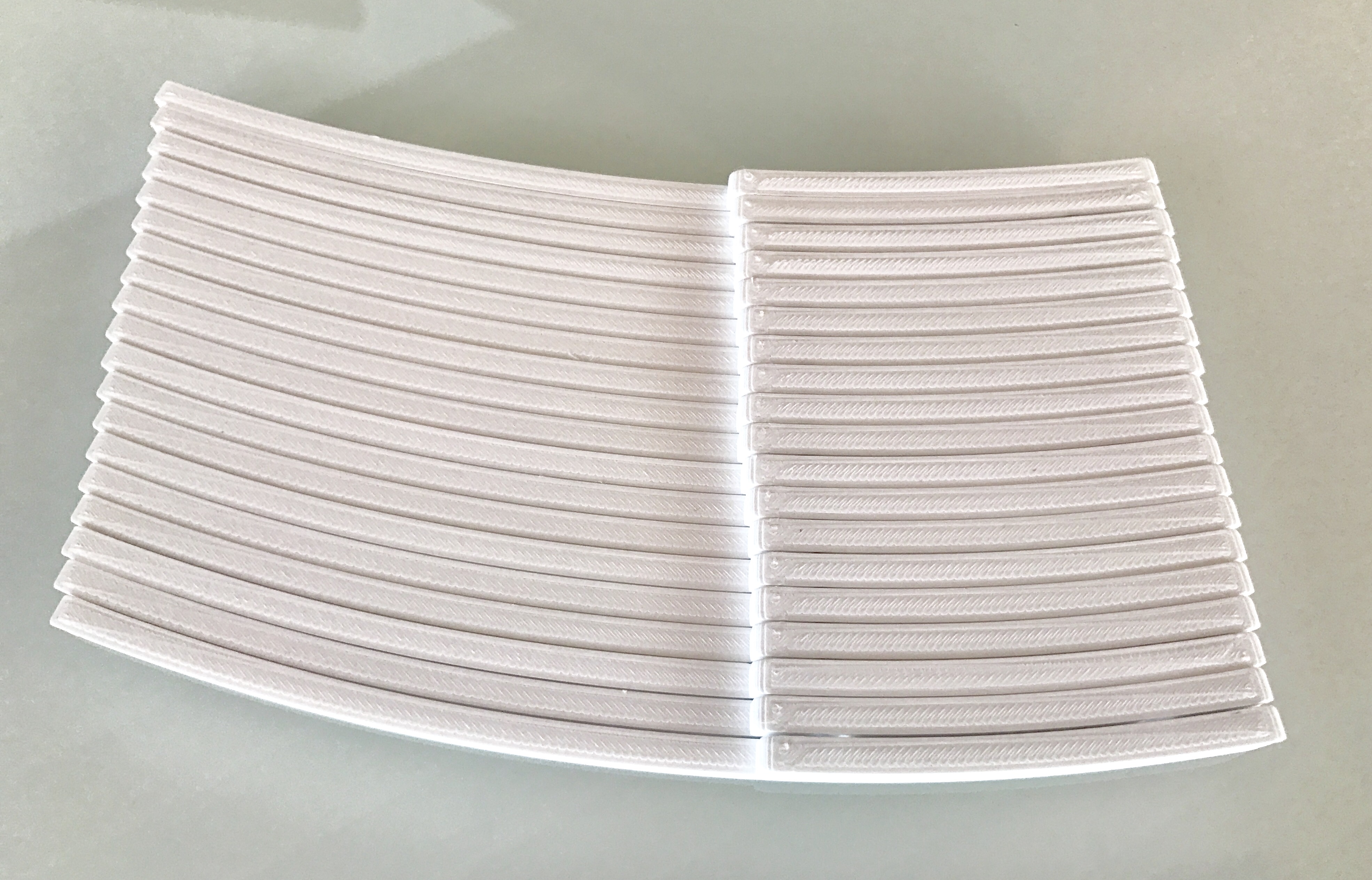

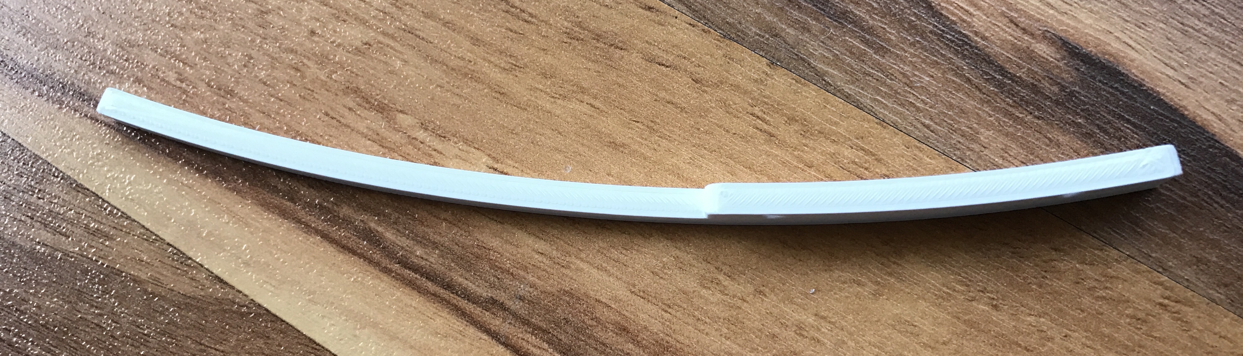

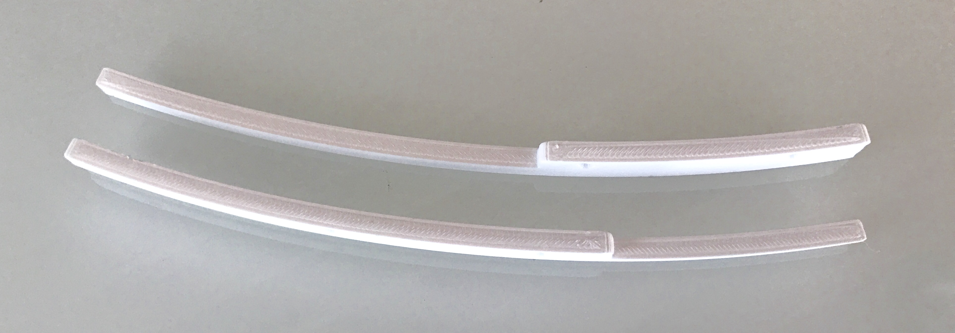

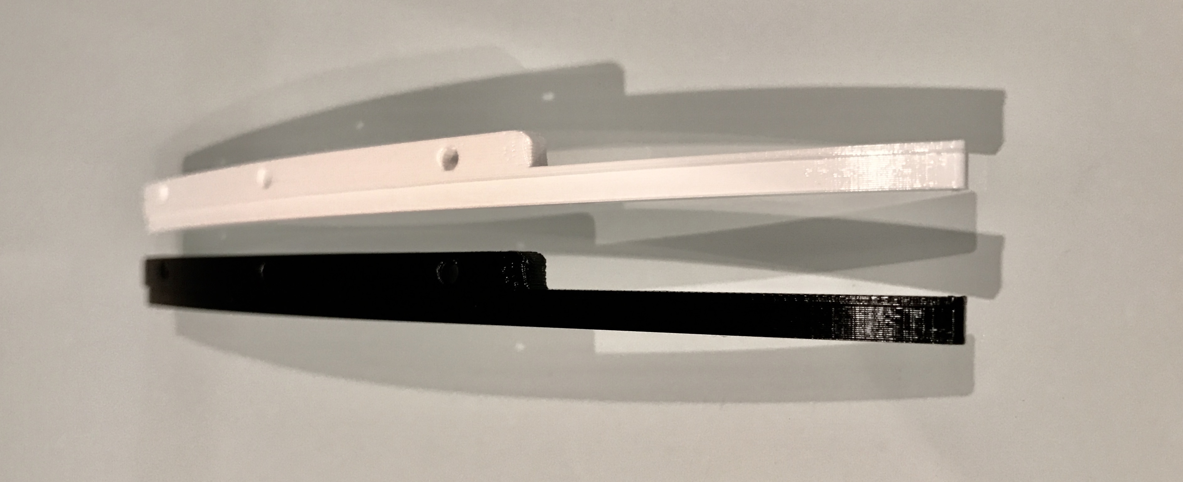

All of the white right-side spacers (applies to the full-size and SSK) have been produced, and onto the left-side for the SSK. Should be done with the whites altogether by the weekend. I mistakenly thought I have co-poly in black already, but the black is in nylon only (using for the stabilizer clips which are next). I have ordered a couple of black Colorfabb XT reels and a clear so I can play a little with indirect LEDs in the future. The following images show the progress to date on the spacers.
Also, I spoke with our box friends, and we are going to start production on those soon. They are going to make one more change for me in prototype form. I need the width and height of the box reduced by 1/4 inch each way to make the palletizing of the Euro shipment work. Otherwise I will be hit with a non-standard freight dimension fee
All right side white spacers for both the SSK and Full-size
Right side on top, left side SSK on bottom (inverted)
Left side SSK
Left side SSK
