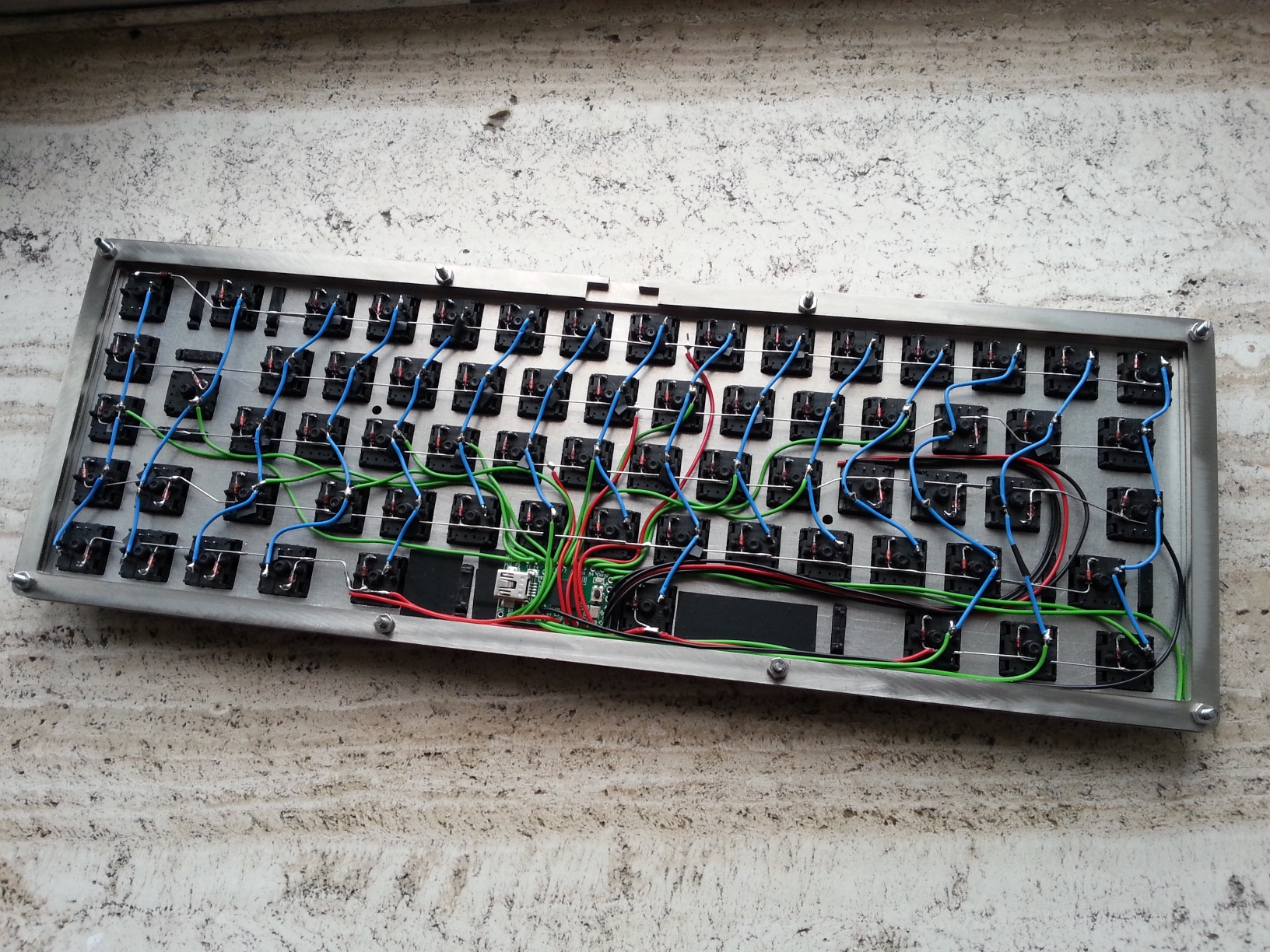

Muirium wrote:Right lads, Matty wants to see your work. So here's where I'm at with the shiny one:
Sphericals, accept no substitute.
Matteo's 2nd generation design, with its hidden bolts, really brings caps right to the fore. The look when you're using the keyboard is a wall of caps. Pure minimalism. About a kilogram of it, underneath!
Still shiny:
Of course, still no stabs yet either. And row 1 wasn't quite complete when I shot those. Here it is now:
And the side view, of the compartment for Bluetooth ambitions to come:
Space Saver, achieved!
Shinier on the underside than anyone sensible likes theirs on the top.
It's truly my kind of keyboard! It's currently my main one, in fact, thanks to a bit of Soarer Inside. I'm really thoroughly chuffed with how it's turned out, and owe a deep thanks to Matt3o once again. Magnifico!
