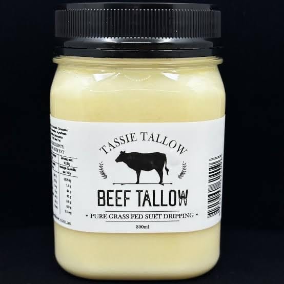

19 Dec 2023, 07:33
After much trial and error, I believe I have found the best solution for restoring Alps switches. Normally I would feed you guys some BS and recommend switching to buckling springs :evilgeek:
Without much further ado, here is the next best thing short of a time machine:
Think of this like a wax boil but better. It's delicious, nutritious, organic, aromatic, sustainable, grass-fed, free range, cruelty free, ethically sourced, grown in season, fare wage, farm to town, barn to ladle, blessed by angels and cursed by demons. Now with free shipping!
