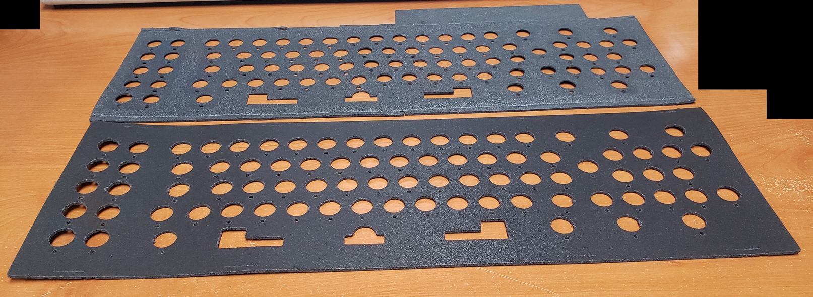

The first new production XT foam has arrived!
Besides almost everything being an exact reproduction of the original, even with the same type of foam material and similar dark gray color, there were two changes made - one, the removal of the vestigial foam covering part of the attached controller, and two, the pin registration holes were changed from 1/8" to 3/32" to provide an ever so slightly tighter contamination shield for the PCB.
As noted earlier I purchased tooling for the XT foam recently and started taking orders for the foam for delivery later this year. It's a small batch - not sure if any will be left by the time they arrive in stock.
From the latest factory video I posted on the project's YouTube channel:
"As the Brand New Model F Keyboards continue to be mailed out I wanted to share another factory video. Still time to customize your Brand New Model F Keyboard and order add-on accessories (like the First Aid Kit, extra key sets, etc.) at www.ModelFKeyboards.com
This video shows how the inner foam is stamped to create all the super-precise holes for the barrels and top inner assembly tabs. You can then see a photo of the bottom of the stamping tool (basically sharp metal in the outline of all the barrels etc.), and finally a photo of the finished product. The machine that evenly applies the stamping pressure is enormous! You only see a tiny part of the machine in this video."
Top (original) and bottom (new) XT inner foam:

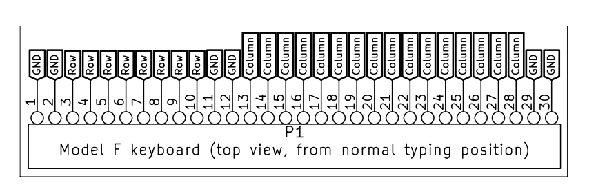

koziserek
30 Jul 2021, 17:25
Hello,
Just received my Model F and seven keys don't work : (((
2, QW, AS, ZX.
Can somebody advise which point requires re-soldering? I find the diagram quite confusing.

darkcruix
30 Jul 2021, 20:29
koziserek wrote: 30 Jul 2021, 17:25 Hello,
2, QW, AS, ZX.
Screen Shot 2021-07-30 at 8.28.06 PM.png (66.91 KiB) Viewed 9992 times
I'd check Pin 14/15/16
Also, try to remove the case and test without the case. Maybe it is just a short.
Pete
30 Jul 2021, 22:05
darkcruix wrote: 30 Jul 2021, 20:29
2, QW, AS, ZX.?
Is there any chance it could just be the firmware? When I was fiddling with the threshold value on the older xwhatsit firmware I would get sets of keys that would not register if the value was too high IIRC.
darkcruix
31 Jul 2021, 09:04
Pete wrote: 30 Jul 2021, 22:05
2, QW, AS, ZX.?
I believe QMK is pre-installed and it sorts the pads into bins automatically and find the best threshold. The likelihood is very low that it is a firmware problem. I'd just remove the case and plug in the keyboard first to see if it makes a difference. If it doesn't I'd check the solder joints for the columns mentioned above.

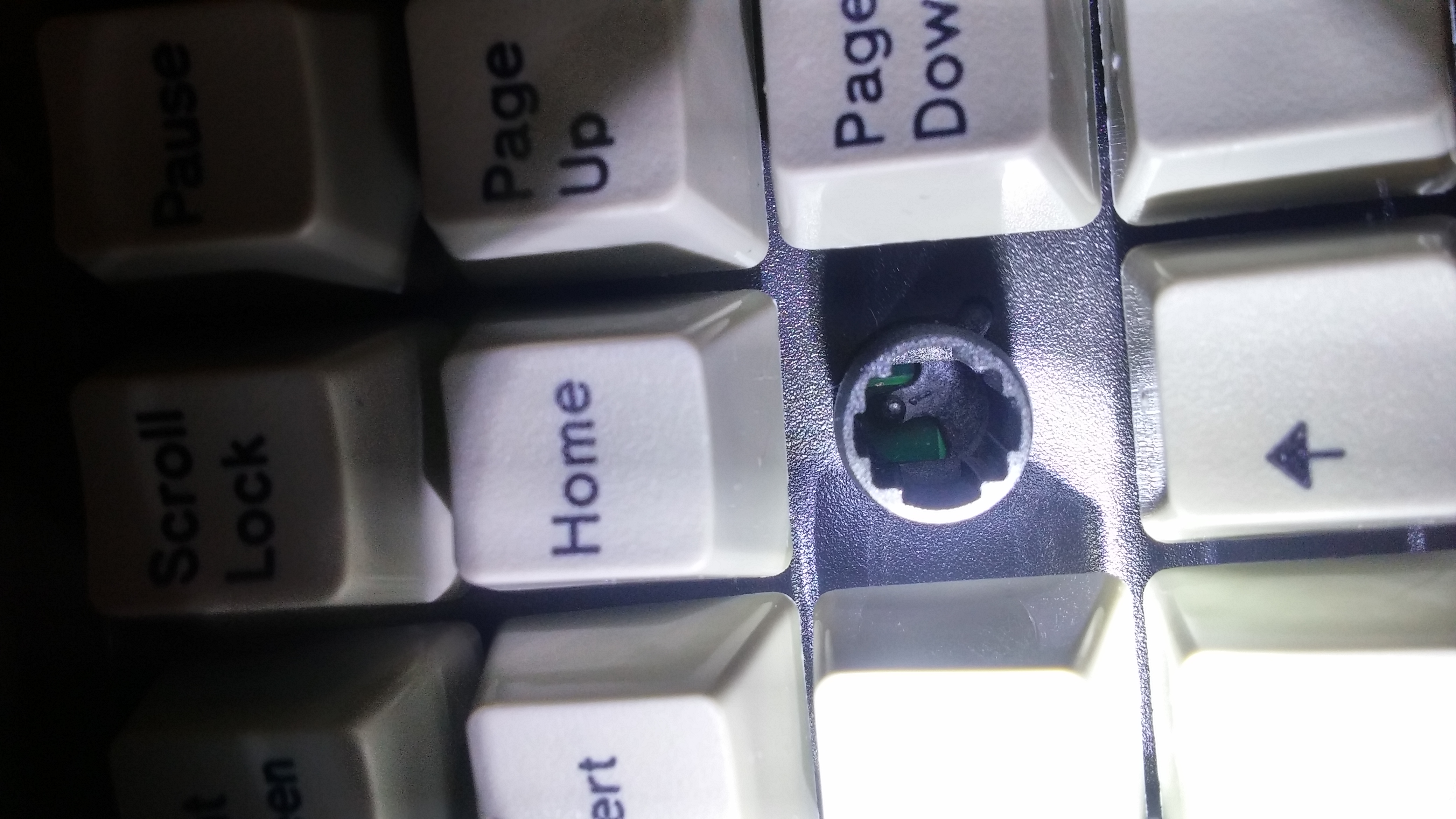

F77 came in the mail yesterday. After five hours of reviewing documentation and reseating springs, four of my five problem keys are working more or less reliably, but one stubborn holdout forced me to realize my keyboard has a serious mechanical fault. Putting it under a flashlight revealed the flipper is out of place:
Displaced flipper
Displaced flipper
I'll need to buy tools to repair this. I also lack expertise. The video guide Brand New Model F Instructional Video 2: Opening up the keyboard inner assembly shows only an incidental view of the flipper assembly, and photos in section 2.14 of Darkcruix's excellent manual show none of it.
Can anyone point me in the right direction? It might be a very simple procedure. But if it isn't, my lack of resources and inexperience with electronics repair have me wondering if I should just bite the bullet and pay to send the keyboard back to Ellipse for repair. Better that than to wreck an otherwise good keyboard.

06 Aug 2021, 07:27
Gurbsordidity wrote: 06 Aug 2021, 03:18 F77 came in the mail yesterday. After five hours of reviewing documentation and reseating springs, four of my five problem keys are working more or less reliably, but one stubborn holdout forced me to realize my keyboard has a serious mechanical fault. Putting it under a flashlight revealed the flipper is out of place:
I had a similar problem once and managed to wiggle the flipper back into place from "up top" (i.e. without opening the keyboard). Make sure to only use implements which won't scratch anything.
I can't promise that it'll work for you, or take any responsibility, but at least the flipper could be relatively easily dislodged from under the barrel. This was not on a reproduction Model F, though, so the assembly could be tighter here.
Gurbsordidity
06 Aug 2021, 08:06
Thanks for the suggestion, Bjerrk, but this thing is jammed tight. Either it was overlooked in QC (doubtful) or the KB suffered a huge blow during shipping that knocked it loose and immediately clamped down again (also doubtful - packaging is not damaged, the styrofoam should have absorbed the impact, and no other flipper seems to have been affected). I'm worried about the pressure of the displaced flipper on the underlying capacitive PCB.
Weezer
06 Aug 2021, 08:42
Gurbsordidity wrote: 06 Aug 2021, 03:18 It might be a very simple procedure.
When that crap happens on my model Fs i just use some tweezers to pull the flipper back into place.
The flippers get jammed up like that during the assembly of the two halves of the barrel plate if the flipper isn't centered properly. It was likely overlooked by QA testers
Gurbsordidity
06 Aug 2021, 09:30
Weezer wrote: 06 Aug 2021, 08:42 When that crap happens on my model Fs i just use some tweezers to pull the flipper back into place.
Appreciate the input. I tried, but the force required to move the flipper would snap the nub off before it ever moves. I'll have to open the case if I'm going to fix it myself.
I'd love to hear of the gotchas - common mistakes and risks - when taking apart the backplate and putting it all together again. The video for opening the case makes the process pretty clear, but it's intimidating and looks risky, and I'll have to spend money on tools I may not use again for a long time. I'd also love to see pictures or descriptions of how the flippers are seated - the video I linked to above shows the finished flipper assembly, but not how the flippers are installed to it.
With that much information I could decide whether to ship the KB back to Ellipse for repair or to risk trying it myself.
Wazrach
06 Aug 2021, 10:32
Gurbsordidity wrote: 06 Aug 2021, 09:30
It's actually not that intimidating. I can help you with the process if you like. I use a bar clamp to slide the plates apart and back together. I also use foldable paper clips to keep the plates together so that the bar clamp can slide the backplate into the tabs of the barrel frame. These tools are not expensive:
www.amazon.co.uk/Hilka-64020724-Quick-R ... 4f2e1370d4
https://www.amazon.co.uk/gp/product/B00 ... UTF8&psc=1
The only other tools you need is a screwdriver to open the case and a pair of pliers to separate the one tab that is normally crimped over the backplate. Do not mess with the other tabs at all, unless they are not aligned properly.
Weezer
06 Aug 2021, 12:28
The most common mistake I see is people monkeying the two halves open and spilling all the springs everywhere. That's also the biggest risk imo. I'd be sure that you use your dominant hand to mallet the two sides open and your other hand to hold the two halves together so when they come apart you can hold them together until the two halves are horizontal. That will save you a lot of time.
I personally don't use any clamps for reassembly. In my opinion they inhibit the lateral movement of the two halves and I'll usually just grab a friend to mallet while I hold the two halves together. That probably requires a bit of strength though. In general it's up to you how to proceed but it's very hard to permanently damage one of these keyboards because it's such a well engineered design with such solid materials. The worst that might happen is the off chance you might break a flipper or something or have a bit of a time getting it back together.
Gurbsordidity
06 Aug 2021, 13:02
@Wazrach @Weezer
Thanks, guys. That's reassuring. If my worries about breaking off clips or anything else are unfounded, I'll pick up the tools and try it myself in the next few days.
Wazrach
06 Aug 2021, 13:17
Weezer wrote: 06 Aug 2021, 12:28 I personally don't use any clamps for reassembly. In my opinion they inhibit the lateral movement of the two halves and I'll usually just grab a friend to mallet while I hold the two halves together.
That's why I use paperclips - they are not too strong as to prevent the plates from sliding together. I think they're ideal for boards like these where the foam has already compressed sufficiently so there's nothing fighting the plates apart. You certainly don't need a mallet for these either, the bar clamp is strong enough for the same reasons.
It gets a bit trickier when doing foam replacements. I like to think the tabs provide the compression, so the only goal of the paper clips is to help the tabs of the barrel frame slightly bite the backplate, after which it is easier to use a mallet to tap them into place.
Weezer
06 Aug 2021, 15:15
I use the rubber mallet in lieu of a bar clamp since I don't own one. It's just a light tap from the rubber end.
phughes
06 Aug 2021, 15:58
On my Model F XT I had to use G-clamps, a block of wood and a mallet to slide the two plates together.
I've used less force splitting the cylinder head off an engine block!
