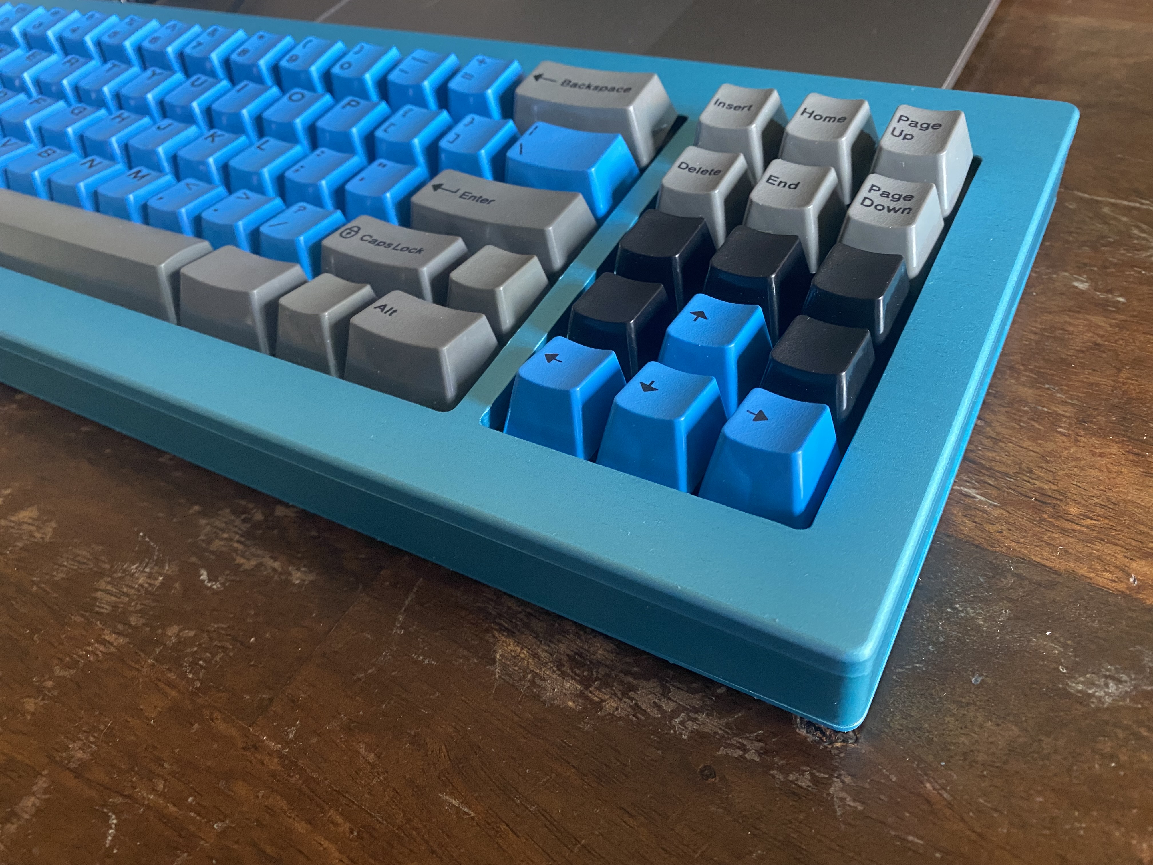

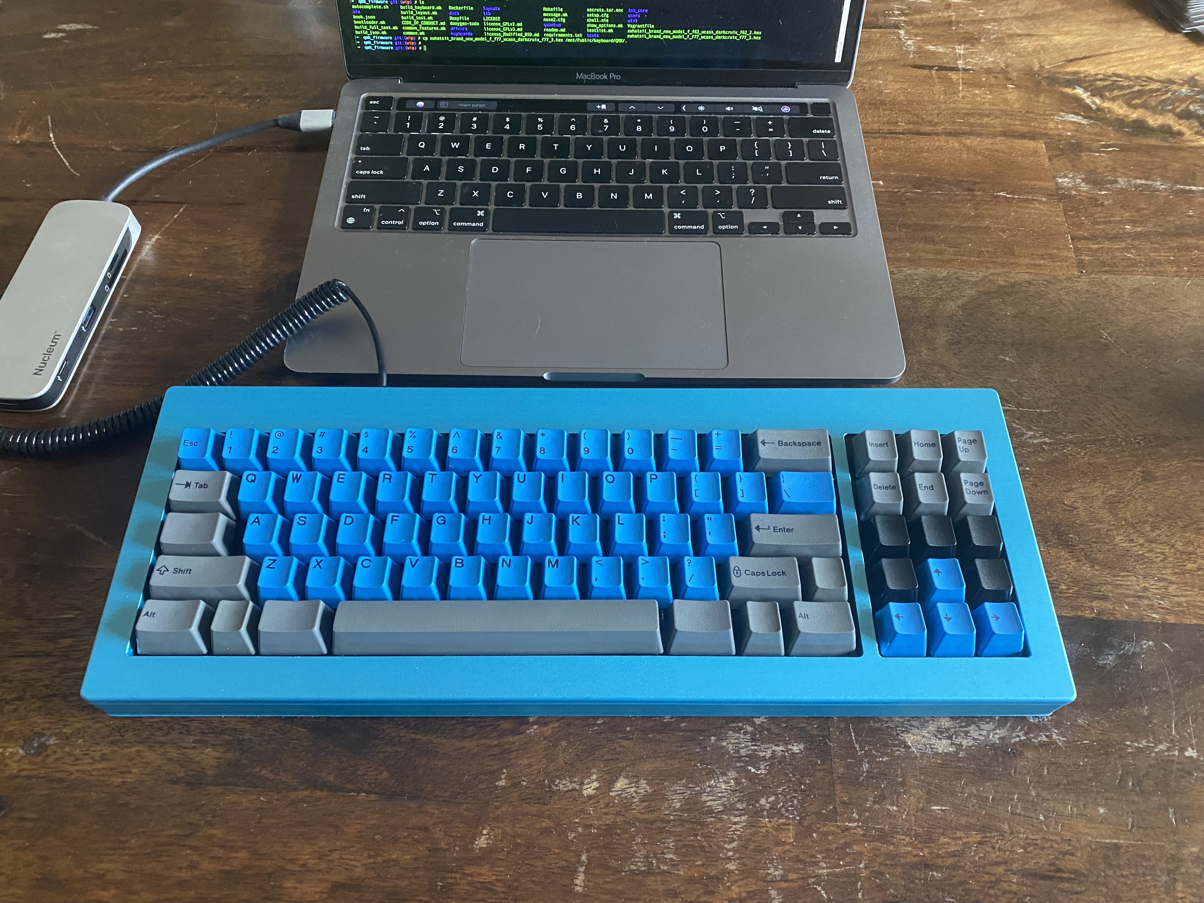

darkcruix
26 Sep 2021, 12:54
I wanted to share two quick photos taken with my phone.
This is the absolutely stunning Carolina Blue Ultra Compact keyboard. I chose to use Mopar Blue keys combined with Dark Gray. I am not sure, yet, about the keycap colors, but I have ... options. More to that a little later, when I have a bit more time (including better photos).
Palatino
26 Sep 2021, 15:41
That’s certainly a lot of blue. I like blue, but not in such volumes. All grey and black caps, maybe? It’s certainly very striking - and great that there are so many options. Are the spacebars on these reproductions well weighted, unlike the monstrous XT original?

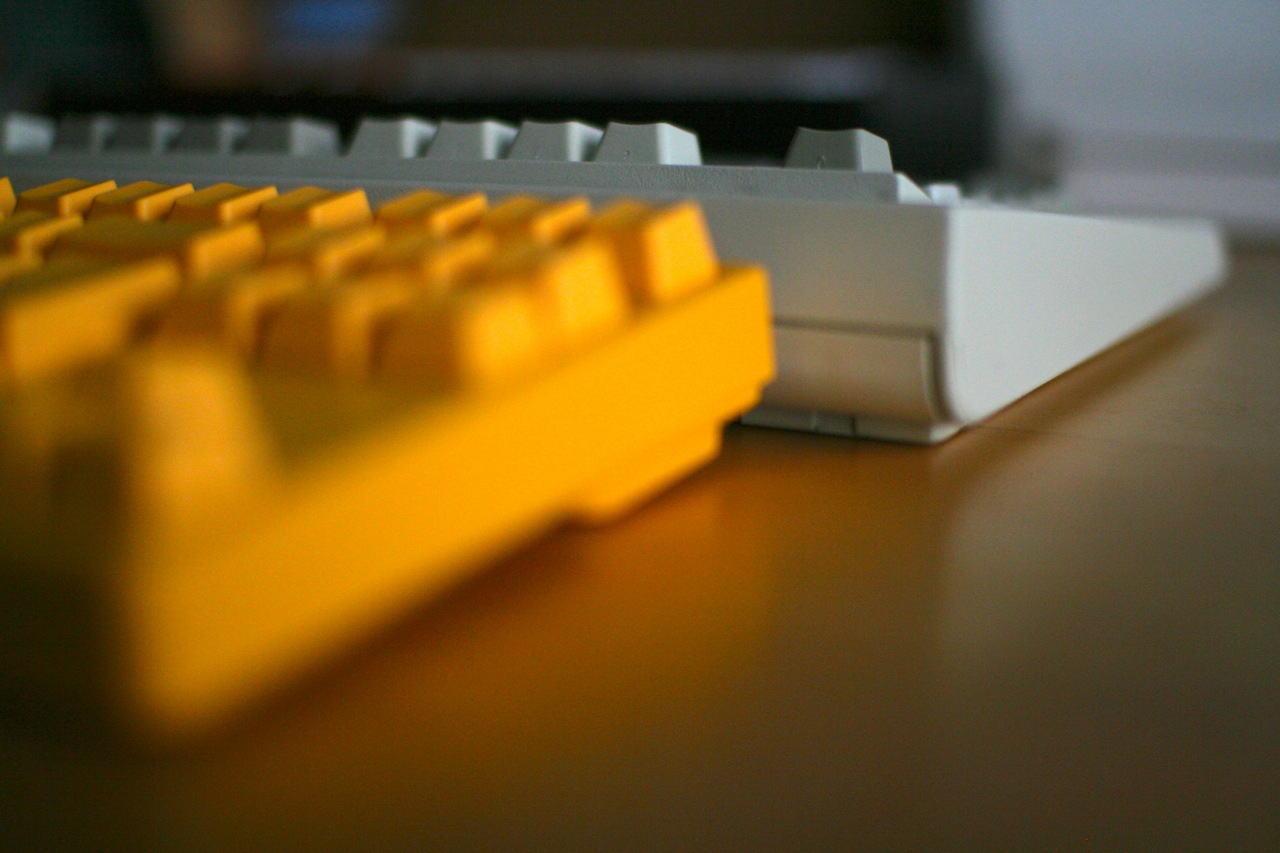

26 Sep 2021, 16:31
I can only imagine a rhapsody in blue like that alongside my not so mellow yellow Ducky some years ago:
russypt
26 Sep 2021, 17:12
Palatino wrote: 26 Sep 2021, 15:41 That’s certainly a lot of blue. I like blue, but not in such volumes. All grey and black caps, maybe? It’s certainly very striking - and great that there are so many options. Are the spacebars on these reproductions well weighted, unlike the monstrous XT original?
Yeah they're closer to Model M weight, maybe even a little lighter (I don't have a measuring device). I don't have an F-XT but it is way easier to actuate than my F-AT.
26 Sep 2021, 17:21
AT and XT spacebar are just about the same. OG Kishsaver is light like a Model M. So the light weighting on these is more in keeping with the style.
That said, I actually quite like heaving a heavy spacebar on a Model F. Feels extra luxurious for some reason.
Palatino
26 Sep 2021, 17:51
I know what you mean. I've remapped Right Shift to spacebar, but now and again I do like to hit the actual spacebar just to register a minor tremor on the local quake sensors.

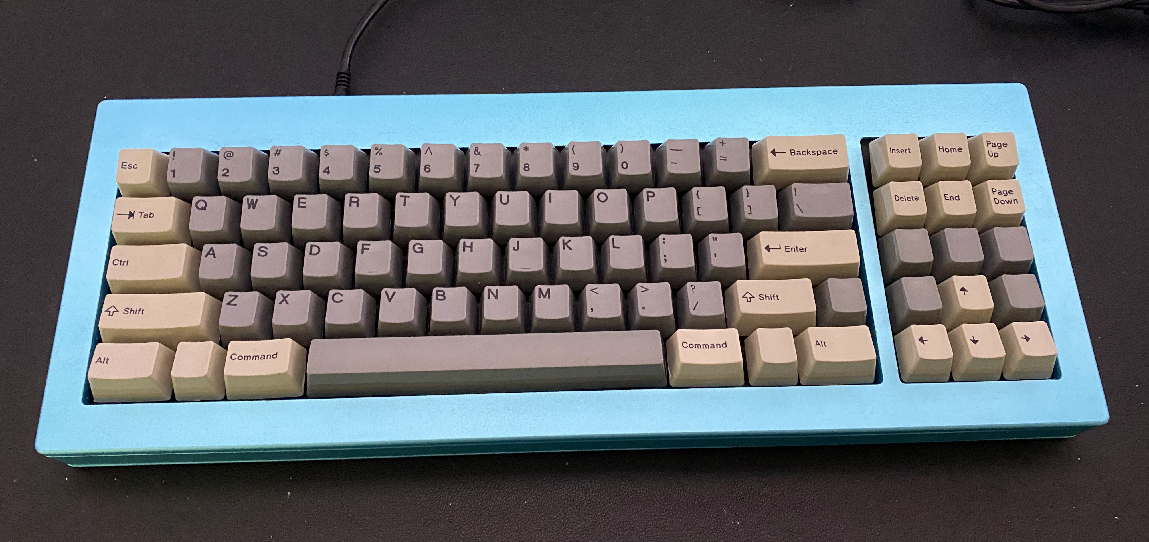

darkcruix
27 Sep 2021, 17:31
I played around with the keycap colors a bit on the light blue keyboard.
I think the comments earlier convinced me to change around things.
I am still not confident with this combination, but wanted to share it (overall the blue is so amazing looking on its own).
