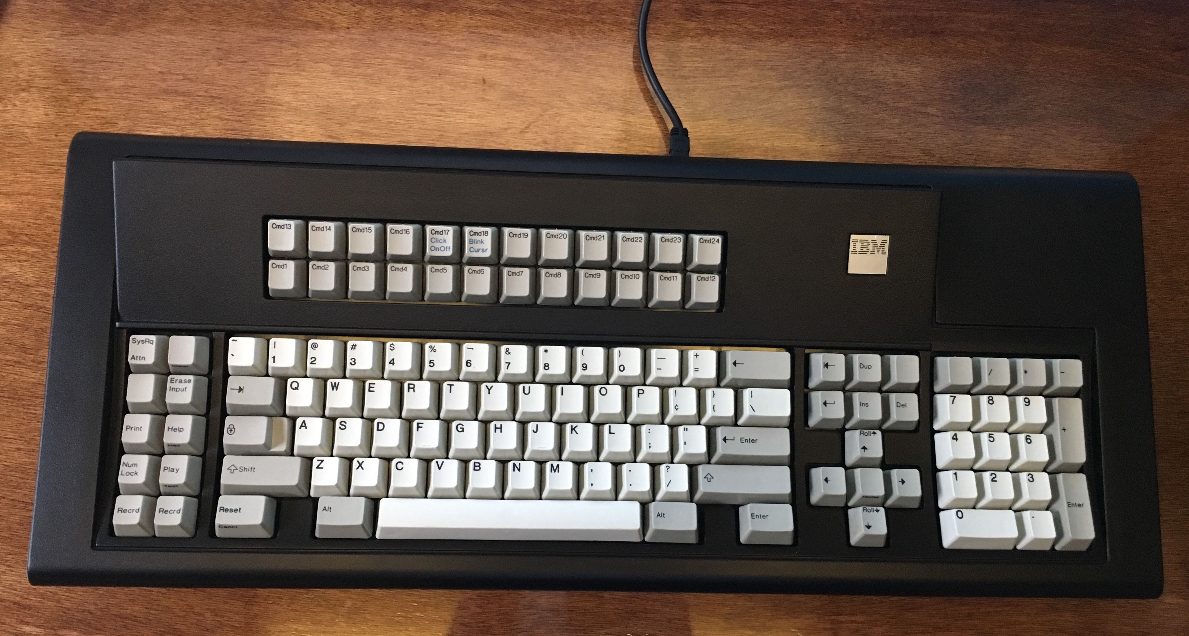

I'm hoping someone can help me with problems I've been having with my ANSI Modded IBM Modem-M Terminal keyboard (manufactured on 9 September 1986 in case anyone is interested.) I'm using Soarer's converter on a genuine Teensy. Key-remapping works flawlessly (I'm typing with it now); however, whenever I try to assign a macro, the first keypress works, but then the entire keyboard becomes disabled. I need to reboot the computer to get it working again. My code is listed below.
remapblock
	EXTRA_F10 LGUI
	PAD_PLUS PAD_ENTER
	PAD_ASTERIX PAD_PLUS
	SCROLL_LOCK PAD_ASTERIX
	EXTRA_F1 ESC
	F24 MEDIA_VOLUME_UP
	F23 MEDIA_VOLUME_DOWN
	F22 MEDIA_MUTE
	EXTRA_F7 NUM_LOCK
	ESC TAB
	NUM_LOCK PAD_SLASH
	EXTRA_SYSRQ PAD_MINUS
	LANG_4 DOWN
	EXTRA_F9 APP
endblock
macroblock
macro EXTRA_F5
	MAKE RCTRL
	MAKE P
onbreak
	BREAK RCTRL
	BREAK P
endmacro
endblock
I would really appreciate any help as I spent a significant amount of time restoring this keyboard specifically so I could type on these wonderful buckling spring switches and assign macros for the billing software I use at work. I'm not much of a programmer, so I have no idea what I'm doing wrong, but I've tried a number of different approaches and they all yield the same result.
Here's a picture of my keyboard. I used Dupli-Color Vinyl Dye on the top case only. Somewhat hilariously, I very foolishly painted the top and bottom in direct sunlight. The bottom part of the keyboard case became so hot that it warped significantly. Fortunately, Unicomp sold me a brand new bottom shell for the keyboard for $10 shipped. Thanks Unicomp! I left the new bottom shell beige. I kind of like the two-tone look, although when typing, you can't really tell. I was able to preserve all of the original stickers too. I really love this keyboard. It's quite the conversation starter!
jeb
09 Aug 2017, 19:00
I think the onbreak command may be causing trouble. Otherwise, it may be a little strange to break control before breaking P. I think what may be happening, is that it's pushing down control and P, and then the onbreak is either failing to trigger or the ordering of the commands is preventing them from breaking for some reason, so those remain on. Maybe because control is down after EXTRA_F5 is made, it's not picking up the break because it's then ctrl+EXTRA_F5?
Speculation about why it's not working aside, unless there's some particular reason for how you're doing this, I would structure it as in the documentation, using SET_META and PRESS (and also using PUSH_META and POP_ALL_META, for safety), and not using the onbreak part.

applehugger
10 Aug 2017, 03:32
jeb wrote: I think the onbreak command may be causing trouble. Otherwise, it may be a little strange to break control before breaking P. I think what may be happening, is that it's pushing down control and P, and then the onbreak is either failing to trigger or the ordering of the commands is preventing them from breaking for some reason, so those remain on. Maybe because control is down after EXTRA_F5 is made, it's not picking up the break because it's then ctrl+EXTRA_F5?

Oh my goodness, that works perfectly. Thank you so much for your help! I'm off to set macros galore. Now I'll never get to bed....

I'm a newbie and I just have my first M122 converted and remap. My problem is that everytime my Windows restart, I will need to remap my keyboard again. I thought the remap stick with the keyboard perminately? Are there some step I missing, how do I fix this. Thank you.

I'm working on remapping a keyboard that is outputting some mixed up key presses. For the most part this is very straight forward! I'm just wondering how the syntax would be in my config file if I need to remap a key that outputs multiple keypresses. Is this possible to remap?
For instance, when I press "print screen" it outputs "Shift" and "*"
Edit: Actually the behavior wasn't consistent and I was pulling my hair out trying to figure out why things were switching around on me after I thought I'd properly mapped them. Turned out the keyboard was getting recognized as set2 and I had to change the config to force set2ext. :lol:
I have always used the WCASS method and it has worked perfectly (but I use only genuine Teensy brand):
WCASS programming instructions for Teensy
First, go to the DOCS folder and double-click on index.html. Since you only need help re–mapping keys, go to the Config section and read the Command Reference. If you are starting with a 122 then you probably will only need to study/learn remapblock. You will also need to learn (or keep a cheat sheet handy) what the program expects you to name any keys you will be working with. You will find these in the Codes section. Open one or more of the .sc files in notepad and look at these as examples.
Create your own sc file with a text editor. Start with a comment line (line begins with #) that identifies what you are trying to do. Add a line remapblock to start the remap block. List the keys you want to change and what you want to change each to. Then close the remap block with the endblock command. Save this file with an .sc extension.
Code: [Select]
# Billy's TSSK layout
remapblock
        F17    F11
        F18    F12
        F19    INSERT
        F20    HOME
        F21    PAGE_UP
        F22    SCROLL_LOCK
        F23    UP
        F24    PAUSE
endblock
Open a DOS prompt and navigate to your tools folder. Drag & Drop scas.exe to the command prompt, but don't run it yet. Add a space to the end and then Drag & Drop your custom .sc file to the end of the command line – but don't run it yet. Add a space and then Drag & Drop the same .sc file – and then add a B to the end. Now press Enter to run the command. This "compiles" your code. You will find it in the same folder as your SC file but with SCB as the file extension.

cdaman wrote: I'm a newbie and I just have my first M122 converted and remap. My problem is that everytime my Windows restart, I will need to remap my keyboard again. I thought the remap stick with the keyboard perminately? Are there some step I missing, how do I fix this. Thank you.
Hmm, you should post your remapping file. The key map modifications should be stored within the Soarer's Converter, so restarting or unplugging the computer shouldn't make the configuration get lost. Or did you solve the issue? Curious what it could be?
