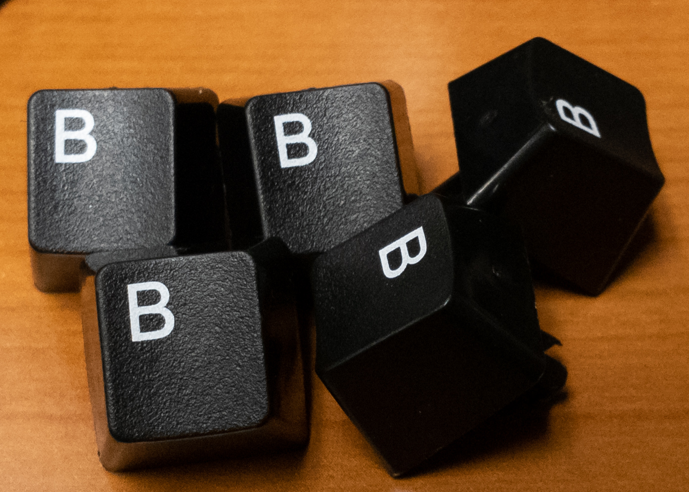

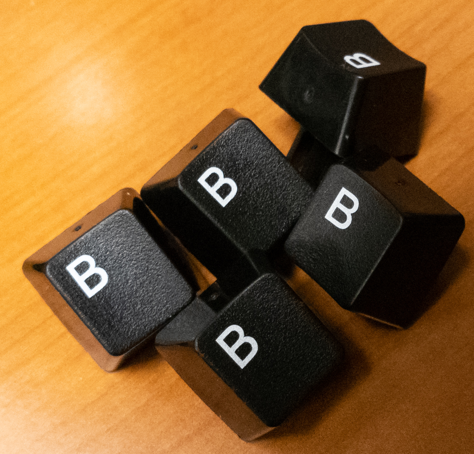

Pad printing update: I received the air shipment from the factory and here are the latest pad print samples. I requested the printing to be thicker like on the original IBM M13. Of course the samples do not have the correct alignment of the finished products. Please disregard the cell phone quality of the photos.
As a reminder please sign the White text on Black Keys Pad Printing Interest form to reserve your spot in line for these sets: https://docs.google.com/forms/d/1873Q9w ... 4XtN1DfNk/
So far there are 65 requested sets which is enough quantity to proceed with production after good samples are produced.

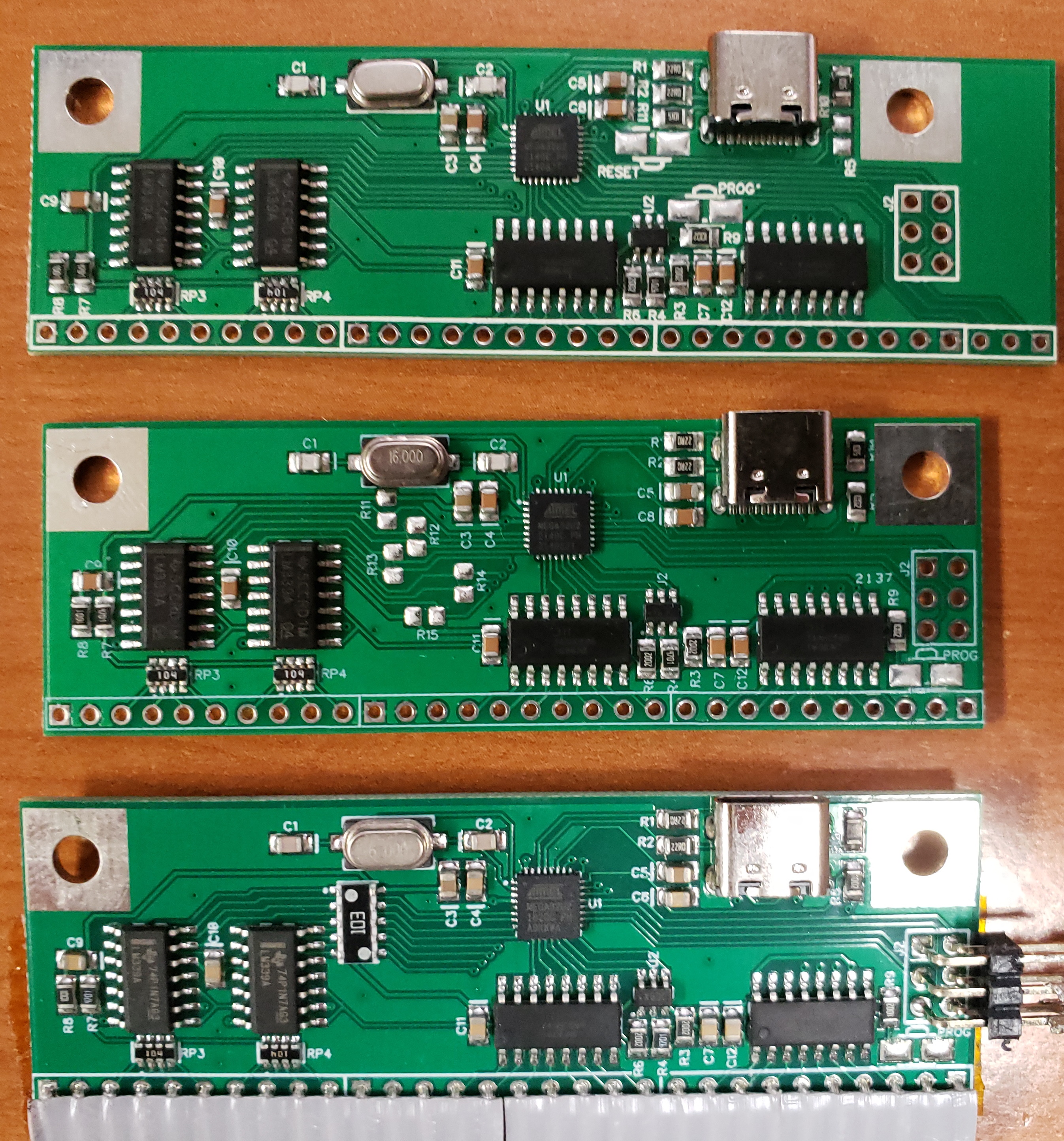

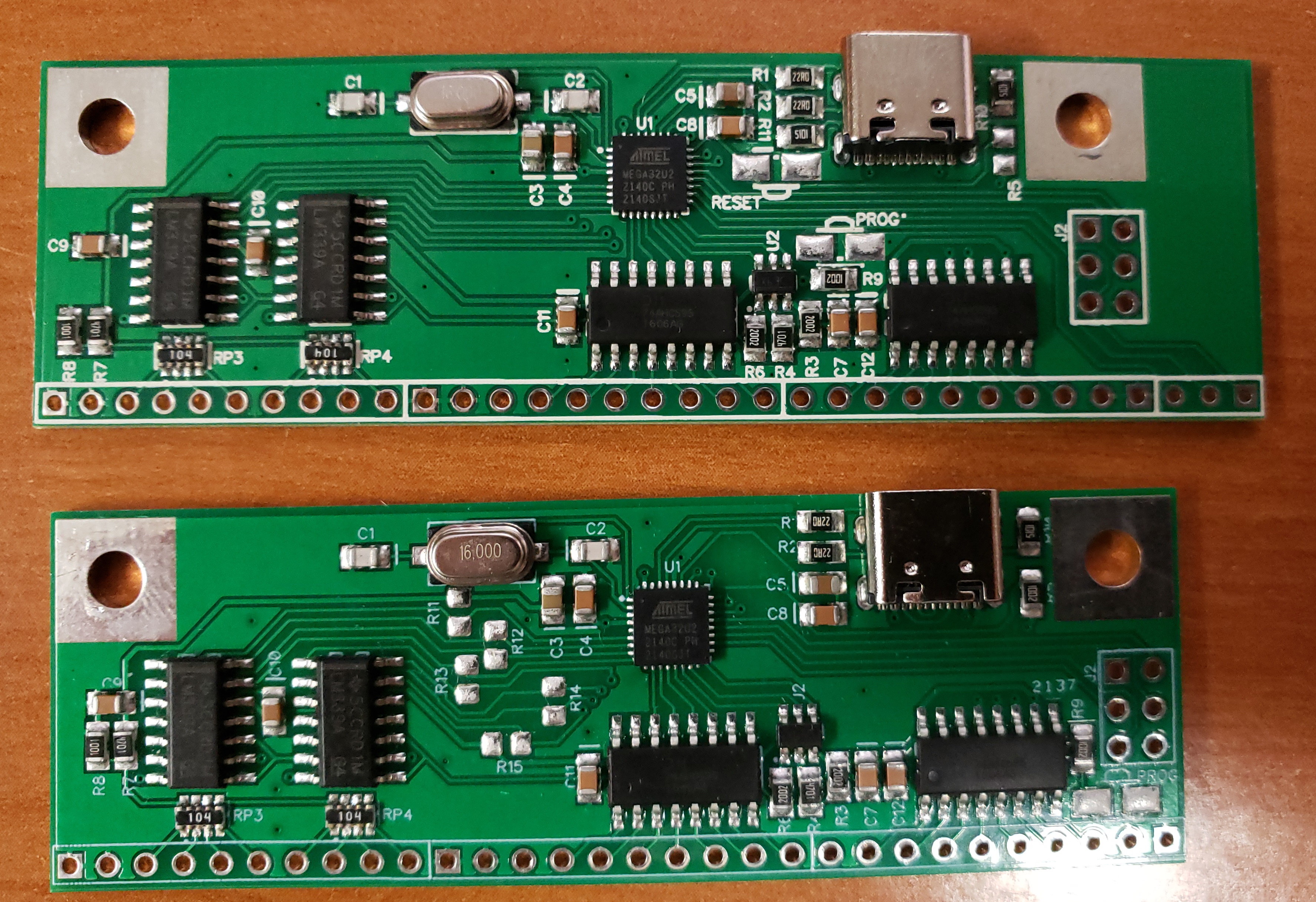

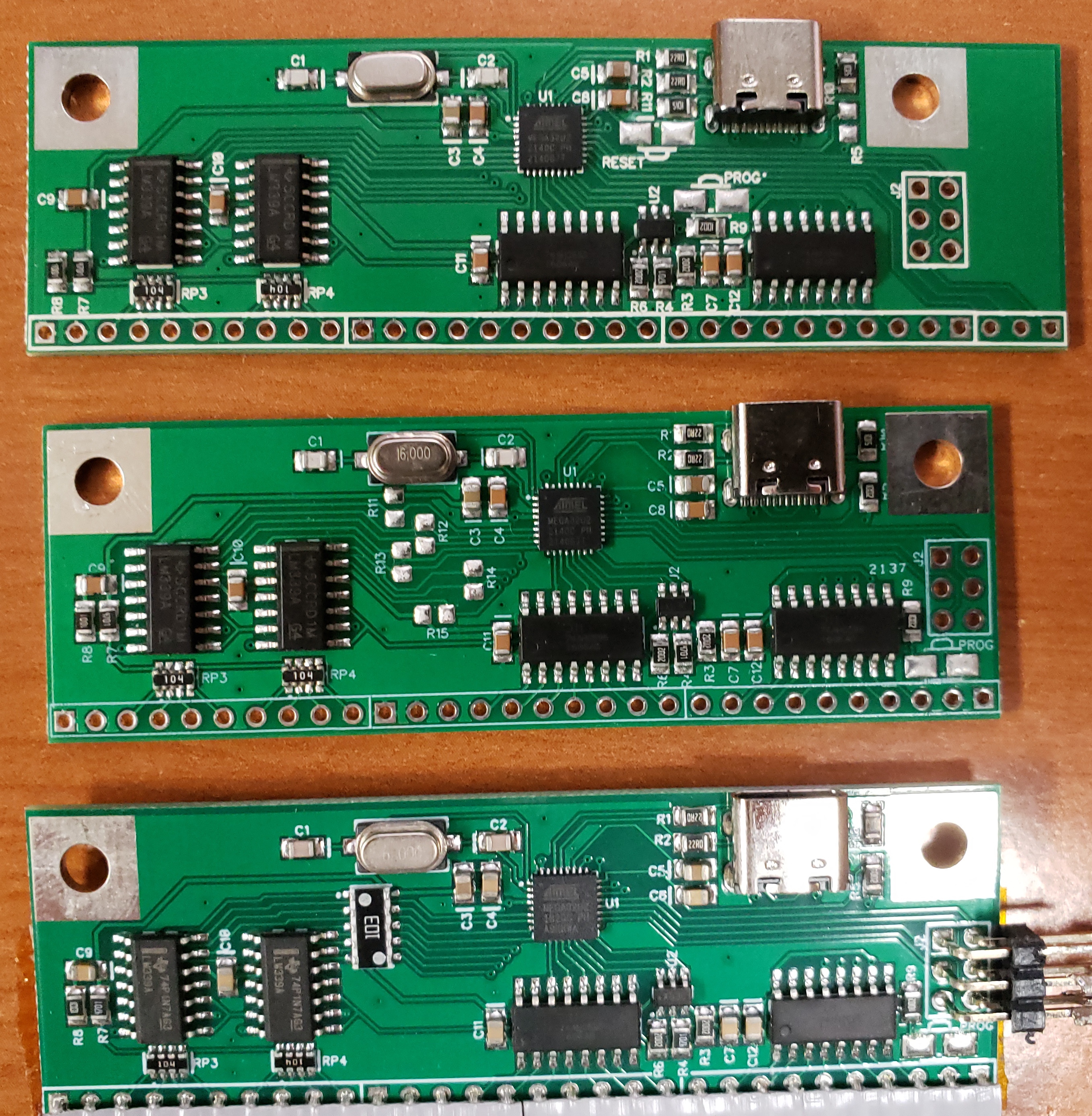

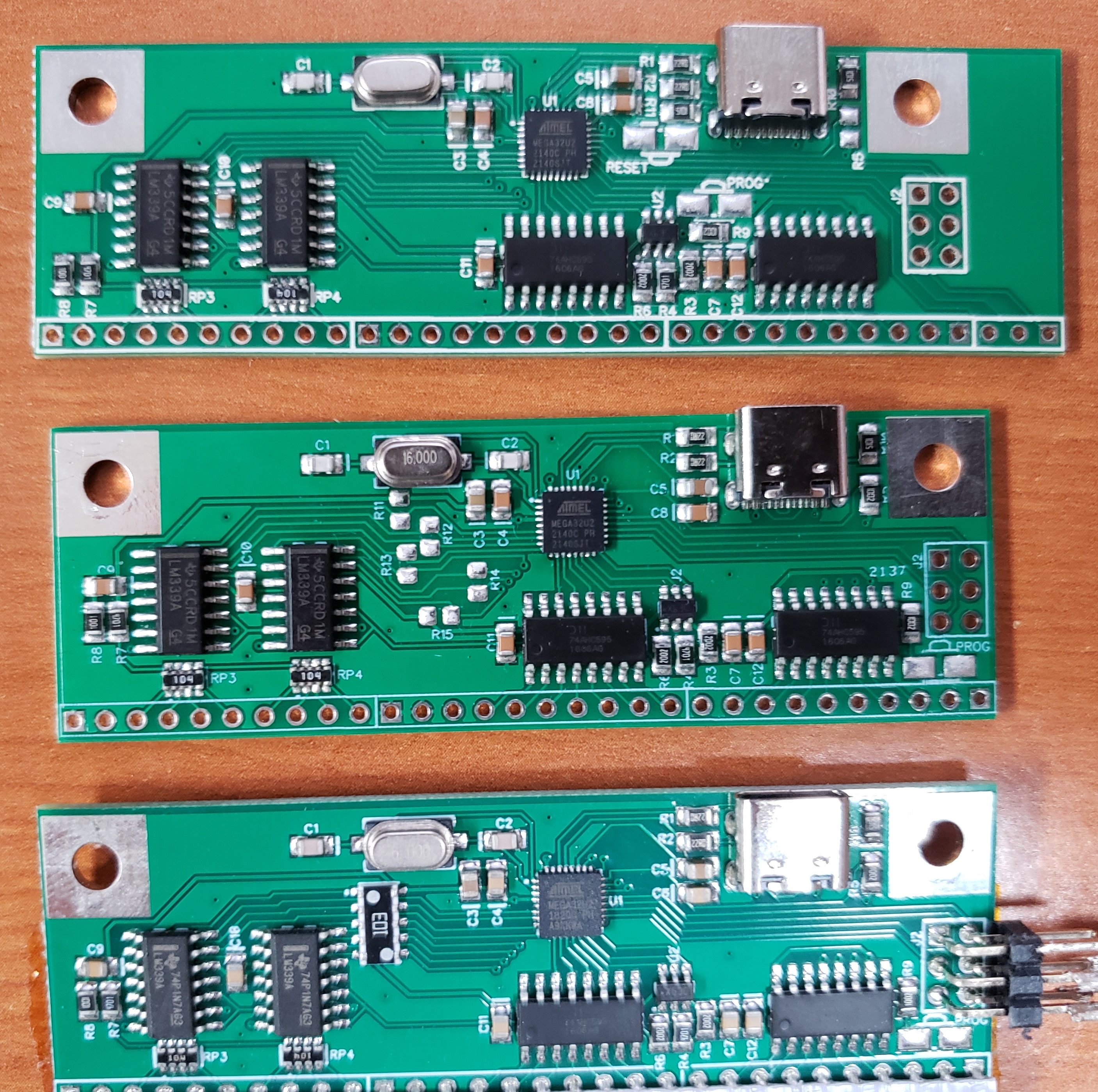

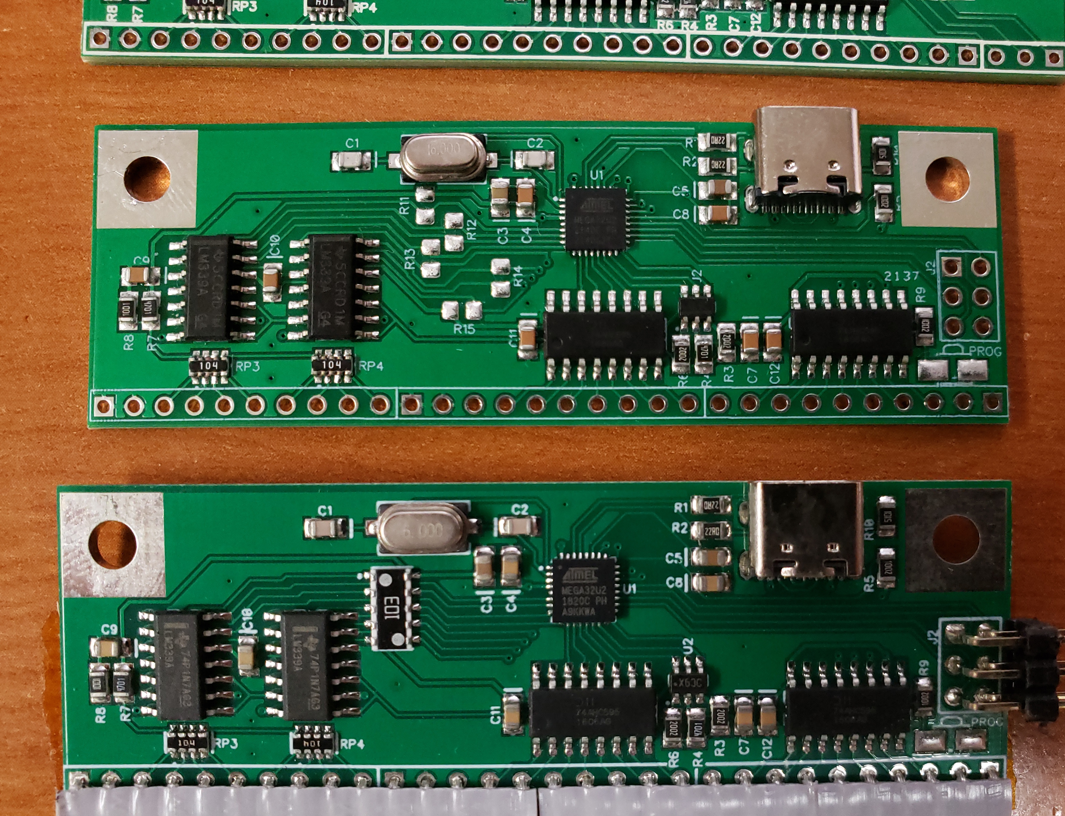

PCB issue:
I received the sample controllers from the most recent batch and it appears that the 6th and 10th pins from the left hand side result in the xwhatsit utility's entire matrix turning from grey to white, instead of just the selected row turning white. Interestingly these are both the rightmost connections to RP3 and RP4. The other rows work normally. This is for the standard controller last year without alterations and following xwhatsit's Model F testing guide (reattached here). It happens on all of the controllers I've tested from this batch but not on the older controllers.
The updated 33 pin controller has the same behavior, but at the same threshold 80, the 3rd pin from the left changes rows 2,3,4,7,8. Same with the 4th pin. Other pins cause flickering of the remaining rows and other rows turning white correctly. Pin 5 correctly changes row 1 in the xwhatsit capsense utility. Pin 8 correctly changes row 5. Not sure if updated xwhatsit original style firmware is needed for this controller.
Any ideas?

Ellipse wrote: 01 Jun 2022, 00:30 PCB issue:
Any ideas?
seriously looks like your RP3 and RP4 are 10-pin while PCB is made for 8-pin ones.
flowchartsman
02 Jun 2022, 04:56
DMA wrote: 02 Jun 2022, 02:52 seriously looks like your RP3 and RP4 are 10-pin while PCB is made for 8-pin ones.
Yep, sure does, doesn't it? It actually looks like at least one of them is okay, while the others are definitely not. Pin spacing means some of the contacts are almost certainly bridged.
For instance. This one looks like it might be okay:
This one definitely not.
My money's on a stock mixup and the wrong roll got put on the pick-and-place, or they thought they could get away with using the 5 array and they might have been able to if they'd have gotten the spacing right. But they didn't
Ellipse
02 Jun 2022, 05:38
Thanks DMA and flowchartsman! I have let the PCB factory know about the error. The photos showed 2 controllers from the new sample batch and one older working controller (the one with the ribbon cable and that has the 8 pin RP3 and RP4 parts).

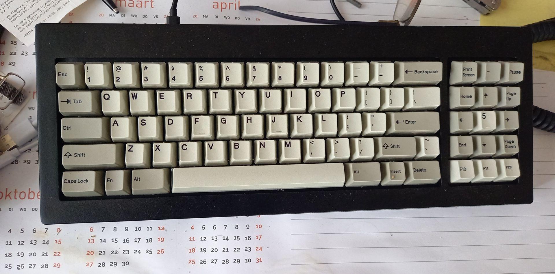

flowchartsman wrote: 01 Jun 2022, 04:00 What, like this?
Honestly, that's...not bad.
I do think that the caps lock with the LED in the center of the padlock is the most awkward of the 3...looks a bit visually crowded, maybe? As I said, it's a hard problem to solve, and IBM did this to themselves...
Still, this is my favorite effort to-date that I've seen.
