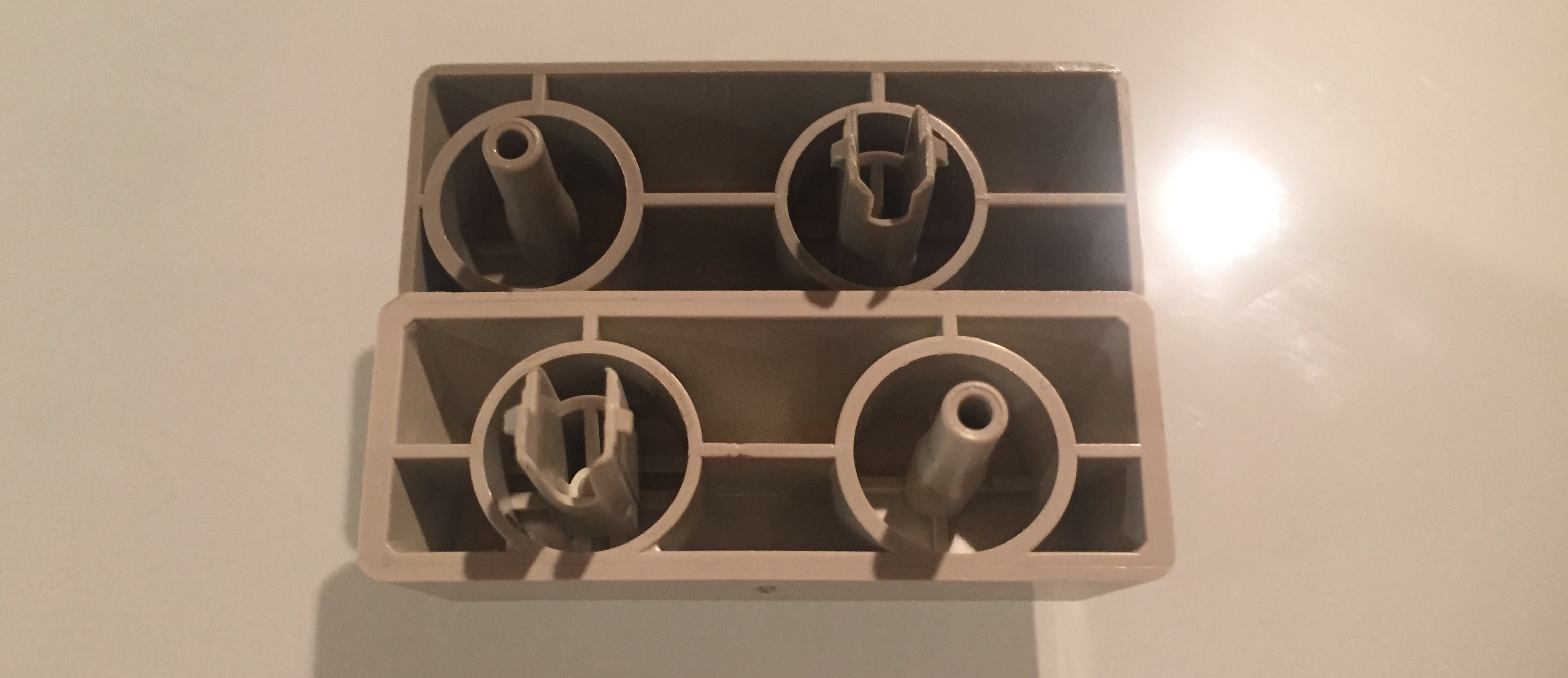

I have a question actually... how difficult would it be to tool in the extra barrels needed for the JP layout? In particular the split spacebar:
It would be awesome to use those keycaps on a MF and assign the others to extra macros (thus allowing even more keys to be had). But, I assume it wouldn't be practical to re-tool everything. And i$'s PCBs would have to be modified, too.

micrex22 wrote: I have a question actually... how difficult would it be to tool in the extra barrels needed for the JP layout? In particular the split spacebar:
You'd have to have the extra pads on the pcb, which would require amending that. I don't think that's a huge technical hurdle, as the windows keys were added at one point, but wonder if it's too late in the game for it. The demand may not be there to justify the expense.
The left key on a split spacebar needs to be a 1u spacing, otherwise it would require a different PCB altogether. The only alternative configuration I have ever found that would technically work well for what we have now (requiring 3 extra pads/barrel cutouts) would be this. It is a right shift from an M and the "Code" key from a Wheelwriter. I am still debating about adding it. Unicomp would carry the blank right shift and ctrl/alt, but the Code key would require some Wheelwriters become useless (my two keys are from unsavable typewriters). It would be a good layout for myself.

fohat wrote: It looks to me like it would take pads and cutouts for 2 Codes and a standard Control or Alt-sized key on the right.
The active barrels look like they would both need to be on the left rather than the right as on the Shift key.
Size wise... I agree, the problem is the "Code" key is not a 1u on the left side, so it couldn't support the standard spacebar stabilizer barrel. I am traveling again already, but do have this in the cloud luckily to post. Right shift on top, Code key on bottom.
Not suggesting I tried EVERY configuration possible, but attempted many. This was the only layout I could find that honored the old, but provided an alternative. In theory, it would handle right or left-hand spacebar usage well. I have found that most people always space with the same hand, so most would gain two keys. If you count the winkeys, that would be 4 extra using Model M, plus 1 Wheelwriter, originals. Note though that the "Code" key is rounded vs slightly concaved for the surface (I actually like that)

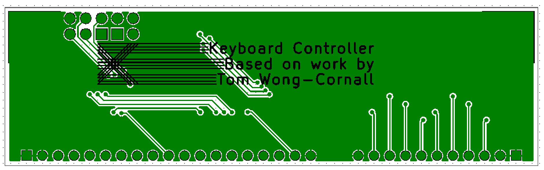

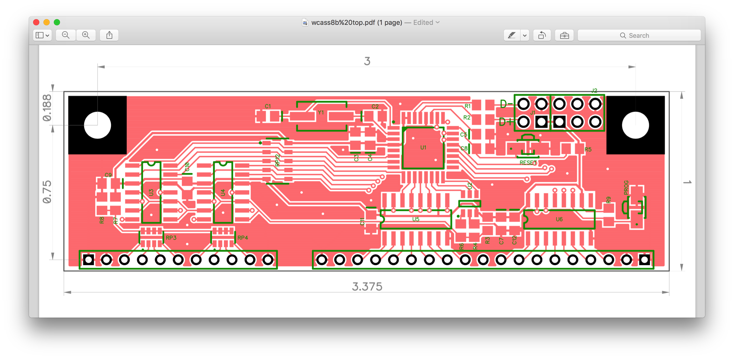

WCass has made some updates to the mini xWhatsit for us. A reminder, this will be using the FFC (Flexible Flat Connector) to slip directly onto the PCB without cables or soldering. No 30 pin connector exists, so it will use an 11 and 19 (identical to the format many of us have soldered the xWhatsit on if using two cables). I will order right away so we can test it out. The only remaining electronic tasks, aside from testing, would be the connector changes to the PCB itself.
WCass is doing some great work for us here. It's highly appreciated

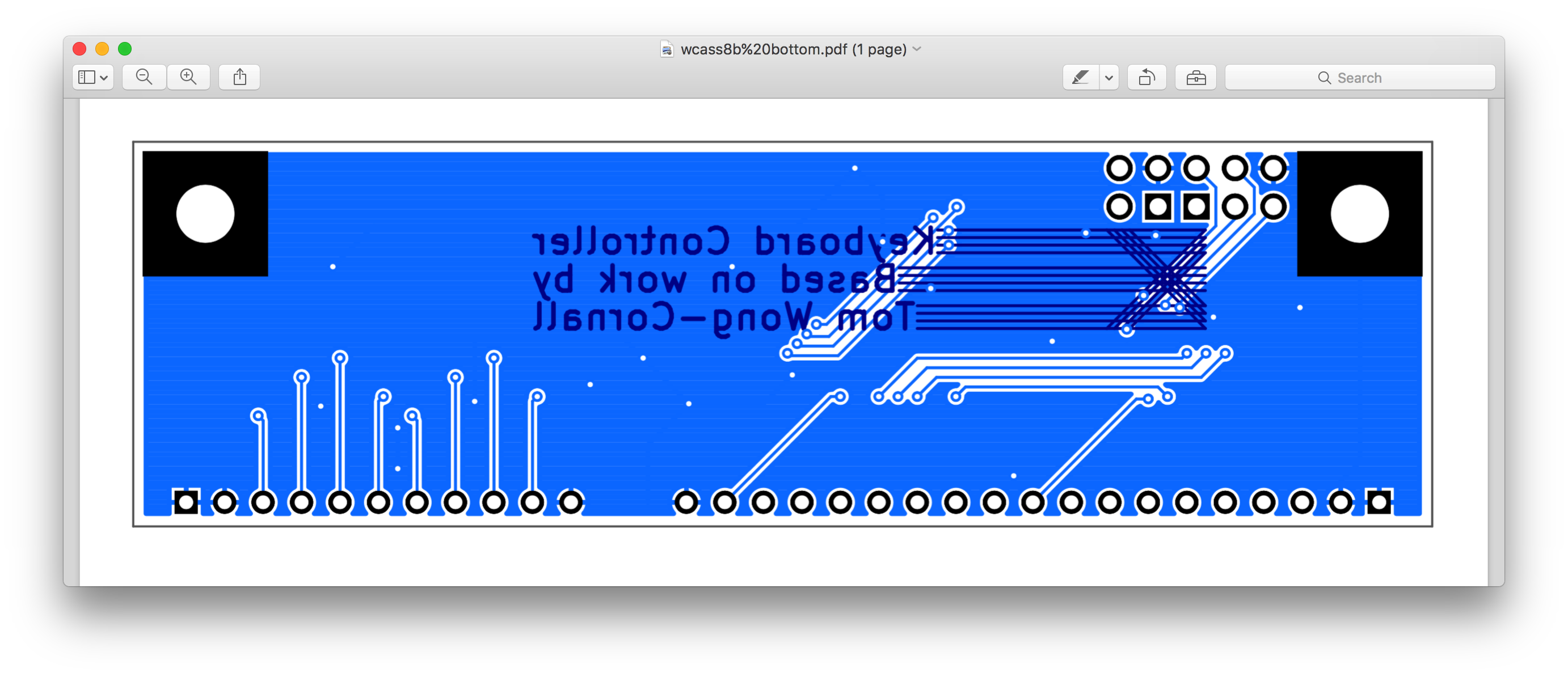

Here goes a dumb question... Shouldn't there be a notch in the PCB between the 11 and 19 pin connection points? I'm assuming this based on the picture of the FF connector that you linked, which looks like it's closed on the ends.
BTW, I really like that it's split into two connectors. That makes it impossible for a buffoon like me to insert it ass backwards. ;P
Oh, also, the shot of the PCB from the bottom should have the connectors on the opposite sides, but if it's just a mock up for us that shouldn't matter.
Ratfink
15 Aug 2016, 15:41
Techno Trousers wrote: Oh, also, the shot of the PCB from the bottom should have the connectors on the opposite sides, but if it's just a mock up for us that shouldn't matter.
It's pretty standard for EDA software to show the bottom of the board mirrored, as though you're looking through the top. That's what's going on here; notice the xwhatsit logo is mirrored as well.
lot_lizard
15 Aug 2016, 16:06
Techno Trousers wrote: Shouldn't there be a notch in the PCB between the 11 and 19 pin connection points? I'm assuming this based on the picture of the FF connector that you linked, which looks like it's closed on the ends.
Right... the PCB will be altered to look more like the beam spring connector.
Exactly... I flipped the image in DipTrace to make it out better

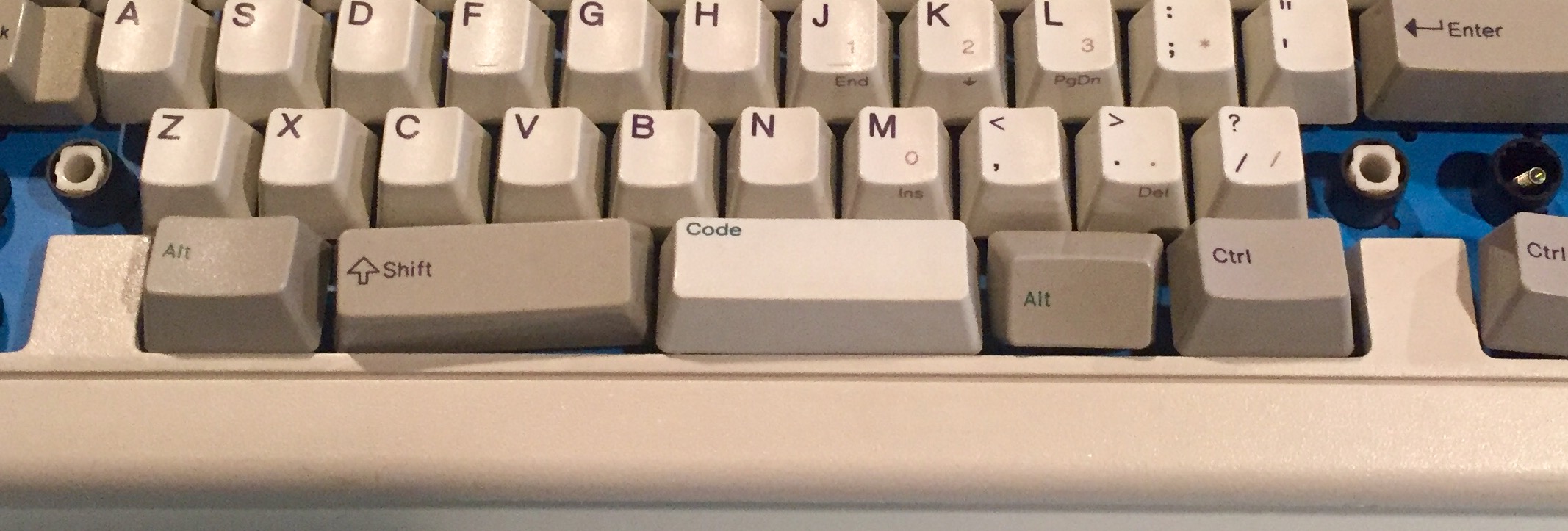

I THINK I am going to add the capability in the top plate for the following configuration. It is three extra barrels that we will just cap (so an impact to the bottom line of about 12 cents). I don't want to impact the schedule with PCB changes though (unless someone wants to take that). The plates are the expensive part about all of this. If in the future you decide to make it work, you will only need to have a new PCB created... and with the new xWhatsit connector, no soldering will be necessary.
I believe it is the only configuration that honors the standard layout, but would allow you to also get creative. If someone dreams up another, let me know.
16 Aug 2016, 19:44
So for what you show, the stabilizer sleeve for Right Shift is going into the current empty barrel at the left end of the space bar, a new barrel will be added for the active leg of Right Shift, the active leg of Code goes in the current space bar barrel, and new barrels are added for the stabilizer leg of Code and the new 1.5u Alt to the left of existing Alt?
And if you wanted the conventional space bar, you simply ignore those 3 holes as if they didn't exist?
That would be pretty cool. I'm glad I have 2 Code keys, even if I map the pieces to space bar, anyway.
lot_lizard
16 Aug 2016, 21:11
fohat wrote: So for what you show, the stabilizer sleeve for Right Shift is going into the current empty barrel at the left end of the space bar, a new barrel will be added for the active leg of Right Shift, the active leg of Code goes in the current space bar barrel, and new barrels are added for the stabilizer leg of Code and the new 1.5u Alt to the left of existing Alt?
Exactly... well worded. We will just use sheet metal plugs to guard against debris. I have some pictures of the assembled SSK (traveling still), but will try to put a post together of all the happenings. It will show the plugs where the winkey locations are. We would use the same for these three (sit nice and flush)
