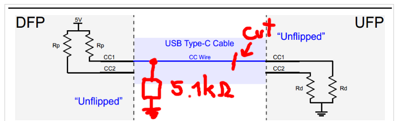

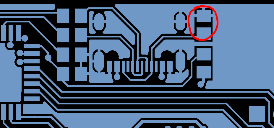

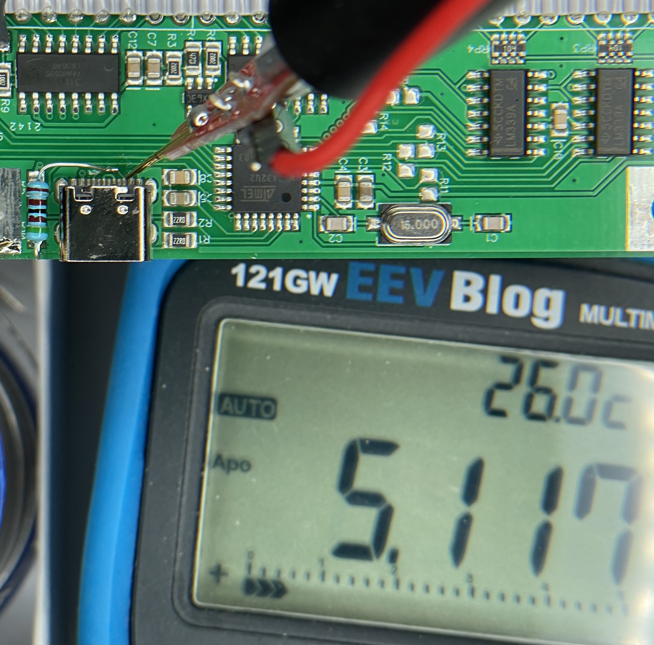

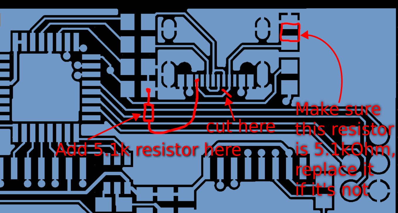

Arkku wrote: 28 Jul 2022, 14:17 (I also wonder whether disconnecting some pins from the USB-C connector might work to the same effect? TBH I have not looked too closely at USB-C specs, but I'm sure the Atmega32U2 can't handle anything beyond the old USB 2.0.)
Arkku wrote: 28 Jul 2022, 16:51 I wonder if the properties of this adapter would be possible to recreate by adding some resistors to the controller inside the keyboard… Unfortunately the PCB-mounted USB-C connector has really tight pin spacing, so seems a bit hard to do after the fact.
  1. The following should make any proper USB-C-to-USB-C work (if you have this version of the PCB):
    The cut (with a thin exacto knife) will make sure that you don't have to lift the USB connector pin, and I think it's easier to perform a cut than to lift a pin. Soldering a thin wire to that pin will be a little harder, but I think it's doable with good soldering equipment. Be really careful not to cut into other traces.
    Instead of soldering directly to the pin, like I've shown, you might also try to just scratch the solder mask of the trace the pin is soldered to, and to solder a thin wire to the left side of where you made the cut.
  2. You may also be able to find a cheaper non-active(non-e-marked) USB-C cable that will work without modifying the controller, only if this resistor is 5.1kOhm in size (EDIT: confirmed by Arkku, that it's already 5.1kOhm):
    (I don't know what the value of this resistor is, please measure it.)
    WARNING: generally stay away from very cheap/no-name USB-C-to-USB-C cables. If they are wired incorrectly, they can kill your devices USB ports. I was only pointing out that non-active(non-e-marked) cables tend to be cheaper than active/e-marked ones. But you still want a quality cable!
  3. The following is not recommended, don't do this:
    You could also make a hacked non-compliant USB-C-to-USB-C cable by modifying a non-active(non-e-marked) USB-C cable like this:
    So cut the CC wire, and add an 5.1kohm resistor on one end.
    I really don't recommend doing this, just showing it for the sake of discussion. This forces the end with the resistor to be the host end of the cable. WARNING: you could kill your laptop's USB port if you do this and don't know what you're doing.
    Also definitely don't do this mod to an active cable, it would be a lot more complicated.
    In any case this only makes sense if the resistor I mentioned in point 2) is not 5.1kOhm in size, and you don't want to replace it with an 5.1kOhm one.
  4. This is probably obvious but you can also use a USB-C to OTG adapter (like you get with some phones: Example) with a USB-A to USB-C cable, if the only problem you're trying to solve is plugging the keyboard into a host that doesn't have USB-A. The only thing to keep in mind that this adapter must be on the host side, not on the keyboard side!
  5. You could also use something like this USB-C breakout board, add two 5.1kOhm resistors (CC1 to GND, and CC2 to GND), EDIT: no, 5.1k resistors are already there, you don't need to add anything to CC pins, just connect the GND/VBUS/D+/D- pins to a cut-off usb-c cable/plug (which must not have a chip in it, if you cut one off a USB-A-to-USB-C cable then there probably won't be a chip there), and hide this whole contraption in the keyboard. It's basicly the same thing as option 3) but a lot less likely to end up accidentally plugged into something else with the wrong orientation, that might die from it.

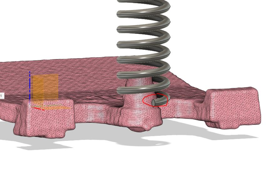

I have a question about the instructions for reattaching a spring. In the "Model F Quality Control Secrets" video it states that "the top end of the spring wire must finish between the 12 o'clock and 1 o'clock positions." In a recent post in the Dick Harris question/answer thread SneakyRobb seems to say that Dick Harris suggested that the spring should be opposite to what the video suggests, with the bottom end of the spring finishing in that position. Here's the picture from SneakyRobb showing what he says is the proper orientation:
flipper spring orientation.JPG (73.81 KiB) Viewed 22597 times
I wonder which is correct and what happens if the spring ends up in the wrong orientation?

daneli wrote: 07 Aug 2022, 01:53 I wonder which is correct and what happens if the spring ends up in the wrong orientation?
As experienced recently: I vaguely remember that boths ends of the spring I removed have the same orientation; what happens is that the key won't register reliably, or only when pressing the key a certain way, even though it clicked, probably because the ending of the spring matches the inner of the key, and the added micro-length just adds the required pressure to press the flipper...
My Left-Ctrl key was "wrong" even though the orientation was "just 12 o'clock". I turned it a bit towards 1 o'clock.
