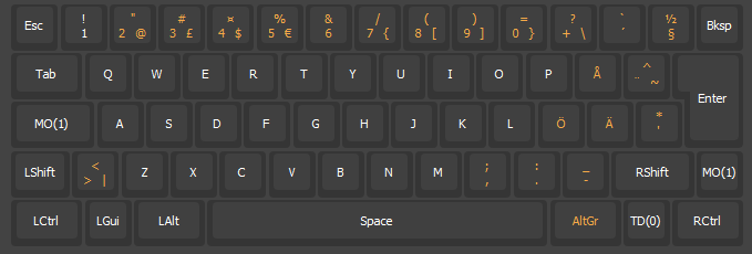

Miky2147 wrote: 24 Aug 2022, 21:21 - I am Italian but for some years now I have not used the ITA layout anymore, I only use the US layout. I have a question: to write in Italian I need to use accents (and the apostrophe) that on the US keyboard for the grave accent I have to press first ~ `(top left under esc) then the letter concerned and it will come out for example the accented letter "è". This keyboard doesn't have that key but it has the esc key in its place, how am I going to type?
Note that you can remap keys as you prefer. Personally I have the ~` key in the top left corner, and to get Esc I can press Fn together with that key. My Fn key is done using the split right shift. Of course you can also do the same the other way around, so that it is Esc normally but Fn + Esc is ~`, whichever you use more.
Another thing you can do to get an Esc is to configure a key like Ctrl as a combo key that works as Ctrl when you hold it and press another key, but sends Esc if you only tap it. (I do this with the "caps lock" key, i.e., the key that is above left shift.)
Splitting the backspace is of course a viable option, which I have also tried but I seem to have a reflex to press the left side of backspace when I correct a typo I just made and the right side of backspace when I'm deleting something that was there before… So it may take a bit of getting used to. (I converted one of my F77s to a split backspace first but reverted it back to a normal backspace a week later. I'm still trying the split backspace on my F62, though.)
Anyway, my point is: these keyboards are very customisable: you can do custom mappings in firmware, including one or more "Fn" keys and layers that you can toggle between, and if you get a few extra keycaps you can split or unsplit keys later.
I'm in a similar situation where I need the JIS 半角/全角 key (which is on the ~ keycode) - what I did was split left shift and place it on the extra key I got from that. It ends up being a much more convenient location anyway.

PRIPARA_PLAYER wrote: 25 Aug 2022, 23:43 I'm in a similar situation where I need the JIS 半角/全角 key (which is on the ~ keycode) - what I did was split left shift and place it on the extra key I got from that. It ends up being a much more convenient location anyway.
Left shift is already split on the ISO layouts normally, so that key is typically already in use for something else. Apple does exchange it with the top left corner key by default, compared to PC keyboards, so in that sense your approach is almost standard. =)

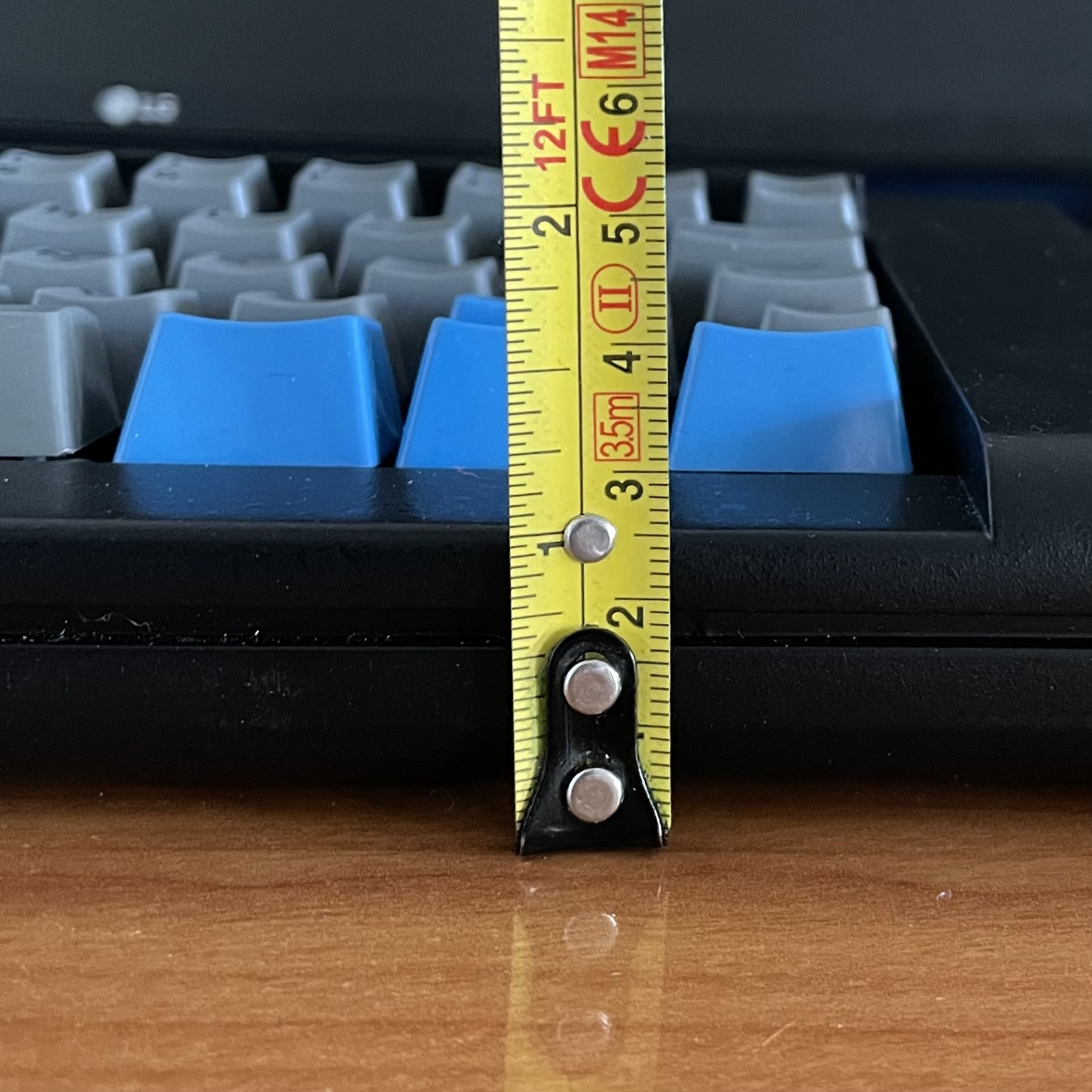

Hi, just wondering, what are the front heights like for the new model F keyboards? Thanks!

wufishy wrote: 27 Aug 2022, 08:40 Hi, just wondering, what are the front heights like for the new model F keyboards? Thanks!
About 24–25mm to the flat part in front of the keys (without feet on the zinc case and with cork feet on the aluminium case, which has protruding screws on the bottom and needs the feet).

Arkku wrote: 27 Aug 2022, 11:40 flat part in front of the keys.
Do you mean from the desk to the front bottom edge of the keycap? Thanks!
Arkku
27 Aug 2022, 14:54
wufishy wrote: 27 Aug 2022, 13:23 Do you mean from the desk to the front bottom edge of the keycap? Thanks!
Yes, but you need to add the feet if you use them, and there are different options… This is with cork feet:
(Angle of photo may result in slight inaccuracy, but it is just over 25mm, so I wouldn't be surprised if it was intended to be exactly 1 inch.)

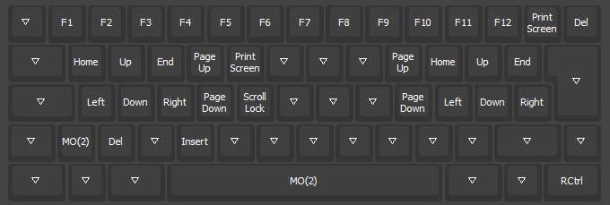

FWIW I'm very happy with my board, but it took a bit of work.
Naturally you'll hear more from people who need help solving their problems, and less from people who have no problems. Here's my feedback/experience.
I ordered my F77 in October 2016 and received the board April 2022.
First impressions back in April:
- It feels amazing, but noisy as heck
- Too pingy and inconsistent compared to my other Ms
- Manual was intimidating, and I was too impatient to watch youtube videos of text. Felt difficult to find information I needed (installing stabilizers, programming QMK).
- Thought I installed a stabilizer incorrectly and took a while before RTFM to find the screw method. Turns out I just have an Enter key that liked to bind a bit.
- Typing felt weirdly inconsistent, like keys weren't registering properly or dropping presses.
- I'm on Mac now and don't want to give up Touch ID
- I spent all this money and waited so long for a board I'm not immediately fully happy with!? :roll:
- Read / watched some reviews about how people weren't quite happy with theirs either / couldn't bring themselves to use it as a daily board... exacerbated my negative feelings...
- AND there is a TKL Beamspring in the works??
So I tucked it away for a few months (with my other custom collector novelty items like those ThinkPad X62/etc) to instead enjoy summer and touch grass.
Got the urge to clean up some unfinished projects so revisted it again a couple weeks ago:
- Spent a day with the board and discovered the "F" key wouldn't register properly - sometimes it would register out of order, or only on up-stroke. Wanted to avoid opening it up to 'tighten the screws' so kept reading..
- Upon closer inspection the spring was installed around 2 o'clock mark. Reinstalled it at 12 o'clock and now it works perfectly. Such a seemingly tiny adjustment makes the difference between a properly working key and misbehaving key.
- Modded with super floss. Reduces the fatigue from listening to the pinging. Satisfaction went up significantly. Fixing my F key and removing the ping finally made me feel good about this purchase.
- Stole some classic caps off my Model M to round out the build
- Spent the 10 minutes to watch the QMK programming video - would have preferred text & animated GIFs, but now I finally customized the right-side block.
- Learned more about Quantum keys. Added the Esc/~ key (helps a TON with unix work). Now I am making a shopping list to split my backspace and shorten the spacebar. Also semi-contemplating adding a F62 "FHKB" to my fleet. :lol:
If you're feeling upset with your purchase:
- Be patient, do not rush the build/fixes
- Read the manual
- Watch the videos
You've invested hundreds of dollars and waited a long time for the board to be delivered. Spend the time and understand the setup process and common fixes.
I'm now almost 100% happy with my board, just need to split a couple more keys. If you're indecisive about layouts like me I'd recommend buying the extra parts upfront.
Almost its final form - same board, two configs. The blue #s seem a bit much and might revert.

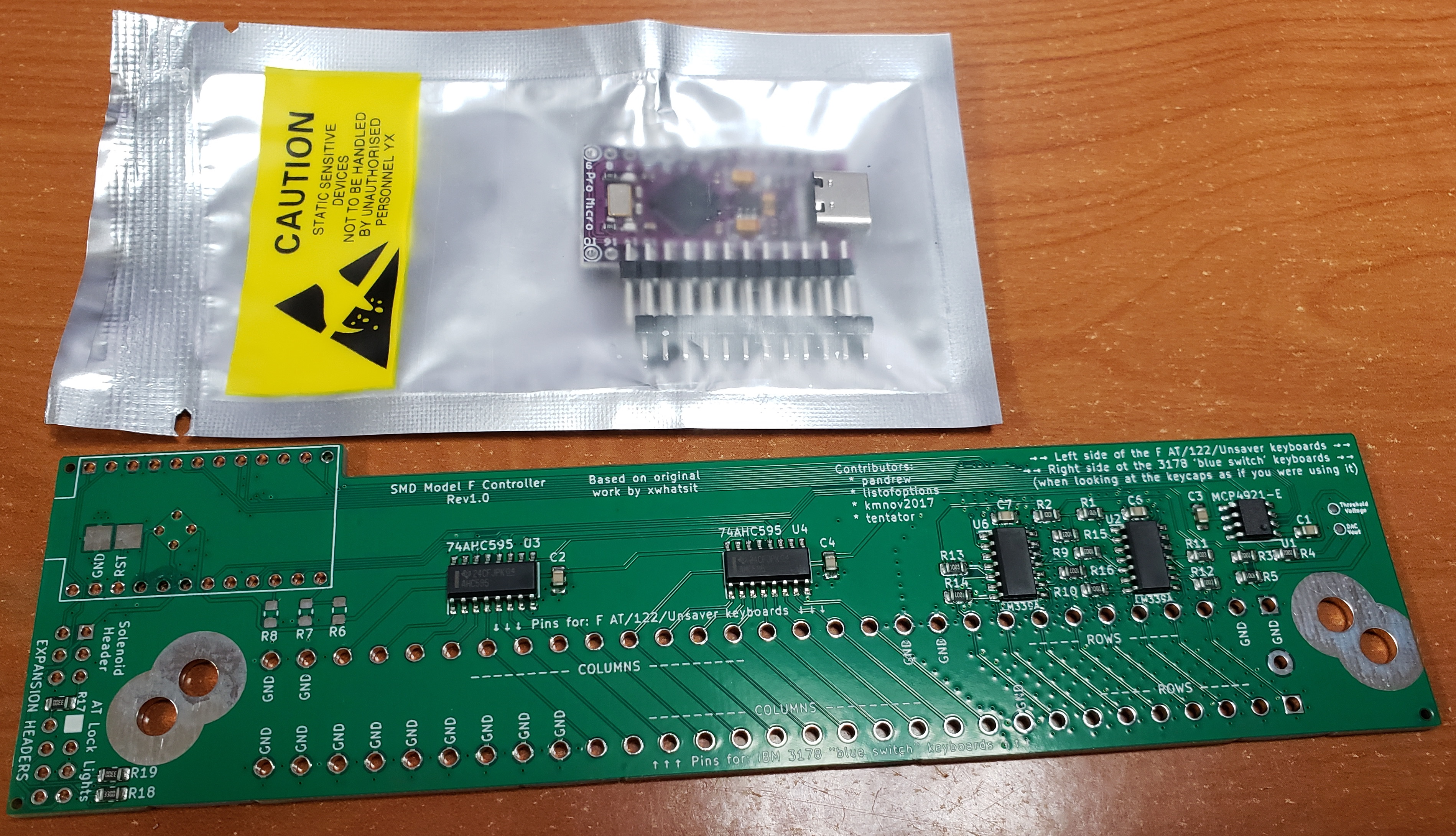

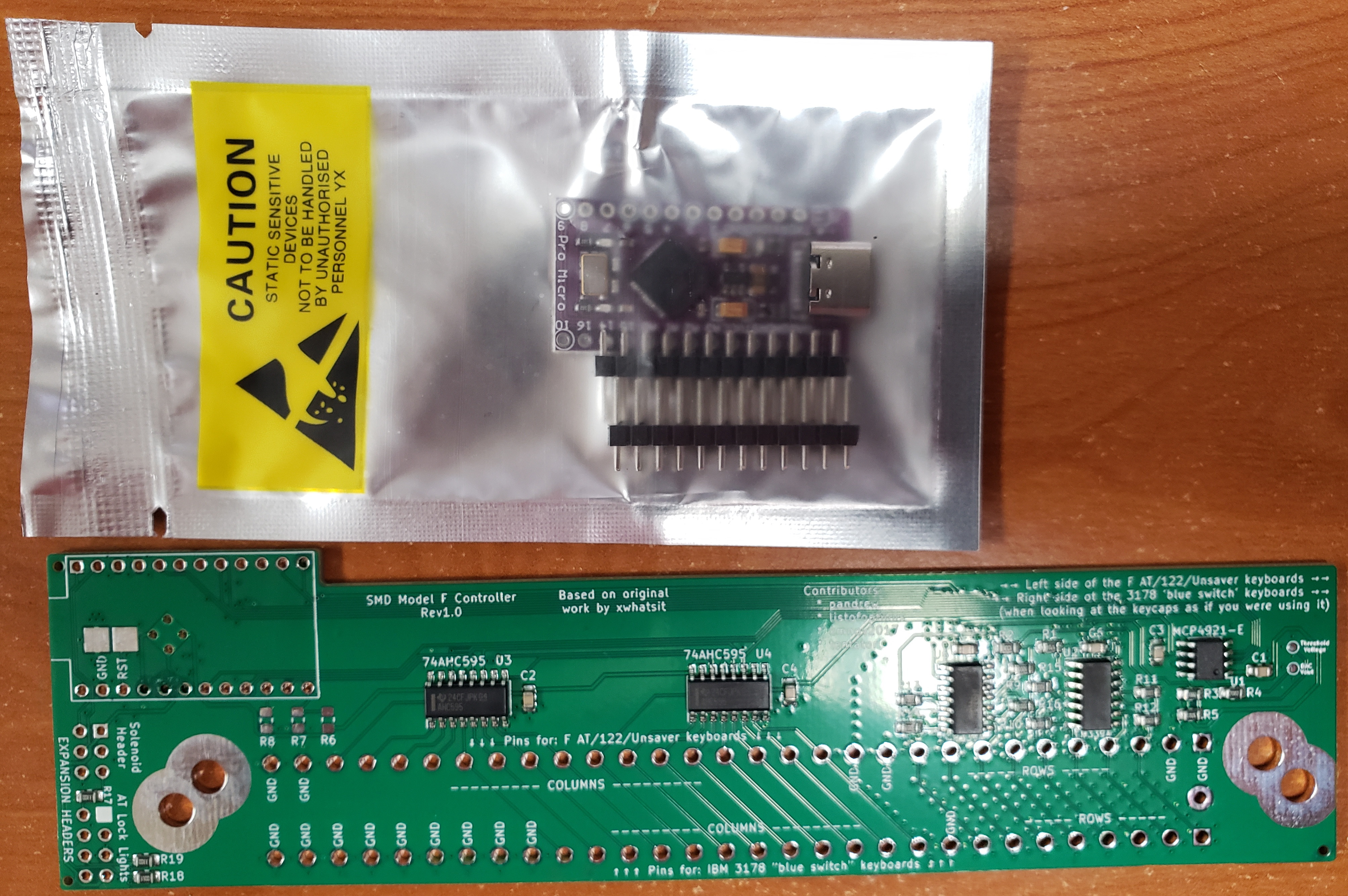

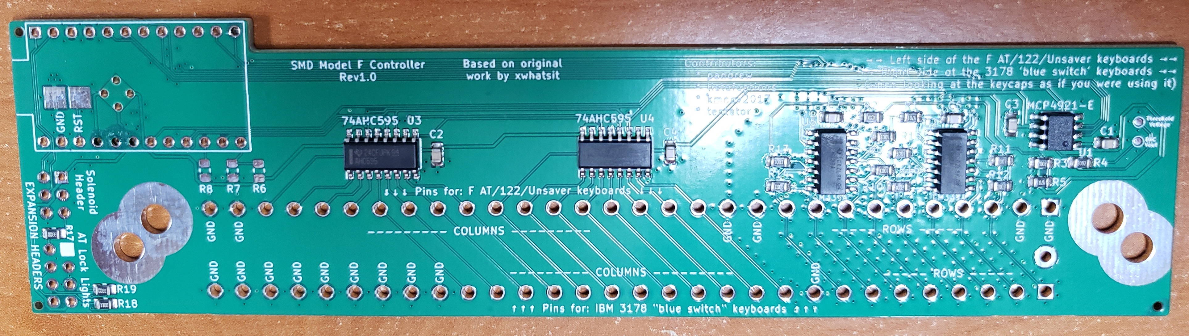

pandrew controllers note: I have ordered 20 assembled pandrew 3178/122/AT/Unsaver type controllers from JLCPCB (I have USB-C 5V pro micro controllers as well, though you'd have to solder these as well as solder any header if needed (I have spare 90 degree and straight up header pins). 2 of these are for my recent 3178 Model F keyboards, of which one is for sale on the project web site. Please do PM or email me if interested.
Arkku this is very impressive! Now we have three types of firmware for Model F keyboards (xwhatsit, QMK/Via, and yours). Any plans for your firmware to support Rico's RP2040-based controller currently in development? https://geekhack.org/index.php?topic=117555.0

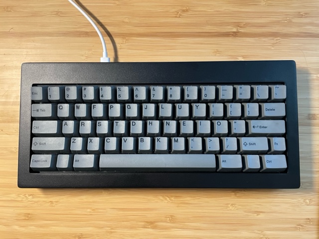

Posting with permission another nice setup - an ultra compact case F62 with dark gray keycaps.
dark gray with black case.jpg (113.94 KiB) Viewed 7166 times

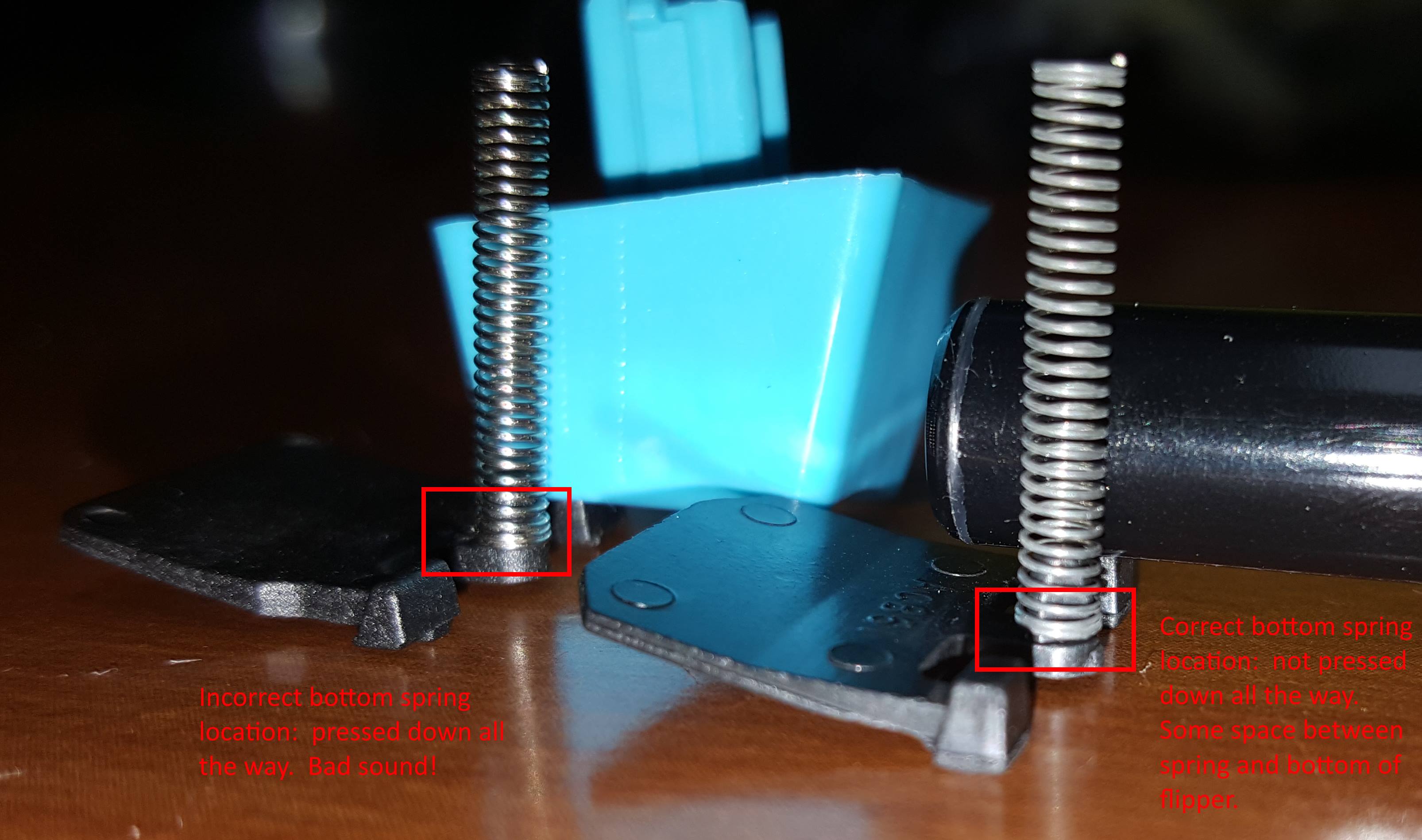

Some more spring research tidbits -
Adjusting the distance between the bottom of the spring and the bottom of the nub of the flipper can oftentimes eliminate buzzing of the spring. Sometimes it's too much distance; wiggling a fingernail in between to widen things can eliminate the buzz. In other examples, moving the spring downwards can fix things. That's why removing and reseating a spring can remove the buzz sound from the spring because it happens to be in a different distance with each installation.
I also had some experiments done with a low number of hours in salt spray testing to see if the springs could be corroded and/or artificially aged. Even with the springs left in for the full amount of the test (~10 hours or so - not enough for full testing) the new production springs did not visibly corrode. Unfortunately there was no benefit to this artificial aging in terms of sound quality (though maybe the test was too brief) so no springs will be offered with this option.
