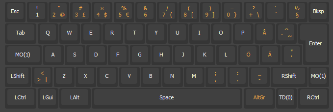

Miky2147 wrote: 24 Aug 2022, 21:21 - I am Italian but for some years now I have not used the ITA layout anymore, I only use the US layout. I have a question: to write in Italian I need to use accents (and the apostrophe) that on the US keyboard for the grave accent I have to press first ~ `(top left under esc) then the letter concerned and it will come out for example the accented letter "è". This keyboard doesn't have that key but it has the esc key in its place, how am I going to type?
Note that you can remap keys as you prefer. Personally I have the ~` key in the top left corner, and to get Esc I can press Fn together with that key. My Fn key is done using the split right shift. Of course you can also do the same the other way around, so that it is Esc normally but Fn + Esc is ~`, whichever you use more.
Another thing you can do to get an Esc is to configure a key like Ctrl as a combo key that works as Ctrl when you hold it and press another key, but sends Esc if you only tap it. (I do this with the "caps lock" key, i.e., the key that is above left shift.)
Splitting the backspace is of course a viable option, which I have also tried but I seem to have a reflex to press the left side of backspace when I correct a typo I just made and the right side of backspace when I'm deleting something that was there before… So it may take a bit of getting used to. (I converted one of my F77s to a split backspace first but reverted it back to a normal backspace a week later. I'm still trying the split backspace on my F62, though.)
Anyway, my point is: these keyboards are very customisable: you can do custom mappings in firmware, including one or more "Fn" keys and layers that you can toggle between, and if you get a few extra keycaps you can split or unsplit keys later.
I'm in a similar situation where I need the JIS 半角/全角 key (which is on the ~ keycode) - what I did was split left shift and place it on the extra key I got from that. It ends up being a much more convenient location anyway.

My F62 arrived a few weeks ago and I've been daily driving it since. The Esc key was a bit bowlegged and required some squeezing to get it to move freely, but other than that it's been running flawlessly. Great work Ellipse and everyone else involved!
I do seem to be missing a 1.5U Ctrl key though. At first I thought one might have been replaced with a Caps lock since I ordered a HHKB-adjacent layout. But then I noticed that there's two 1.5U Caps lock keys in the bag, which makes me suspect a mix-up instead?
If there's anyone in the EU who's got an extra 1.5U Ctrl and needs a 1.5U Caps lock, feel free to hit me up. Seems like a shame to pay tens of euros in import duties and handling fees for a single key :lol:
My preferred layout uses the caps lock position as a function key and does away with the caps lock key entirely:

PRIPARA_PLAYER wrote: 25 Aug 2022, 23:43 I'm in a similar situation where I need the JIS 半角/全角 key (which is on the ~ keycode) - what I did was split left shift and place it on the extra key I got from that. It ends up being a much more convenient location anyway.
Left shift is already split on the ISO layouts normally, so that key is typically already in use for something else. Apple does exchange it with the top left corner key by default, compared to PC keyboards, so in that sense your approach is almost standard. =)
You could follow similar logic for ISO and split right shift instead (which JIS has split by default), although obviously that doesn't work if you already have the HHKB split

PRIPARA_PLAYER wrote: 26 Aug 2022, 02:30 You could follow similar logic for ISO and split right shift instead (which JIS has split by default), although obviously that doesn't work if you already have the HHKB split
Yes, although I do have the HHKB split on right shift on all my keyboards, since I put the Fn key on the split. Another key that can be split is Enter: I wanted dark gray keys and the ISO enter key was/is not available in that colour, so I made a DIY ISO enter by using two separate keys (1.25U and 1.5U, I think). However, in practice I notice I only press one of them, so the other could also be repurposed into a new key.

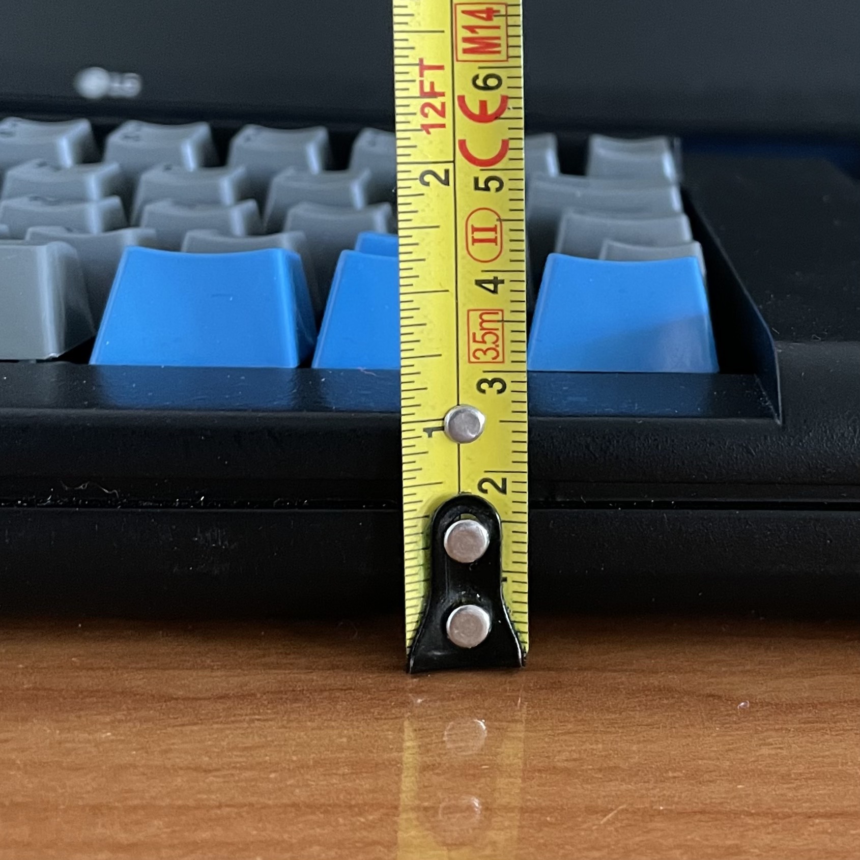

Hi, just wondering, what are the front heights like for the new model F keyboards? Thanks!

wufishy wrote: 27 Aug 2022, 08:40 Hi, just wondering, what are the front heights like for the new model F keyboards? Thanks!
About 24–25mm to the flat part in front of the keys (without feet on the zinc case and with cork feet on the aluminium case, which has protruding screws on the bottom and needs the feet).

by wufishy
Arkku wrote: 27 Aug 2022, 11:40 flat part in front of the keys.
Do you mean from the desk to the front bottom edge of the keycap? Thanks!

wufishy wrote: 27 Aug 2022, 13:23 Do you mean from the desk to the front bottom edge of the keycap? Thanks!
Yes, but you need to add the feet if you use them, and there are different options… This is with cork feet:
(Angle of photo may result in slight inaccuracy, but it is just over 25mm, so I wouldn't be surprised if it was intended to be exactly 1 inch.)
