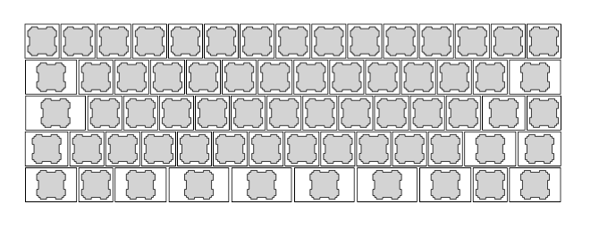

QQ: what's the motivation behind avoiding stabs? hard to source?
also, curious if anyone's tried this: if you have e.g. a 3 unit or greater, can you just mount three switches and take the springs out of all but the middle switch? does that work?
08 May 2014, 00:59
Not too difficult to source. I have hoarded a few for these projects anyway! The reasons to avoid them are: general simplicity (no need to consider their mounting points in our plate and PCB designs), more compact layouts with smaller keys, and arguably better feel and sound. You can surely hear and feel the stabilised keys in your board while typing. Stabs make a difference.
I'm not against using them (I picked them up for a reason) but the idea of going stab-free is interesting in its own right. At least as an experiment.
As for using switches as stabs:
http://deskthority.net/workshop-f7/grou ... ro#p160876
It doesn't quite work. Those wires that stabs have are there for a reason!
bearcat
08 May 2014, 01:17
ah, ok; so even if you take the springs out, you're missing the torsion wire?
Here's the svg for the plate, if anyone wants to put a border around it & ponoko it:

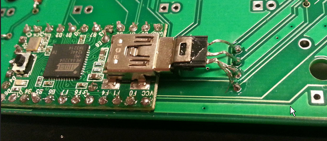

This is what I was thinking for the Teensy and USB :
-[°_°]-
08 May 2014, 11:26
yes it's totally feasible, but I don't think it fits a poker case. At least it wouldn't fit the Alu one I have that admittedly is very slimline

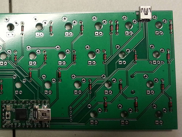

The teensy is placed on the upper side of the PCB under the space bar:

DanielT wrote:The teensy is placed on the upper side of the PCB under the space bar:
that can be done with PCB mounted switches only though. Or you could place a big hole in the plate just under the spacebar
08 May 2014, 16:29
Which you pretty much do already for PCB mount Cherry stabs.
DanielT
08 May 2014, 17:06
Exactly :D and hole will not be vizible because is hidden behind the key caps. I think this is a good option if we want the PCB to be copatible with the Poker case. There are some problems if the bottom row has no classic space bar ... :(
