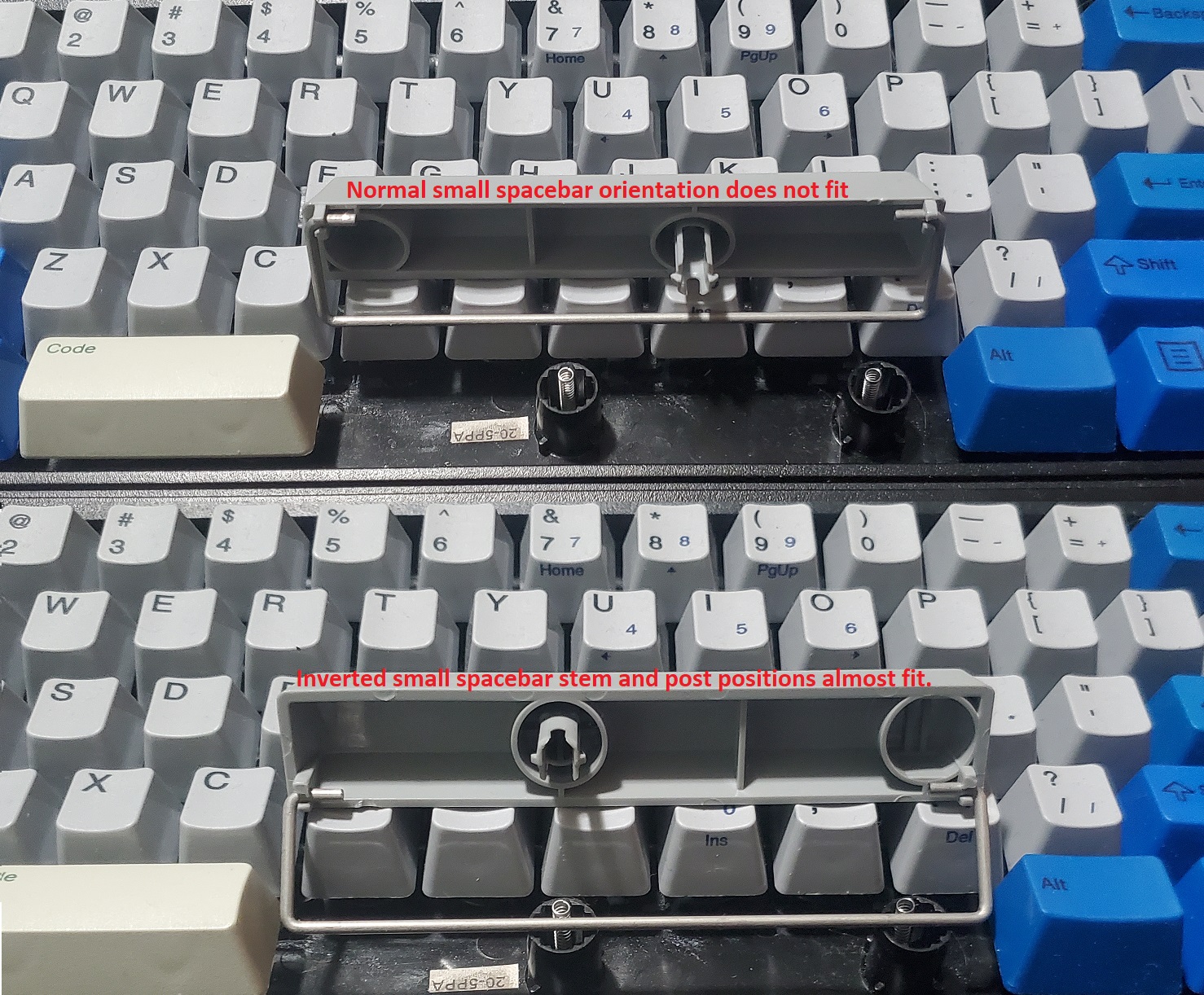

Ellipse wrote: 26 Jun 2023, 23:57 SunshineRag_DT I have ordered the Code keys, PC AT Big Enter, and non-stepped ISO Enter - feel free to sign the interest form here:
Ellipse thanks, one thing I was noting about the spacebar is to make the code key usable with current layouts it probably needs a inverted small spacebar. I understand that this is likely not going to happen but wanted to note that if a small spacebar was made with an inverted post and stem location it would allow the "Code" key to fit in current layouts without sacrificing the RWin. See the attached pic. Obviously this would require a new small spacebar mold but the size will fit..
Just wanted to note this if ever interested in newer split spacebar layouts.

Has anyone modded their spacebar to be inverted as shown? Is it just a matter of adding metal tabs to the other end, to support the reversed wire stabilizer, and then removing the current stem and gluing a Model M stem from a two-part key?
