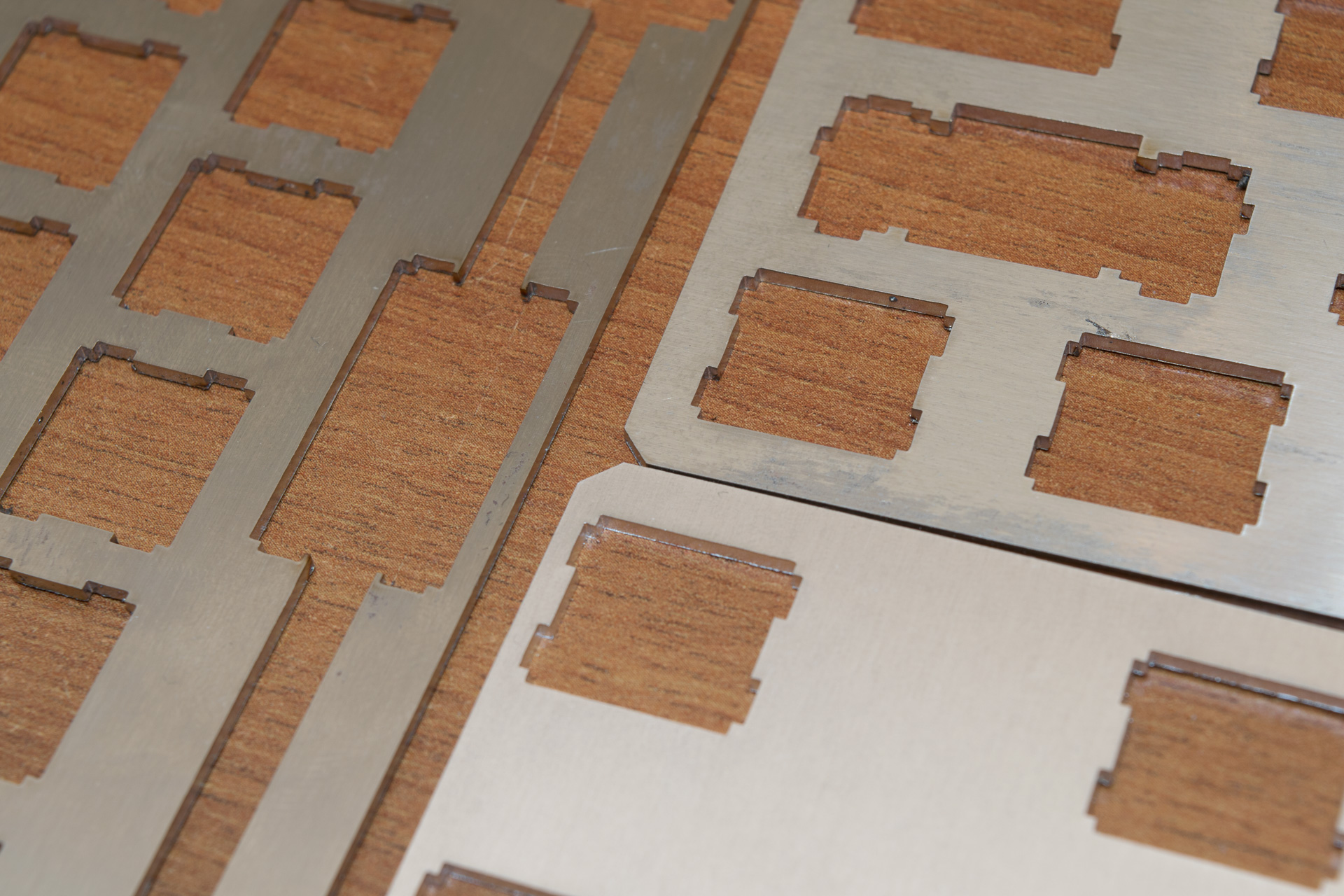

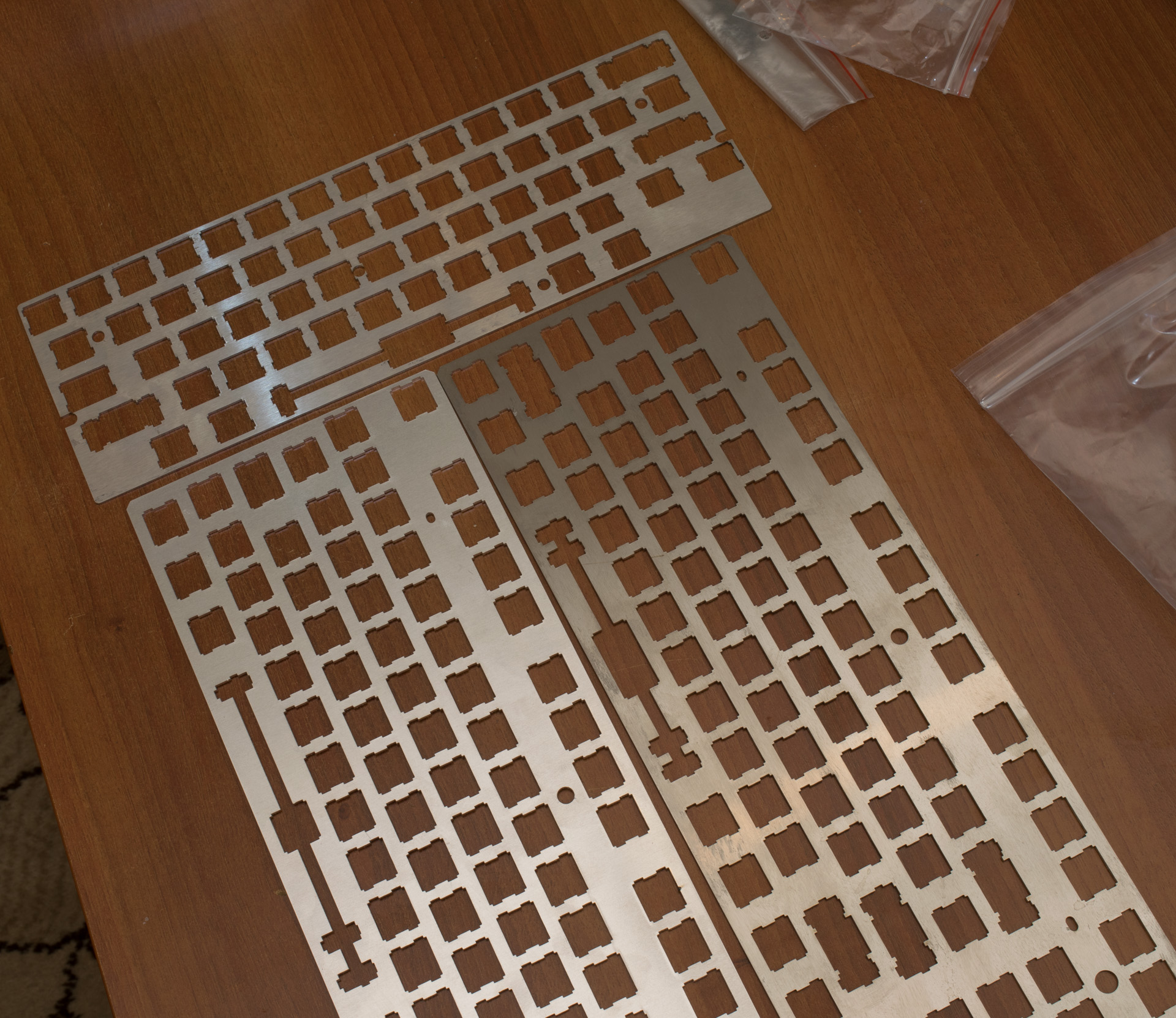

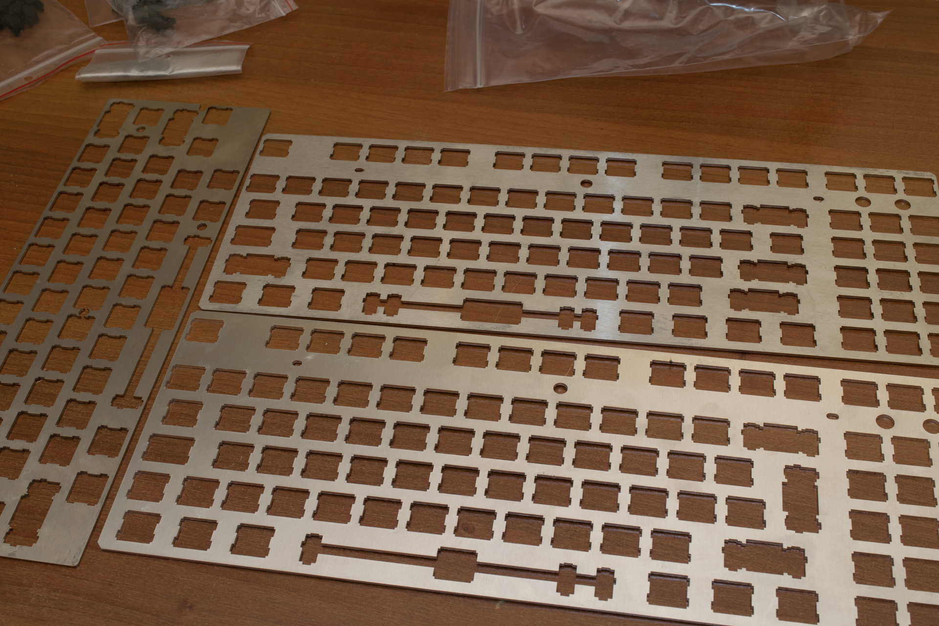

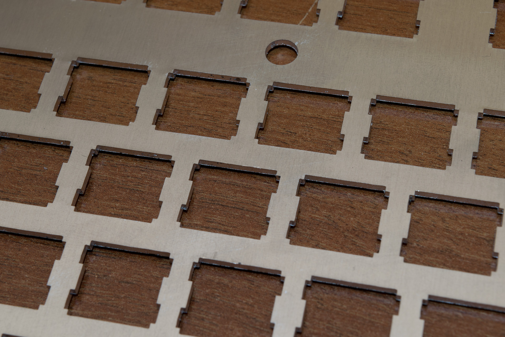

Got the samples today! :mrgreen:
They look nice, are quite accurate, and price is not too bad!
There is a bit of an issue with stabilizers, Costar work perfectly, Cherry PCB mount are tight fit but definitely possible, and Cherry plate mount are a bit hit and miss whether the stabilizer will clip or not (I think this is a problem with all universal stabilizer cutouts). Bear in mind I tested them the way I got them, with minimal deburring.
ANSI and 60% are SS, ISO is aluminium.
Price is 15€ for the aluminium ones and 20€ for the stainless steel.
Depending on quantity and sheet usage and nesting ability price might drop a euro or two, but don't count on it.
You can calculate postage here. (use irregular letter)
Weight is 270g for the SS and 100g for the aluminium, but keep in mind that the alu plates will need extra support to avoid bending (they are VERY easy to bend).
I'll open a formal GB thread probably tomorrow.
