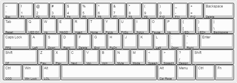

While we're here matt3o, I've asked the manufacturer for an updated firmware for our 60% boards. I used the same layout as the KBparadise V60 and found places to put all of their existing LED controls as documented in the "manual". This place outsources the firmware development and is requesting a MOQ or an additional charge to bankroll things like a programming tool, extra features, etc. But the firmware already supports one Fn layer so simply doing these key mappings should be trivial. Let's see what they come back with.
Updated 60% layout. See http://bit.ly/2bY6f4C.

That looks quite good, but why not move up to Fn+{ (where LED- currently is)? That way, it would be similar to the HHKB. This would be essential for me at least.

It's an arbitrary choice, but, I chose to mimic the V60 instead of the HHKB becase that's what I tend to use more often as a 60% board. Also, the V60 has the same layout, and, the layout I proposed doesn't require any key changes.
I could perhaps come up with another mapping that is more HHKB-like. But right now I'm trying to see if I can get a new firmware at all. If that is easy then I may also request another HHKB-like firmware and give the option of flashing one or the other.

For the firmware / keymapping have you sent that picture to the manufacturer? I have no idea what many of those legends mean and I doubt the manufacturer does either:
WASD
FPS
CF
COD
LOL
Car Race
Design
etc.

Those legends are from the manual. The keyboard firmware offers a bunch of gaming oriented LED controls that are described in this way. There are some photos of the manual in the photo album.
WASD - enter or leave a lock mode where the WASD keys are mapped to arrows.
FPS - illumate key caps in a manner helpful for many first person shooters
CF - same, for Crossfire
COD - same, for Call of Duty
LOL - same, for League of Legends
Car Race - same, for many car racing games

I don't know if anyone's brought this up yet, but will these have media key functions? It's kind of lame, I know, but I've grown accustomed and rather fond if the way my QFRs have them arranged a function layer on the F keys. Obviously, full programmability would be the bees knees, though.
[ XMIT ]
08 Sep 2016, 05:19
Right now, no, media keys are not present. I'm still working to see what we can do for programmability at all. I may know more tomorrow.

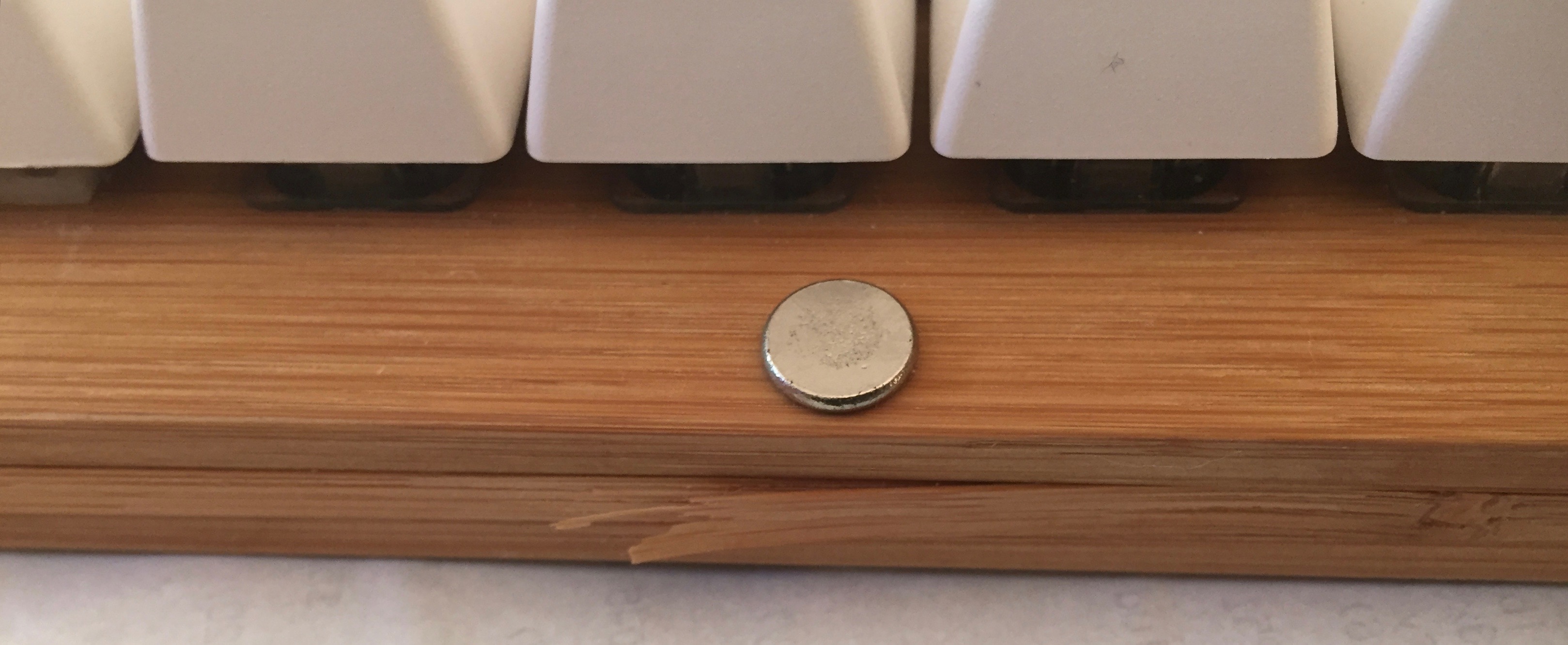

  • Bamboo body - I am a huge fan of bamboo in general. The grain is always very clean, seldom warps, and prefer the carbonized look over natural. They did a nice job laser cutting/engraving the 3 layers, but fell pretty far short when it came to polishing the end result. I can tell the production was a bit rushed when I first opened the case to a strong varnish odor. The edges are quite rough, and there is a pretty uneven transition between the layers. You can tell that very little sanding was done once the plates were cut. Surfaces all the way around are fairly rough. Definitely has potential though with 5 minutes of extra attention to detail.
  • Fasteners - as others have mentioned, the sex bolts are a bit excessive and could be a higher grade. Something a little smaller that was countersunk on both the screw and nut sides would be ideal.

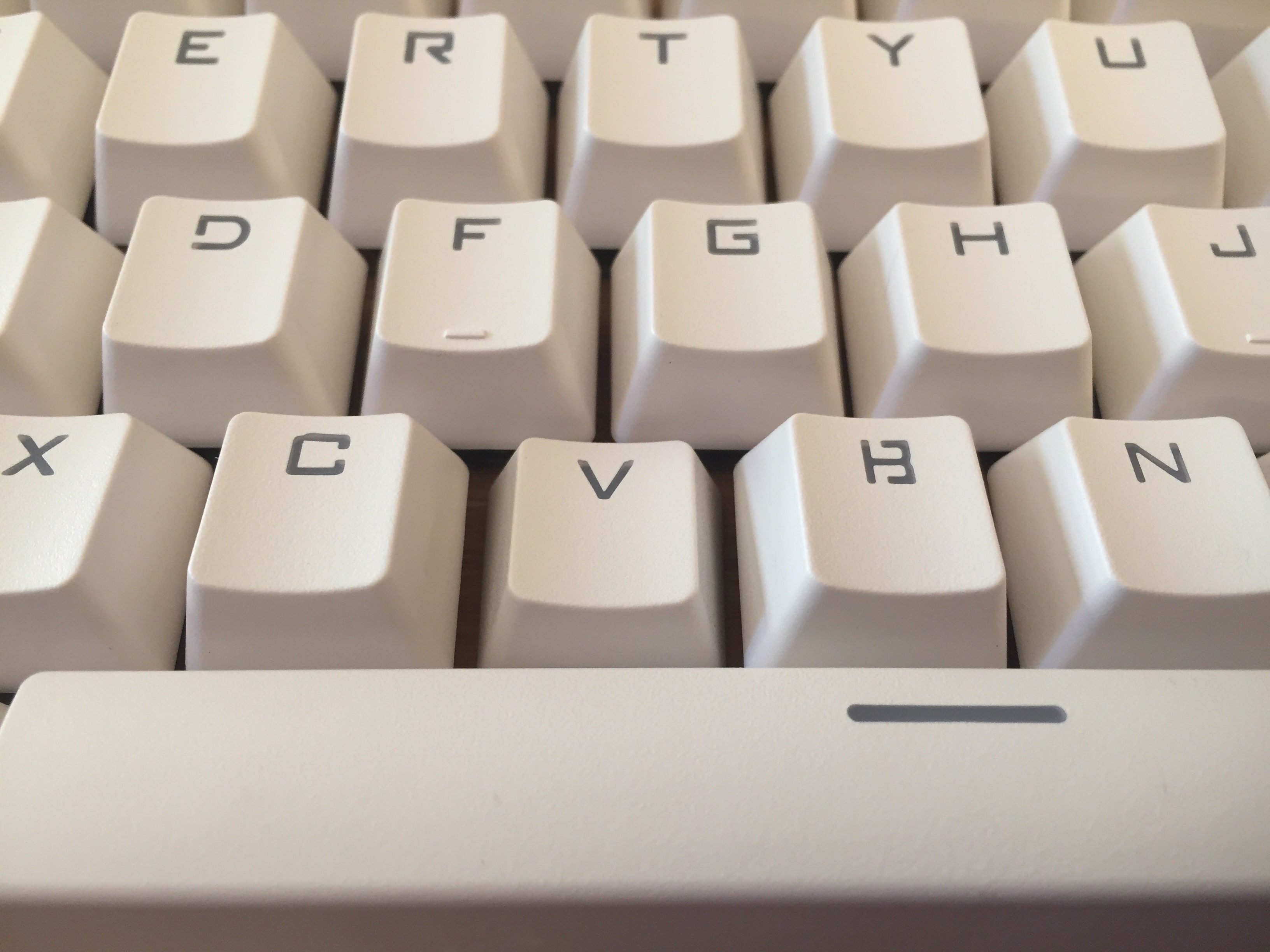

  • Caps - this one has already been beat to death, but I would second what everyone else has said. Cap quality itself is fine, but the legends are not ideal (my daughter couldn't find 'A' even though she is very aware what it looks like and where it is located on a keyboard).

For key caps: we'll offer a bare bones option since the current caps aren't popular. But, they are double shot, and PBT, and inexpensive.
For "sex bolts": future bamboo boards could, as an example, have the top two layers glued together with attachment bolts at the back. We'll probably head in this direction.
