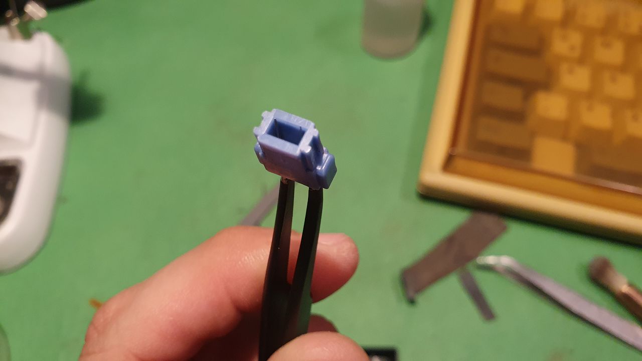

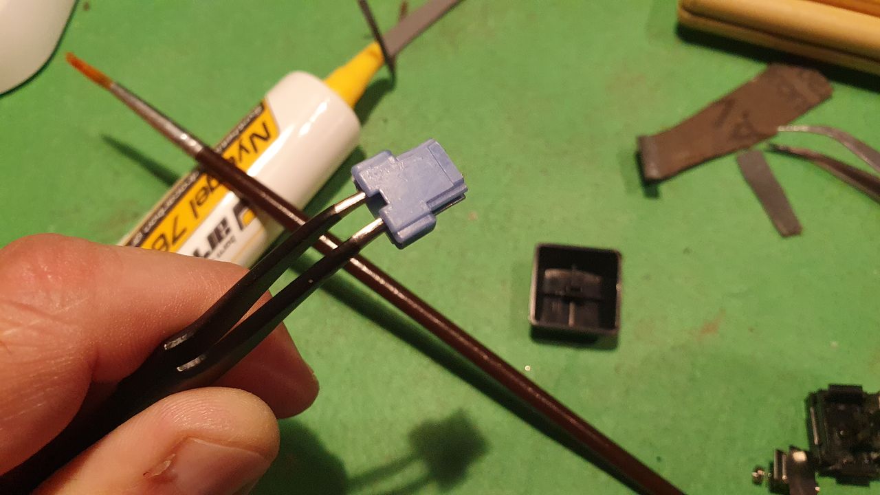

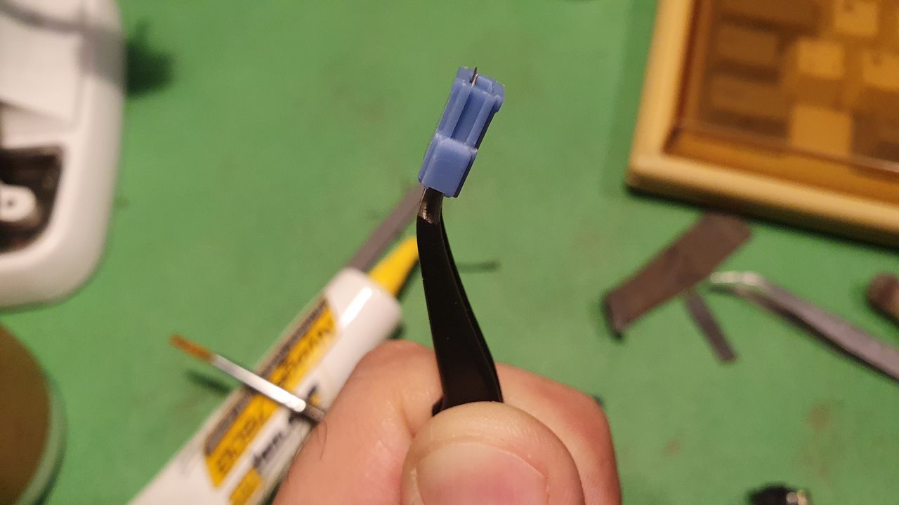

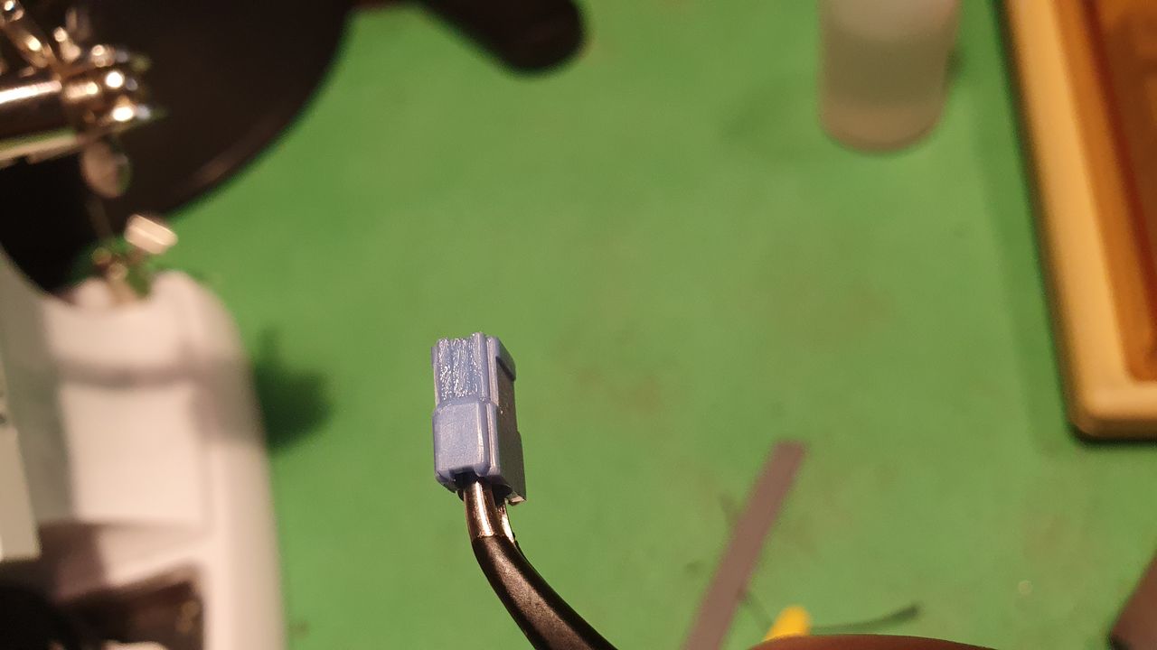

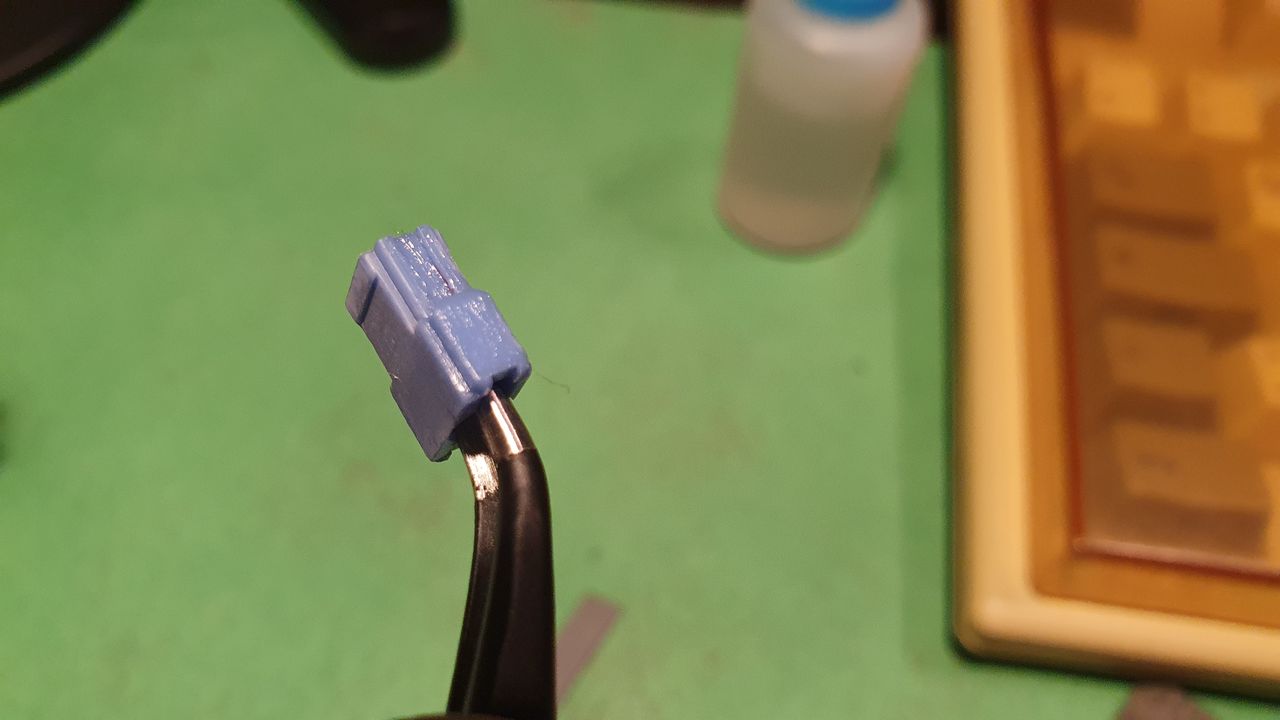

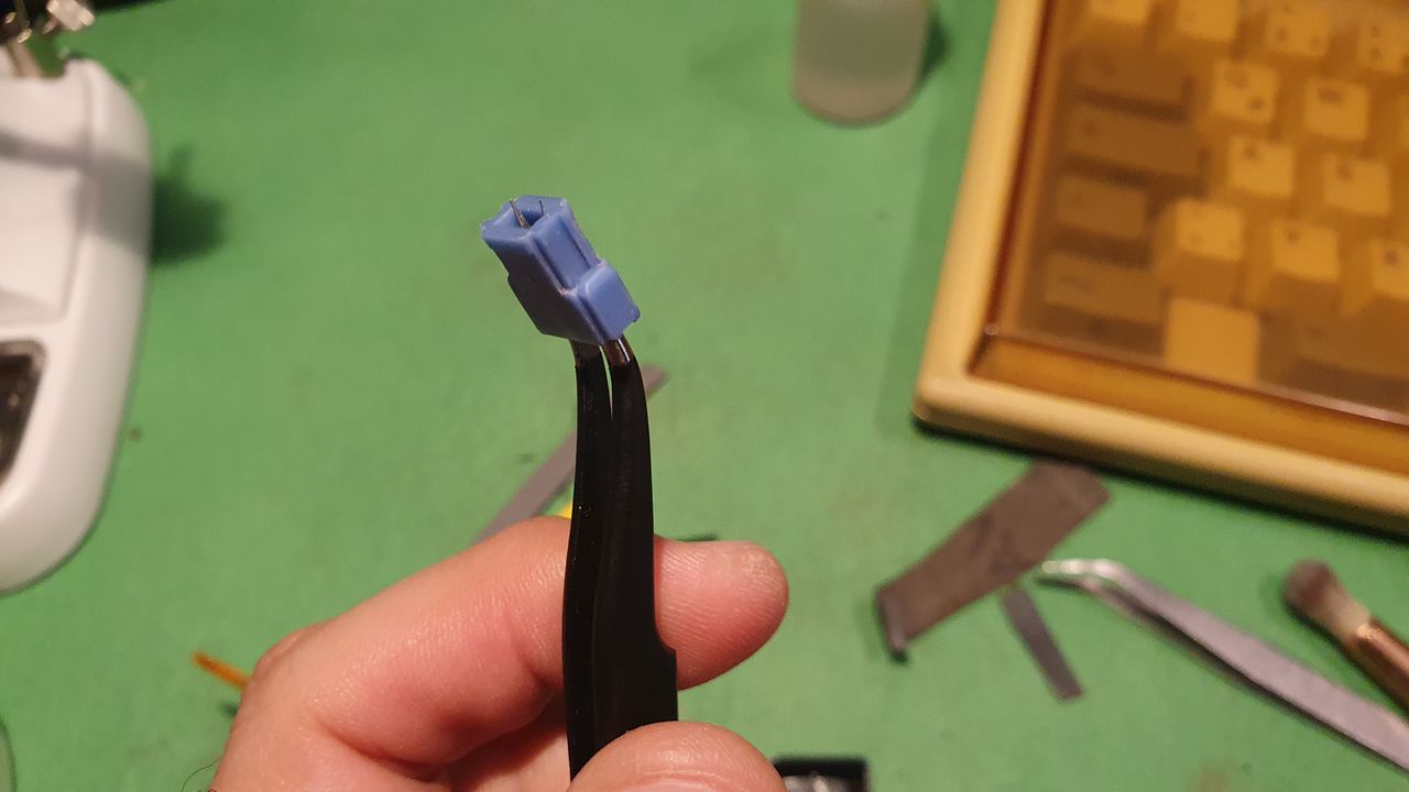

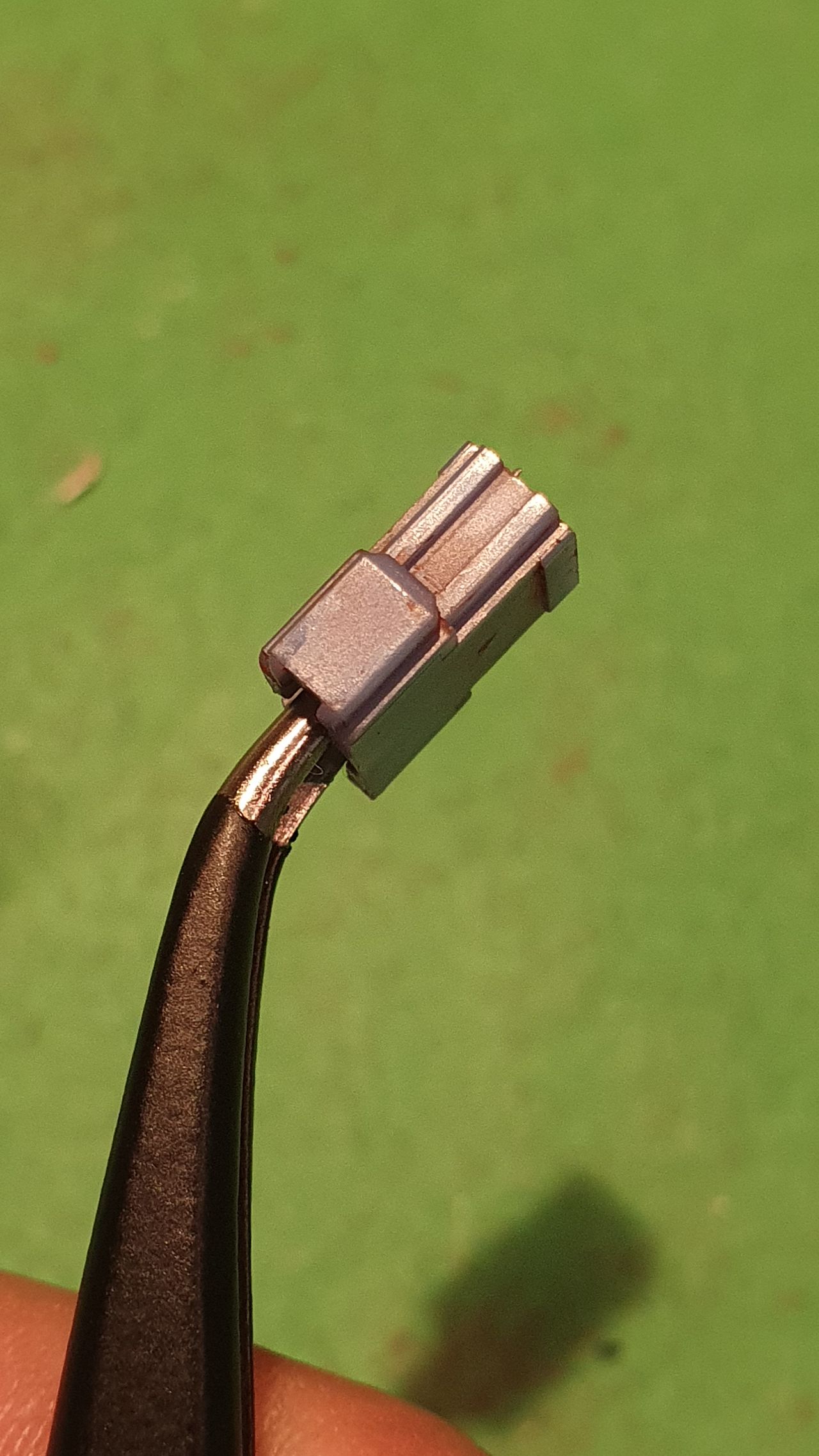

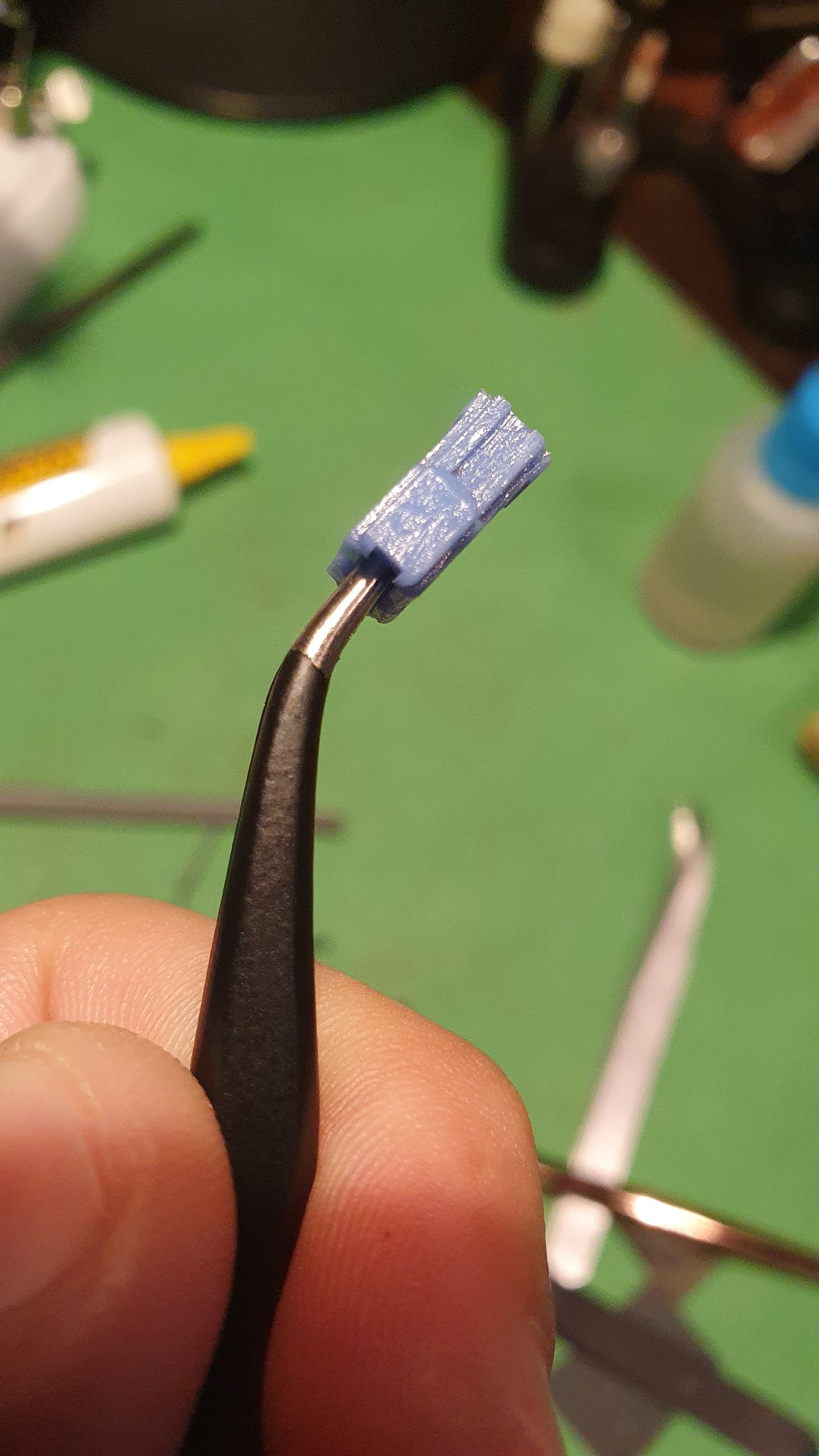

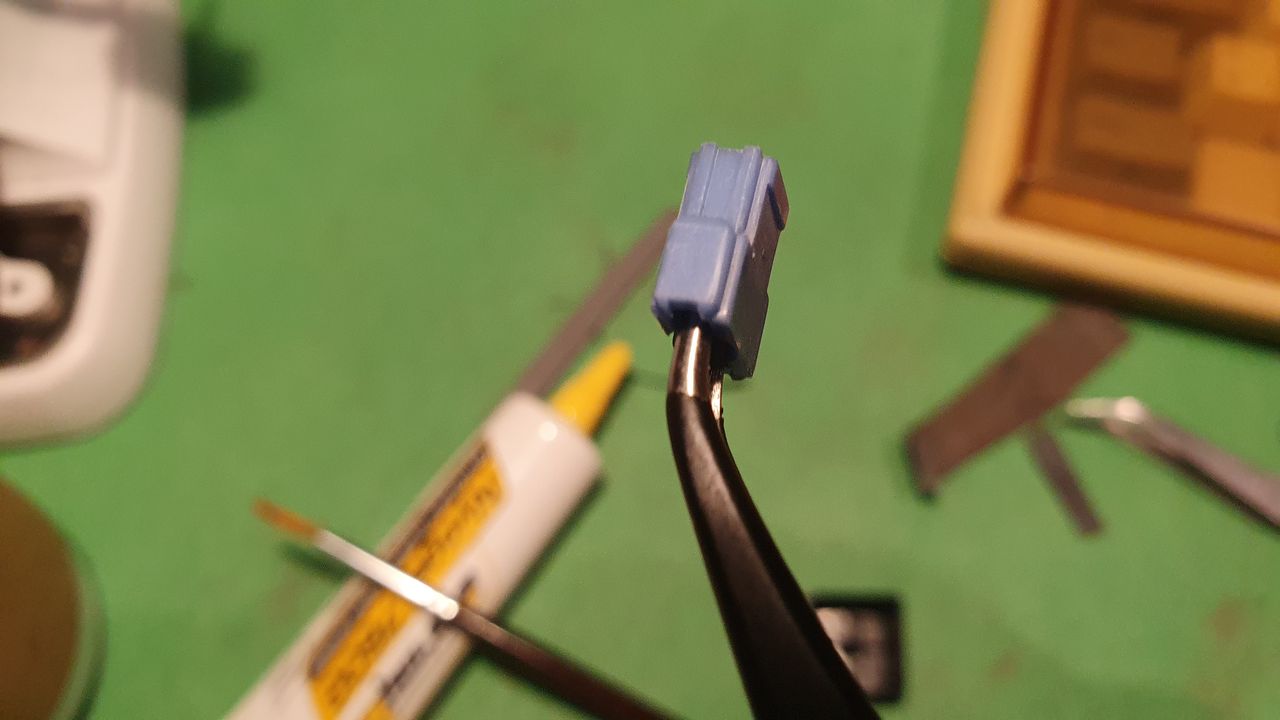

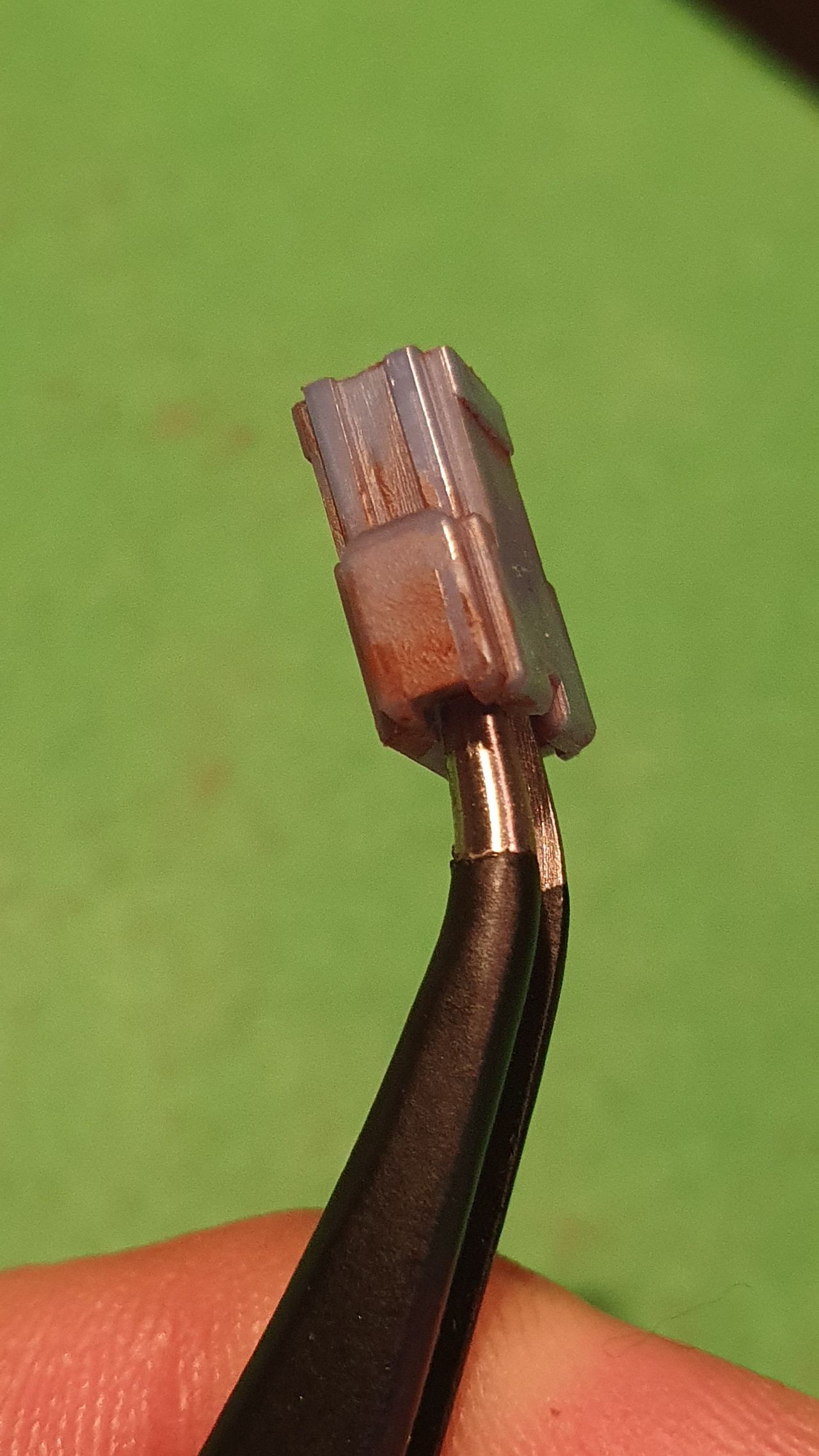

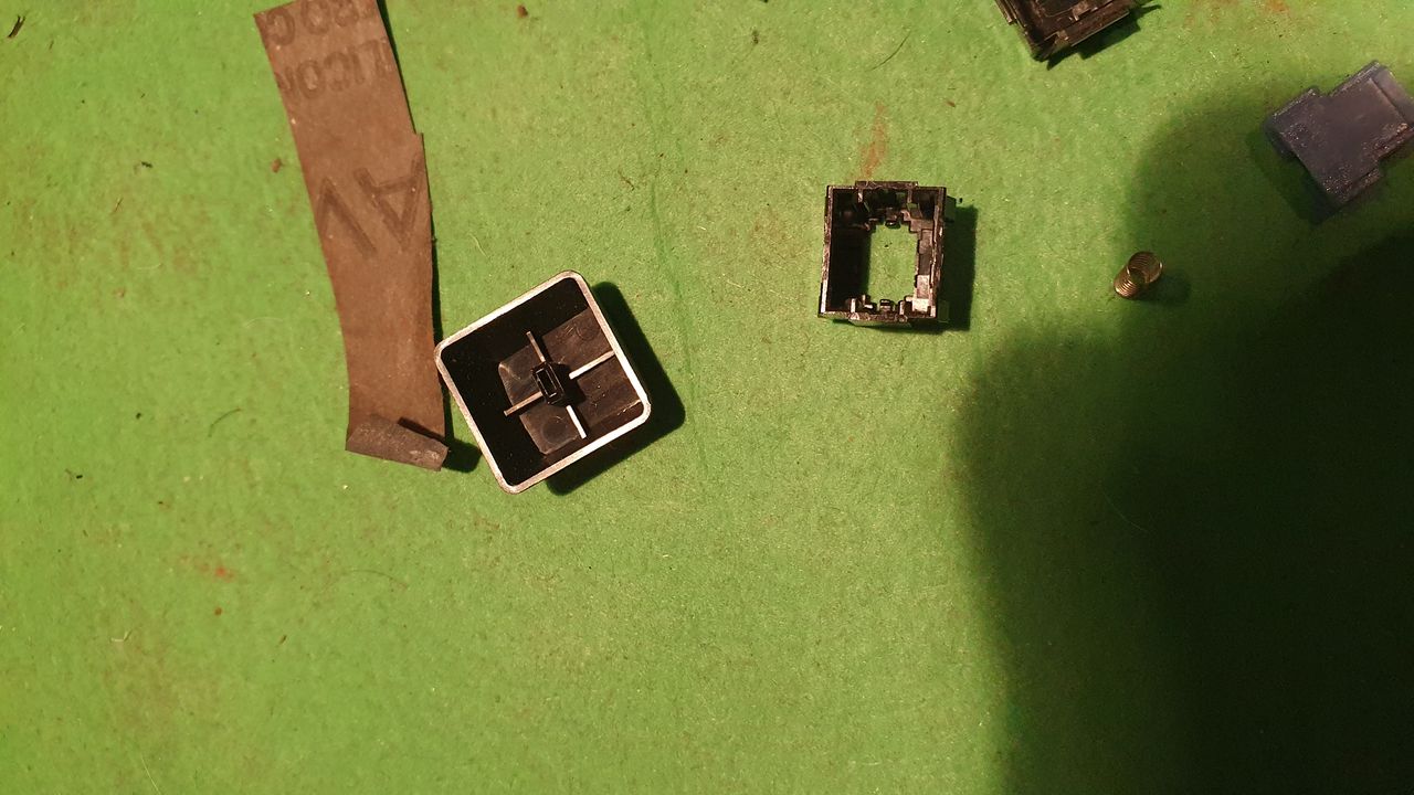

I received the day before yesterday and managed to do some tests. And, well... I am disappointed, very disappointed.
I used it on 3 different Blue SKCM switches, two of them came straight from a keyboard and they were "virgin" (not opened before) and the third is thoroughly cleaned and polished and slides and feels smooth.
The results are horrible, they make the keys bind as hell. I don't understand how is that even possible, but they actually do make them bind unbelievably and terribly bad. How on earth a lubricant can increase binding friction is beyond me but here it is. What did I do wrong here, guys? what is your opinion? Check out the pics and videos and let me know. I am frustrated now and this just only gets me more stubborn and want to find the right lube or technique to finally fix this.
NOTE: To clarify: I did left the first 2 switches to "cure" for about 30+ hours, maybe more, and they didn't get any better...

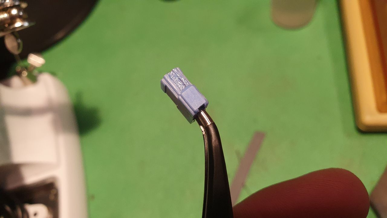

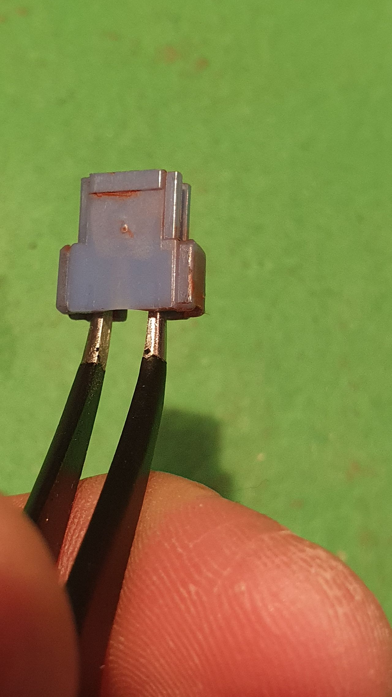

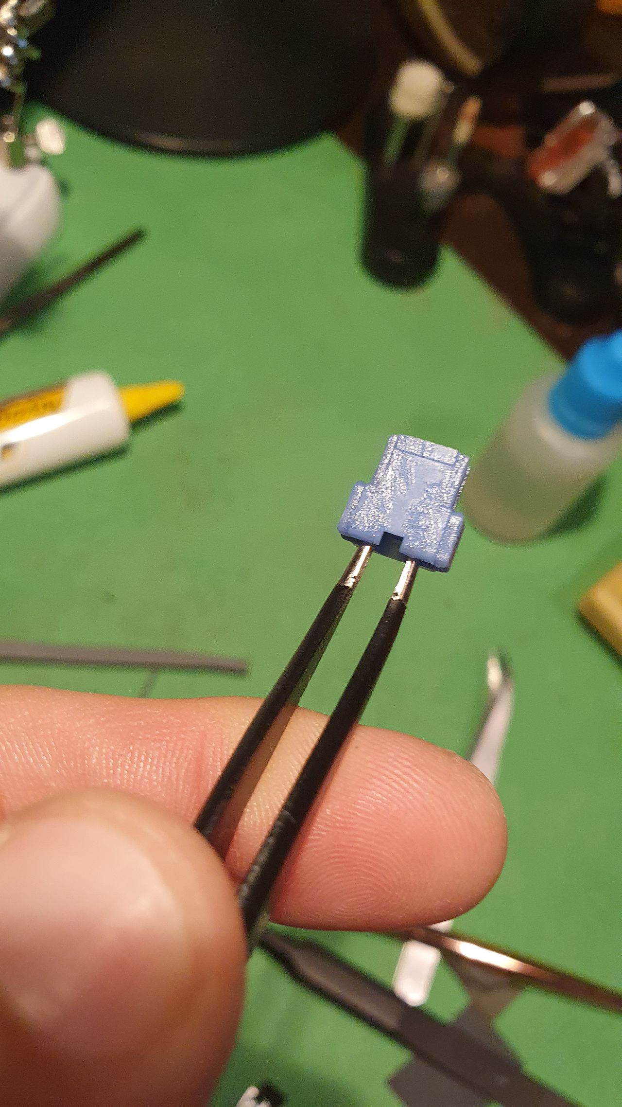

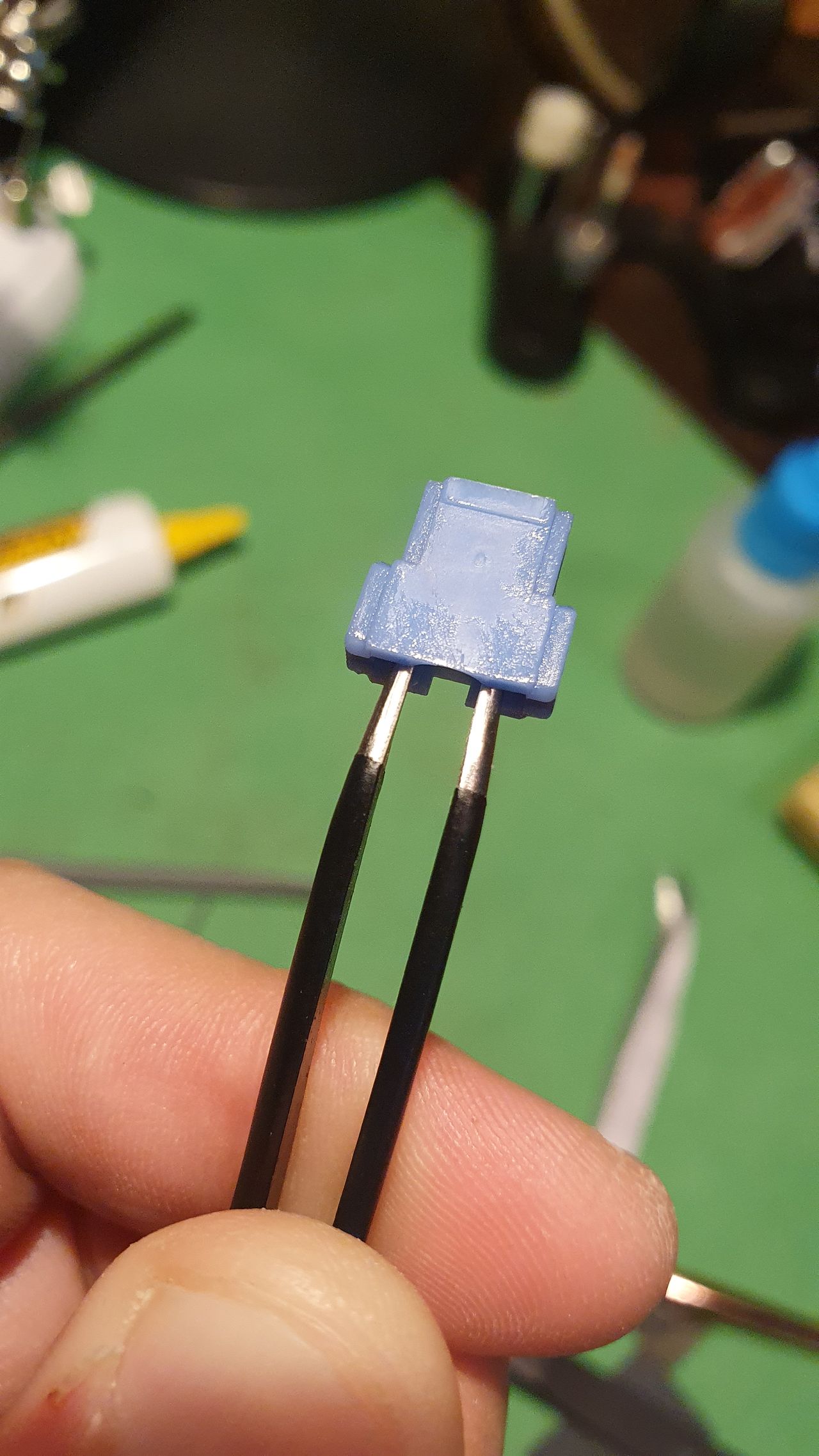

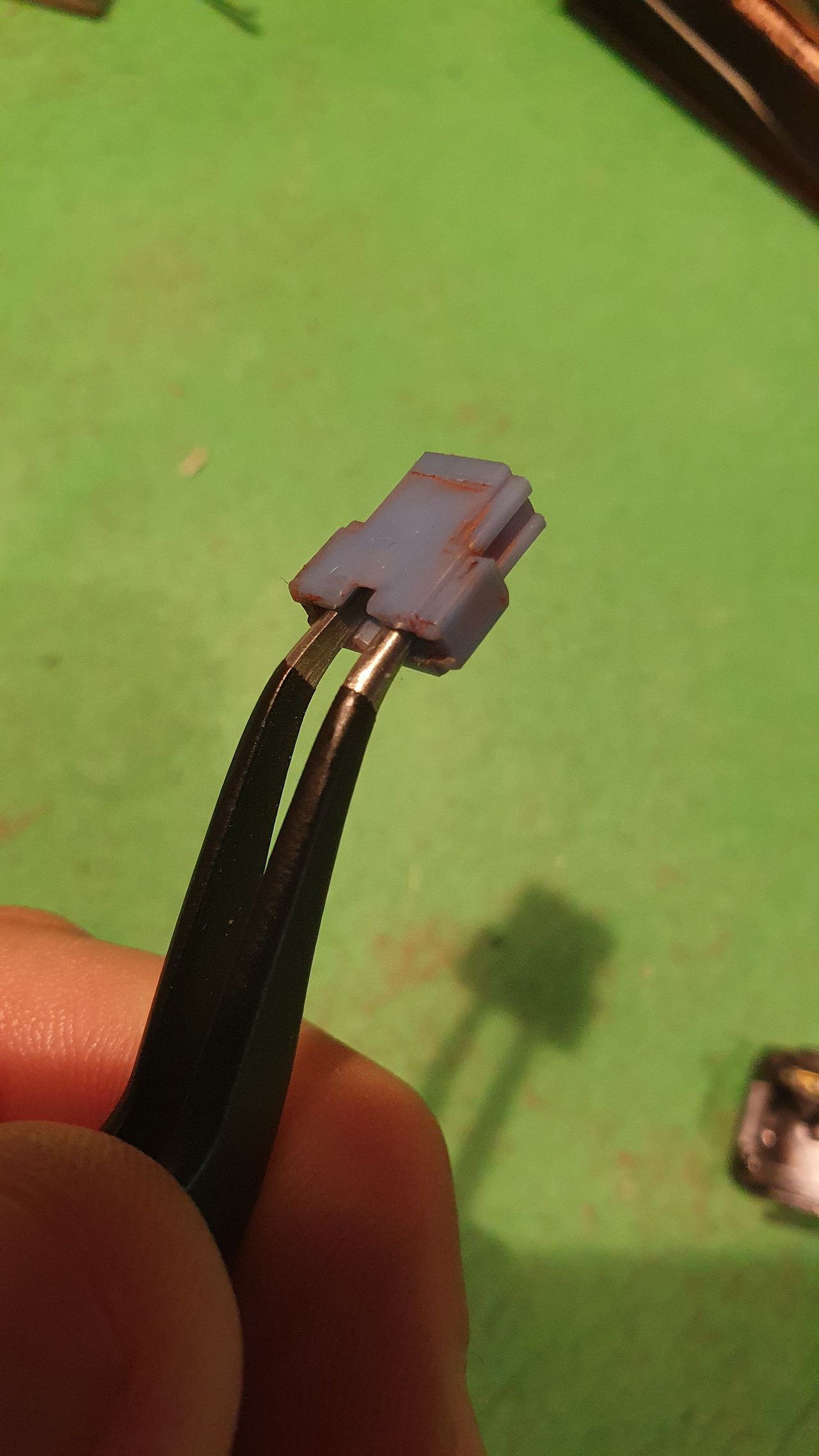

I took pictures and videos and tried to document this as much as possible in the little time I had. So here we go:

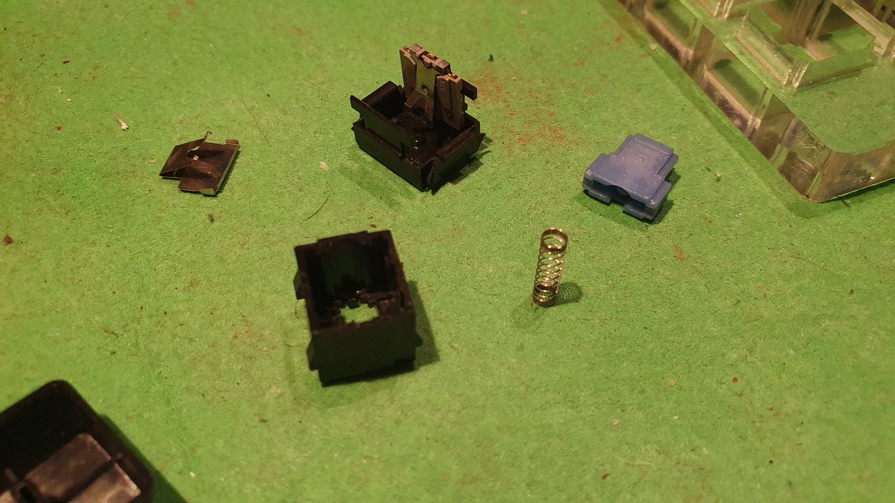

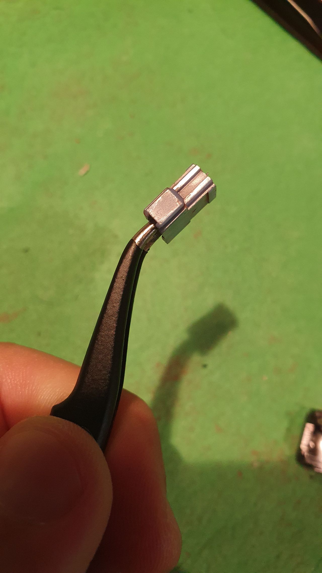

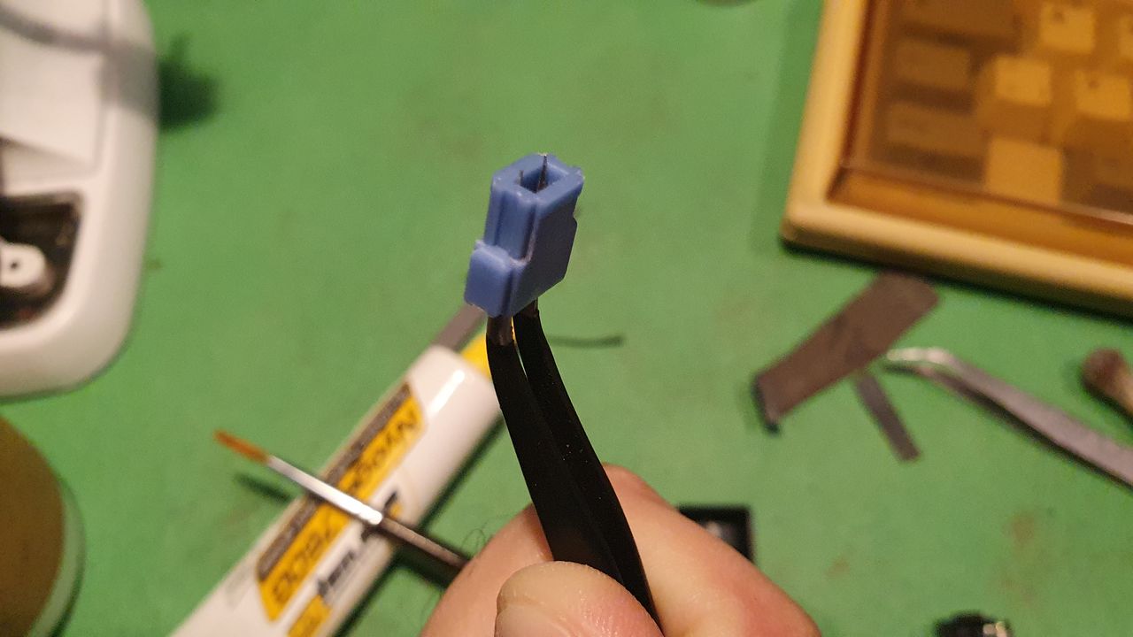

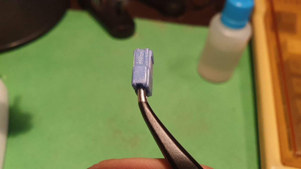

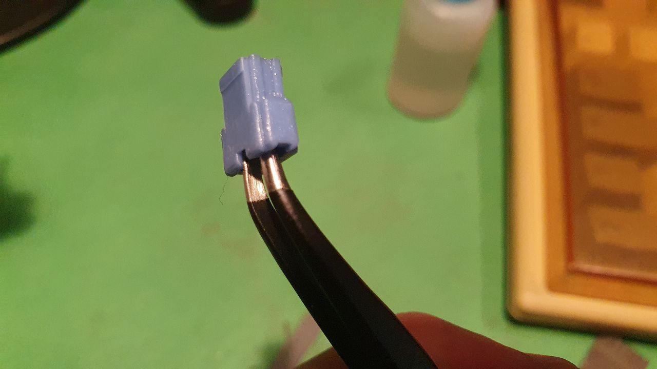

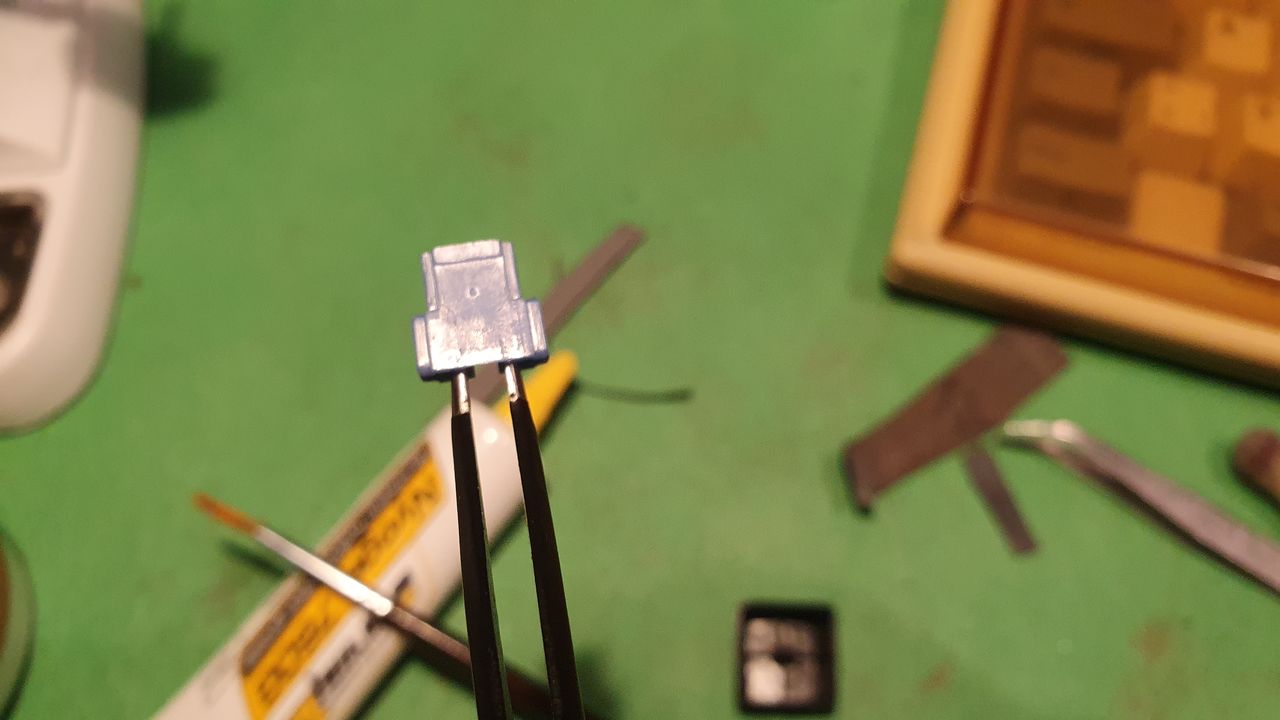

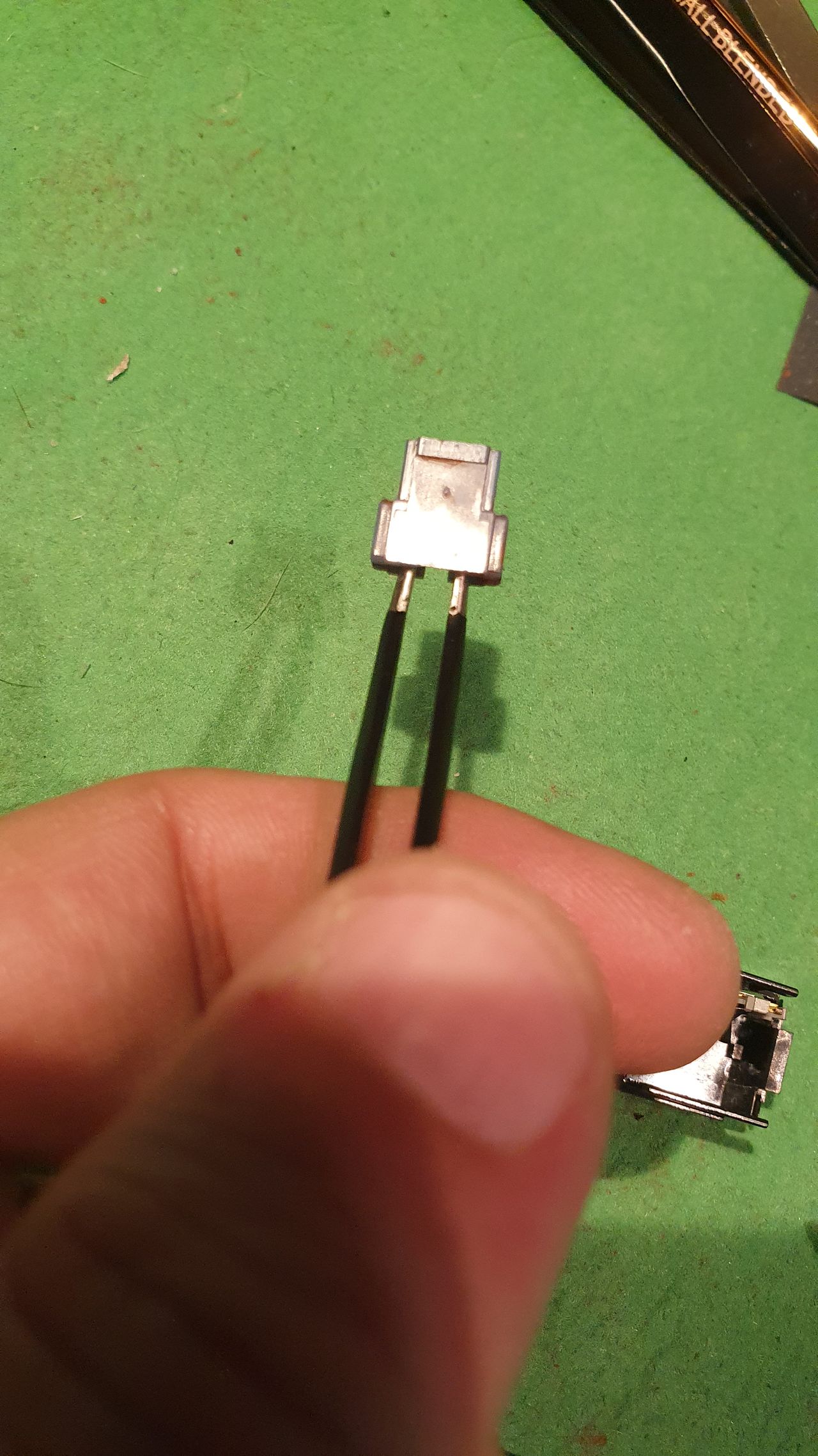

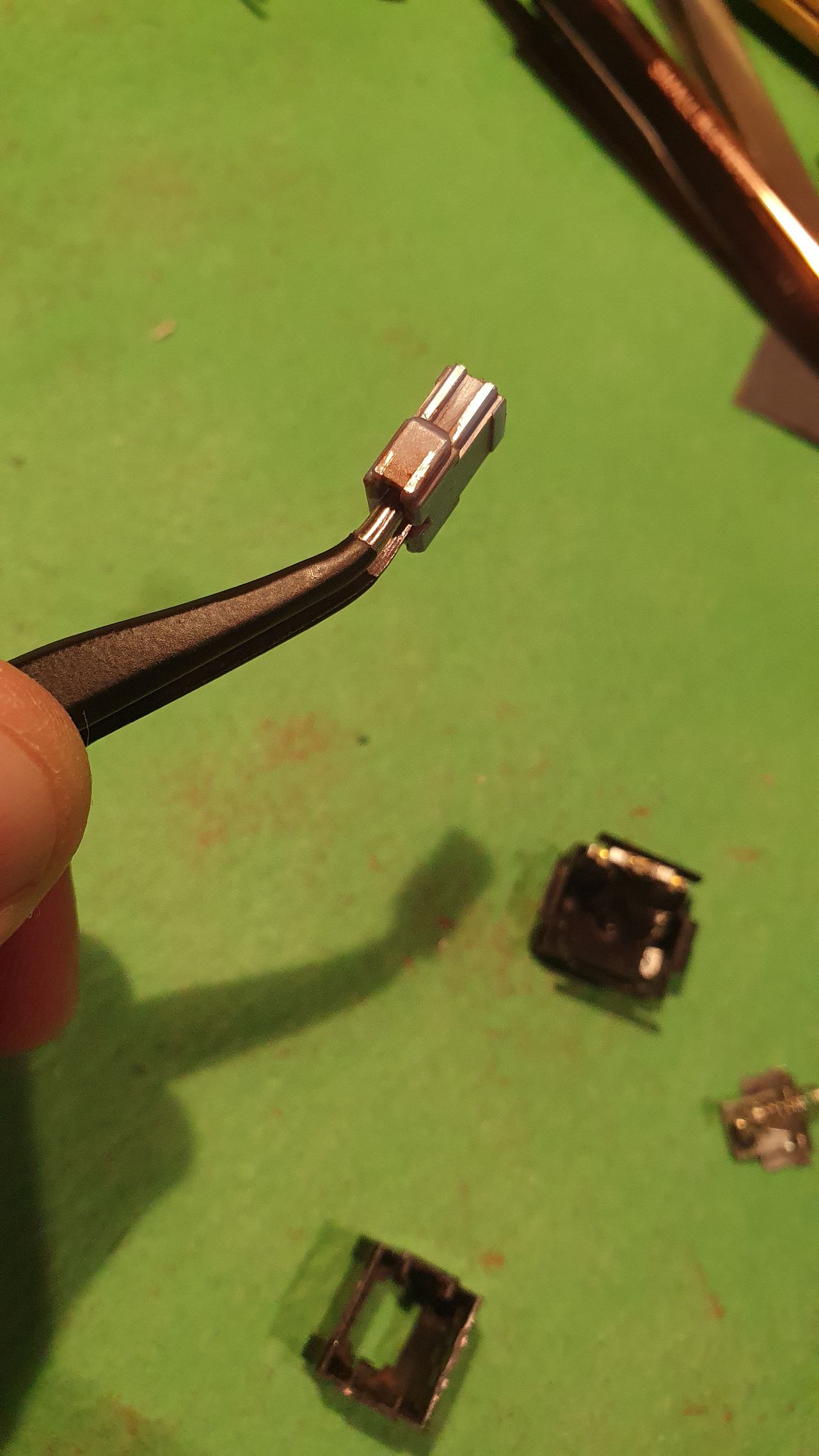

These are the parts of the switch that I tested:

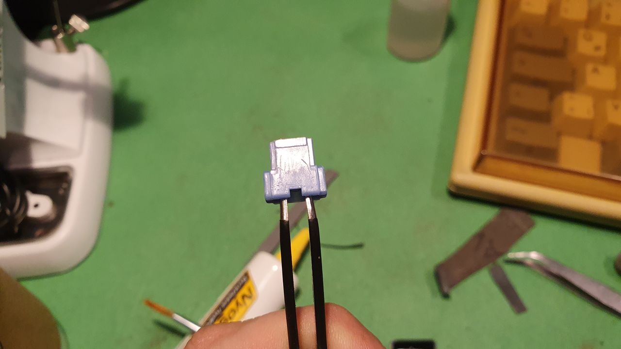

This is the slider before applying the lube:
This is a video showing how it was clicking before applying anything.
https://youtu.be/w2oLDZXicBc

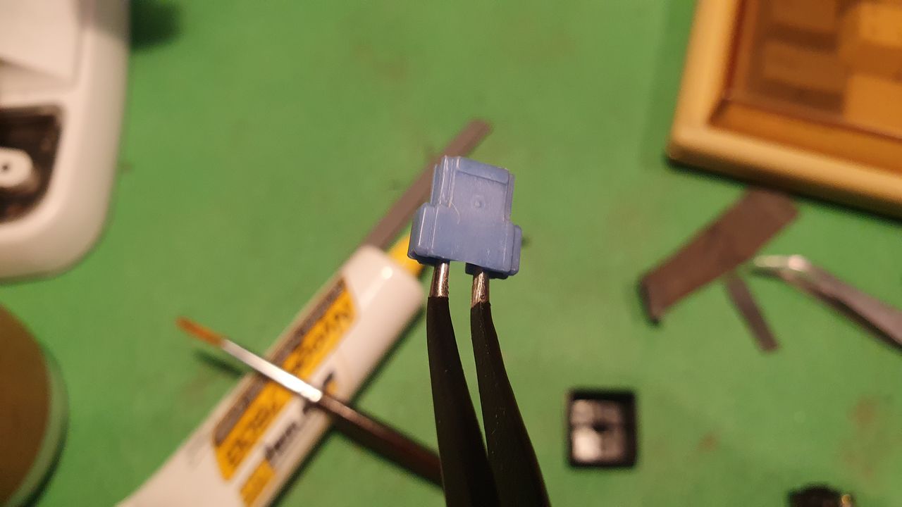

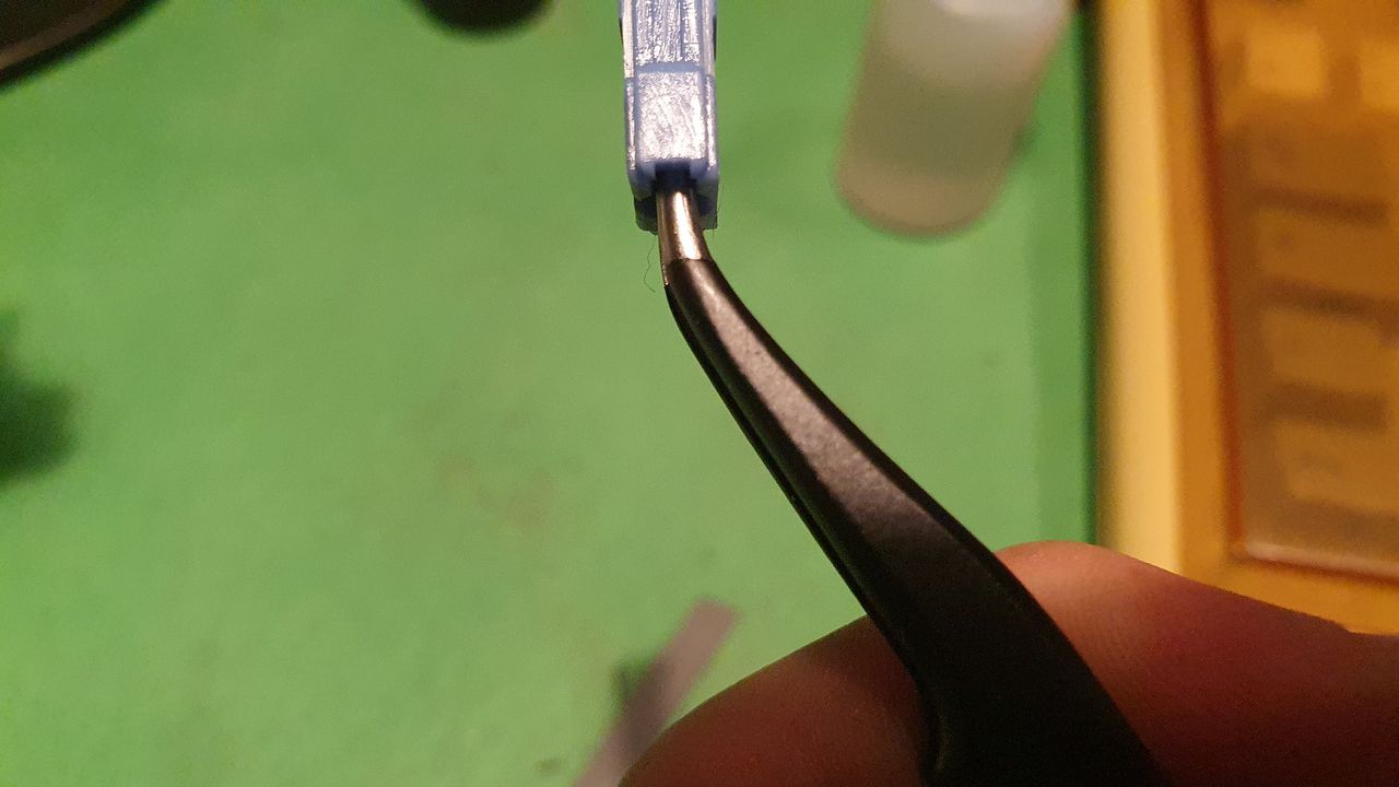

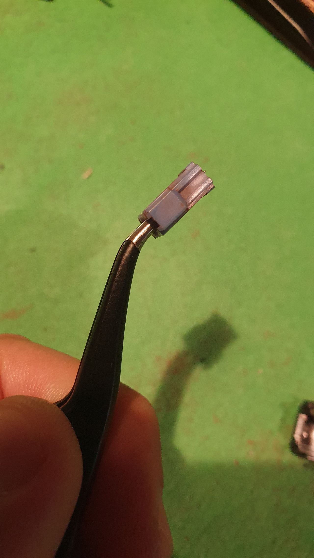

I applied some on the inside of the top sliders of the stem:
Here's the video
https://youtu.be/hz53kvYAXgc

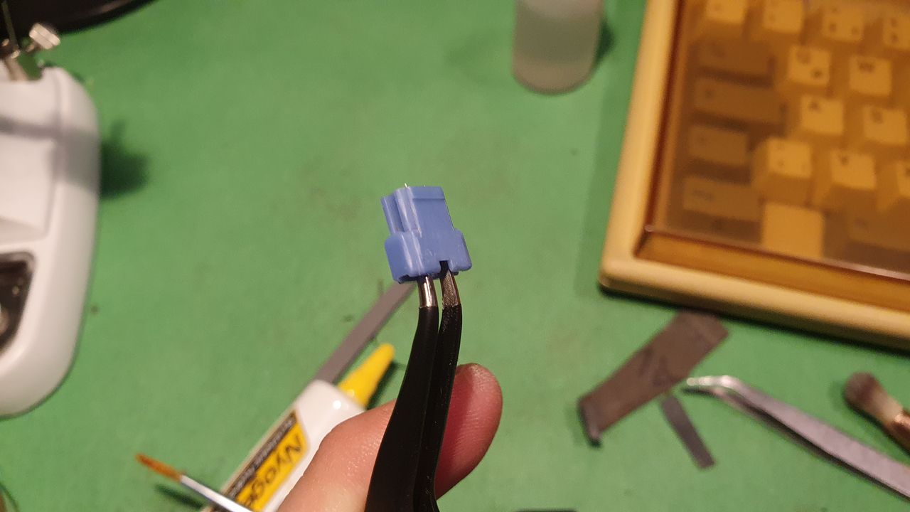

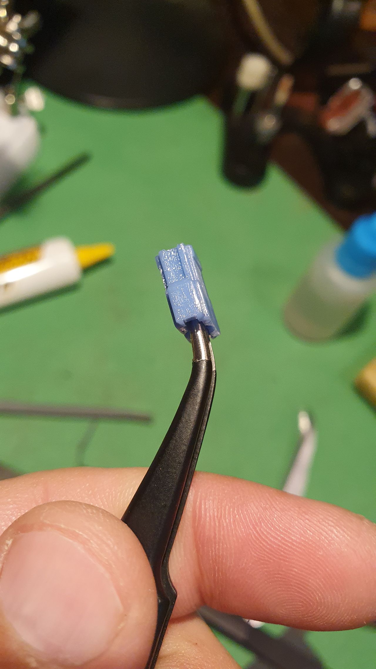

I then applied some to the bottom sliders as well:
Here's how it behaved, in this video I am using a kitchen scale. The scale has been 'reset' (tare) to show 0 grams when the switch tester is on it, therefore the grams that it displays are actually only the force that I exert on the key. (of course this is not accurate, but good enough for this)
https://youtu.be/MBV6QMCipGw

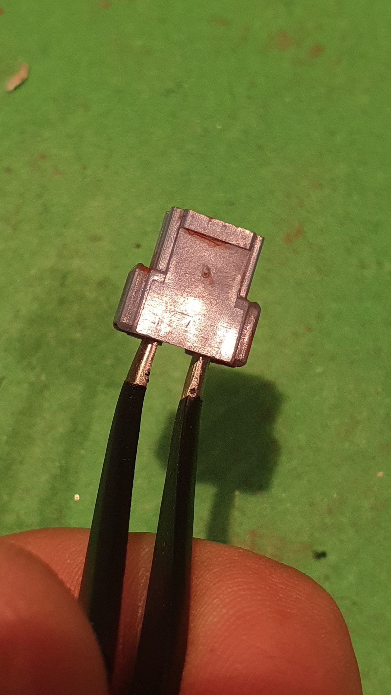

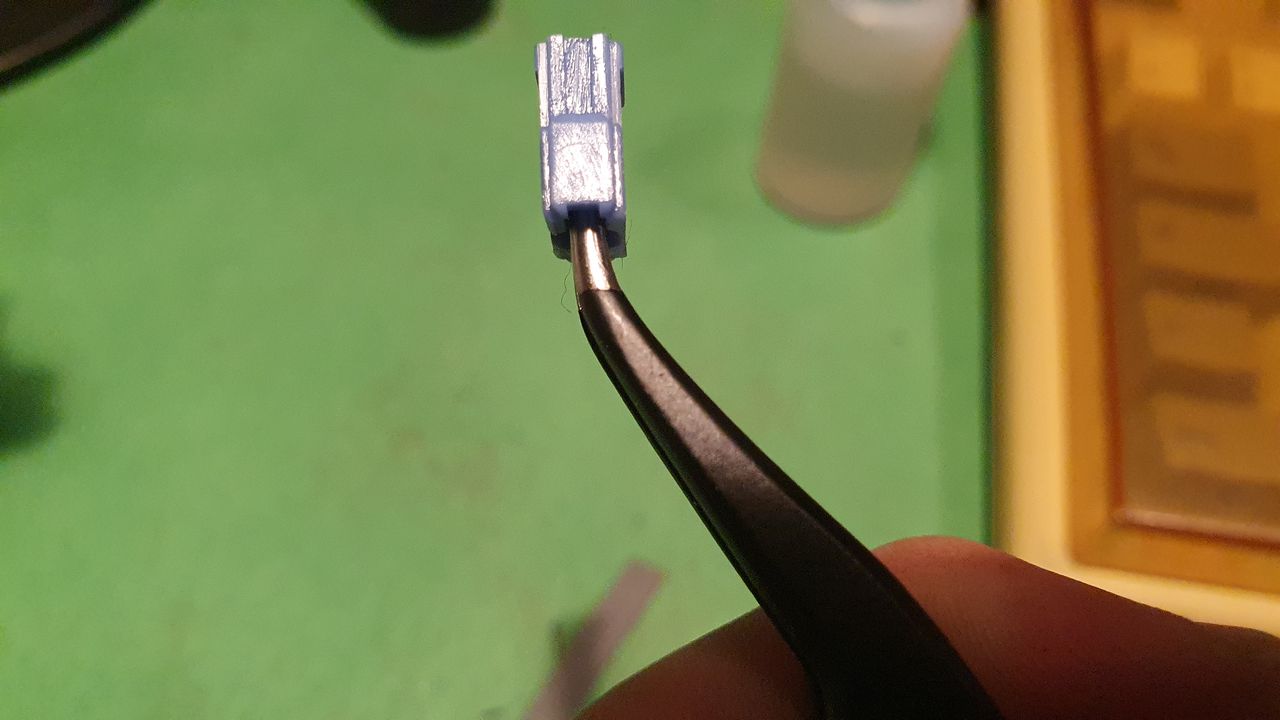

I then continued on and applied the lube on all points of the stem: the top sliders (on the outside) and the contact points with the click and contact leafs in front and back:
And here is the monstrous binding in video:
https://youtu.be/FsalZbu2MTk
For reference, here is a second switch that I have, and had thoroughly cleaned and polished:
And here is how it clicks:
https://youtu.be/Qq4e2b2T6Go

NeK wrote: 13 Nov 2020, 11:09 I received the day before yesterday and managed to do some tests. And, well... I am disappointed, very disappointed.
Here's the video

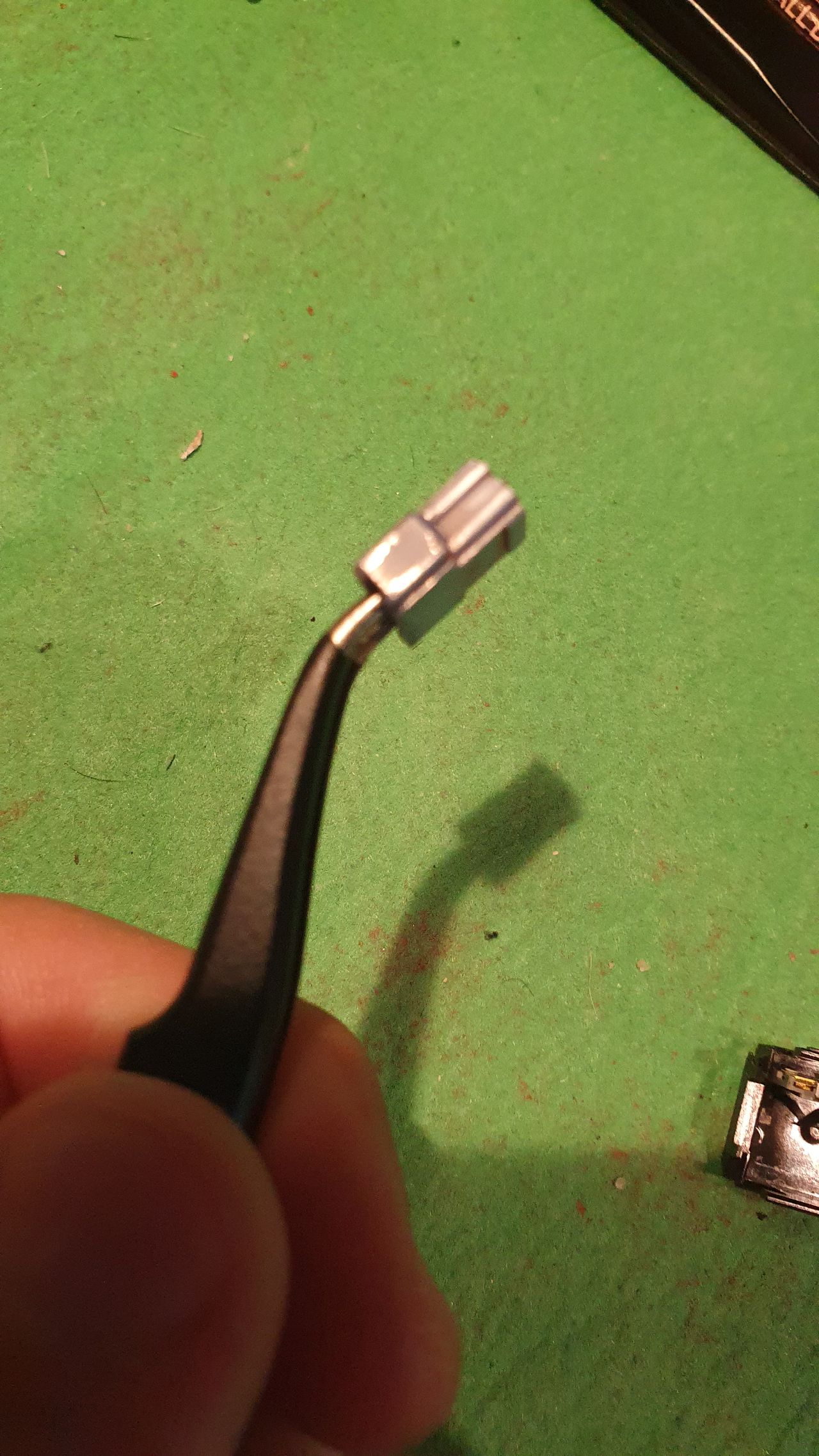

nyogel-760g-blue-skcm-test_applied-everywhere-2.jpgnyogel-760g-blue-skcm-test_applied-everywhere-3.jpgnyogel-760g-blue-skcm-test_applied-everywhere-4.jpg
Remember, the binding is consistent with the testing results we've had. My switches also bind, but they bind noticeably less than they did when I first lubed them. The curing process seems critical for this lube, I wouldn't make my final judgement until a week or so has passed.

headphone_jack wrote: 13 Nov 2020, 14:20 Remember, the binding is consistent with the testing results we've had. My switches also bind, but they bind noticeably less than they did when I first lubed them. The curing process seems critical for this lube, I wouldn't make my final judgement until a week or so has passed.
I hope you are right, but I doubt it. They are binding so strong, they are like climbing hooks on a rock! But anyway I have left the 2 lubed switches undisturbed in the keyboard and I'll check them out after about a week or so, just to give this a fair chance.

NeK wrote: 13 Nov 2020, 21:53

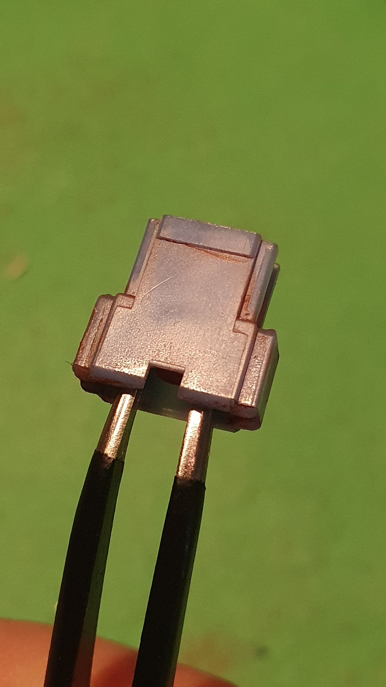

You also used like, WAY too much lube on the sliders looking at your pictures. From what I understand, nyogel works best when applied in a thin layer over the rails of the slider. Yours is absolutely coated in the stuff. I would suggest scraping a lot of it off and then seeing if the binding is at least partially fixed.
NeK
15 Nov 2020, 12:05
headphone_jack wrote: 15 Nov 2020, 05:41
OK, I'll try it and see.
