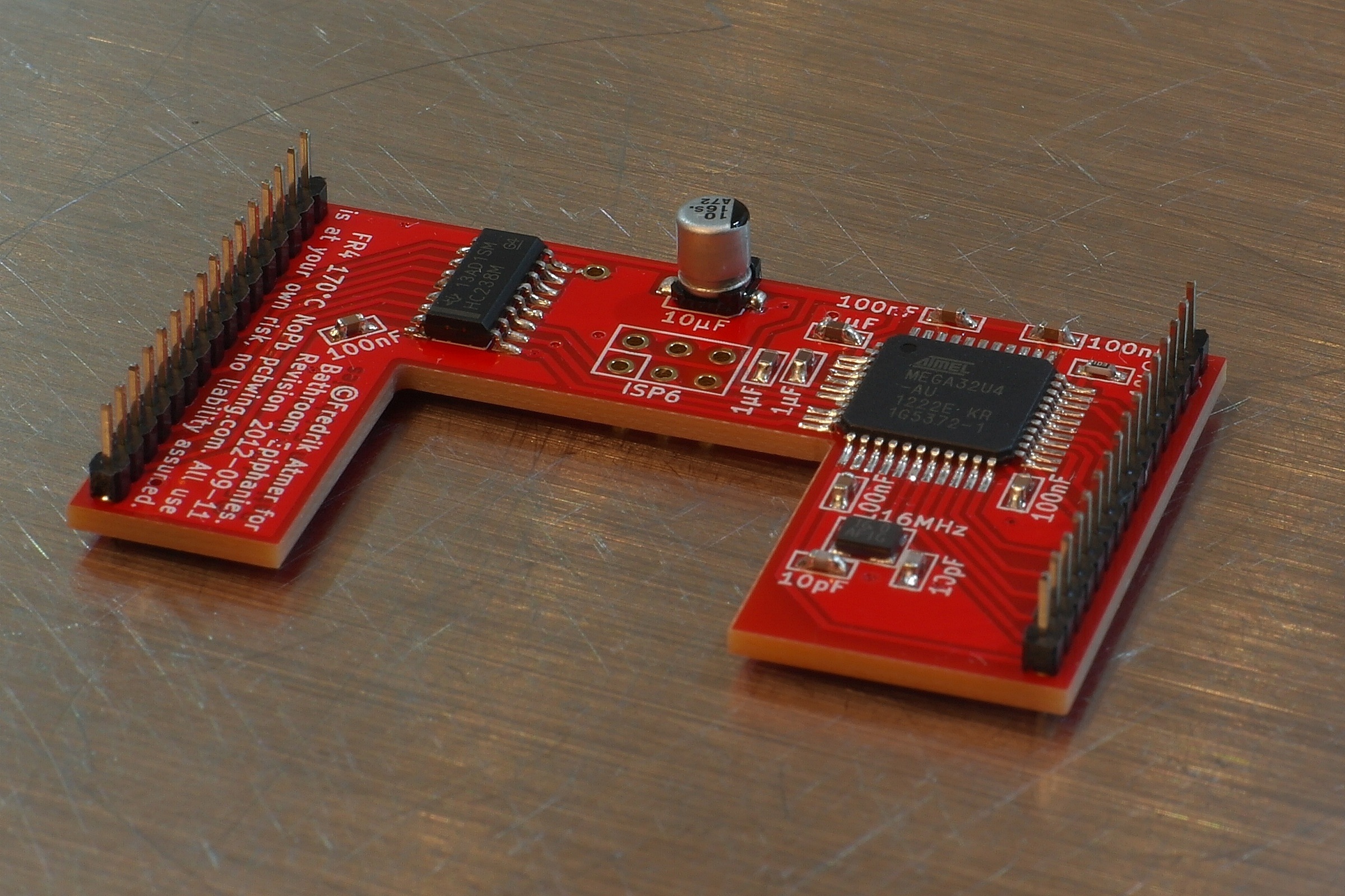

Final round of Deskthority Awards voting has begun. If you like your Filco tenkeyless custom controller from bpiphany, please go to the links below to vote for bpiphany and the controller mod for these Deskthority Awards:
Vote Filco Tenkeyless Custom ATmega32u4 controller for Best Input Device Mod Award
Vote bpiphany for The Best Deskthority Forum Contributor Award
bp controller.JPG (983.31 KiB) Viewed 3537 times
