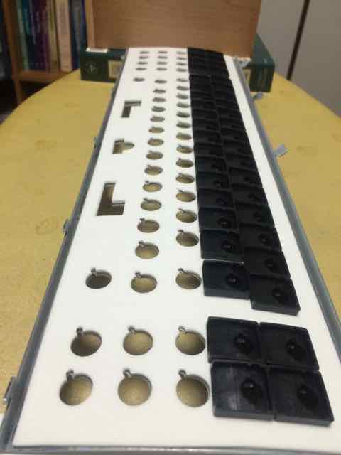

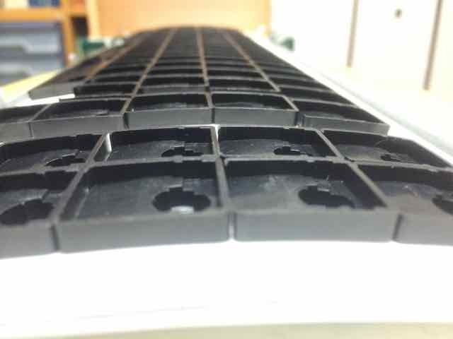

Finished painting the barrel plate on an XT. Installed a new foam layer consisting of 1/8"-thick white silicone foam from McMaster-Carr. I had considerable difficulty getting the plates to slide back together, despite using spring clamps to hold the plates together and a bar clamp (with a straight holder rather than a swivel holder). Finally got the plates to align sufficiently so that I could fold the tab back over to lock everything in place.
It could be that the 1/8" foam is somewhat too thick or that the surfaces provide too much friction to allow the plates to slide readily. If 1/8" is too thick, then the 3/32" or 2 mm thickness could be used. Regarding sliding friction, the surface of the art foam seems to have less friction than the surface of the silicone foam. The art foam is also much cheaper than the silicone foam or sponge.
Because I did not use the art foam that I had punched as the foam layer, I decided to put art foam between the outside of the back plate and the case to provide some additional sound deadening.
I used the fishing line trick to keep the spacebar hammer in place during the realignment of the plates. However, I used black multifilament line instead of clear monofilament line. The black line give me some trouble pulling it out after assembly; I think the monofilament clear fishing line would have less friction and would be easier to remove.
Despite these problems, the refurbished XT works just fine -- I am typing on it now, using a Hagstrom converter box to connect the keyboard to my Mac. I plan to install a Teensy and Soarer's converter later.
This is my second XT. I did not do any restoration on the first one other than to do a thorough cleaning of the keycaps, case, and barrel plate (without separating the plates). The first XT seems to have a somewhat higher-pitched click with each keystroke, but it does not have a "ping". On the other hand, the second XT, which I have refurbished, has a pinging sound in many of the keys. I am considering doing a "floss mod" to see if this alleviates the pinging.
However, the spacebar on the second XT seems smoother and quieter than the one on the first XT; this might be because I lubed the stabilizer spring with Mech Lube 2 at all its contact points, but it might also be a function of the different composition of materials within the case of each keyboard.

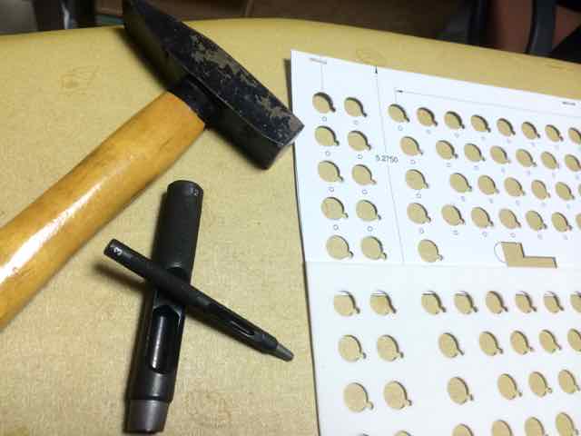

Thanks to Wcass who was kind enough to share the Keyboard template for the IBM Model F AT keyboard I could finally restore mine after few failed attempts of replicating the template in my own by spraying black paint over the old putrid original keyboard foam sheet.
The Spay over foam try never worked, the wholes where never perfectly aligned but Wcass template is accurate to the mm... amazing!.
I used 2mm art foam from a stationary shop in Tokyo city center. and it seem to be the perfect size. I tried to fit in a 3mm on but was too thick. Nothing in between, I wasn't able to find a 2.3mm~2.4mm sizes he in Tokyo, the one thicknesses I came across were 2mm, 3mm, and 5mm
For the holes I used 12mm and 3mm hole punchers, the 12mm for the main barrel hole and the 3mm for the fitting pins. These holes needed to be very accurate as you know otherwise the foam will fold or overstretch when fitting in the barrels. Overall it took me 4 hours to punch the 168 holes (84x12mm + 84x3mm), including preparation and cutting the spacebar shape. That is too much time for such a simple operation but I took my time to try match the hole cuts to the template accurate to +/- 0.5~1mm,....and it really paid off. Some pictures below:

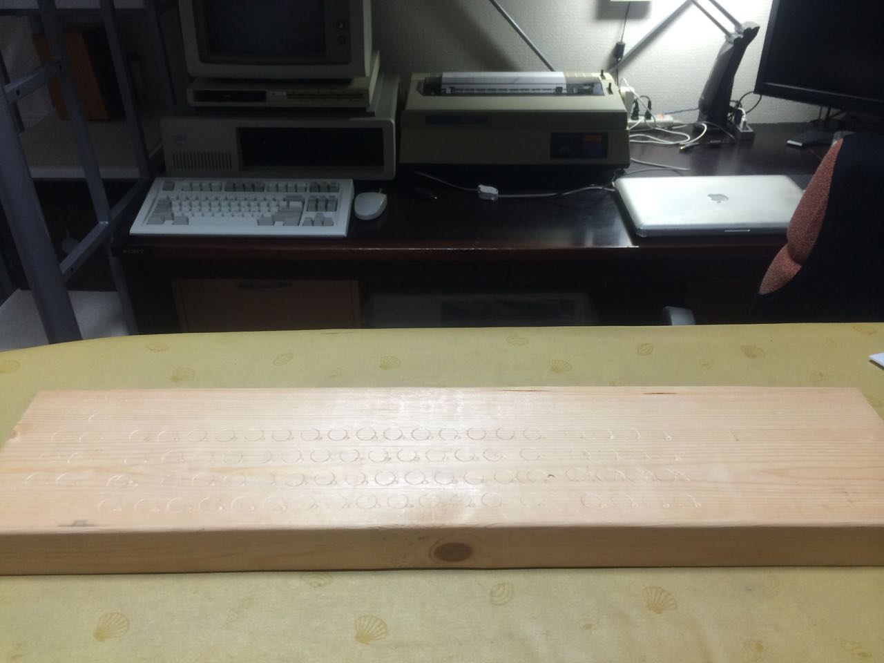

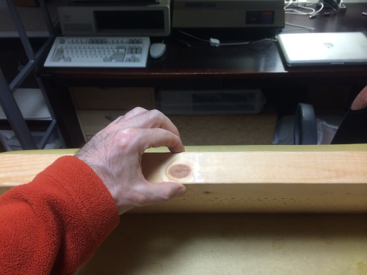

The Base board
The last but not least, A thick base board. I tried using spare shelf trays that were 1cm thick and half the length of the print. It wobbled and vibrated too much with every hit. A big difference when I moved to use a thicker board.
Thick base board
Thick base board
Thick base board.jpg (90.62 KiB) Viewed 16019 times
Base board Thickness - just to get an idea
Base board Thickness.jpg (94.88 KiB) Viewed 16019 times
Thick base board - The Giant Octopus attack
Thick base board - The giant Octopus attack.jpg (137.11 KiB) Viewed 16019 times
Maybe I punched them in too hard :)

Thanks for sharing all those details. I used a thick piece of soft lumber too, but I used a smaller piece and had to move it around frequently. I like the idea of using a larger board. I have a couple of foam pieces I need to punch out where I've already painted the top plate, so I'll be using the template method. The template is larger than A3; how did you line up the two halves?

I actually discarded the A3 print because it was a 0.1mm regular paper. However the template fits for the most part on an A3 print no problem. If you print it centered all barrel holes will show up. You will only lose about 1~2cms on the Right and Left margins (see image below) but since no holes are printed in that area you can simply add these to the foam cut.
A3 print(11.69' x 16.53')
A3 print
A3 print
I used a Tabloid size print (11' x 17') which is perfect for printing the keyboard template real size in one single sheet, including the cutting margins.
Tabloid print (11' x 17')
Tabloid
Tabloid
27.94cm x 43.18cm.jpg (397.85 KiB) Viewed 15968 times
A3 and Tabloid print side by side
Tabloid LEFT, A3 RIGHT
side by side.jpg (737.99 KiB) Viewed 15968 times

Those O-rings are an interesting idea. I was contemplating using a split lock washer myself - but figured their use would probably crack the barrels.
When I rebuilt my 4704 107 recently, I tried 2mm craft foam across the entire plate - found that it wasn't thick enough for the home row. Tried 3mm craft foam across the entire plate - found it was too thick for the top and bottom rows. I then cut the home row strip out of both pieces, and tried the 2mm foam on the top/bottom with the 3mm foam on the home row. This ended up sort of cantilevering one edge of the barrels on the home row.
I went back to the store and picked up one foot of automotive headliner foam, which came on a roll 54" wide - and is about 1/4" or 3/16" thick and very soft. It was a pain to cut holes in compared to the craft foam (don't have a punch) - but it applied an even pressure on all of the barrels across the plate. I also found I much preferred the key feel with this softer foam compared to the much denser craft foam.
