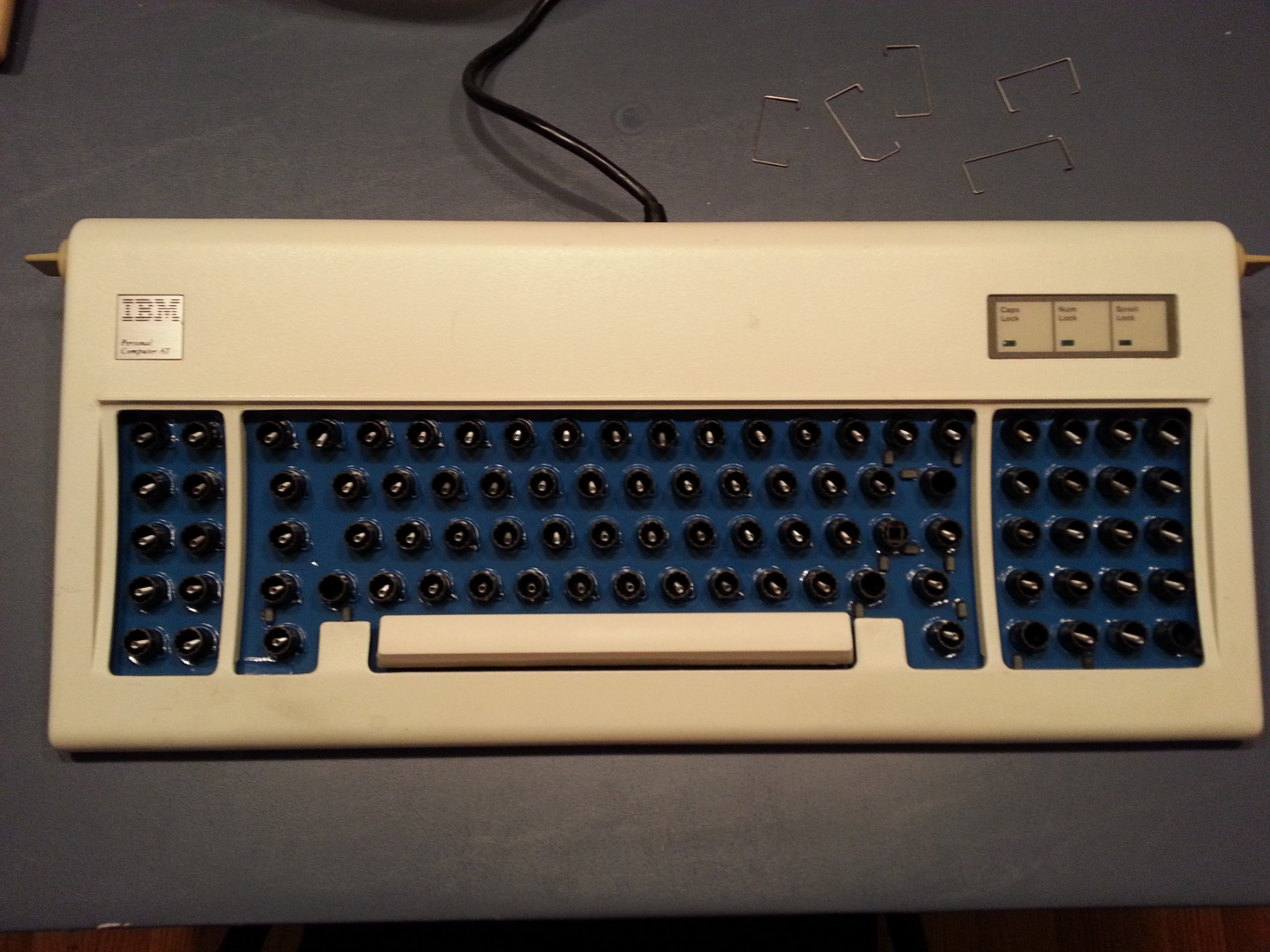

So, what I ended up doing at least for now, is using 1/32" ~50 durometer silicone. I cut the overall sheet as per above, and punched the holes, etc. Then, after closing and opening a few times, I determined that row 4 needs one more layer, and row 2 and 3 two more layers. The best way of doing that is to cut and punch an additional three row wide mat, then a two row one, but I'm too lazy at this point and simply cut thin strips (the width of the non-stem barrel portion), and overlaid them on top of each other and the overall mat. Worked well enough, and all barrels have none or negligible play once closed.
On closing and opening: it will definitely be harder, but I've learned another neat trick. First I clamped it, then wedged something with leverage, like a handle of a wrench, into the gap where the bottom plate goes from concave to straight (where the bolt holes are for case mounting). Then simply gently push towards the top plate to get it sliding open or closed, depending on which end you're using, alternating a little lengthwise. Pad against the top plate as needed if you've painted it. Be careful not to push /down/ into the top plate, but against the side only.
Of course the best way to close still is to use something like a pipe clamp or two, but opening is great using the method above.

I got my die set from HF. They go on sale from time-to-time.
http://www.harborfreight.com/9-piece-ho ... -3838.html
Some folks punch a single big hole that goes around the notch. I prefer to make two punches. Ether way will work. My template for the Kishsaver is below. TBH, i have not used this specific template myself (my foam was in like-new condition) so double check the positions. I have templates for the AT and 122 also; PM me if you need one.

Now that's a how to! Thanks for the details, Wcass. I'll check this out when I work on an F that needs new foam. To my relief, my Kishsaver's is actually in fine shape, the only crumbling was on the exposed outside edges.

Wcass, have you experimented with different types of foam you can order from McMaster and found out the one you linked is the best for this application? I noticed that they have lots of options.

I have very little experience actually. I knew that i needed something thick enough to fill the wider spots but it needs to compress down for the tight spots. I filtered for "extra soft" or "soft" and that left me with just two options (excluding buying full rolls) - the stuff i linked to and silicone foam. The silicone was 10x as expensive, so I just went with neoprene.prdlm2009 wrote:Wcass, have you experimented with different types of foam you can order from McMaster and found out the one you linked is the best for this application? I noticed that they have lots of options.
