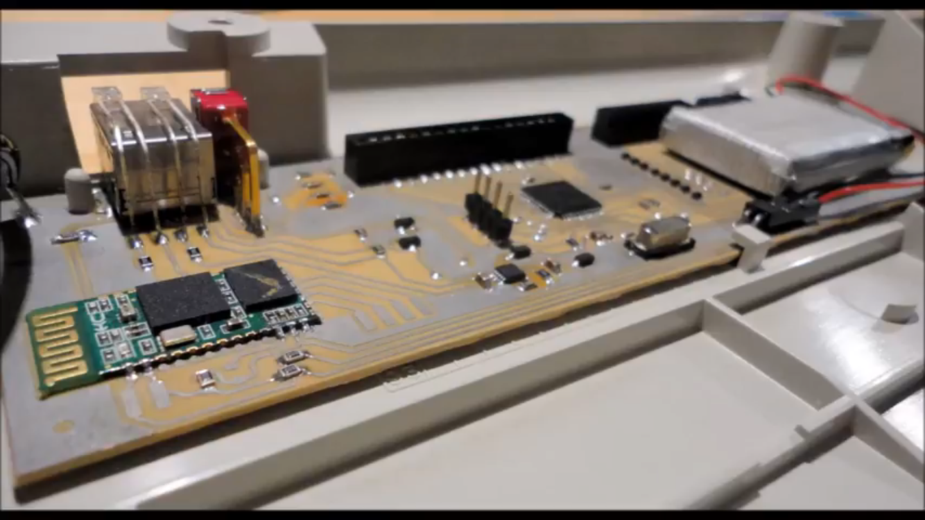

Seeing mind_prepared's Bluetooth Model M in the Great Finds thread makes me wish we could slap BT in this.
If someone wants a MASSIVE gold star, the daughter board that WCass put together is begging for BT (as soon as I saw it, it's immediately where my mind went). Its the perfect spot for it, but trickier than normal because it is already in USB protocol by the time it hits the board. So you would need to firmware it differently than a conventional HID key mapping. I did reach out to mind_prepared about it because I was impressed by his approach, but he doesn't have the "tools necessary to write a custom firmware for the BC417". He's bright btw based on his response if anyone ever needs help in that space.
To back up beyond this project, if someone did make the daughter board BT enabled, you would actually be creating something that could BT enable any xWhatsit currently around (or any USB keyboard for that matter) assuming there was room in the case for the board and battery. It would only potentially require minor tweaks in the firmware and connection considerations. That is the genius of this modular approach WCass came up with (software folks should appreciate the abstraction of controller vs comm). If we ever do dream up a better connection (BT, XBee, whatever), it only takes swapping the daughter board out. The trickiness of the xWhatsit remains untouched as the actual controller, and can receive comm upgrades over time without impact.
phosphorglow
28 Aug 2016, 01:10
Welllllllll...
Basic functionality would likely be possible. The 32U2 only has two unused pins (B3 and C2) which could probably be swapped to free up D3 and D2 for UART. But then no pins are left to check for battery level, flow control, and other useful related control (depending on the BT module used).
The expansion header could be removed to free up another four pins, but no room left for LEDs or solenoid. Or redesign it again with the '1286. Also, everything will have to be stepped up to 5V running from a battery. Battery life will likely be awful. Throw a big 'ol battery in there, though... :P
Then it's a matter of adding a serial protocol to the firmware.
Certainly some very clever people around here can do this. Bluetooth Model Fs and Beamsprings really need to happen. Just because.

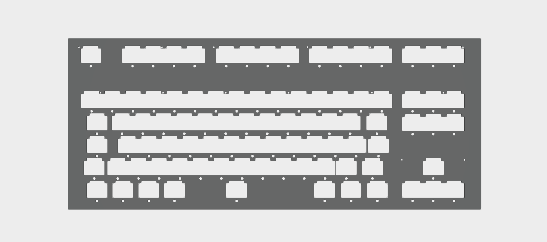

On a more productive note, we have a first pass at a "foam" layer that I would like to try that mixes two properties of very different materials for two unique reasons. To stabilize the barrel, I would like to use silicon rubber. It is much more dense than foam, yet still compresses well. It is on the expensive side, so we will leverage only where it provides value. I have a few isolated keys that will need a slightly different cutout than what is picture (say Escape, the entire bottom row, etc), but this is the general idea. The overhang of silicon above the barrel secures the base of the next barrel(s). We will start testing somewhere in the neighborhood of 1-1.25mm thickness.
I originally would have done these as "rows" when cutting out (still might), but Wodan's single barrel foam is a very intriguing idea here since we are mixing materials in a single layer. Something to chew on...
The actual foam will be butyl rubber, and will fill all the voids where the silicon is excluded. Butyl rubber actually deadens sound better than silicon (both are excellent) if we can dial the compression of it in just right. For sure it would be cut as a single sheet, and I will start testing somewhere around 2.5mm thickness before compression. We want it substantially thicker than the silicon because it needs additional compression to be optimal.
These were two of the "layers", If you notice, they would sit entirely inside the assembly. To separate the top and bottom plate, I am going to experiment with latex film under the PCB. It can be as thin as .15mm (going up in small increments). I would like something under our thin PCB anyway to further deaden ambient vibration, and it also provides the perfect means of separating the plate assemblies (sits directly above the bottom plate).
Another "layer" I have considered is a thin membrane above the silicon and butyl to prevent any LONG term butyl decay from bonding to the top plate (our pervasive F issue with foam). Butyl breaks down at different rates based on compression (less gases can penetrate the more compressed)... so I will need to research that more.
Still needs cleanup, but a reasonable first start
EDIT: I should mention that I will be trying out several materials (Nitrile, EPDM, etc). So this is not set in stone as to the substances or thicknesses used by any means.
Butyl sheet with all necessary cutouts

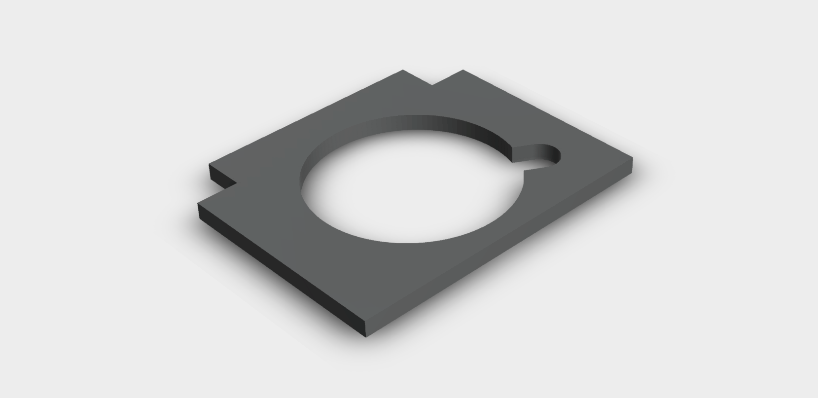

Silicon gasket (again, these may be produced as row strips in the end, but this is showing the "Wodan method").  Single barrel cuts makes for easier assembly, with a marginal tradeoff of being SLIGHTLY less secure
Screen Shot 2016-08-28 at 4.37.27 AM.png (86.28 KiB) Viewed 8415 times

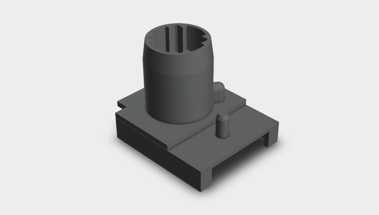

Barrel showing how the silicon gasket would fit
Screen Shot 2016-08-28 at 4.39.44 AM.png (99.05 KiB) Viewed 8415 times

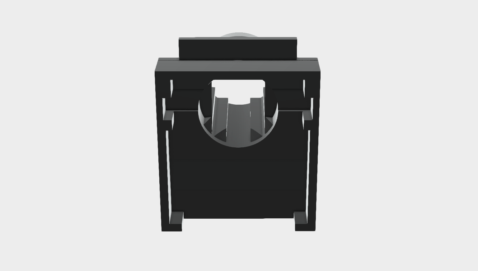

Barrel with silicon gasket overhanging.  This overhang secures the barrel(s) above at their base
Screen Shot 2016-08-28 at 4.41.15 AM.png (69.48 KiB) Viewed 8415 times

what he is using is this plus a USB battery (for charging a USB charge device) with an adapter between the two. As this is a kit that needs assembly, it would be easy to connect everything direct to pin instead of the actual USB connectors.
Techno Trousers
100,000,000 actuations
28 Aug 2016, 19:24
Ha ha, that's a heck of a daisy chain! Good thing there's plenty of room inside the phase 1 cases for those who want to try this one.
lot_lizard
28 Aug 2016, 22:33
wcass wrote: what he is using is this plus a USB battery (for charging a USB charge device) with an adapter between the two. As this is a kit that needs assembly, it would be easy to connect everything direct to pin instead of the actual USB connectors.
It is certainly cleaner than an Ada + separate arduino. The only downside is it looks like the actual BT receiver is not included... Or am I reading that wrong (from the phone)? Certainly slick though, even if pricey.
If we can go direct to pin easy enough, does it make sense to just do that with mind_prepared's approach, and have everything (BT/USB) live on the daughter?

  • Conceptually thinking about the "foam", I have decided to make the silicon portions "1 piece per barrel" like Wodan did in his thread. He did because of the size of his cutter, but it makes remarkable sense given these are the points of compression and stabilization for the board. When compressed, by being independent with tolerance on all four sides, they compress much better than being a single combined row. This provides much more consistency than if they were one strip. If one strip, the keys in the middle of the row have less room to displace the silicon, and would provide uneven tension on the top plate (the opposite of what is desirable). Wodan is either a genius, or "Flemming"-ed his way into something very novel (accidentally discovered penicillin on the reference)

lot_lizard wrote: I am going to experiment with latex film under the PCB. It can be as thin as .15mm (going up in small increments). I would like something under our thin PCB anyway to further deaden ambient vibration, and it also provides the perfect means of separating the plate assemblies (sits directly above the bottom plate).
While you're at that - can you please check how thickness of that affects key signal (detection stability, pressed/released levels..)?
