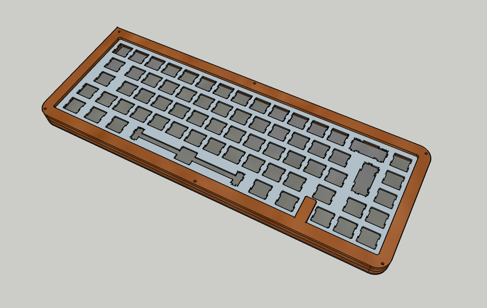

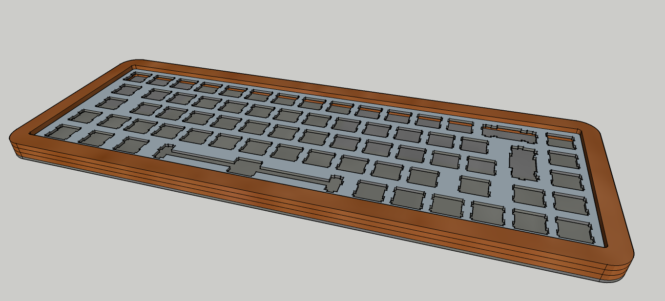

Today I had some free time, so I started sketching the case, pretty much like the one Matteo posted

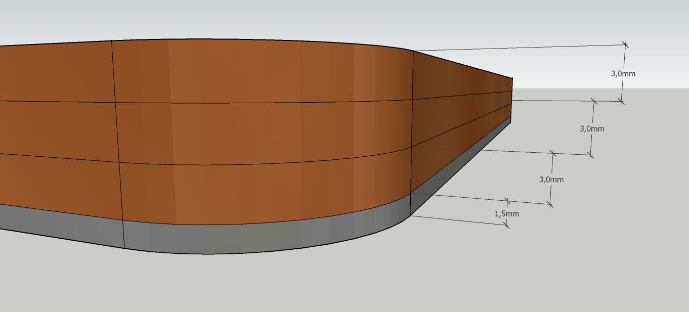

What about the thickness of the layers? Here is how I made them (metal plate in "sandwitch" is 1,5mm thick):
Will there be enough place for wiring, controller and all or it is better to make thicker layers?
-[°_°]-
25 May 2014, 16:35
if you use a PCB and SMD components you need at least 6mm. From your schema you seem to have approx 4.5mm free room which is not enough.
If you use a PCB and teensy you need a lot of space. 15mm at least.

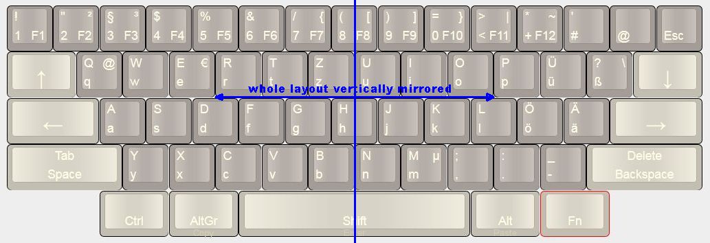

Dear matt3o, what do you think about symmetrical staggering as an aesthetical value. Symmetrical staggering consequently by 0.5 u could be a good compromise between a grid-like layout (Typematrix) and the common inhomogenous staggering.
(Please ignore the legends of this picture, it is just about the arrangement of the keys!)
-[°_°]-
26 May 2014, 14:23
I'm not a fan of "symmetrical vanity". Personally I don't give any value to symmetry in a keyboard.
That being said I like your layout, maybe the FN position is not optimal, but that's very subjective.

matt3o, well, it's all about taste, then. The mash-up of functionality and vanity renders "keyboarding science" attractive in my eyes. Muirium, you are right, as there are no caps with legends for the shown layout, blanks would do it, as it shouldn't be difficult to memorize the function of 6-10 keys.
26 May 2014, 16:06
Also, where's enter? On the function layer!?

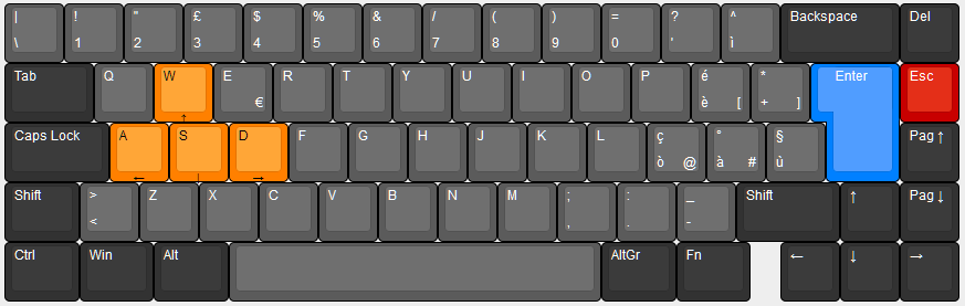

This is the Robot-65 ANSI layout, right? I assume the bottom row are just 1.25u modifiers, but do you have the sizes for the rest of the keys? This is definitely my favorite of the layouts.
-[°_°]-
28 May 2014, 00:01
it's a pretty "standard" layout. bottom row is all 1.25 + 3 1u. Shift is 1.75. Backspace is 1.5u.
everything else is standard.
