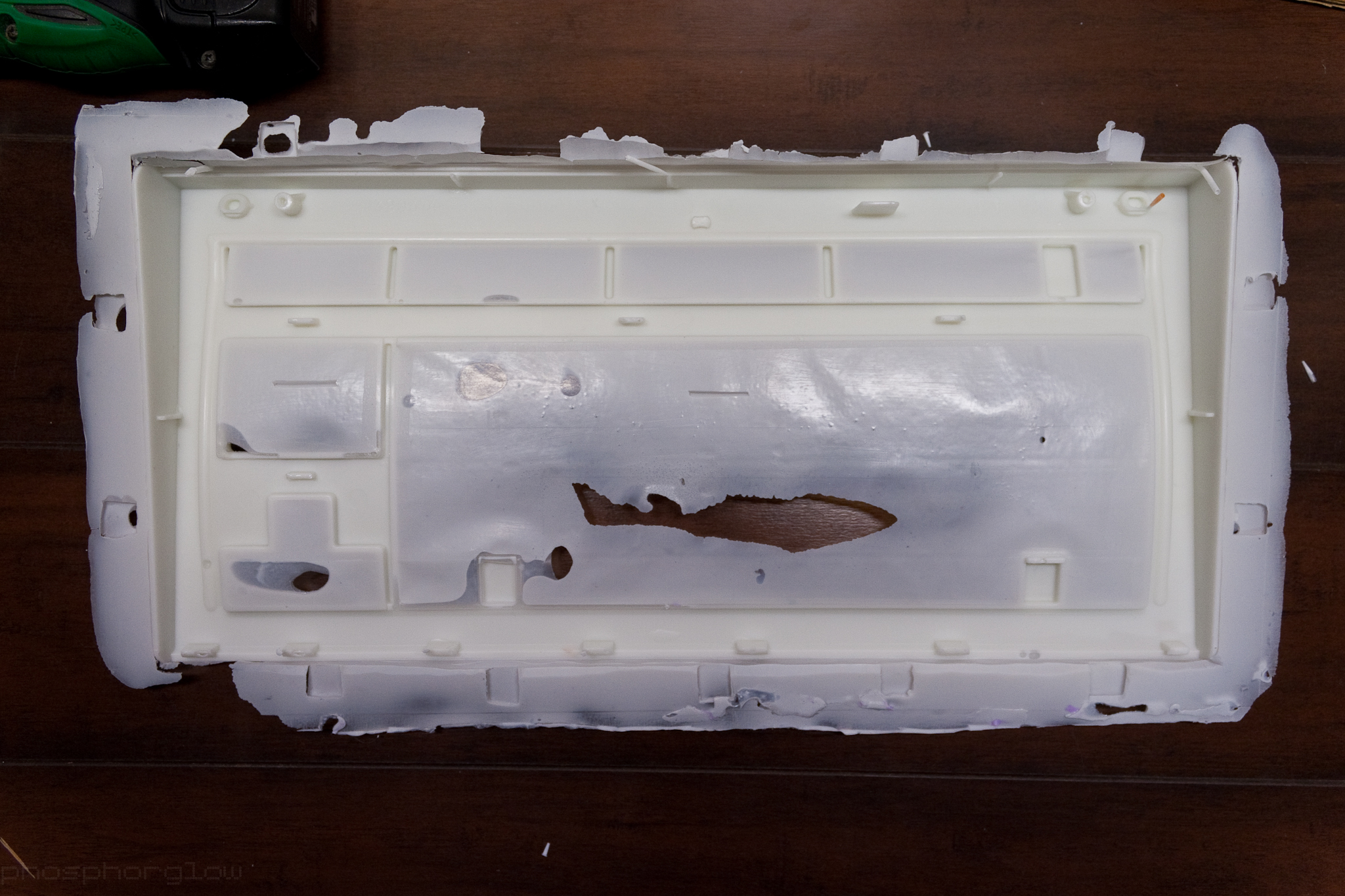

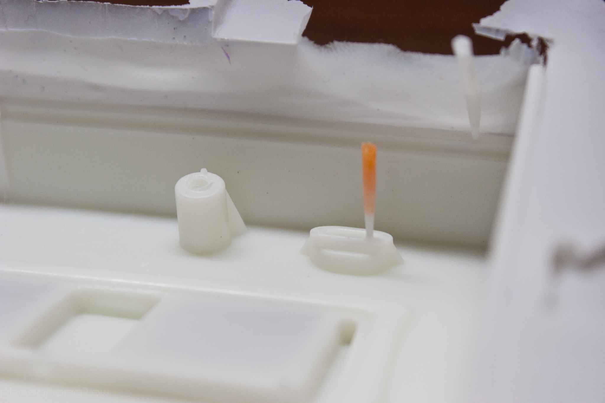

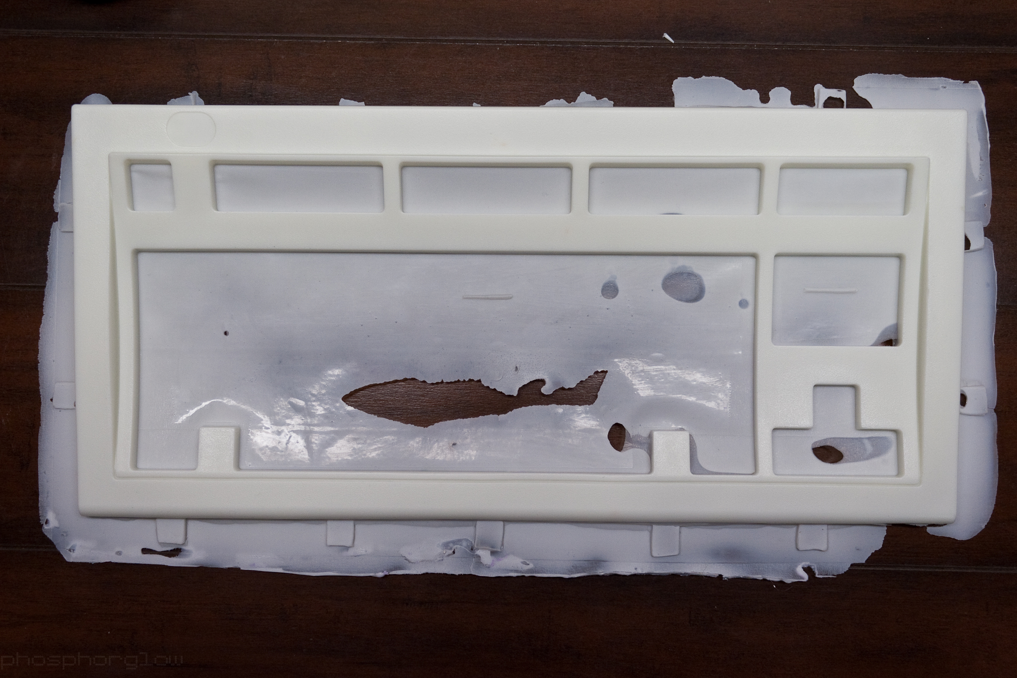

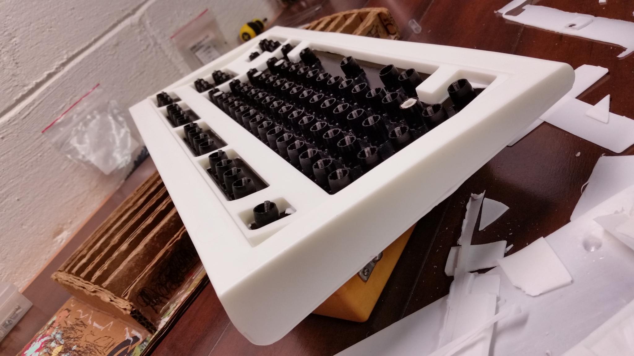

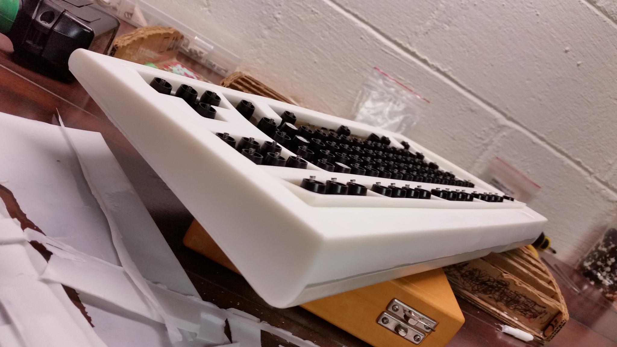

The cure time for this resin is 16 hours... but when I noticed the excess had solidified enough I couldn't help myself. I figured I'd still have issues to sort out and it wouldn't be perfect so I just ran with it. I'm glad I did.
I think this will work just dandy. I have to fix the plaster support shell (first attempt at doing it this way) and I also underestimated the amount of resin needed.
I need to work out a few more vents, but the inside is a pretty close duplicate of the real thing.
As for wear/toughness, the resin I'm planning on using (Innovative Polymers IE-3076) has properties similar enough to production thermoplastics. I'll buy some soon to play around with. Eventually I'll do some stress tests (drop it, hit it, throw it at the wall, etc...) and see how it goes.
Welllllll... it's pretty darn tricky even on this small of a scale. And I'd imagine that a new injection mold for production is pretty pricey. Sure would be nice if they did, though.

Teehee! Otay. This is enough for now. I have lots of other things to finish up before I continue messing with this.
But I'm feeling pretty optimistic about it.

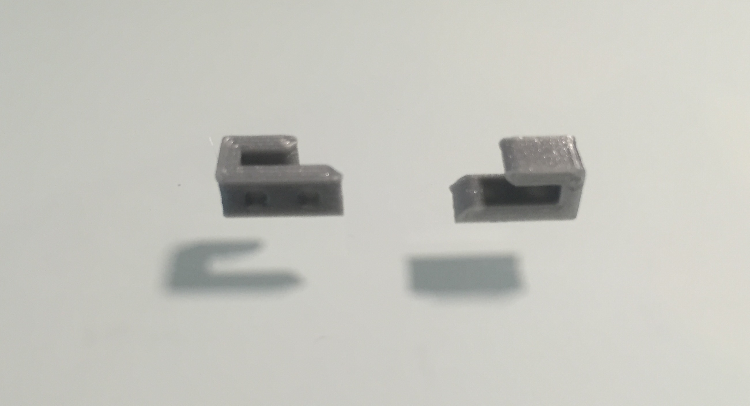

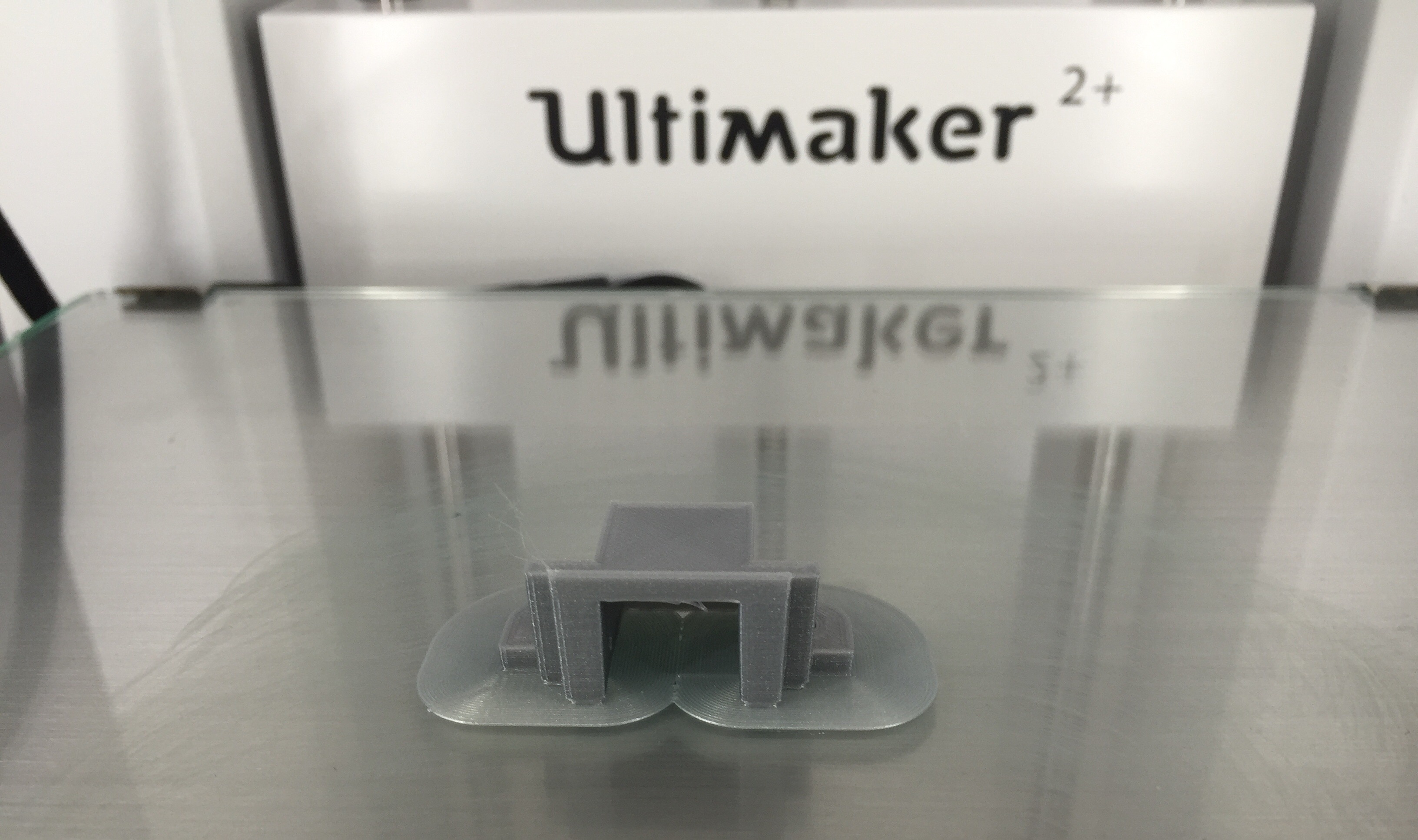

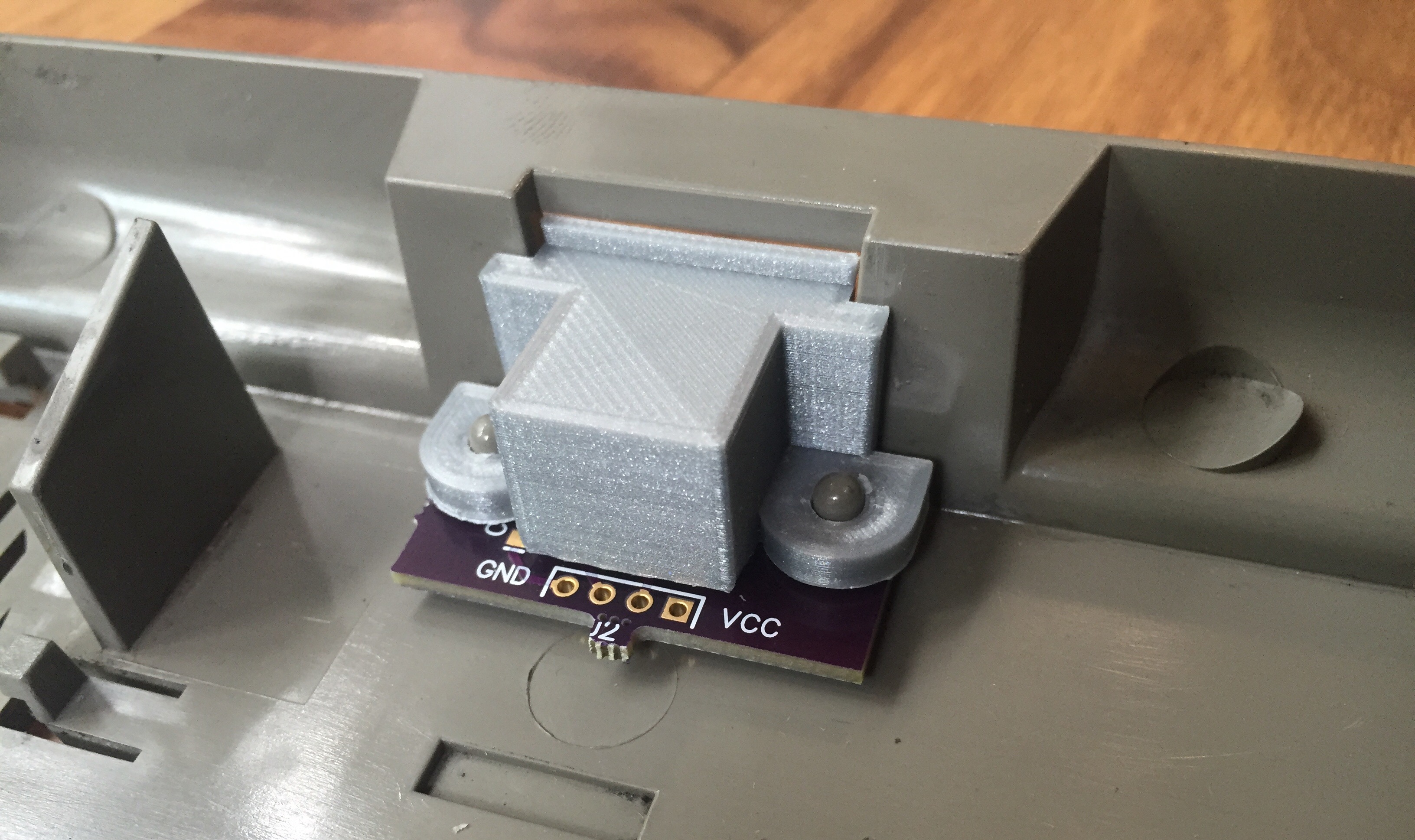

Just a quick status update. I am in South America until late this evening (short notice), but I am going to check out a demo of the LaserPro Explorer (along with a smaller Epilog) late tomorrow afternoon as our foam laser cutting option
I did get a chance before I left to print one of our retainer clips on the Ultimaker, and it worked famously. Travel was short notice, and threw a kink in my plans, but this is best pic I have to offer. More early next week.
I was impressed by the Ultimakers software to create bracing automatically (the thin base support was not part of my design, but software added... not impressed by the excess resin it used to brace, but nice to see regardless). I was concerned about the top bridging, but it turned out well. Only minor sanding to correct (I will adjust the design to compensate for all of this). Need to play with the orientation of the print a bit to see if there is a more ideal result. The test PLA was provided by the kit, and we would want to take a different path since some of these parts will be painted, and others receiving sheet screw threading (as others have pointed out... PLA blows for functional parts).
Very pleased with the printer though. I think I will work up a design to get 20-30 parts on a deck at once to save effort. Very promising. Btw... Painter's tape was garbage. Since I didn't have alternatives, I went with a glue stick in the end. Printed several demos, our stabilzer clips, and the retainer clips all did very well after adjustments (just didn't have a chance to take pics yet). Sorry

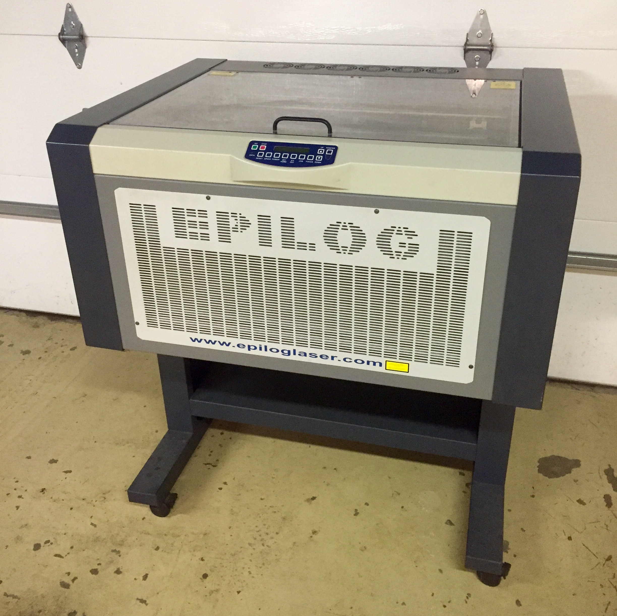

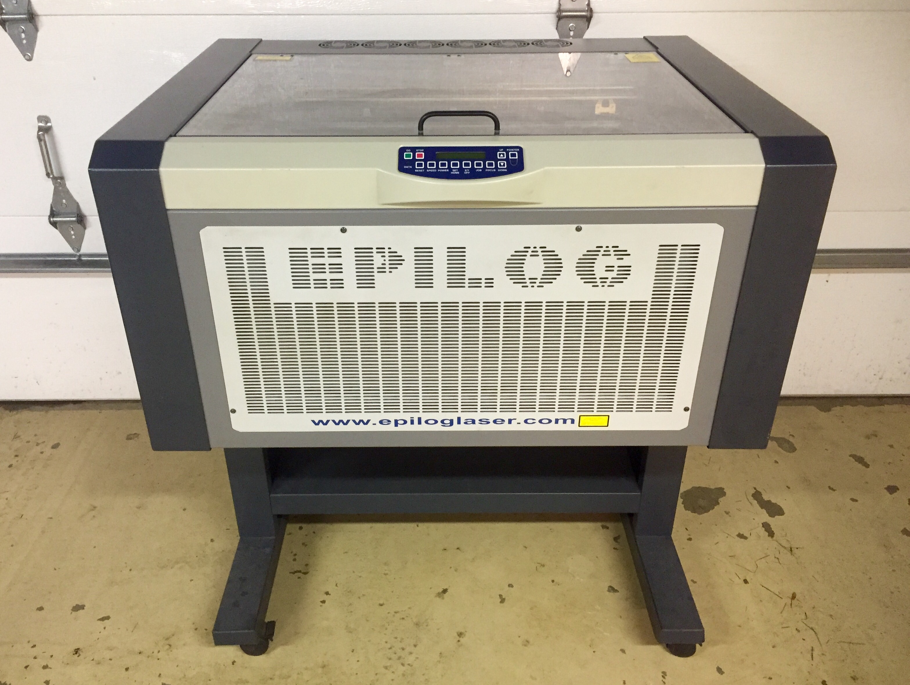

Status update:... I visited the shop with the laser engraver/cutters for sale and am in a word... Disappointed. The machines were old and don't even support 64-bit, along with other red flags.
My friend also pointed me to a stop on the way back from my trek that has a 2010 Epilog Helix that I will check out tomorrow. The bed is smaller than the LaserPro, but will still handle 2-3 sheets of foam at once. I have been chatting with the Epilog owner quite a bit today, explained what we are doing (she purchased originally for a non-proft Leukemia fund raiser), and she is excited to hear our story.

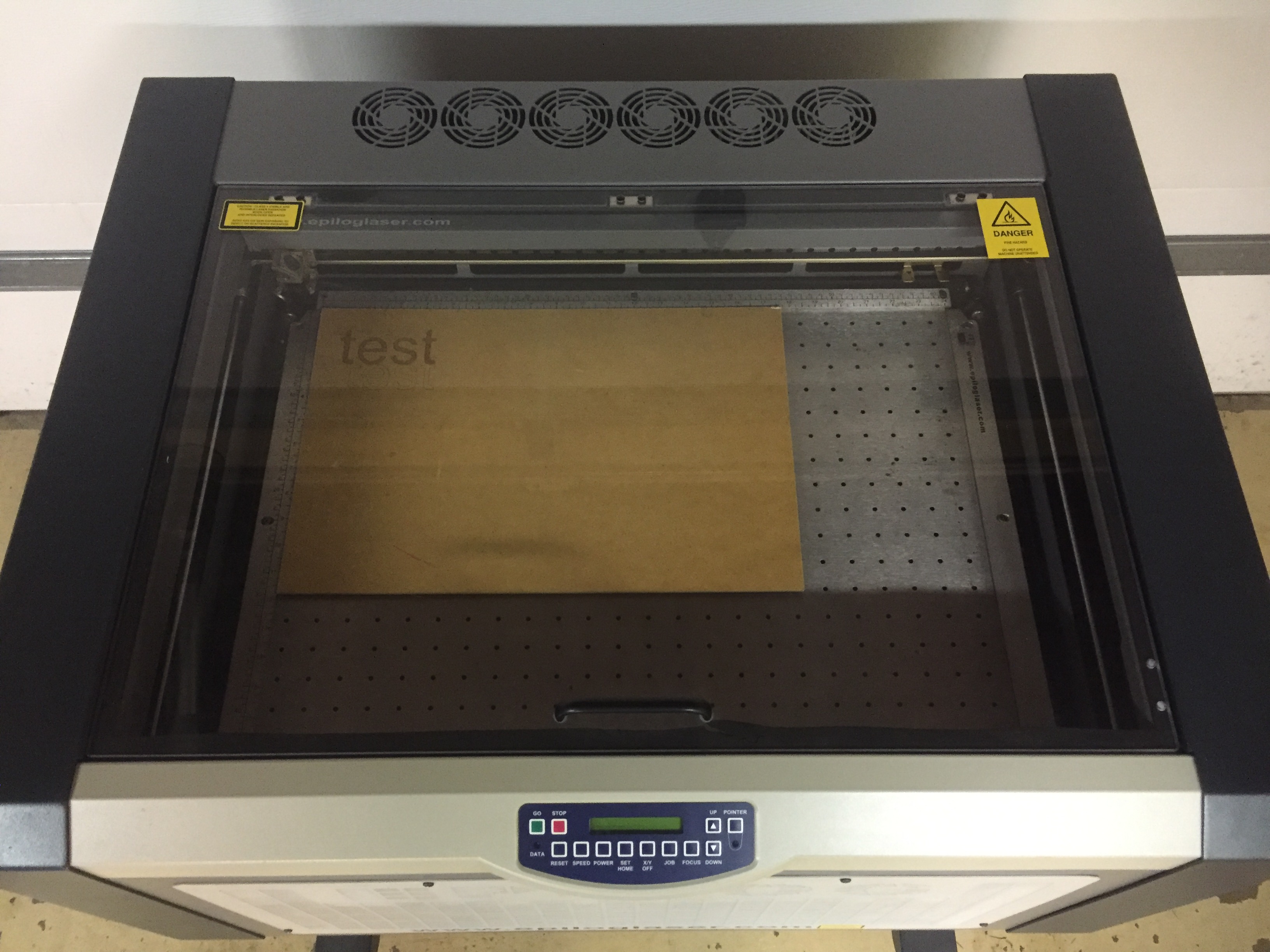

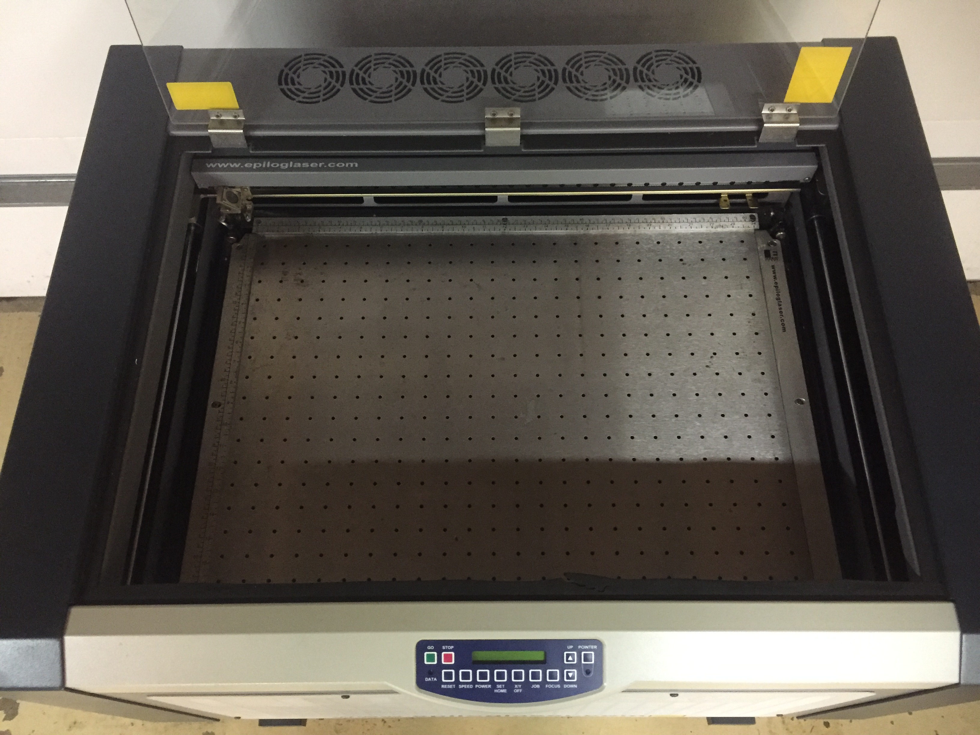

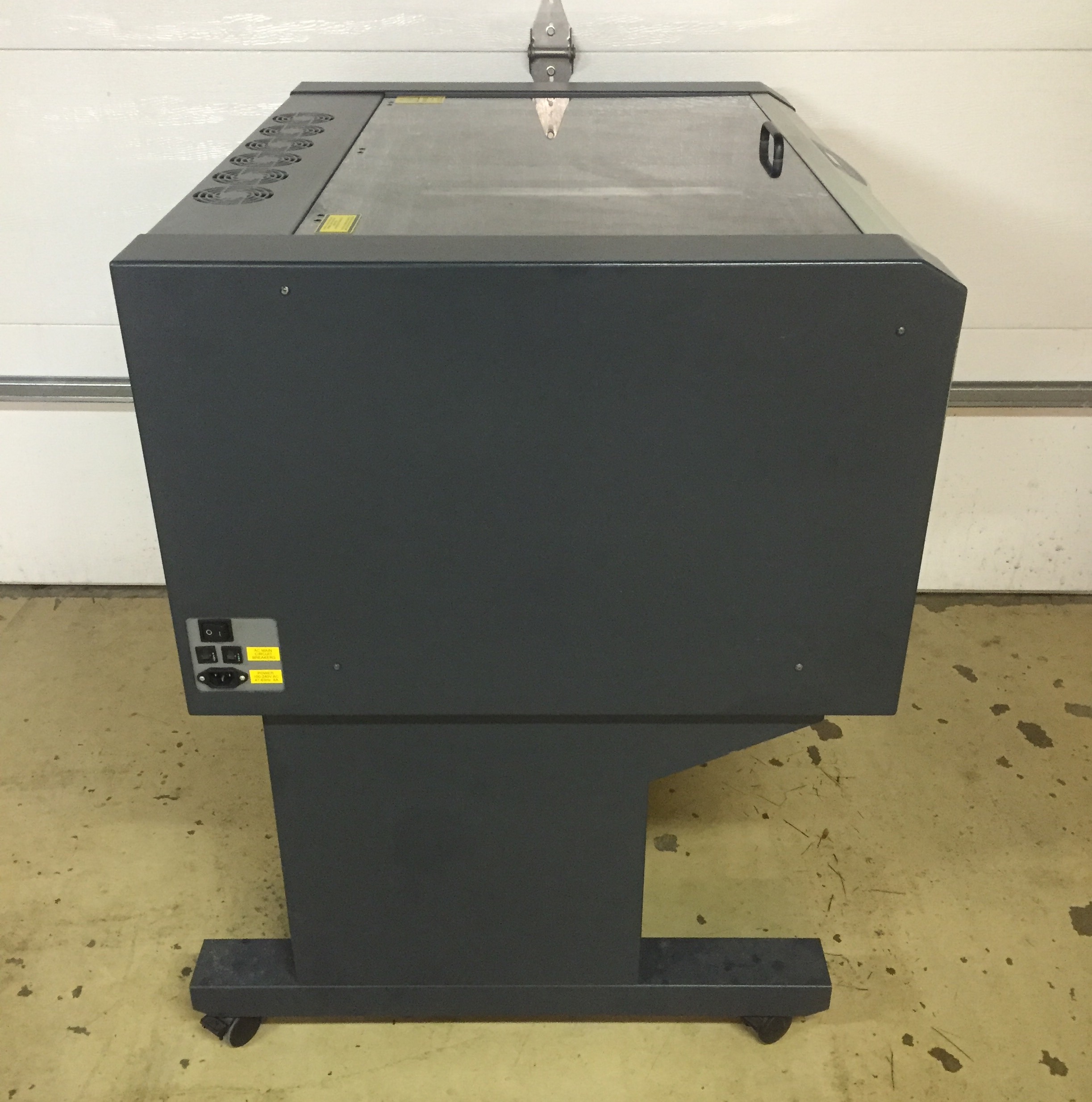

After a bit of a procurement boondoggle, we are officially set on the cutter front. Again, a 2010 Epilog Helix 35w with 24"x18" working area and downdraft table. It needs a bit of a bath, but I'll probably wait on that until after our project. Certainly serviceable now... The vector cutting table is under the engraving plate.
I need to get shipments out from "the haul" tomorrow for those that didn't want to wait until our eventual group buy, but should be able to make some plastic part and foam progress sometime this week (no travel planned)
Again... If anyone ever needs something cut or engraved in the future on a small scale (not production run), this machine will be available if you cover your material cost and shipping.

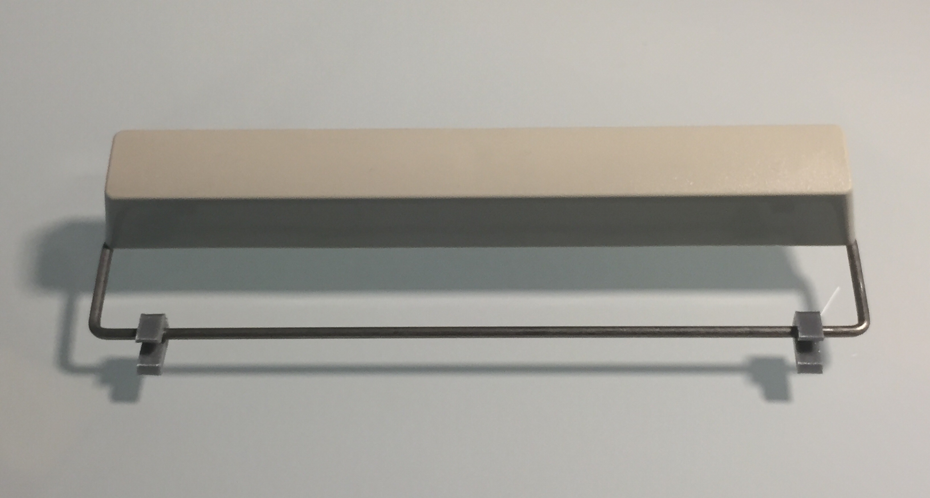

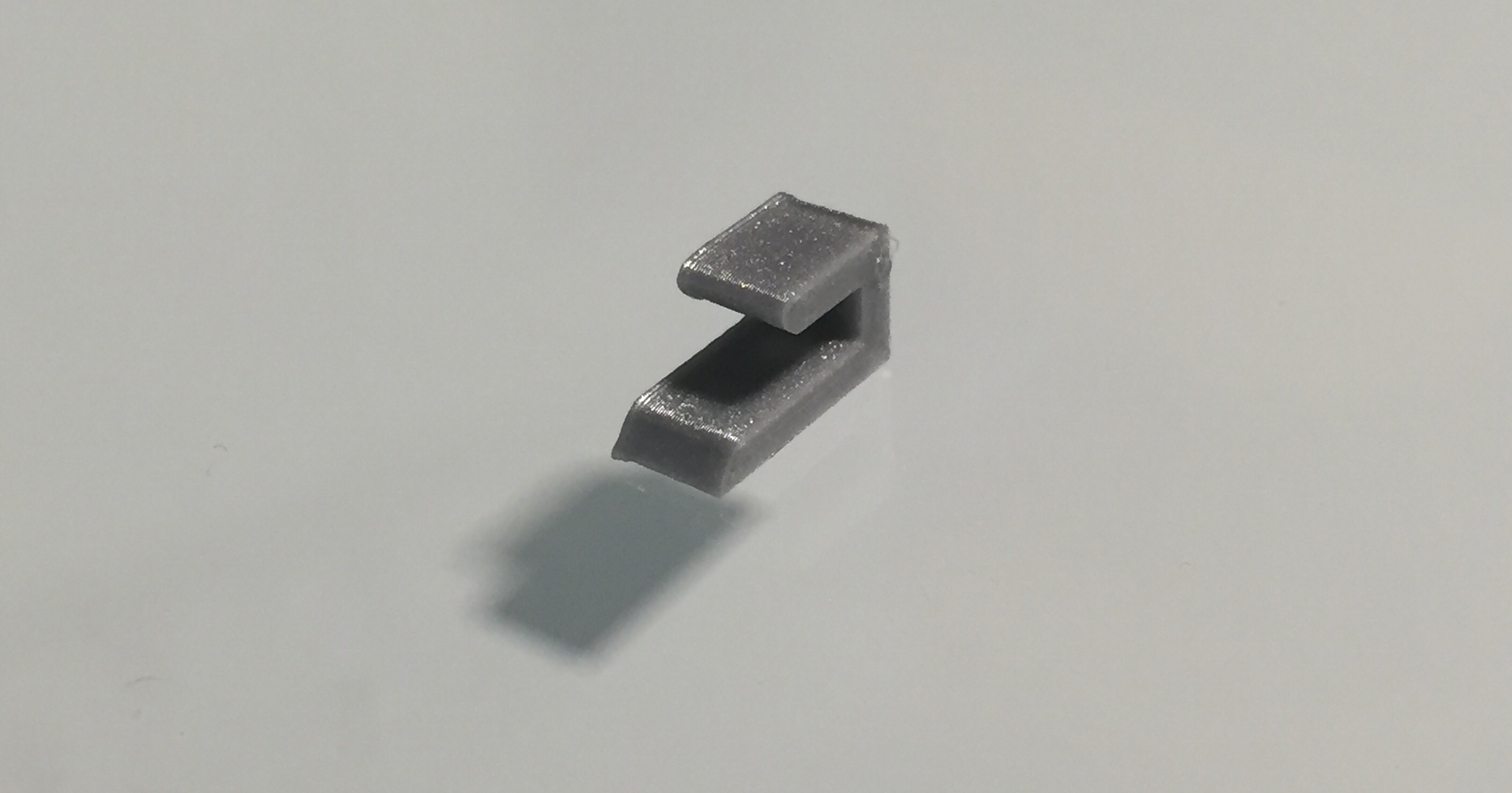

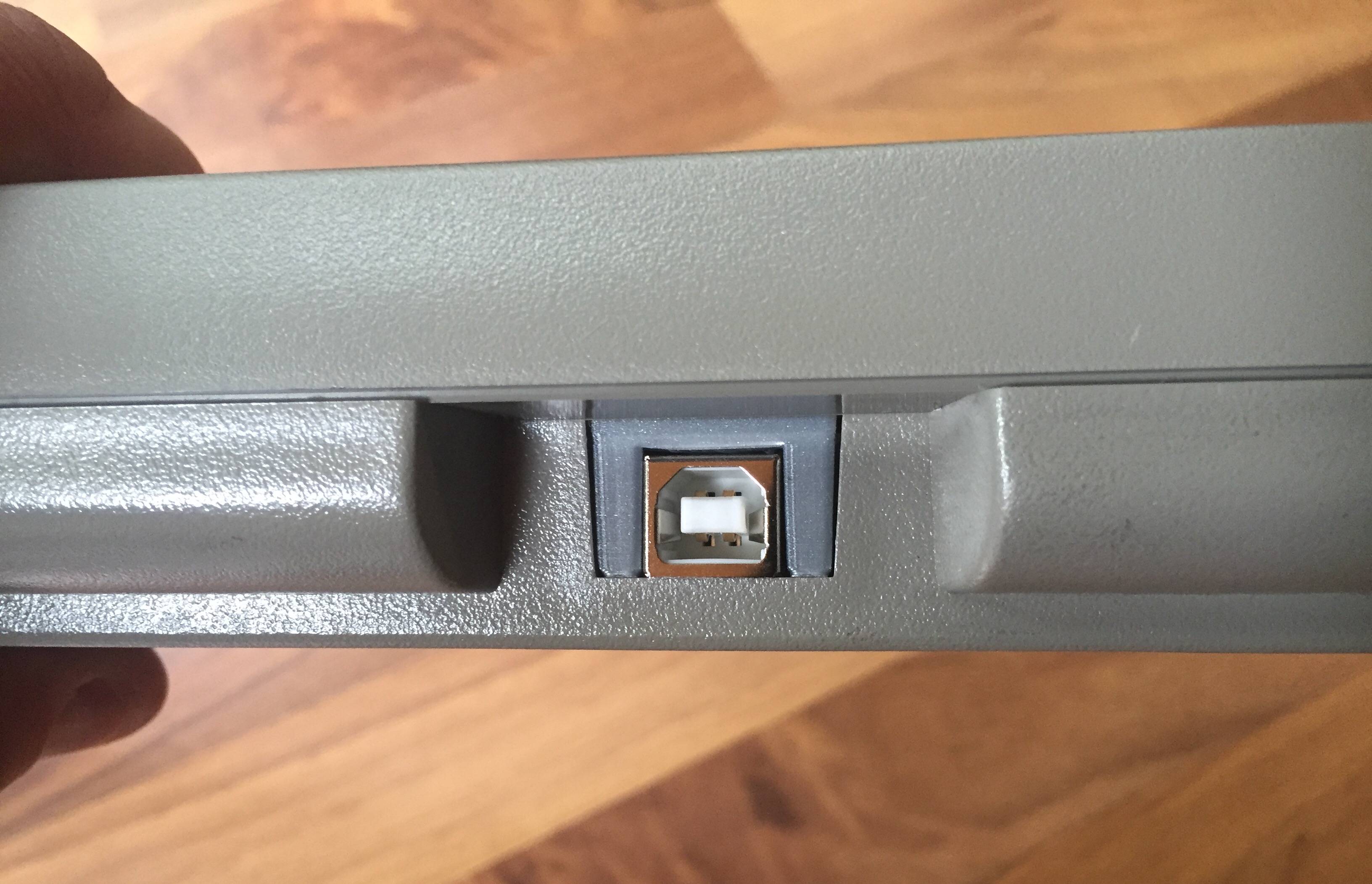

Back home and had the chance to take a couple more shots of the USB-B retainer clip printed on the UM2+ using the provided silver PLA. The port is rock solid now, but I will add .05-1mm to the peg diameters. The fit is almost too tight. Very promising though. We still need to work on color matching tactics.

That is excellent work.

Ah, now that I look at your models, I see what may be part of that problem. Making holes in OpenSCAD by difference-ing out a cylinder always results in a hole that's slightly too small, since you're placing the vertices at the radius specified, not the centers of the edges. The brilliant nophead analyzed the situation and created the polyhole library which is now included with OpenSCAD. Just add the line
include <MCAD/polyholes.scad>;Code: Select all
polyhole(d=CLIP_R_INNER*2, h=CLIP_Z)- lot_lizard

I am not so sure PLA is the best idea for the retainer clip as it will take some stress from plugging and unplugging and PLA is brittle .
It will also be a paint to have to change filament from one part to the next , unless you have dual extrusion.
As for Dye i am not so sure , painting may be better, you dont want to screw with the filament and cause clogging or extrusion problems

I will be doing batches of multiple parts on a single print (so think an STL of a given part multiplied to create a batch in a single STL). I would print all of one color (say 150 white retainer clips) before moving to the next color or different part altogether, so the filament swaps wouldn't be a big deal to me.andrewjoy wrote: I am not so sure PLA is the best idea for the retainer clip as it will take some stress from plugging and unplugging and PLA is brittle .
For the dyeing, I would wait to alter the pigment on the finished product versus the filament. I am very comfortable painting, but the dyeing is interesting to me for a few reasons:
- the pigment bleeds into the surface of the part and makes for a longer lasting finish
- the finish itself would be more desirable since we wouldn't need to worry about different paint thicknesses (in the corners, etc)
- MOST IMPORTANTLY... I could do all of the parts for a given color in a vat at once... I'm lazy
In the end, no matter what we do, it will be very solid. I stood on this one already... its a little tank.

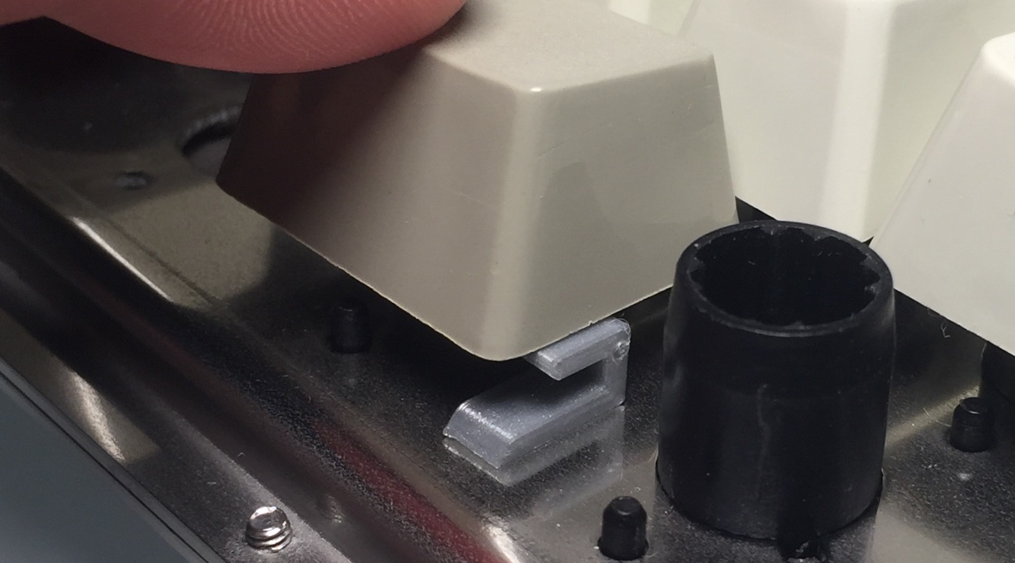

Printed out our little stabilzer clips over lunch. I will likely increase the base height a bit to aid in the screw hold from underneath the top plate, but the fit was ideal otherwise. Again, this will be in better plastic later with higher resolution, but a nice sanity check
- fohat
- Elder Messenger
- DT Pro Member: 0158
I recommend that you verify the height of those boys.
You are probably approaching the point where you will interfere with the downward stroke of the key skirt.

Indeed... Very close. The goal was .5mm clearance, but we could probably stand to give some of that back. Especially if we use a very flexible plastic that retains its shape. It won't take much pressure to keep the wire in alignment. Definitely need to experiment (especially since we are proposing these as a way to fix legacy broken clips... Should be well tested). Appreciate you pointing out. I should have shown that out of the gate.
EDIT: The dimensions will change slightly with the different plastics and resolution as well. Next is to test in whatever we decide we like as an end material and resolution. The above took ~3 minutes to print. Assuming that is doubled with higher grades going forward, we could probably crank out 10 an hour pretty easy. I can fit A LOT of these on one printing cycle (haven't done the math yet per bed size), but the horrible thing would be if something went wrong in the middle, the entire batch... and more importantly time... are lost. I just don't have the opportunity to baby-sit small batches though. Has to be big and vanish for a while. Once I know these are golden, I'll start production (even before the GB)
