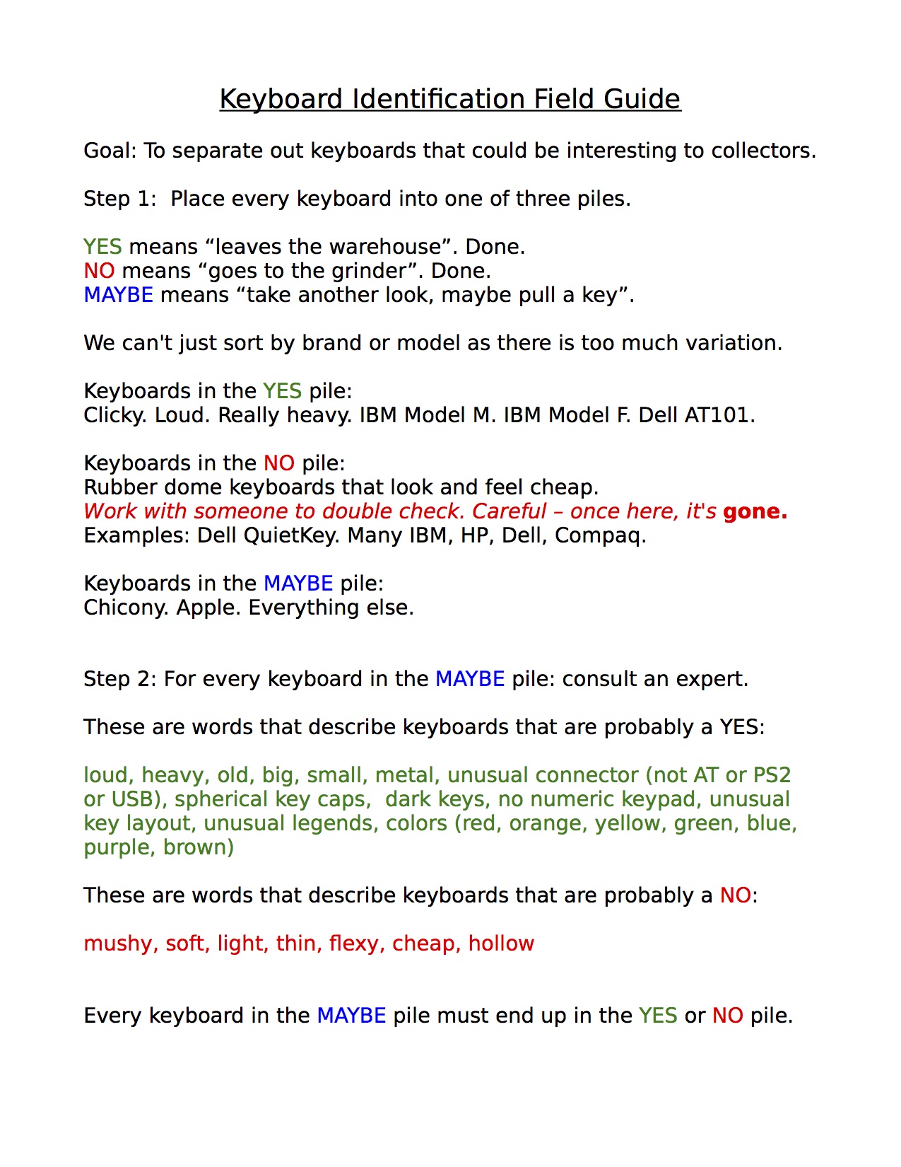

A very real problem is sorting keyboards at a recycler. The vast majority are rubber dome keyboards that are more valuable for their reclaimable materials: silver, other precious metals, some plastics. Some are valuable to us.
What I've constructed is a document to give to non-experts to help with first round keyboard sorting. This assumes one "expert" and multiple individuals who are not experts but are capable of learning and following patterns. I've tried to "keep it simple" and restrict it to one double sided sheet of Letter or A4 paper.
The full guide, version 1, is here as an image attachment.
20150417 Keyboard Field Identification Guide.jpg (409.02 KiB) Viewed 6682 times

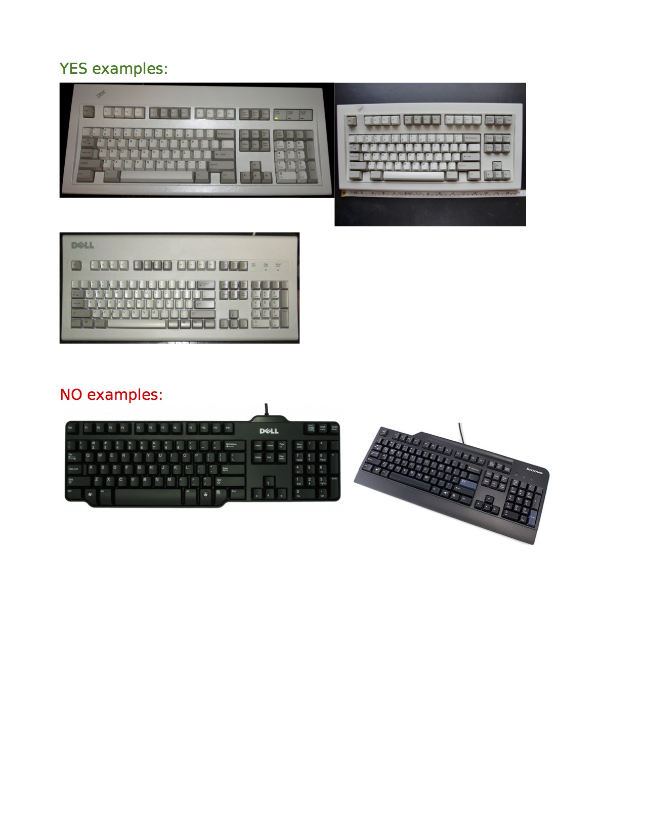

20150417 Keyboard Field Identification Guide 2.jpg (184.92 KiB) Viewed 6682 times
This is the current text on page one, without formatting:
Keyboard Identification Field Guide
Goal: To separate out keyboards that could be interesting to collectors.
Step 1: Place every keyboard into one of three piles.
YES means “leaves the warehouse”. Done.
NO means “goes to the grinder”. Done.
MAYBE means “take another look, maybe pull a key”.
We can't just sort by brand or model as there is too much variation.
Keyboards in the YES pile:
Clicky. Loud. Really heavy. IBM Model M. IBM Model F. Dell AT101.
Keyboards in the NO pile:
Rubber dome keyboards that look and feel cheap.
Work with someone to double check. Careful – once here, it's gone.
Examples: Dell QuietKey. Many IBM, HP, Dell, Compaq.
Keyboards in the MAYBE pile:
Chicony. Apple. Everything else.
Step 2: For every keyboard in the MAYBE pile: consult an expert.
These are words that describe keyboards that are probably a YES:
loud, heavy, old, big, small, metal, unusual connector (not AT or PS2 or USB), spherical key caps, dark keys, no numeric keypad, unusual key layout, unusual legends, colors (red, orange, yellow, green, blue, purple, brown)
These are words that describe keyboards that are probably a NO:
mushy, soft, light, thin, flexy, cheap, hollow
Every keyboard in the MAYBE pile must end up in the YES or NO pile.
Ascaii
The Beard

You are missing something very important: Cherry! Unfortunately, most cherry boards fit your "no" indicators, so put the brand down on the definitie MAYBE list.

Muirium wrote: An image attachment?
Propose a nicer way to share a PDF or similar. Suggestions welcome. I'm not buying into Dropbox or one of those awful embedded Javascript PDF readers. Plus it was quick and dirty. So, yes, image attachment.

Maybe I'm missing something - all of the text in the document was copy-pasted in the original post?

Keyboards with soft rubber media control keys. Can all of those be ruled out?
17 Apr 2015, 22:02
Chuck everything that is a rubber dome. To determine;
-Press a couple of keys. Listen to the sound (keep anything that makes more than the tiniest noise, even dampened tactile switches make much more noise than rubber domes) and feel the keyfeel (all linears are mechanical, if it feels squishy, like you could press it more than 100%, it's almost certainly rubber). It should be possible to recognise at least 90% of all rubber domes this way.
-Look at the keyboard. If it is black, looks cheap, or has extra buttons that are stupid (music, internet, email, that sort of rubbish), or is NOT rectangular when looked at from above, it's probably rubber dome.
-Feel the keyboard. If it feels very light, as if it has no metal parts in it, it's almost certainly rubber dome. Even the lightest mechanical keyboards are heavier than membrane ones (the lightest I've found so far is my 6312-TW, and that has a nice giveaway metal back panel and is very clicky).
-Look at the brand. Brands on the front may be rebadges, so try to look at the back-side sticker if there is one. The mechanical series of manufacturers usually look substantially different from their (later) rubber dome series. Brands to look out for are IBM (buckling springs on old ones; very easy to recognise), Chicony (practically all their mechanicals start with KB-5***), Cherry (G80, G81, and G84), Focus (keep *001 and *000 keyboards, will almost always be a 2001), Dell (keep it if it says AT101), Acer (keep 60** and 63**), Apple (toss it if it's not old or if it's called "AppleDesign Keyboard"), keep all Northgates, all Zeniths, all Montereys that make a noise. Key Tronic is almost always rubber domes, but apparently they're just about the best rubber domes on the market.
-Keep everything that's SUPER old. If it's 1990 or older, it will almost always be mechanical.
-Keep everything that ROUGHLY resembles a Model M, F XT, F AT, or Alps Bigfoot. There are fucktons of clones of these, but the vast majority of them are mechanical.
-Pull a key cap on everything you're not sure of. If you can't directly see a rubber dome underneath it or the cap you pulled doesn't have the slider integrated into it, it's almost certainly mechanical.

Thanks Chyros. I will incorporate your feedback and all other feedback I get in an eventual version 2 of my document. Hopefully this thread is useful to other keyboard hunters as well.
Only to play devil's advocate, and to demonstrate how frustrating a problem this is, I'm going to try to provide a common exception to as many of your suggestions as I can. :evilgeek:

XMIT wrote: Thanks Chyros. I will incorporate your feedback and all other feedback I get in an eventual version 2 of my document. Hopefully this thread is useful to other keyboard hunters as well.
*lots of stuff*
Yeah I know, this is more meant as a general pointer :) . It will not work in 100% of the cases, just in the vast majority of them. I tried to make it in such a way you're more likely to accidentally keep a rubber dome board than to chuck a mechanical one.
The handlers at the recycling centre(s) I go to just keep everything for me, I go through them myself. It's piss easy to sort through them if you have a little bit of experience with older boards (I'm not very interested in new boards). And they only cost 50 pence apiece, so I wouldn't mind even if I did get a rubber dome one every once in a while :) .

How about some sort of visual flowchart? We recognise things by sight, after all. So much easier to check something against pictures than to process (necessarily complex) words.

Muirium wrote: How about some sort of visual flowchart? We recognise things by sight, after all. So much easier to check something against pictures than to process (necessarily complex) words.
Perhaps. I am considering a longer field guide to give to managers and others who are willing and able to read through a longer document and/or can watch video and listen to audio. The one page guide above is designed to be given to a volunteer with no training. I keep the procedure and the language super simple.

It's a cool thing you're trying to do. However, the more instructions they have, I think the less likely they will want to mess with the whole thing.
My opinion is to keep it super-simple. If it's heavy or clicky, keep it.
