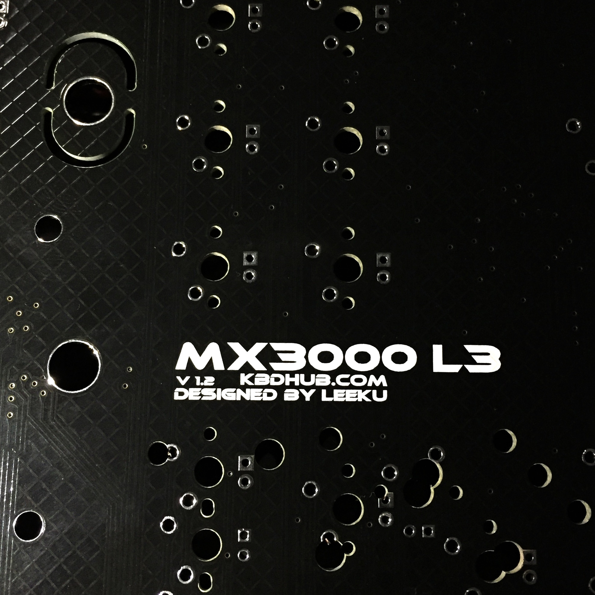

I got a Leeku MX3000 L3 PCB.
I want to change the layout.
I've found those links,but I have no idea what to do.
http://kbdlab.co.kr/index.php?document_ ... nt_3053246
http://kbdlab.co.kr/index.php?mid=board ... srl=543530
https://github.com/leeku11/l3
Does anyone know how to do?

Better late then never, maybe you already found out after a few months... You should only have to start the software tool 'JigOn', and can do remapping after you connected the keyboard / PCB in the software (there is a menu option for that). After doing your changes you have to save them, also in the menu - then it will be automatically disconnected. To change the mapping of a key you have to click in the top layout on a button (it is then red), and afterwards on a button of the keyboard map below.
