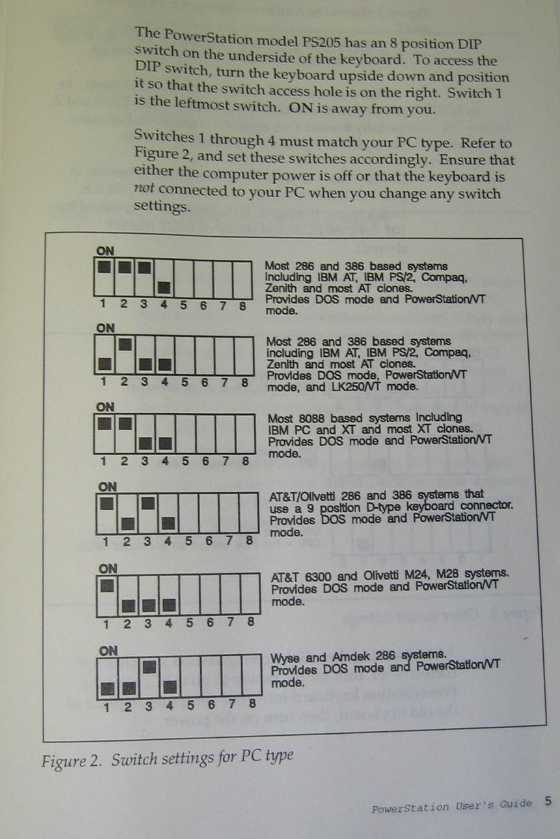

I have the same keyboard and I am trying to figure out my dip switch settings.
Any chance you have the manual with your new keyboard? If so, can you upload it pleaseeeeee!
:D
urbancamo
26 Sep 2016, 00:39
I have a manual for this keyboard somewhere - I will scan it when I find it!
In the meantime I found this image on an eBay post:
Not all the switches but probably a help.
0100010
26 Sep 2016, 04:38
Based on that image, if you put the DIP switches like the first diagram, it should work with just an AT to PS2 passive adapter.
That is very interesting that it can also do XT (it says WYSE as well, but I assume that is PS2 and not the other WYSE).

Finally, as promised, here is the full manual: http://wickensonline.co.uk/static/files ... Manual.pdf
