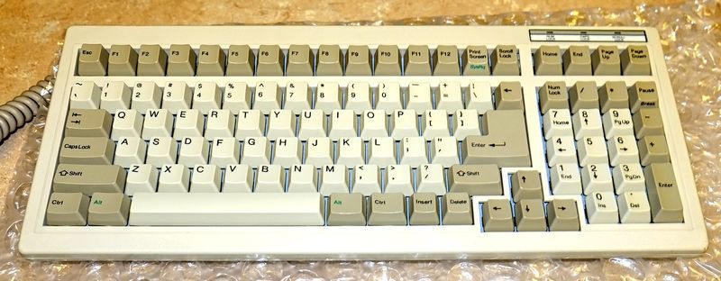

I actually found a FK-2002 at the recycler earlier this week:
It's not quite as nice as my other one but would hurt a lot less to cut this one down to make a 60% ;)
And the keycaps need some retr0brighting...
